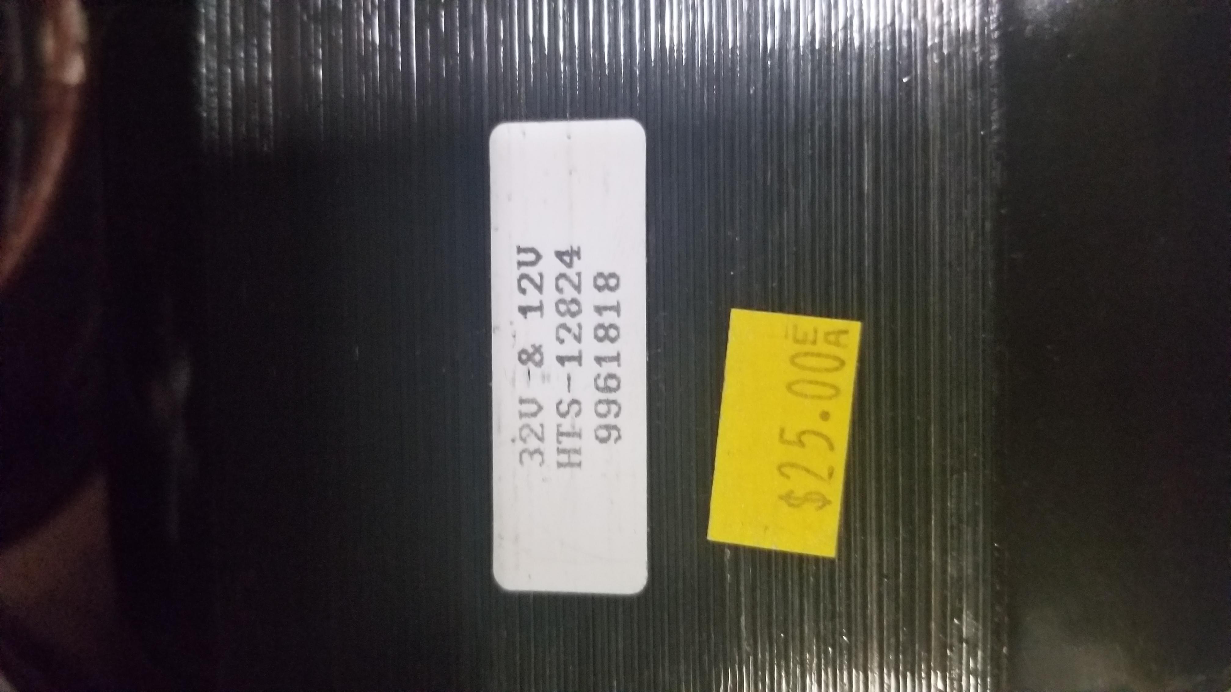

Before doing so if you have a multimeter measure the secondary AC voltage, also more pics of the transformer would help, take a pic of all the wiring. Was this transformer previously powering an amp ?
The label shows 32V, it it’s 32V output you can easily make a linear power supply and use it with a nice TPA3255 or other.

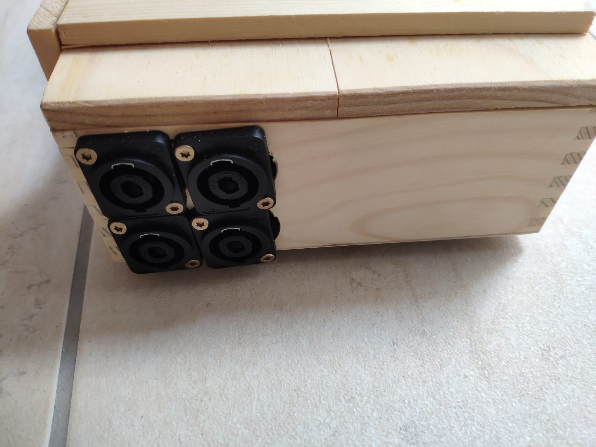

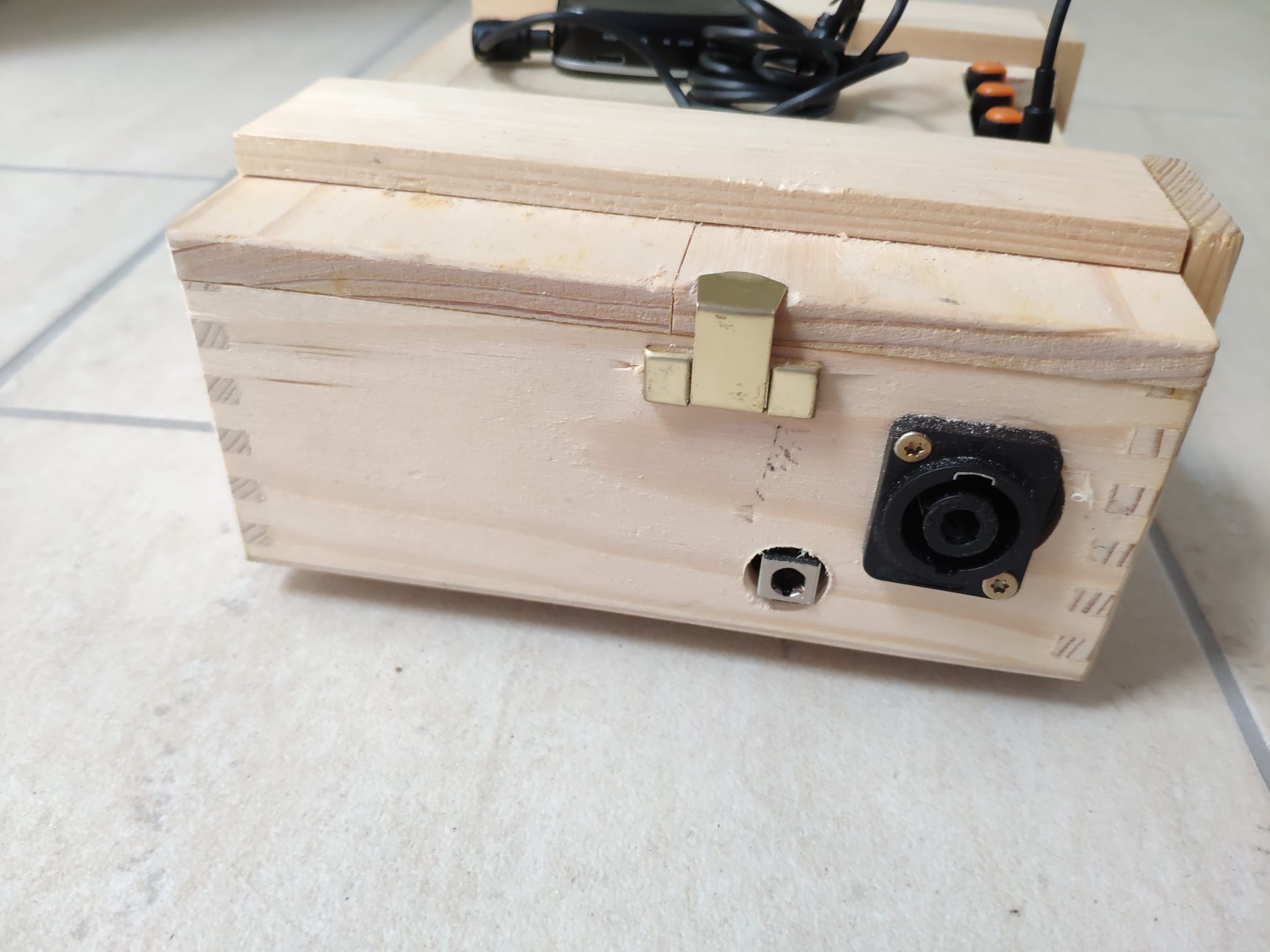

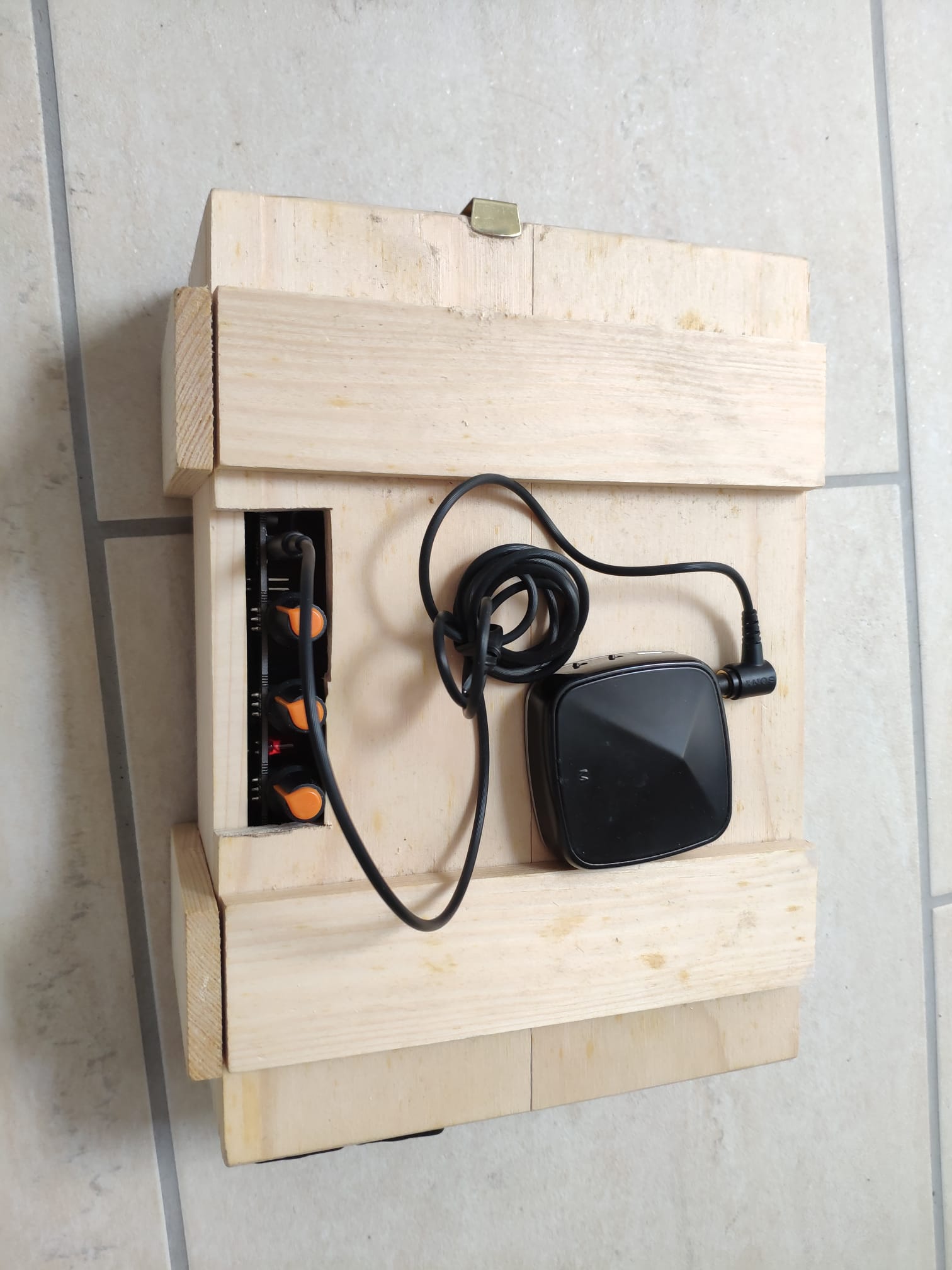

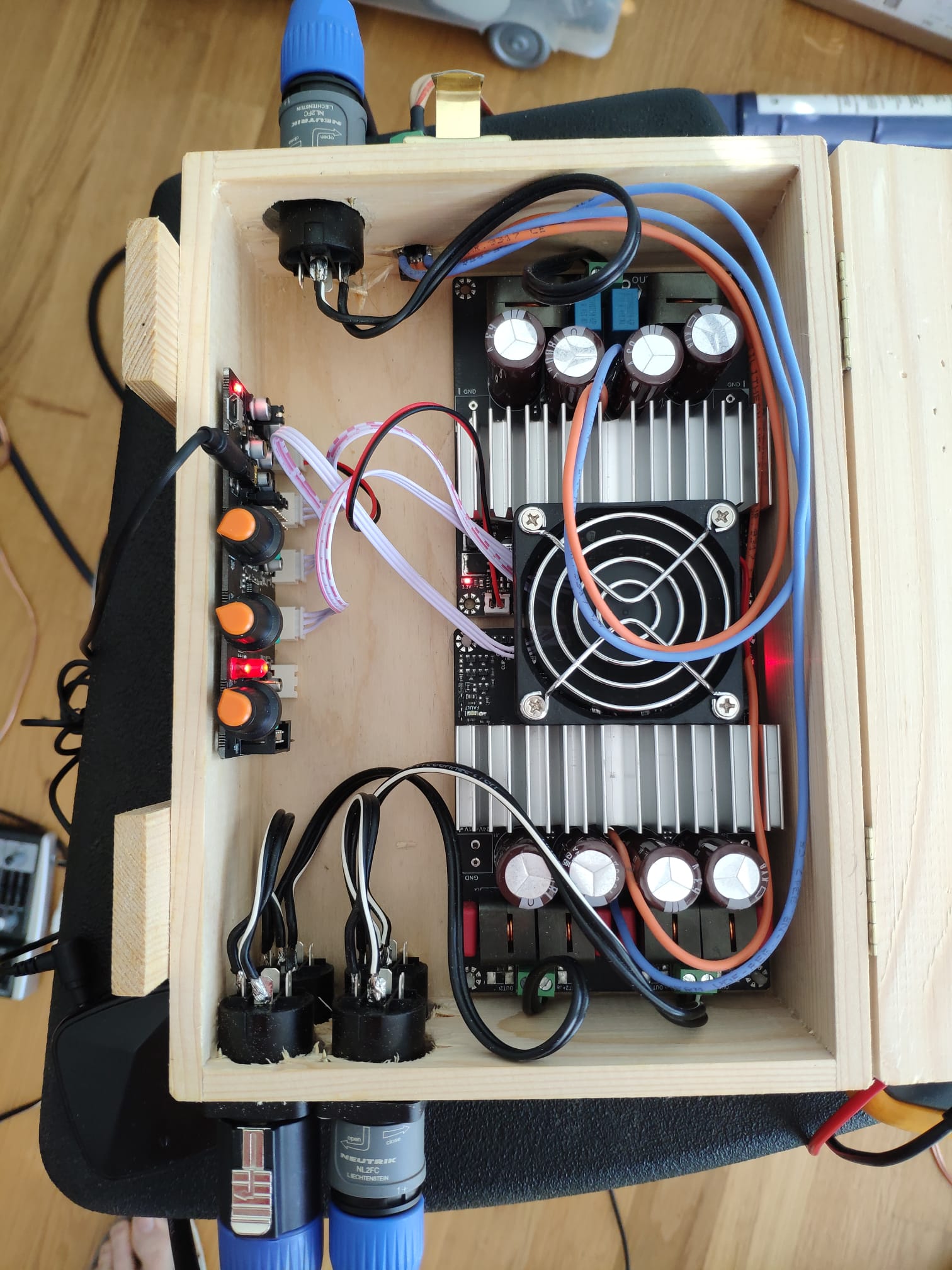

My new 2.1 Amp.
Later I will make better enclosure with built-il power supply.
But for testing it and play at my birthday party its enough^^

I guess 3E Audio boards ?
If you are looking for a nice Enclosure, I can help you )
Exactly.
3E Audo but with better caps
What type of enclosure?

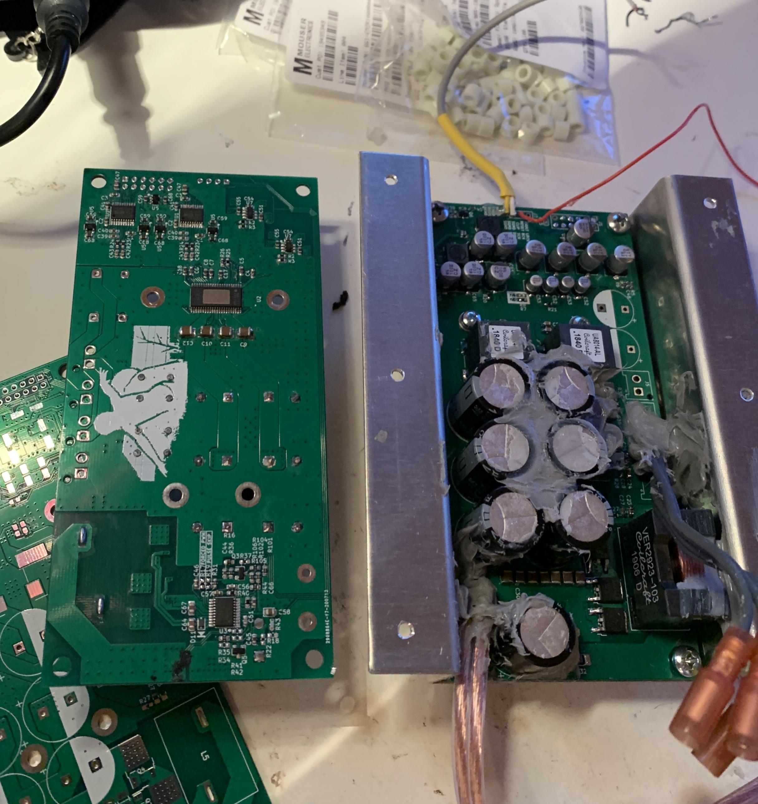

I did the updates myself. checkout :
New Inductors MA5173-AE as per TI spec
+ OPA1656
PS: If you are looking for the best TPA32XX board, I will suggest you to get a 360 Customs oriented design or XRK Audio. They both perform very very well, they are among the best class D I listened to.
I compared it VS Hypex Ncore here : TPA3251d2
