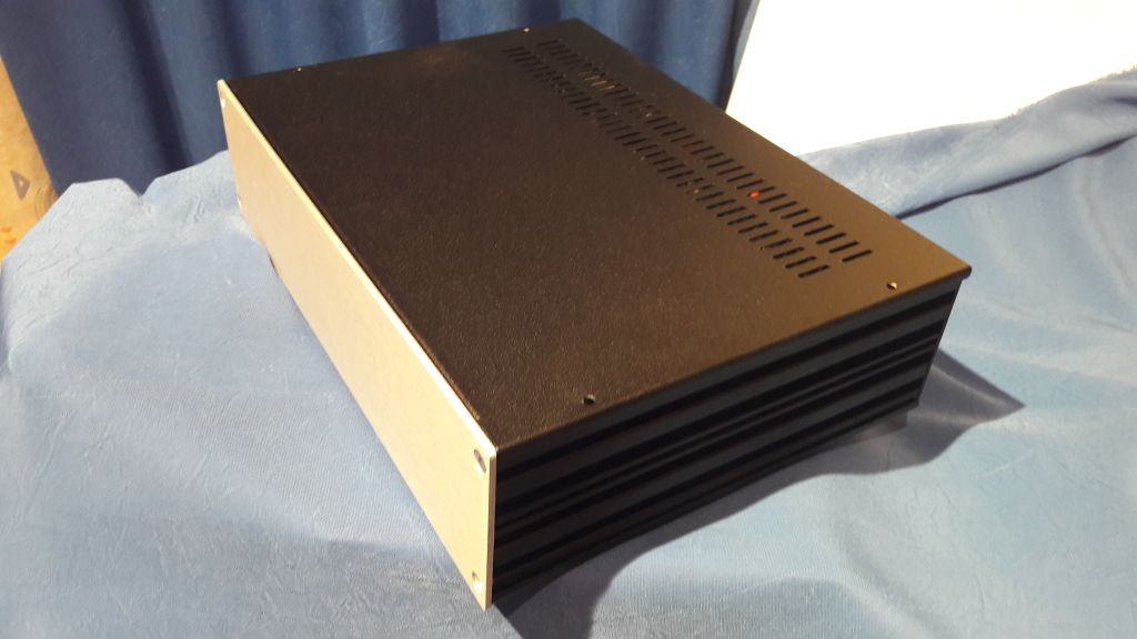

Please tell us more about your enclosure, perhaps a link, seems like the perfect size and it has ventilation (harder to find)
Enjoy
Eric
Hi Eric, indeed this enclosure is perfect for any kind of project. You can DIY whatever you want inside : double mono / TPA / large Boards etc...
The quality is excellent and the price absoluterly great !
It comes "ready to use"
checkout :
100% Aluminium enclosure
311x220x90mm
Boitier amplificateur DIY 100% Aluminium 311x220x90mm - Audiophonics

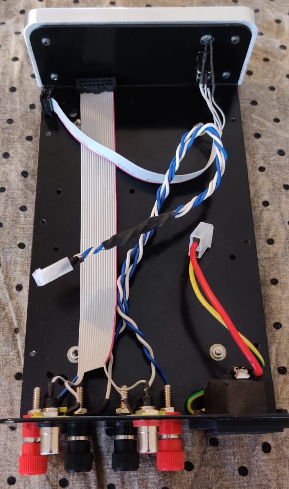

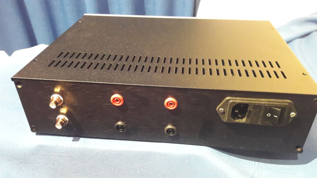

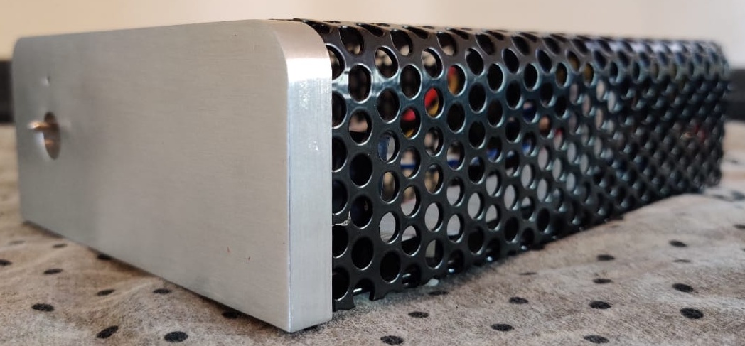

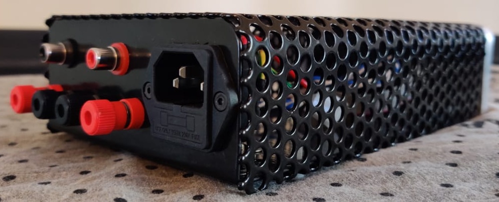

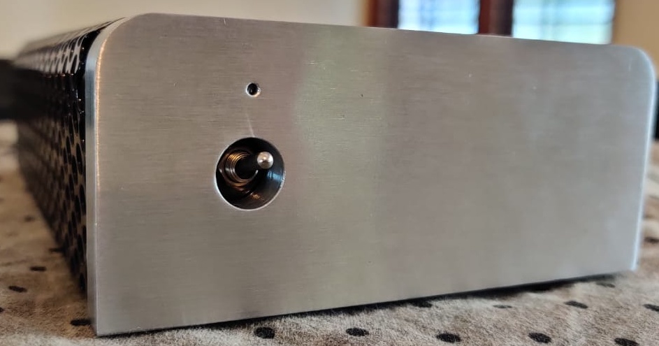

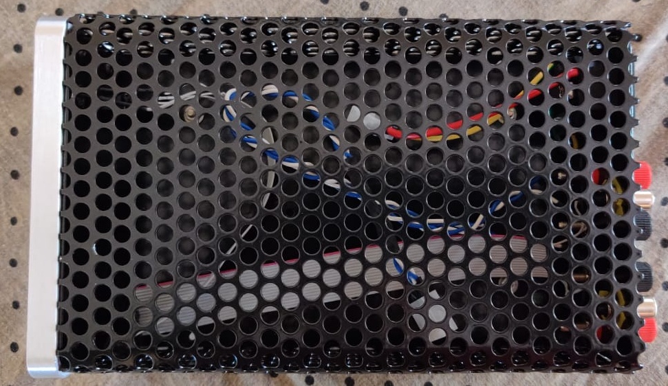

A cabinet for a friend's hypex, alongwith harness. The RCA and speaker terminals aren't the best - only had these to hand. With no option to get new ones because of the lockdown here.
Happy to make more if anyone wants it. PM if so.

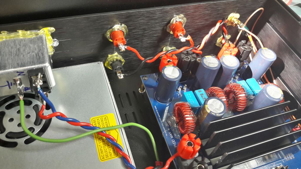

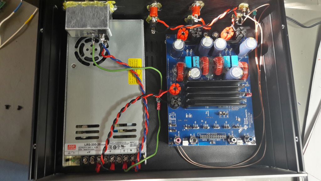

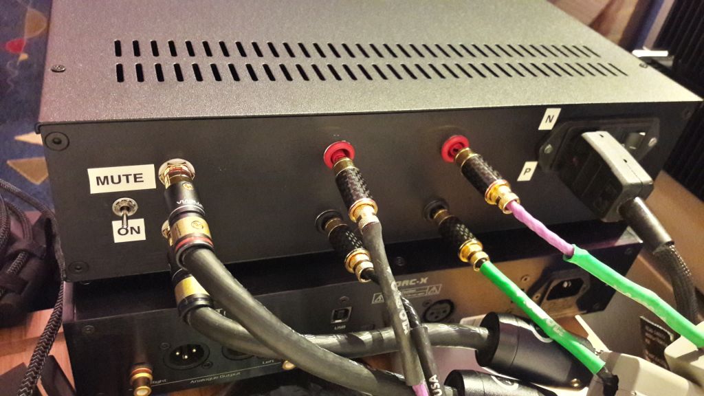

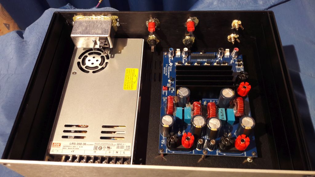

After 1 year listening and using as a DIY "reference" i decided to give my TPA3251EVM a small case before it is in the cupboard or laying around.😉
i got that board when the discount over the TI code was enabled- its about 95Euro😀😉.
housing is a Galaxy Maggiorato GX383 330 x 230 mm -maybe a bit too compact but it is ok.
Meanwell LRS36/350 -set to 34V. connection is done over the RCA connectors under the pcb via a RG178 mini coax cable.
i use a mute switch to avoid on/off pop. for this is set the on board switch to normal but solder in parallel a other switch to set "Mute on/off". I do not need the max power of that board because at home the setup is ok for that. sound is really very good.
Any updates for improving sound quality are welcome. if you know a better sounding Class D amp give me some ideas.(150-200Euro)

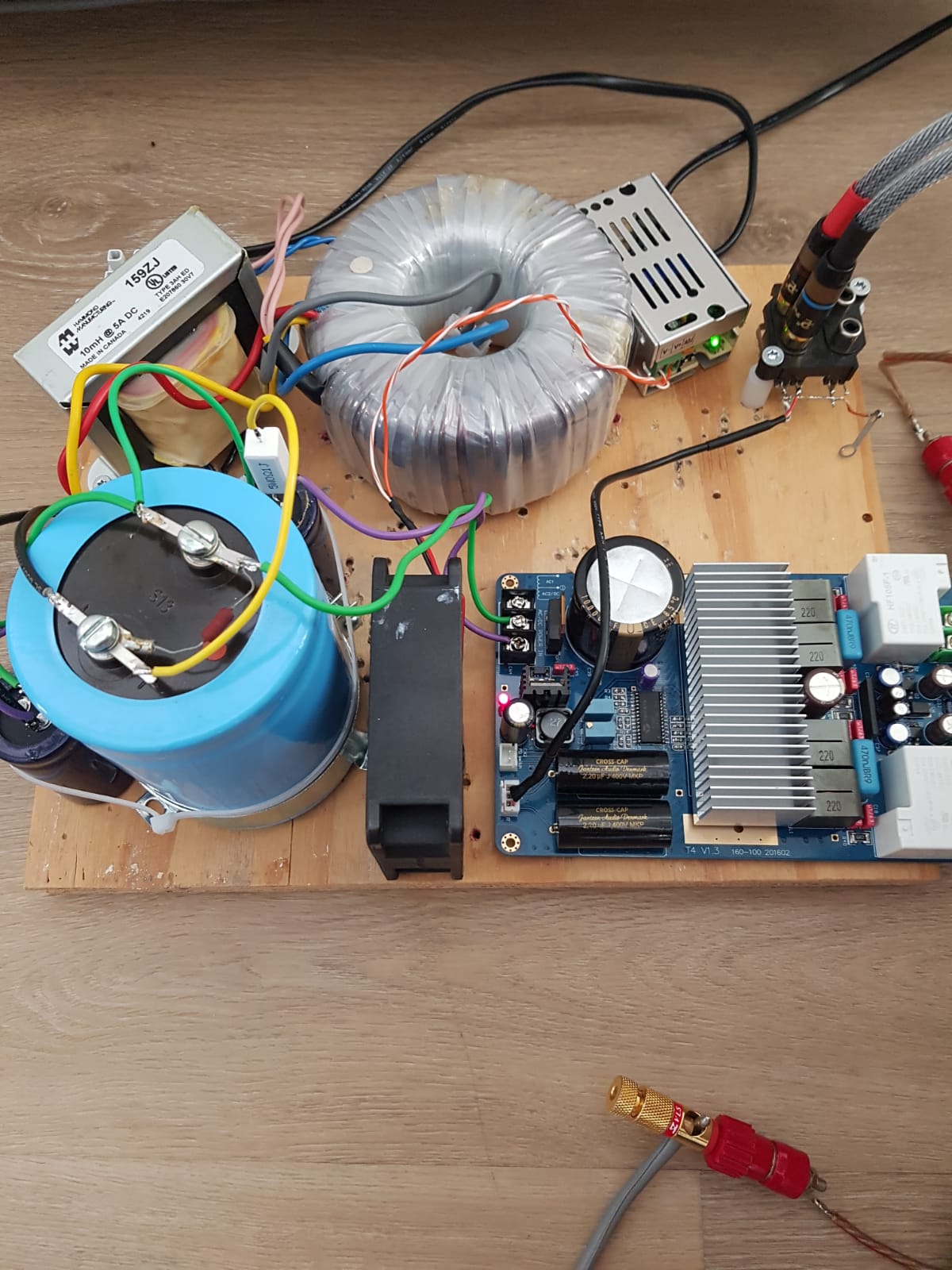

So I had the Hifimediy T4 laying around for a long time. After building a couple of Pass amps I was curious about the sq of this board.
I always first build an amp on a piece of wood before begin the struggle of building it inside a high end case.
Because I had the parts for a linear psu I first used one big capacitor after the rectifier. The sq was okay, not more than that. Today I made a CLCRC filter and fired it up. Now it’s a whole different amp. Sounding much better, more detailed, more open.
Not sure it will stay but for now I’m going to listen to it for a while. In the meantime I also ordered the 3e audio tpa3255 board so that’s going to be the next experiment.
