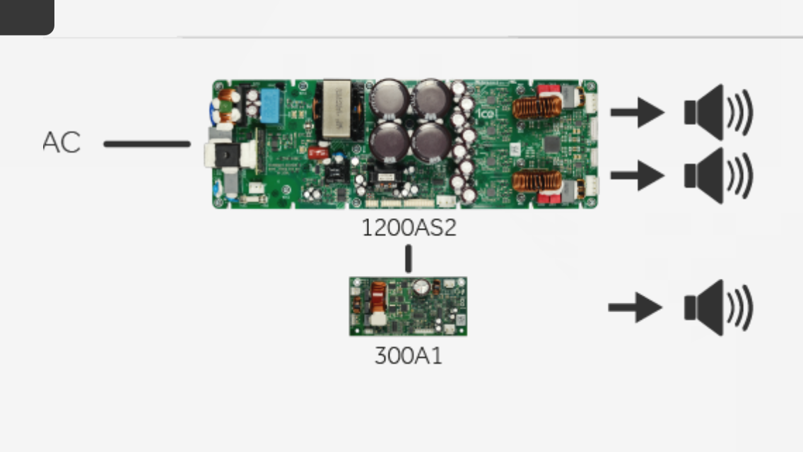

Ok, this will not work .. 300a1 has too low acceptable supply voltages (+-55v) - it cannot be directly connected to 1200 which has a rail +-65v.Hi

Have you noticed a sound difference between the 300A1 and the 1200AS2 since these are not using the same technology if I can say it that way (1200AS2 is IceEdge)

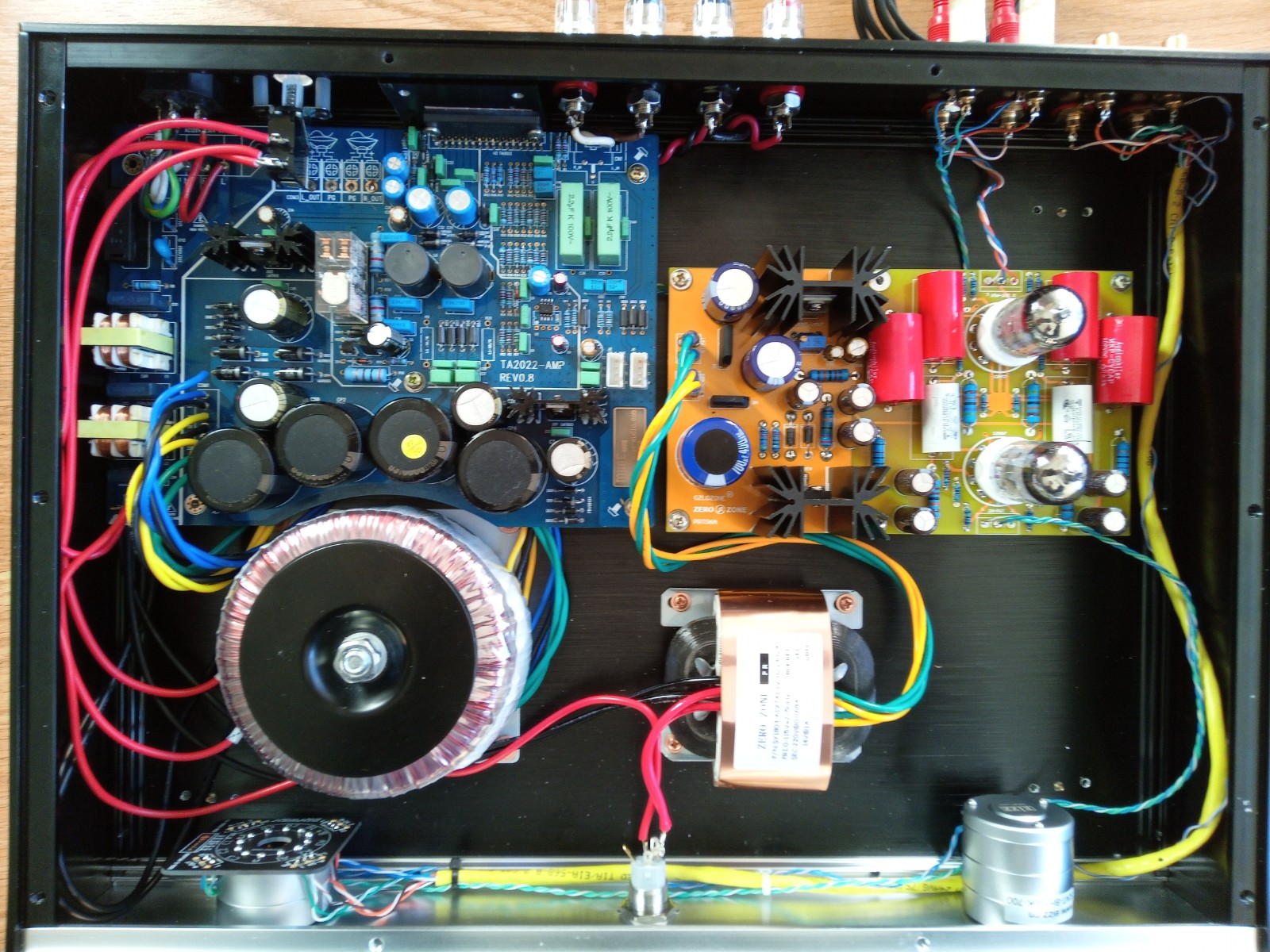

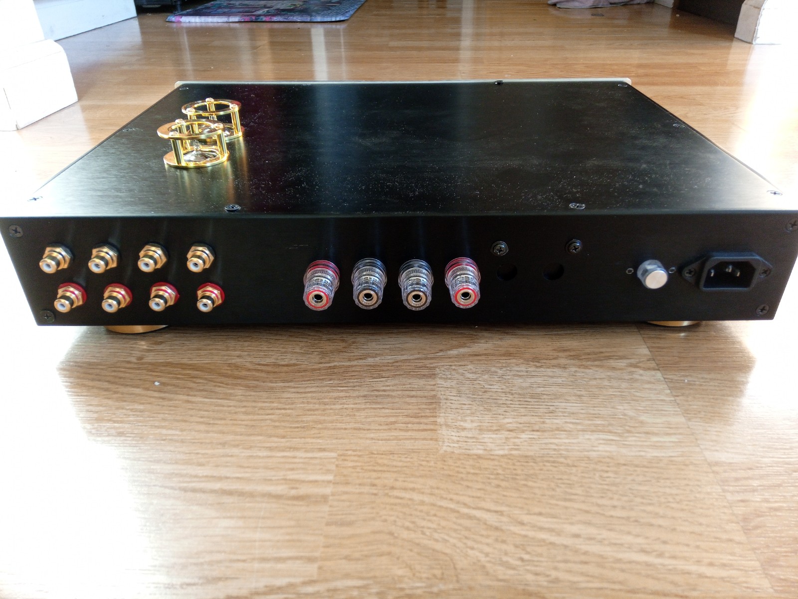

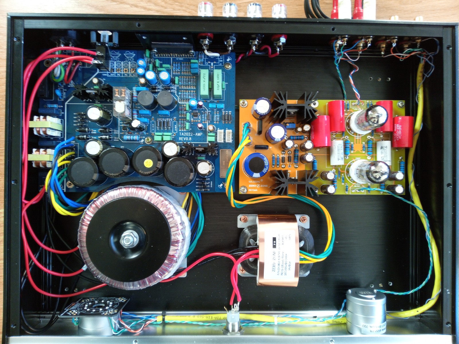

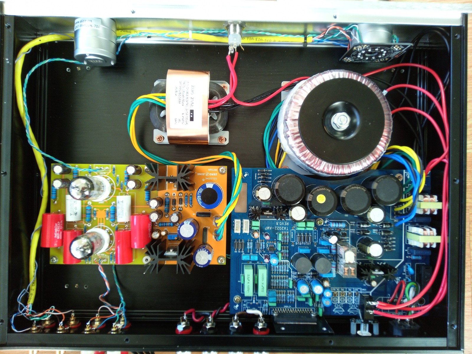

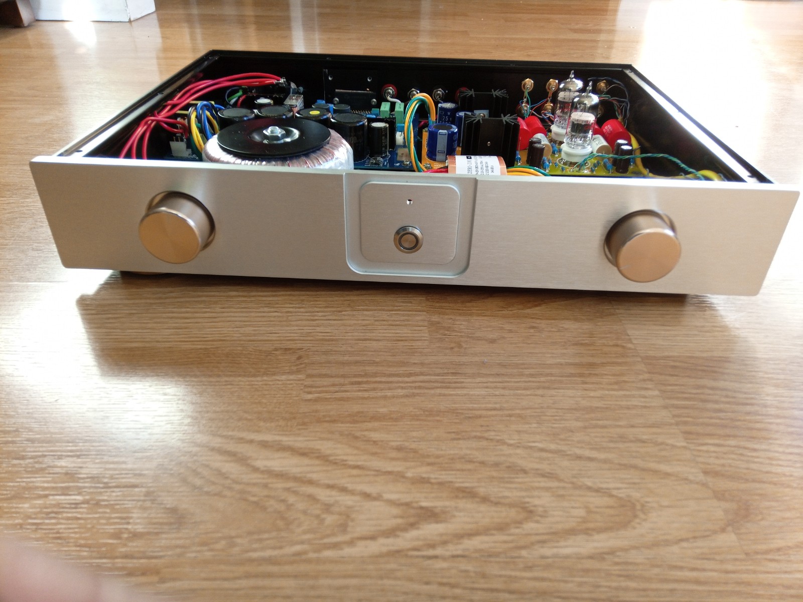

I'm a cheap diyer with less money and time to spend on this hobby. Usually buys PCBs and populate them. But for this one I bought completely populated boards
Long time back I bought TA2022 assembled board from Muse. It is really a great sounding amplifier, vocals resolution is really best compared to my other SS amps. Recently bought another tube preamplifier kit from eBay, Matisse PRT06A so want to build a flexible preamplifier/integrated amplifier. When I use it as a preamplifier I don't want to switch on the power amp section. So I used 2 power switches, front one for preamplifier and a rear one for power amplifier. Also have added pre-out and main-in RCA connectors to manually connect to external amp when use it as preamp or to internal amp for integrated amp. I thought of using a relay for this which connects internal amp when power amp is switched otherwise external. But to keep signal purity I decided to go with manual switching.
Volume control and selector switches are from AliExpress EIZZ brand. Looks very well built for the price.

Whole thing looks very well build.
Once I will need the additional channels, I will have to think about the amplifier's...
I would recommend getting in touch w IcePower since the recommend the 300A1 as a hanger amp for the 1200AS2. The same for a 3 way application, see below I did a copy/paste from their site.

Yes.. a based mine intention on that.. leter on a checked the datasheet...I would recommend getting in touch w IcePower since the recommend the 300A1 as a hanger amp for the 1200AS2. The same for a 3 way application, see below I did a copy/paste from their site.
