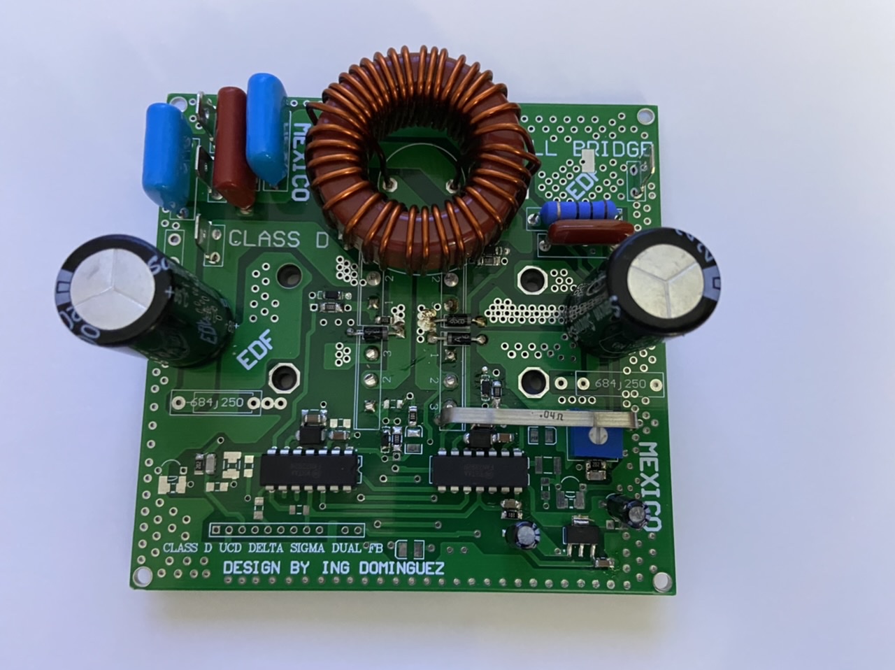

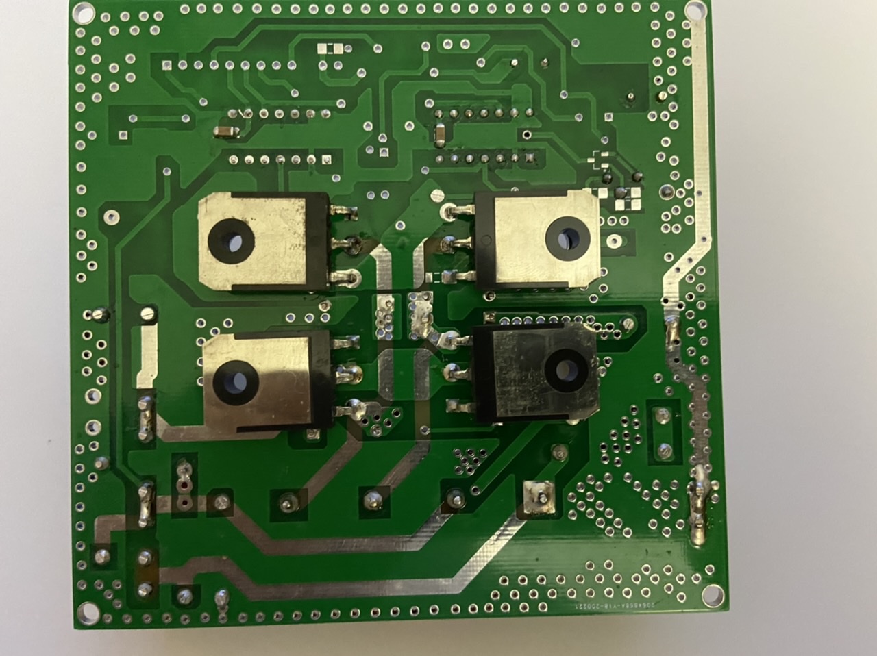

Full BRIDGE..... ucd , delta sigma or dual feedback vcc 40-140 volts single power
Very nice build redmx :up:
Is the coil T130-2?
Drivers IR2110?
Modulator not finished yet? .... guess it goes into the front as a daughter-board.
Have been thinking many times on making a motherboard for the switching part, and then using different types of modulator boards. Did it in one of my first builds ...
Don't see any snubbers?

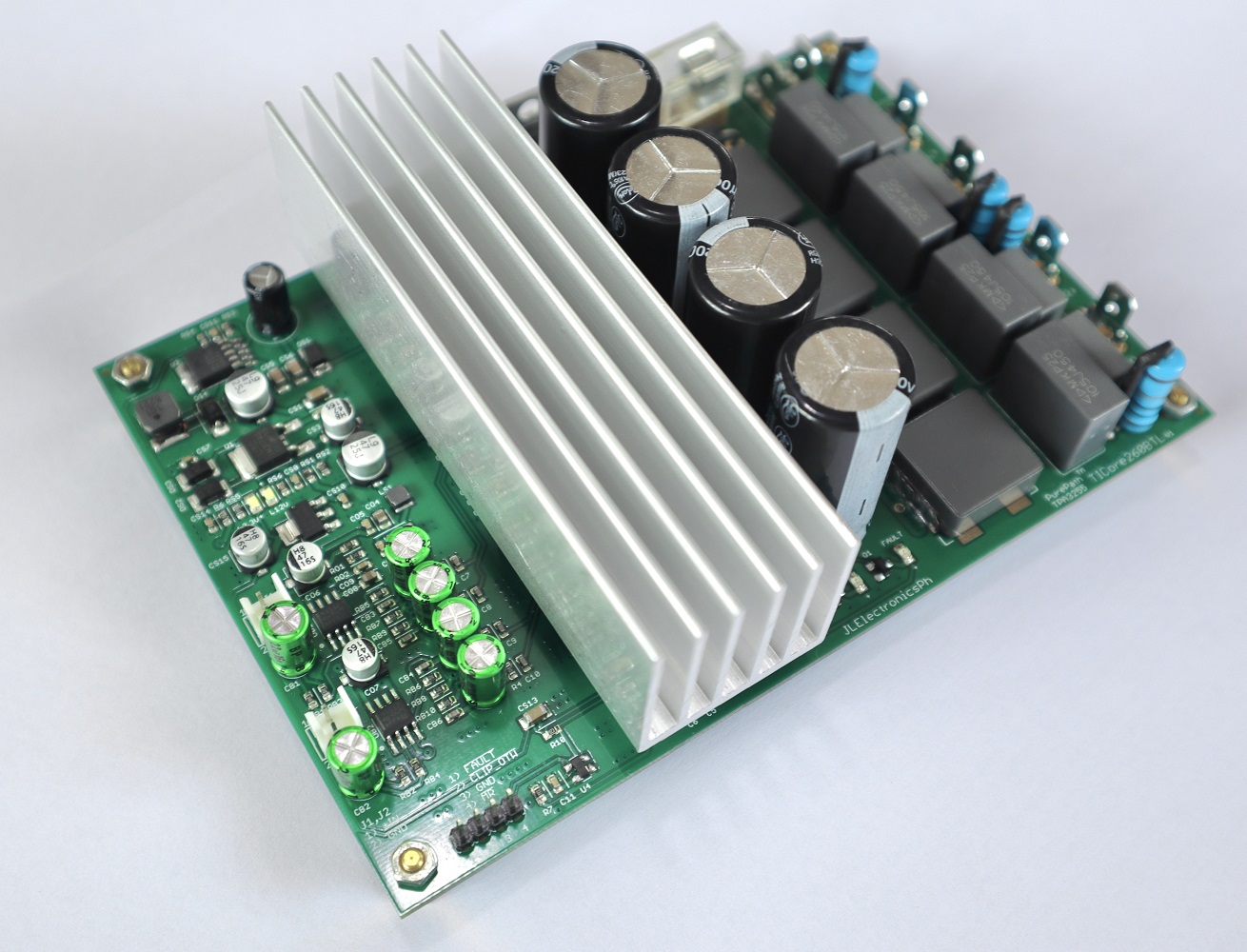

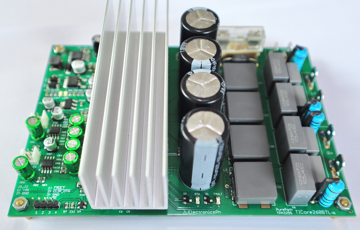

JLElectronicsPh TPA3255 Prototype
✅ Transient voltage protection (SCR + TVS + Fuse)
✅ Oversized Zobel Network
✅ Linear post regulator
✅ Voltage supervisor (no startup/shutdown pops)
✅ Nichicon muse input caps
Will upgrade to better output inductors and opamps to OPA1656 on production version.

Really nice :up:
Why the oversized Zobel? .... for a 300W amp I use only SMD ....
What are the coils?
Really nice :up:
What are the coils?
So that we can select larger value zobel capacitor which can improve open load stability of TPA3255, specially in PFFB configuration. I will add optional parts for PFFB in production version.
Also some people perceive difference in sound when using different capacitor on zobel network. Using oversized Zobel will give them more options in selecting parts to play with.
Coil's part number used in the picture is SRP1770C-100M. Will use Ice Components 1D17A / 1D23A in production version.

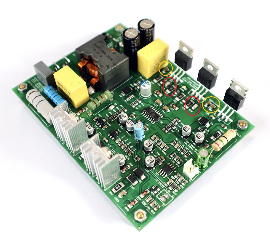

My new class-d amp based on IRS2092
IRCore350M
✅ +/- 25V to 65V DC Supply Voltage
✅ LDO voltage regs with 2 stage filter for +/-5V supplies
✅ PQ2617BHA-220K Low DCR, high Isat, output inductor
✅ IPP530N15N3 OptiMOS output mosfets
✅ Buffer opamp
✅ Open load instability protection

Hi JLesterP
That is a really good looking pcb :up:
Did you have any problems with thaming mosfet ringing with the OptiMos3 fets? Are you using any Snubbers or other measures to reduce ringning?
Really cool work
/Baldin
Thanks! Got no problem with IPP530N15N3, power supply is only up to 65V DC, osc freq only around 360kHz. Location of drain - source snubbers and bypass caps attached below.

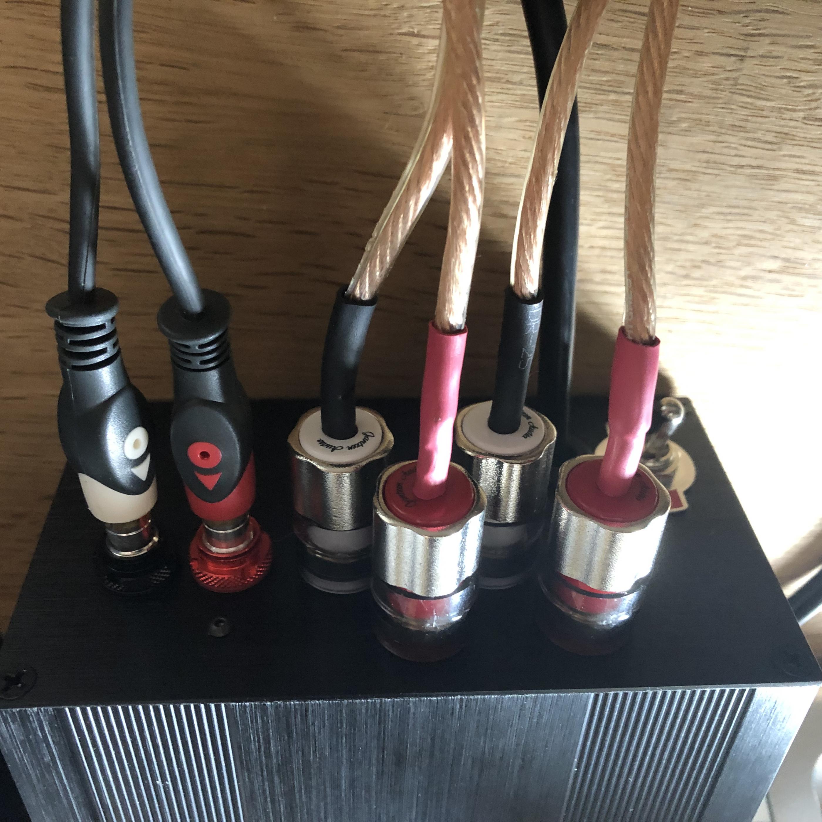

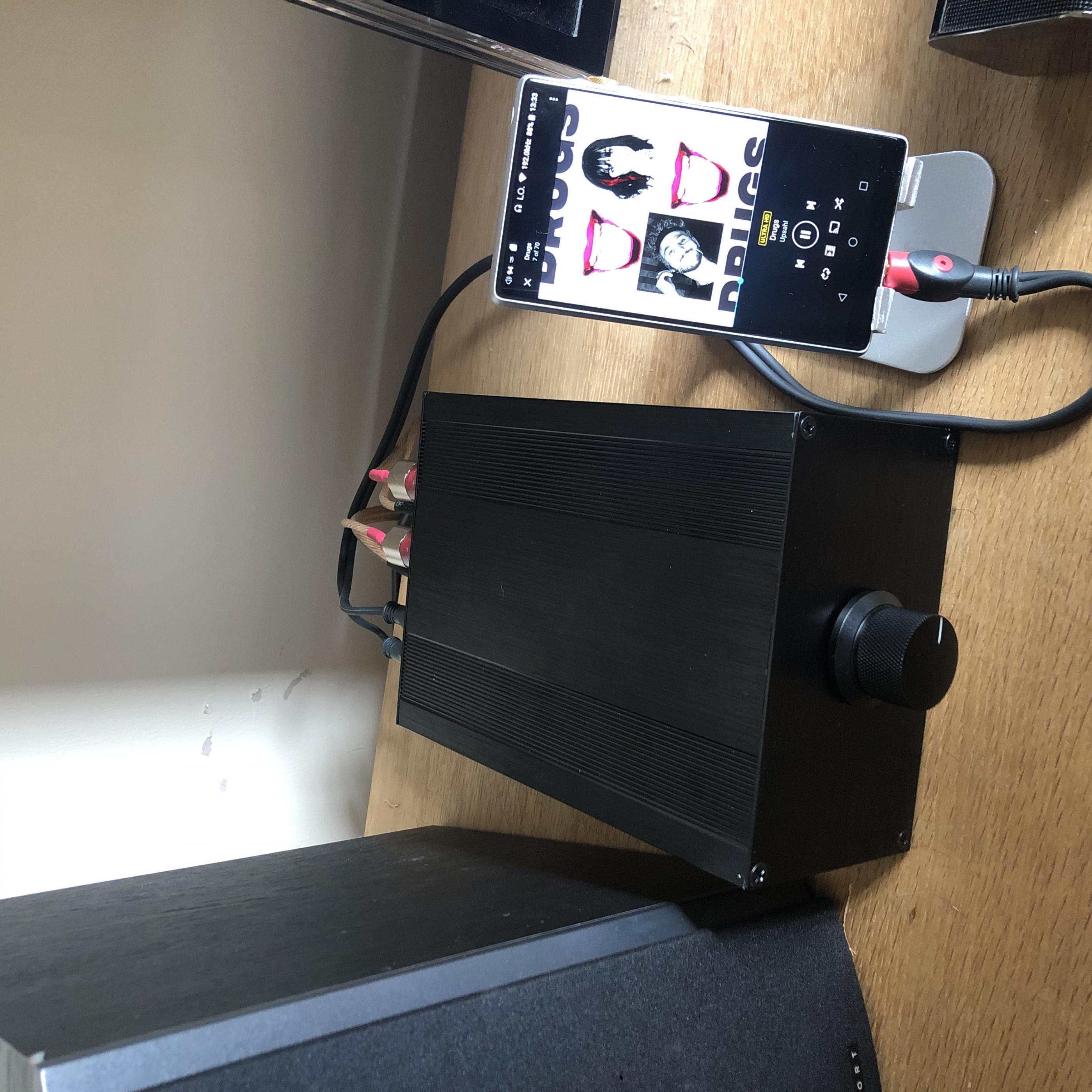

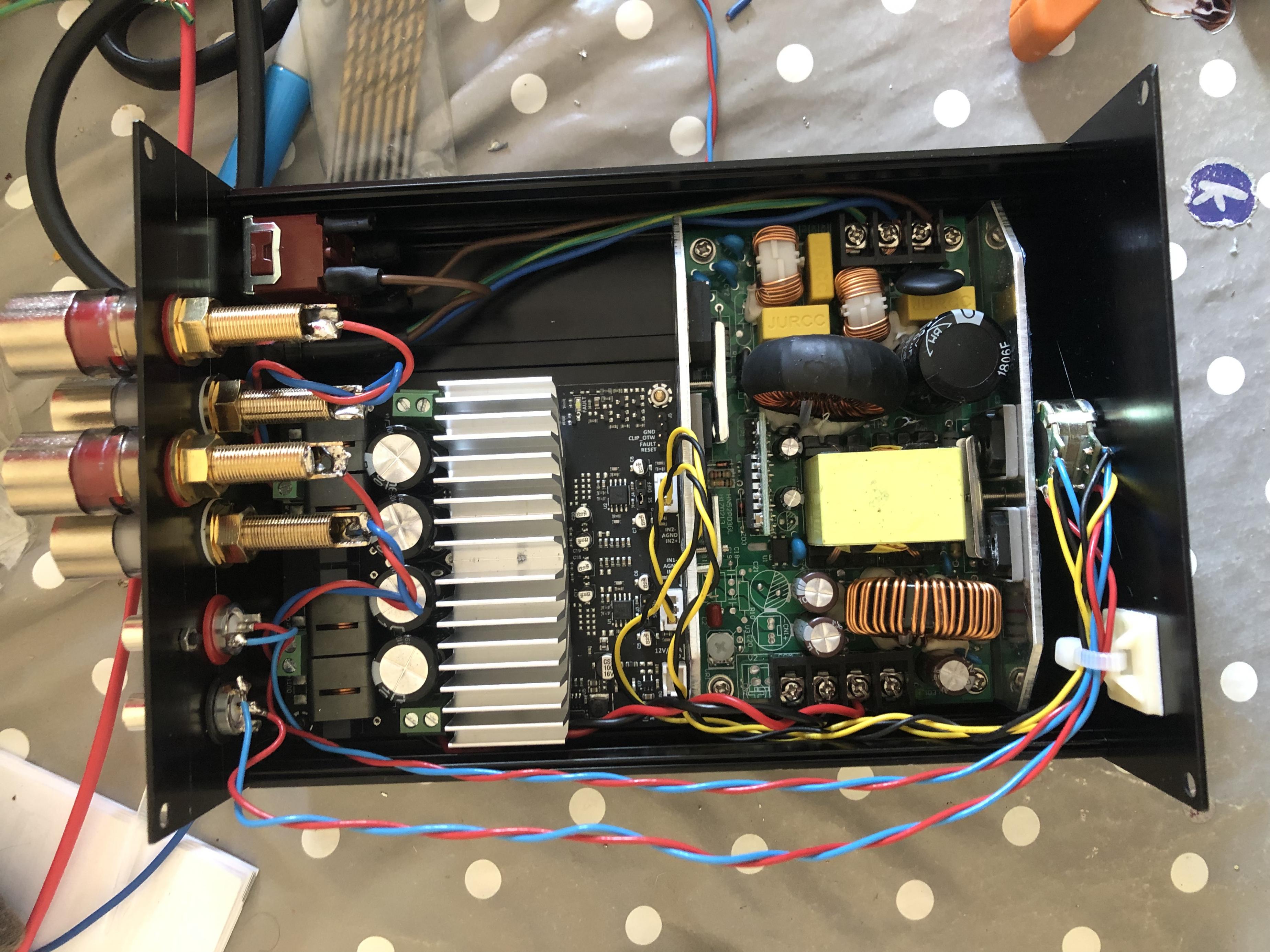

3eAUDIO TPA3255 WITH DOUK 400W SMPS
Here is my first attempt at making an amp. The sound quality is excellent. I was sent the 24v smps instead of the 48v so I am still waiting for the replacement. I will be putting a wooden front on it to make it a bit prettier. It looks like a cheap eBay amp it the moment. I am very happy with the almost finished result.

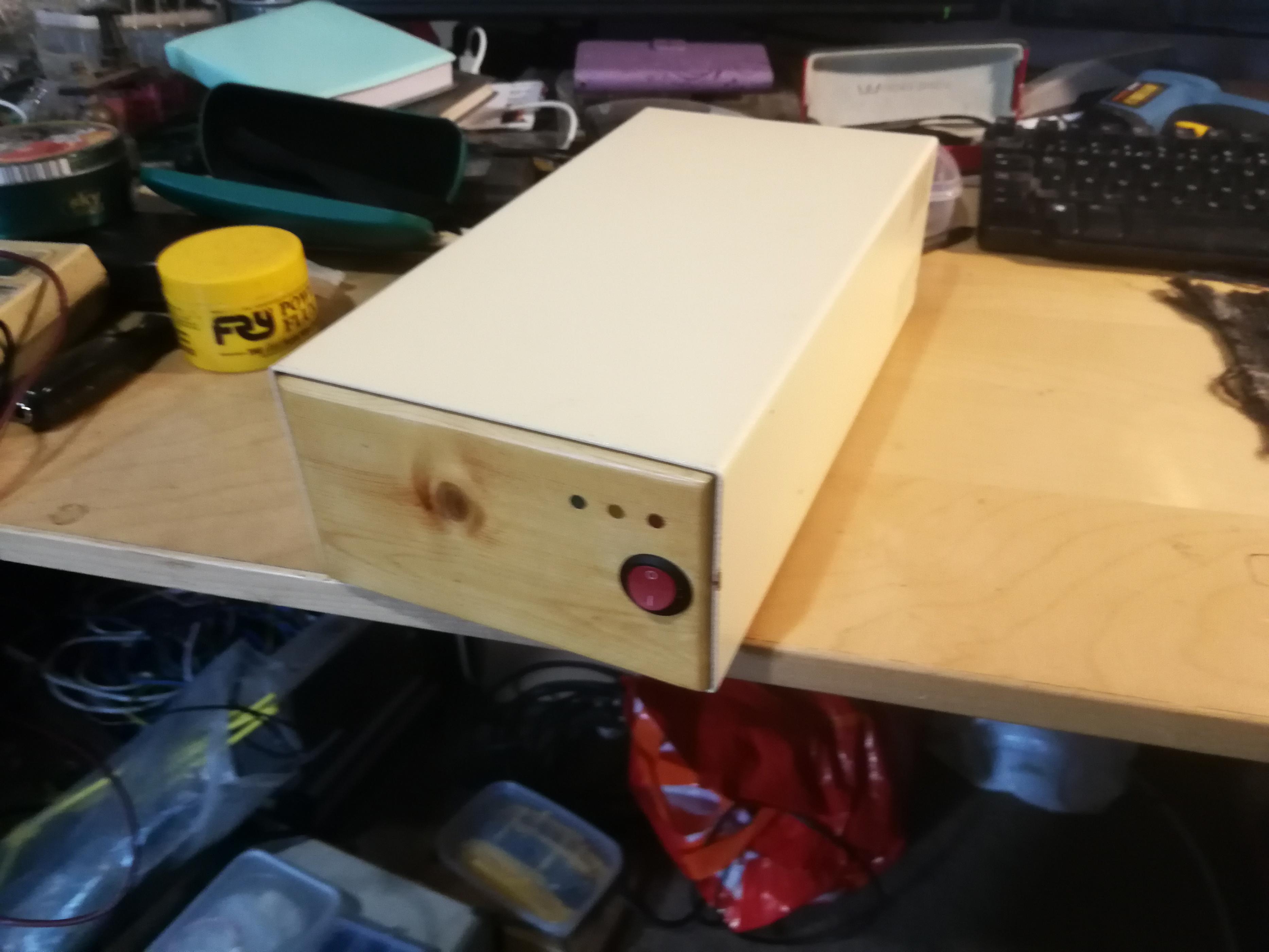

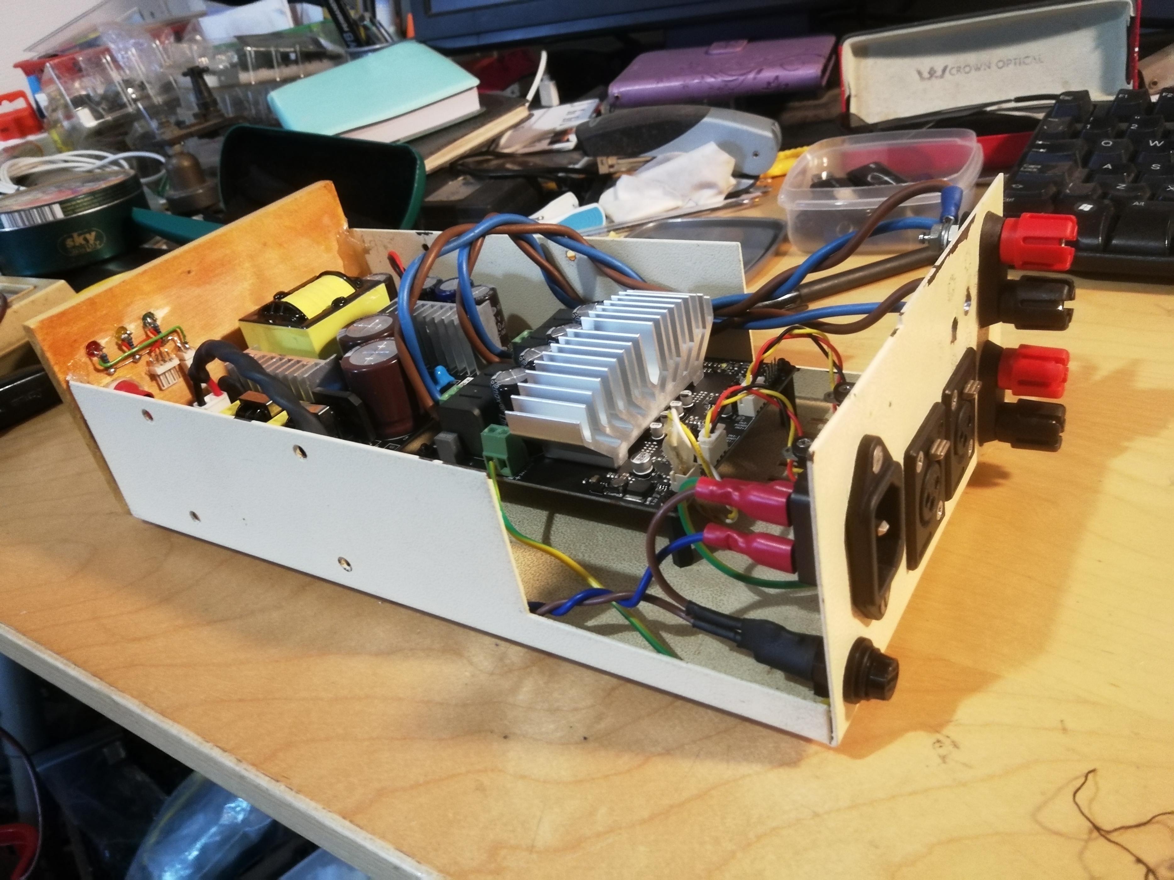

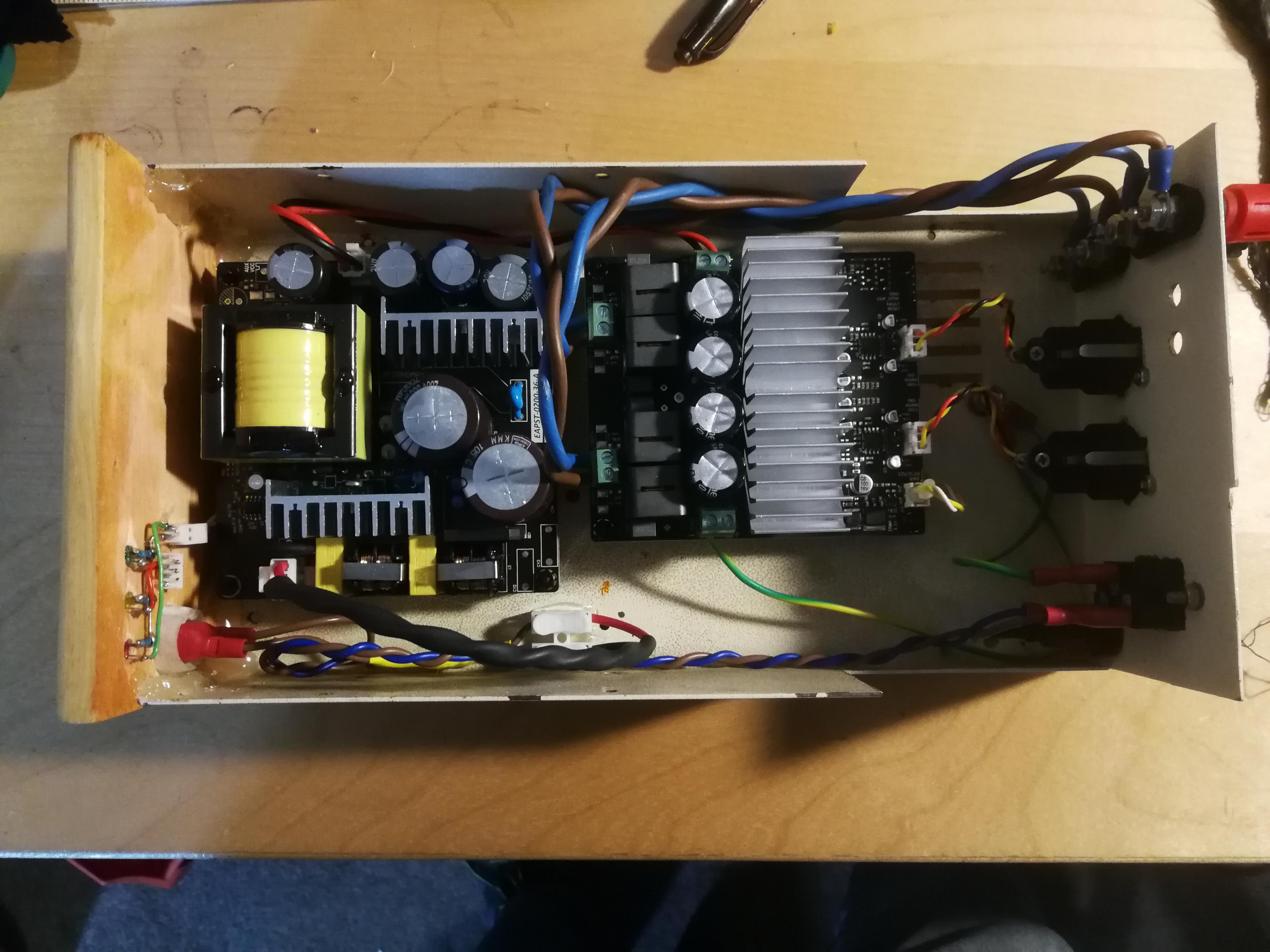

2nd class D amp
This is my 2nd class D amp, I used an old computer CD case and wood from an old shelf, works really well so far.
Tidy amp mate, it’s a little more complex than my one. Is it a 51 or 55? What smps is that? Are you using the 12v aux for an LED or something more? If it is just for an LED could you tell me what I would need to put a power light in my amp?
Sorry about all the questions.
So far sound is good, hard to compare since it is working with new balanced pre-amp as well, and rewired LP12 deck Balanced too. So AB test not easy, like it a lot at the moment.
It is the 55 with the "3e audio" 48 volt PSU I got from EBay, was going to wire up the front leds to fault and clip, but not done that yet. used the 12v on board for power on led.
