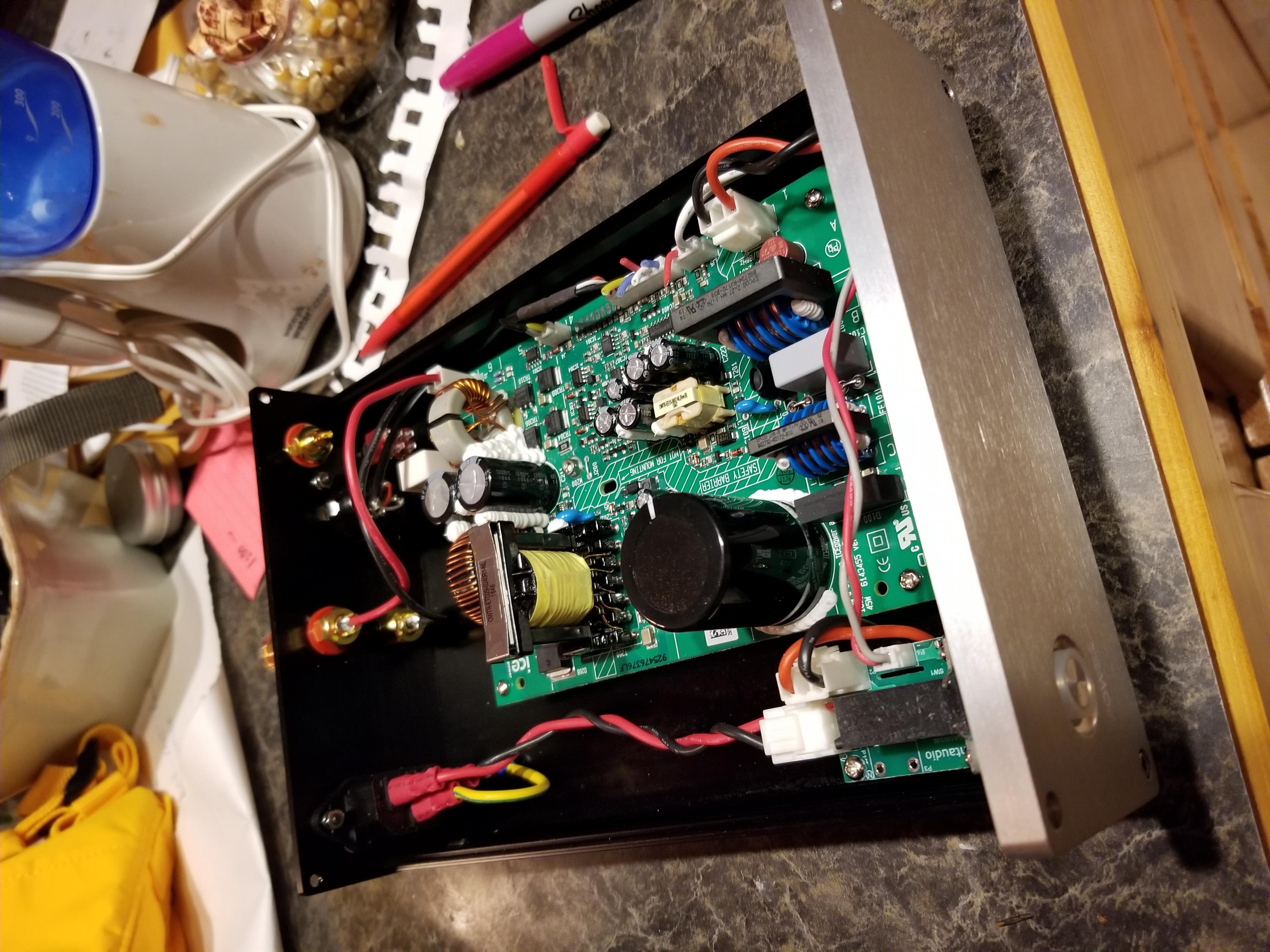

Icepower 200asc monos (board version L)
Here is the first amp. I haven't received the second case from Ghent yet even though I ordered them at the same time...
Decided to forgo the switch and RCA input, as I don't need them.

Very nice work, congratulations!!
May I suggest you don’t cut the unused wire, you might need them eventually (ex +/- 12v supply output)

Thanks, Eric. Yeah; I probably shouldn't have cut them, but I usually don't tinker (too much) with stuff once its built...
The Ghent cases are nice, I just hope the second one shows up sometime so that I can listen to them, LOL...

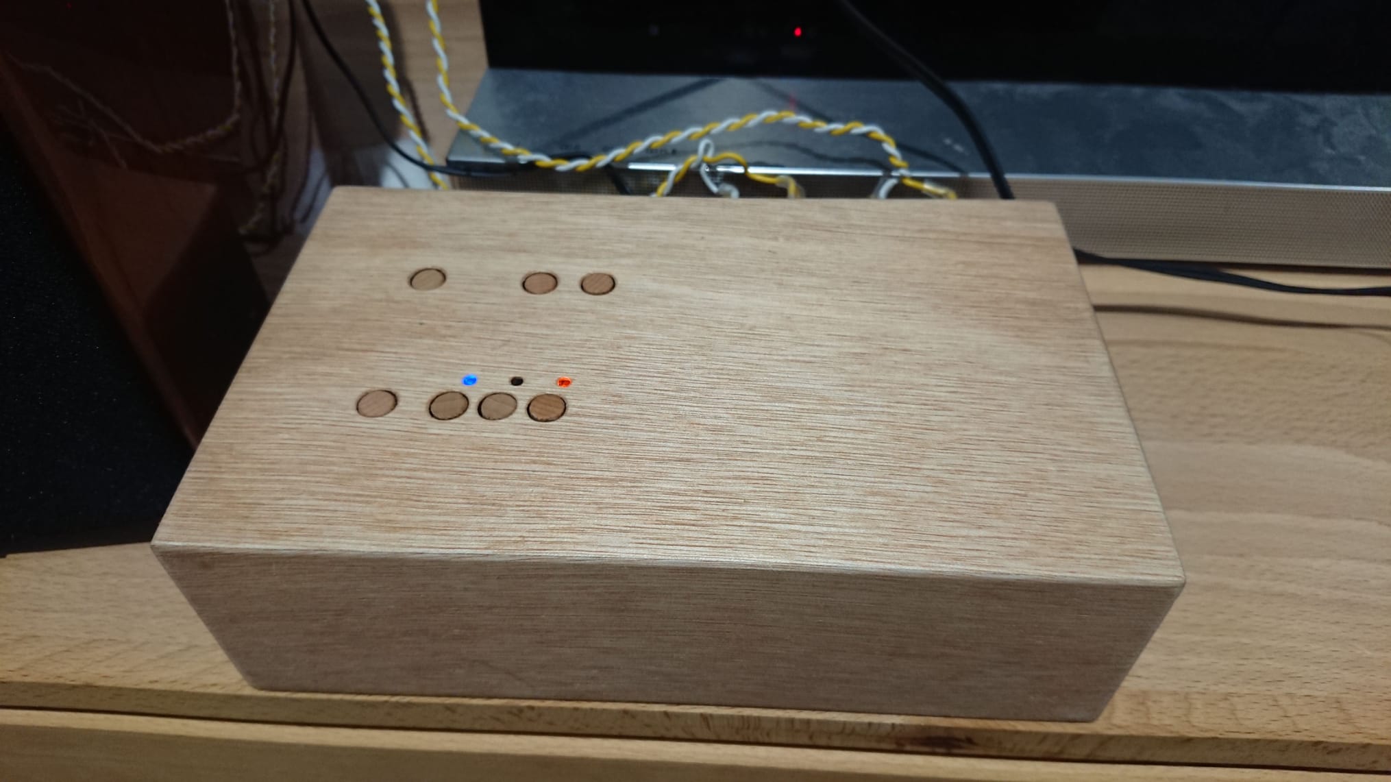

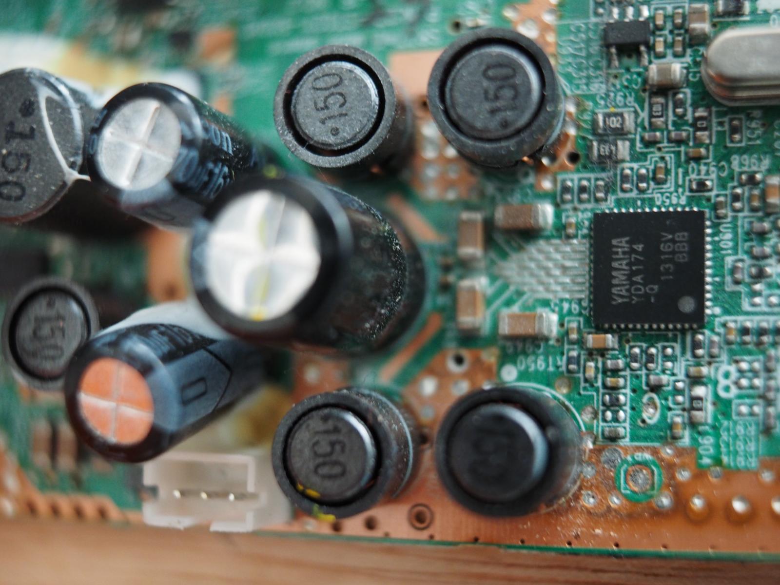

Yesterday I just finished the case of my little bluetooth amp.
Its the electronical part on an Sony SRS-BTX300. So it has bluetooth standby fir only 0.1W power consumption and a 2x10W Yamaha YDA174 chip. Sound really good on my Canton Vento 820.2

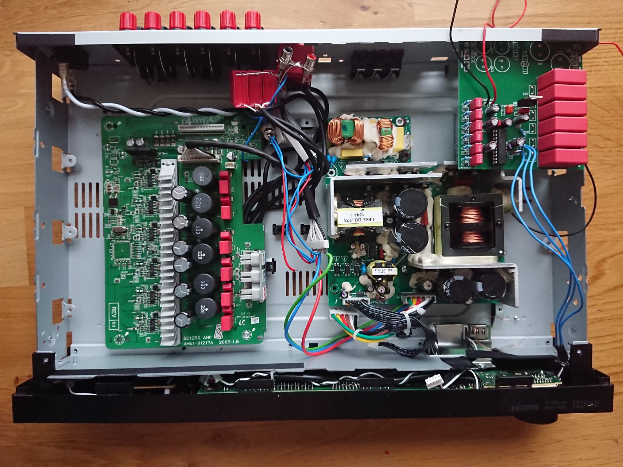

6 channel IRS2092 with 36V power supply and PT2325 volume control.
Amp will be feeded by Teufel DecoderStation 5.
I will put some relay for bypassing volume controle on-demand like Yamaha Pure Direct.
Amp is based on IRAUDAMP5 with IRF6645 mosfets.
I will put some additional capacitor later.
Power supply looks to be enought for powering this amp easily :-D

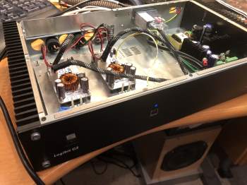

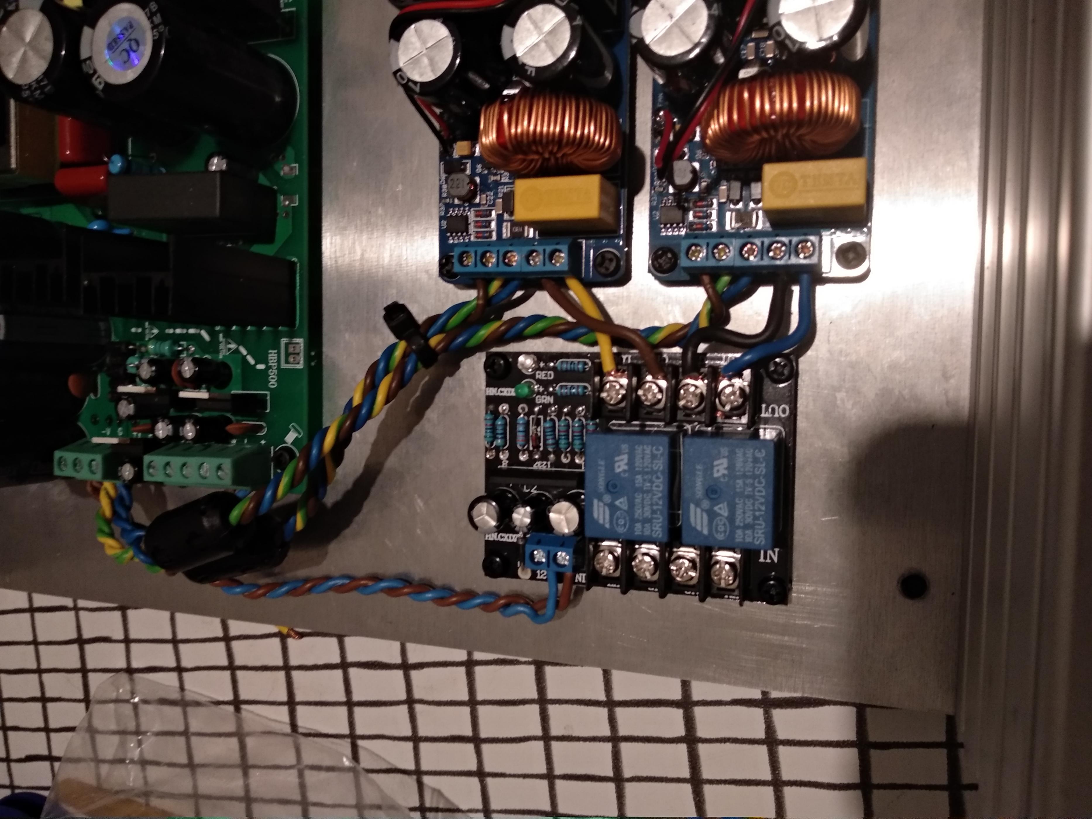

Still very much a work in progress. 2x IRS2092s and a - /+ 65v power supply. There is also a speaker protection board. I've been thinking of changing all the wiring to a suitable gauge solid core wire. This way I can do the wiring much more tidy then what it is now.
The enclosure is laser cut aluminium and extruded profiles for the sides.
I've noticed that at the speaker protection module the negatives of the audio signal have continuity to ground. Is this common practice? Should I ground this module through the standoffs to the chassis, or should I keep it floating?

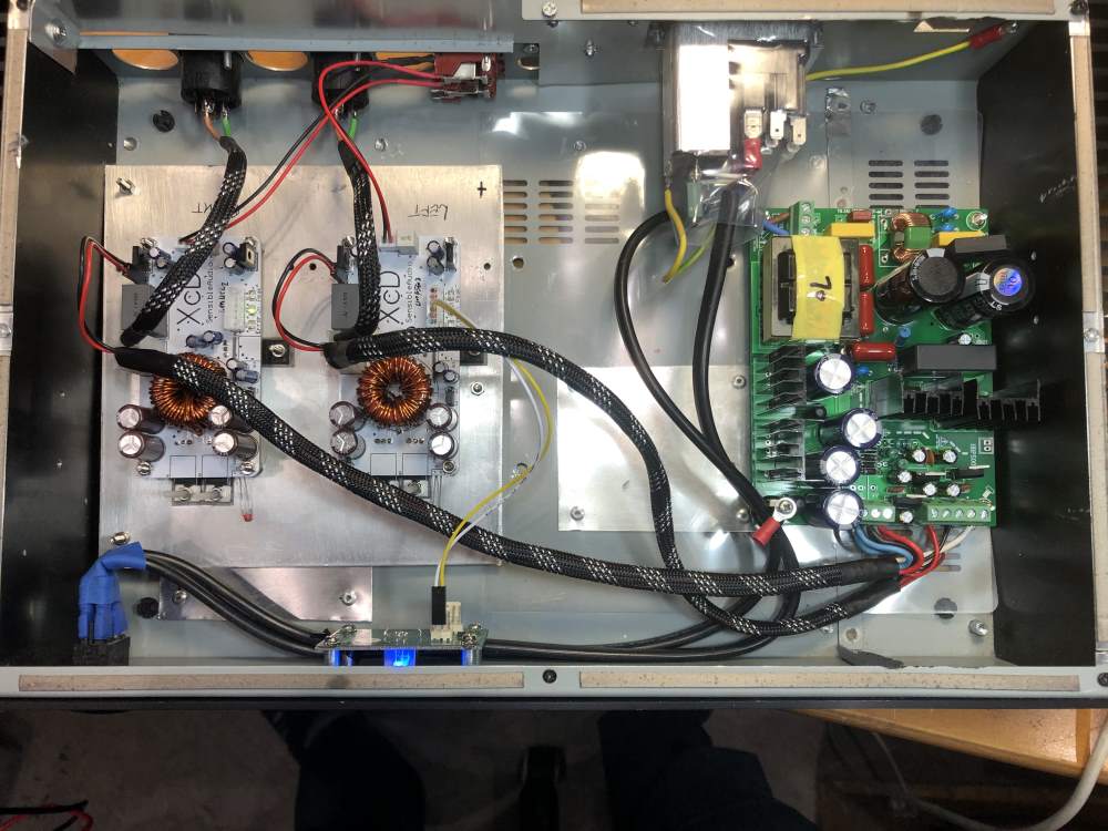

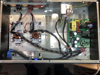

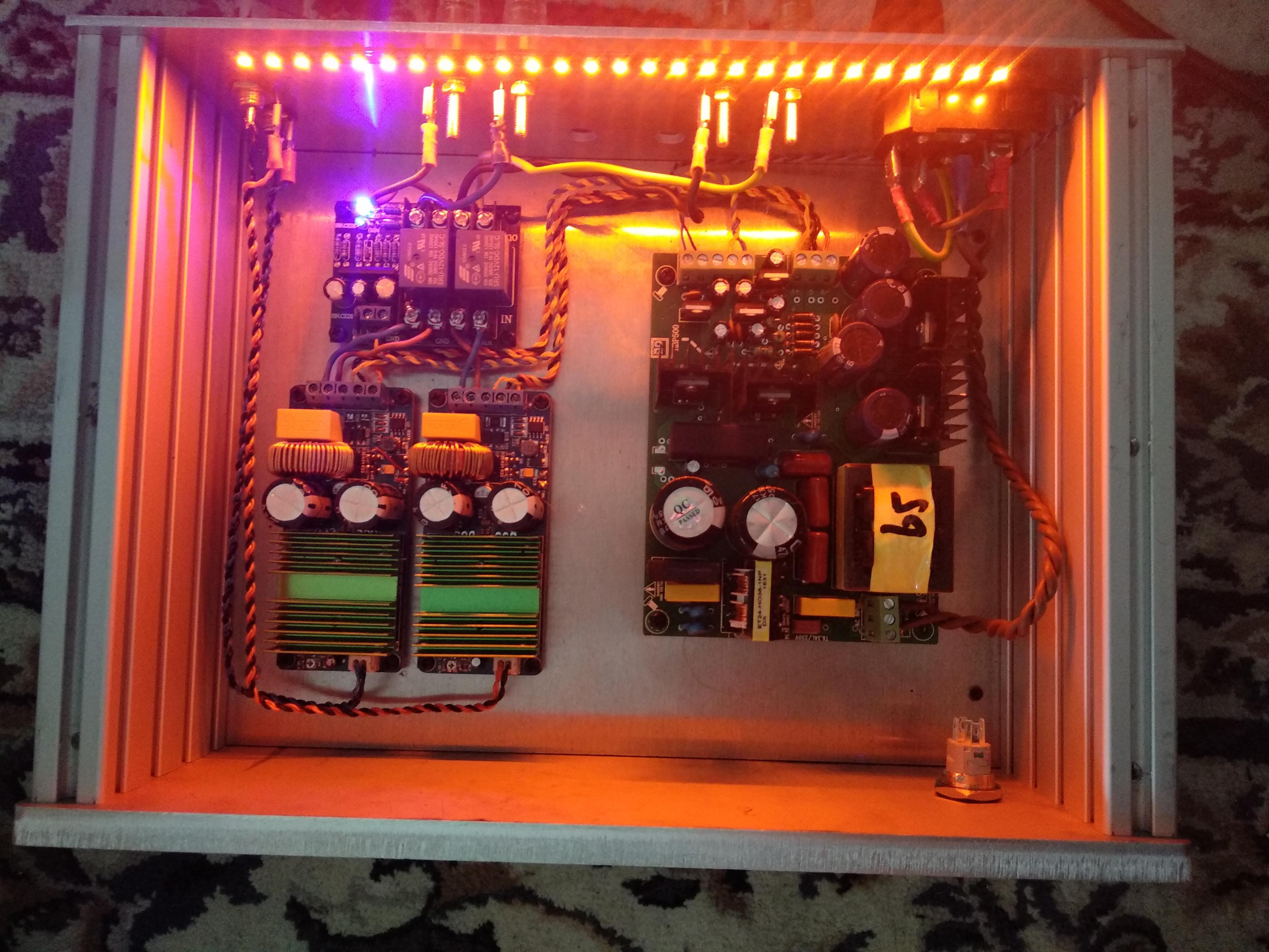

Here it is my amplifier with 2x IRS2092S and 500W +/- power supply. It has a speaker protection module that is powered by the 0 - 15v output of the power supply.
I took off the fans from the amp modules because they were noisy. I have noticed the heat sinks run pretty hot. I am looking for a bigger heat sink that connects both modules and is bolted into the chassis somehow. Either that or running heat pipes from the heat sinks to the chassis. Recommendations are welcome

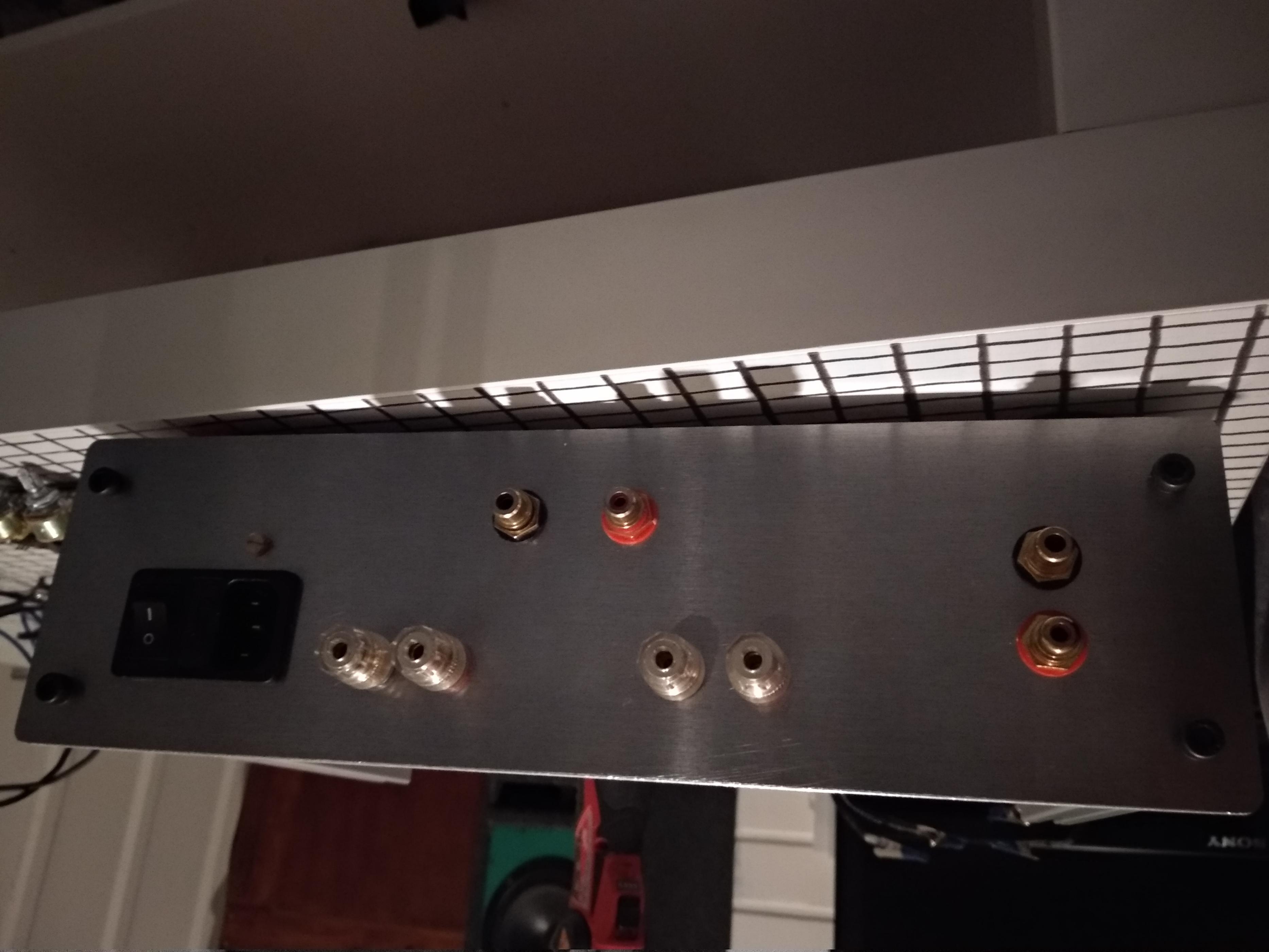

The case is laser cut aluminium with extruded aluminium sides.
The front panel switch is not connected yet. I have my doubts using this switch for mains power is a good idea. It also features an illuminated ring that is powered by 12v, and the connections run very close together. I was hoping to use this switch to switch some kind of relay that turns on the power to the psu. But have not figured out the best way to do this.
I also plan to add a 12v trigger input system so the amp turns on when the preamp turns on(a preamp and DAC In one enclosure will be a future project.
I will also use the 12vdc output of the psu to make a 12v trigger output that can turn on the subwoofer amplifier

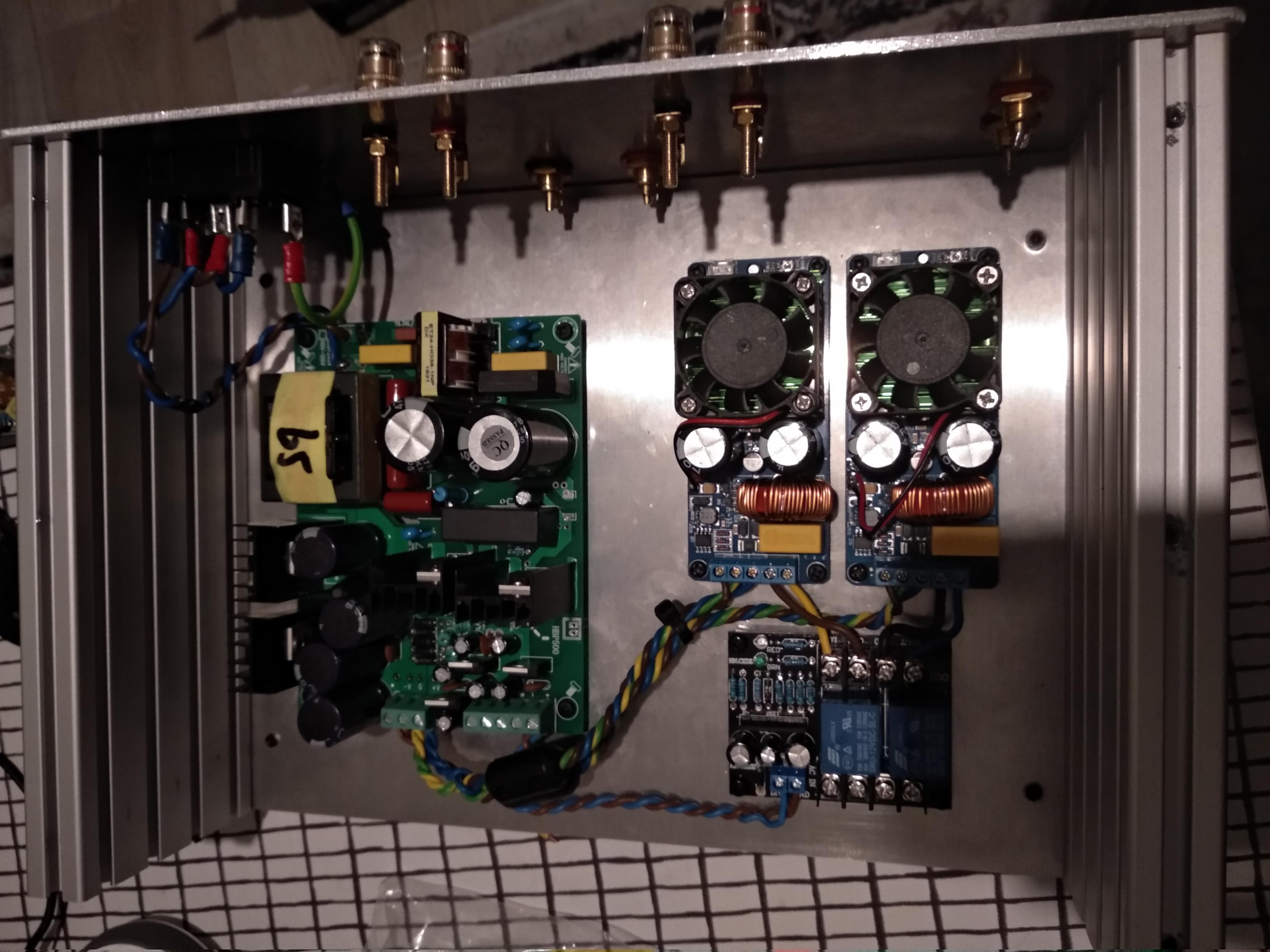

Hi Hofmann,
Those heatsinks on the amplifier modules are very small, even with these high efficiency amplifier modules, they are bound to get hot at sustained high output levels - this is why the fans were fitted in the first place. If I were you, I would re-arrange the chassis and mount the amplifier modules on either side of the chassis - remove the small amplifier heatsinks and use ~3mm or thicker aluminium Angle brackets to mount the amplifiers to the extruded side panels. Ensure that the bracket contacting area is flat (sanding with fine sandpaper) and also use some heat-conducting paste between the amp module and the bracket. The side panels should have sufficient area and not require fans for cooling.
This way you should have a quiet and cool running amplifier.

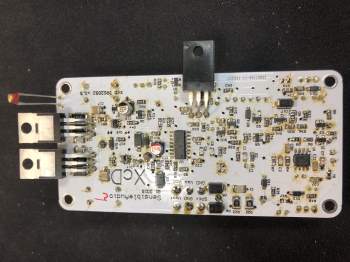

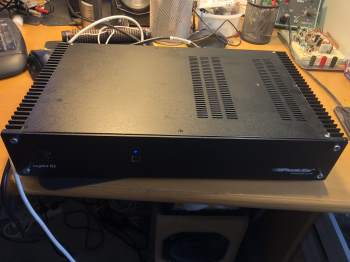

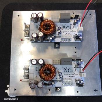

My XcD ver 3.5 ca. 2 x 300W @ 8 ohm
Latest amp. Would say I'm horning in on this class-d thing.
LM4562, IRS2092S, ZXGD3003E6, IRFB5620, T106-2 @22uH, Ø1mm, 1uF, dual fb / pre + post-filter fb. F switch = 380 kHz.
+-70 Vdc (500W SMPS from eBay)
Running really cool. Coil less than 40deg C @ 20 deg C ambient temp. No heat from Fets. @ Idle of course 🙂
Used an old AMP as enclosure (got a few scraped ones from my previous workplace).
Ready for installment in my main system. And at some point I'll try to do some measurements.

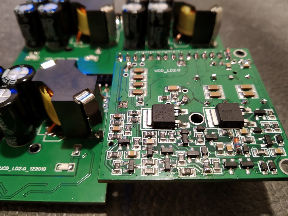

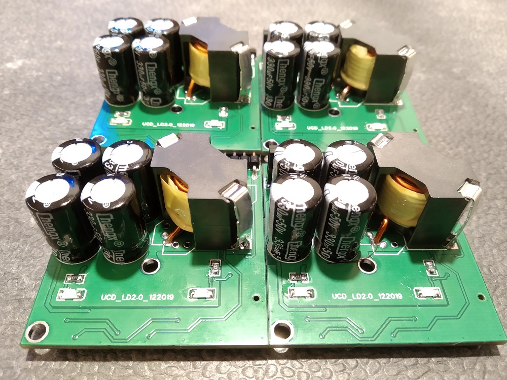

small discrete UCD
Hello,
My version of self-oscillating UCD amp, based on Philips / Putzeys patent.
Works from +-20V up to +-40V with switching freq. at ca 310Khz.
Idle consumption is ca 1W at 35V supply,
and no audible noise at the speaker 🙂
I will use 4 of them in my 2 nearfield monitors controlled by an ADAU1701
driving a 80W woofer and 15W tweeter, so no further cooling is requiered.
The first prototype, and the final version: 😉
