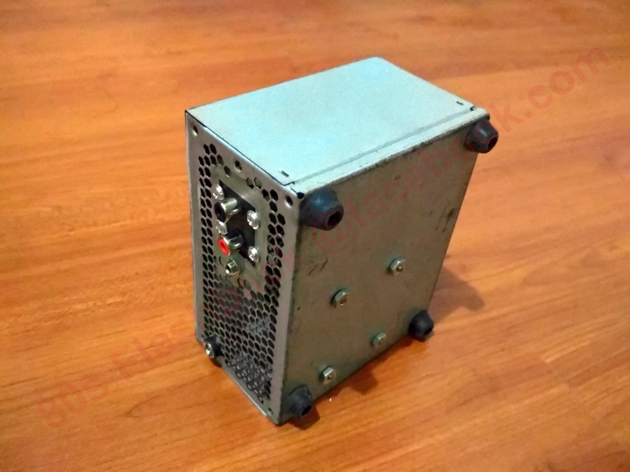

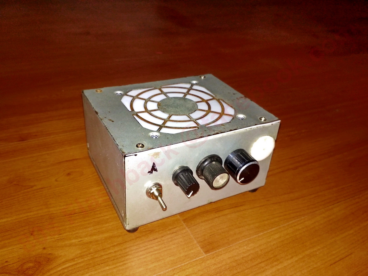

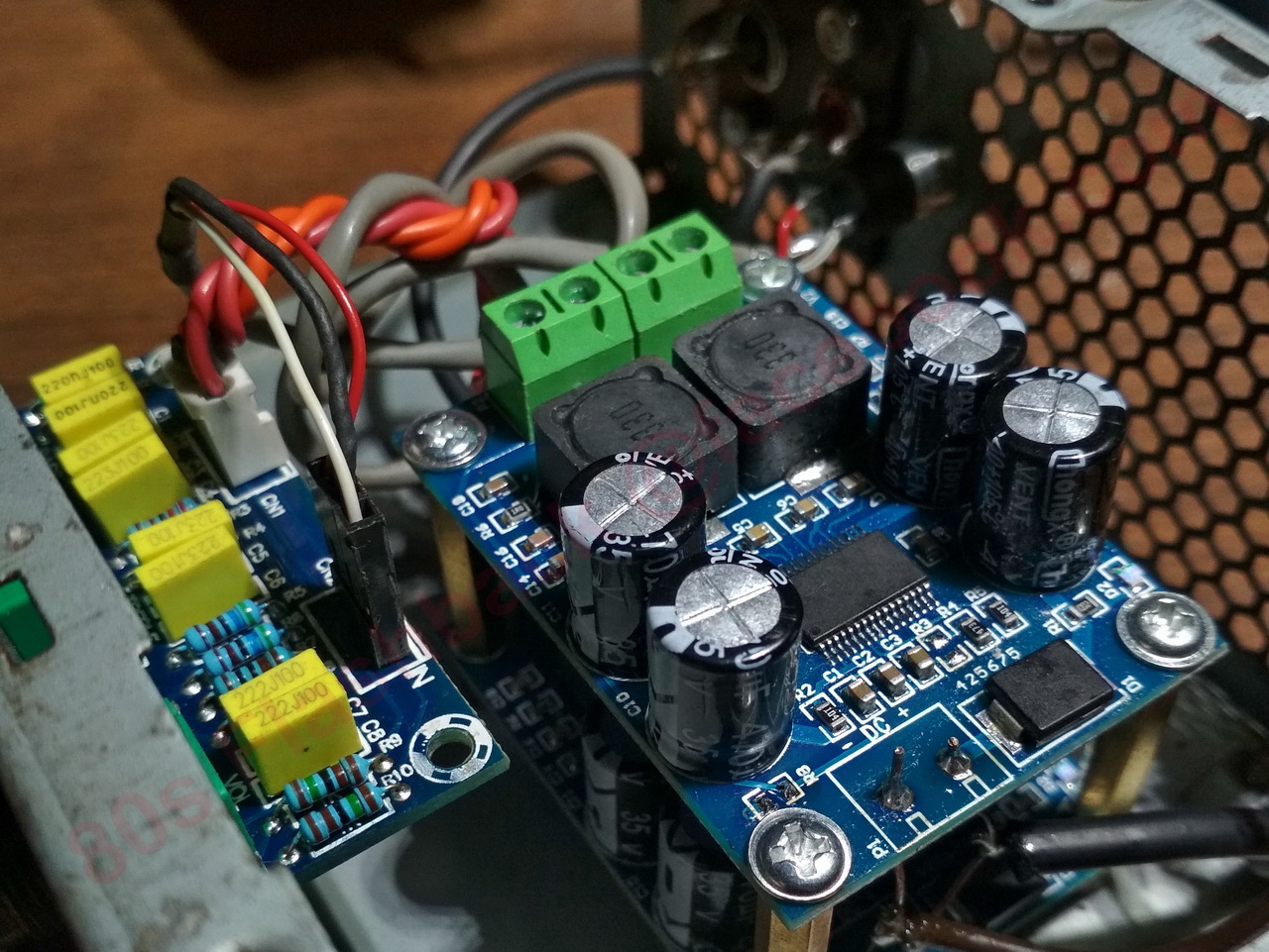

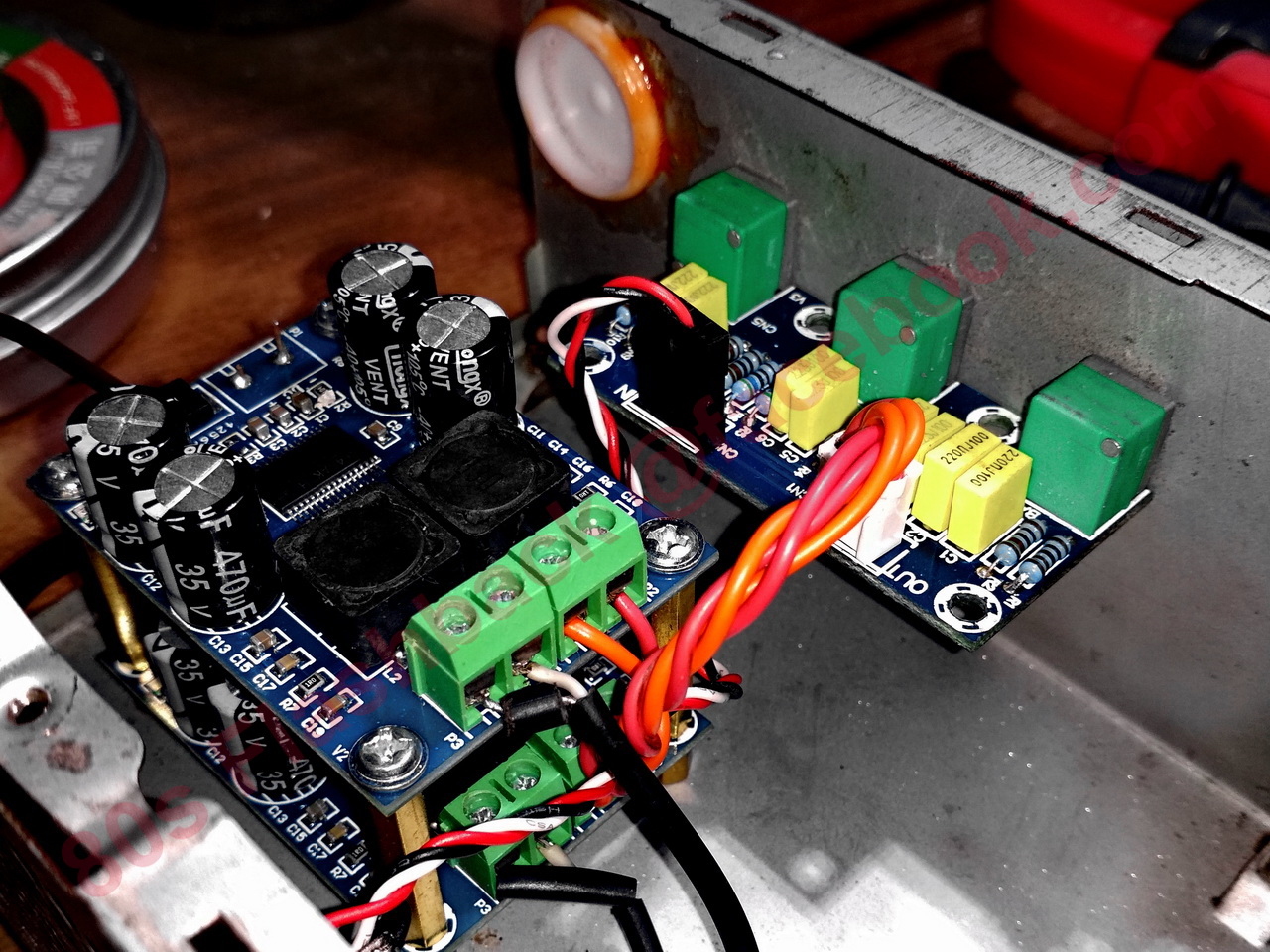

This is a sleeper build of a pair of HX-M311 with passive tone controls, stuffed in a discarded SFX PSU case (125x100x64mm). The board is configured with 36dB which cause some hiss which can be heard a meter away. The main draw of this model is that the capacitors can be easily replaced. The only difference between this and the more popular 3118 mono board is the slight bump between 100~300hz. Although not as great as, say LM1875, this chip can provide high quality sound without making a dent in the electric bill.
Mods were very minimal; 1. removal of terminal block for power 2. lowering gain to 20dB (60kΩ input impedance) thru removal of 75kΩ resistor at GVDD
Only the boards and stand offs were new and the rest are from my old parts bin so don't mind the bottle cap and ice cream tub cover

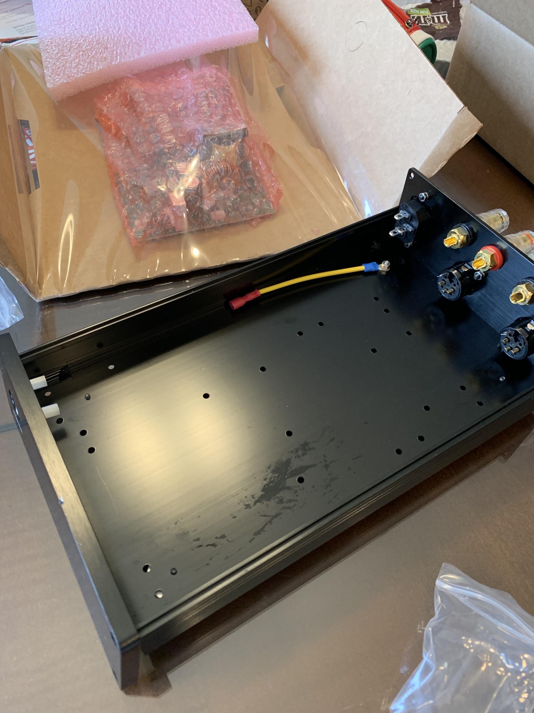

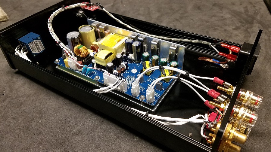

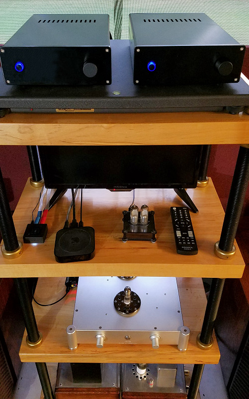

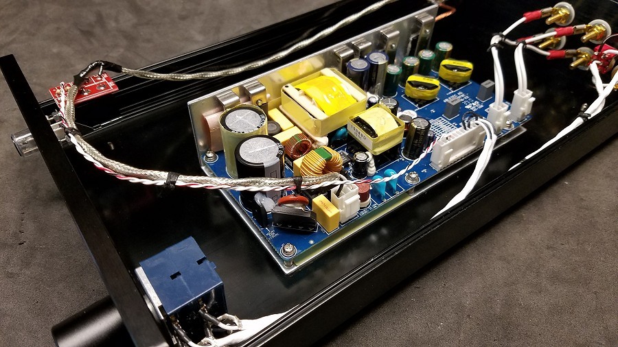

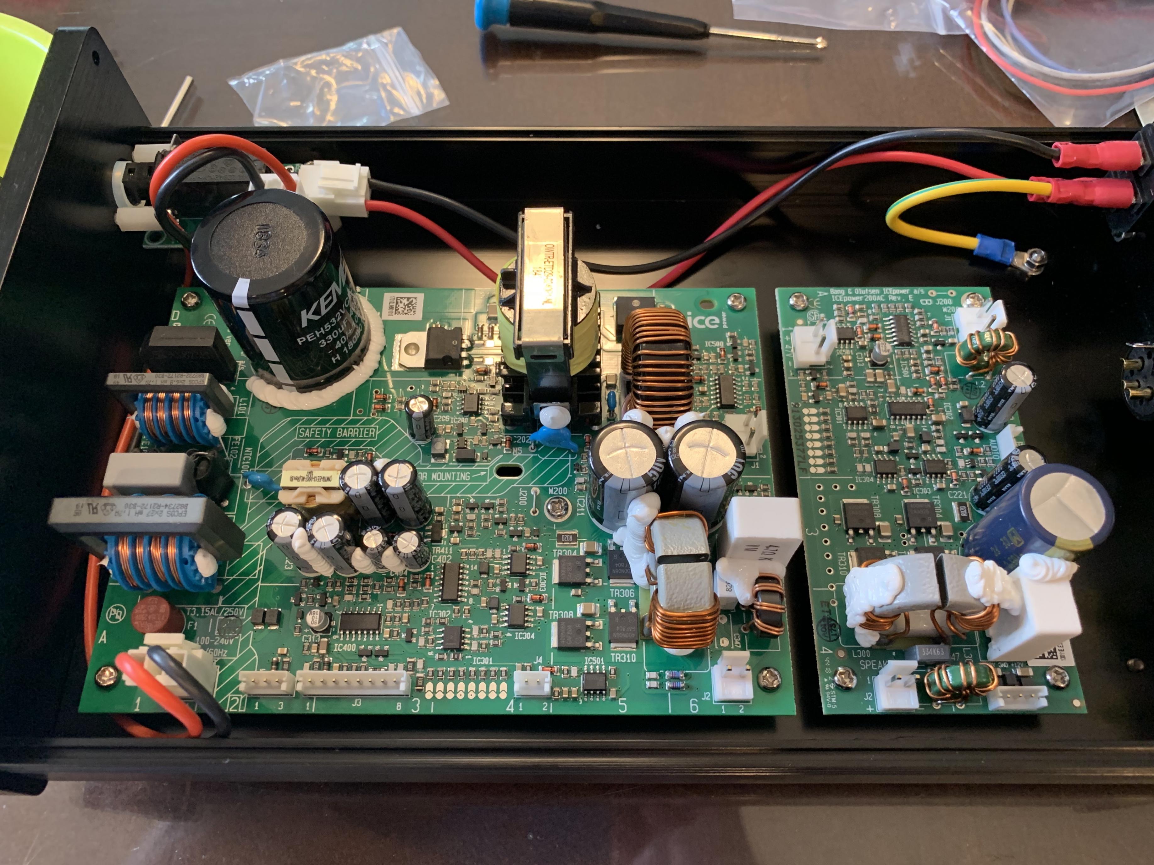

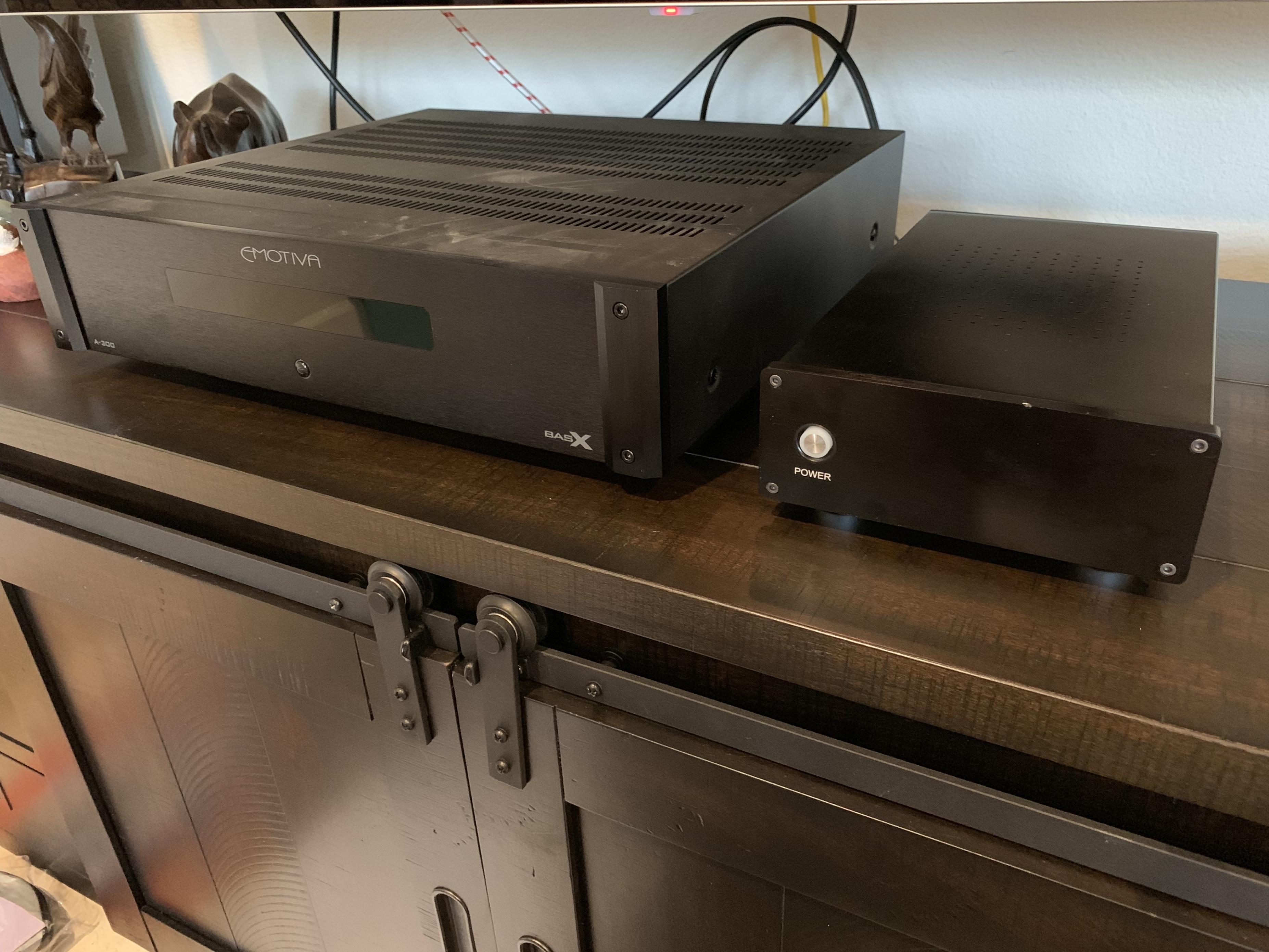

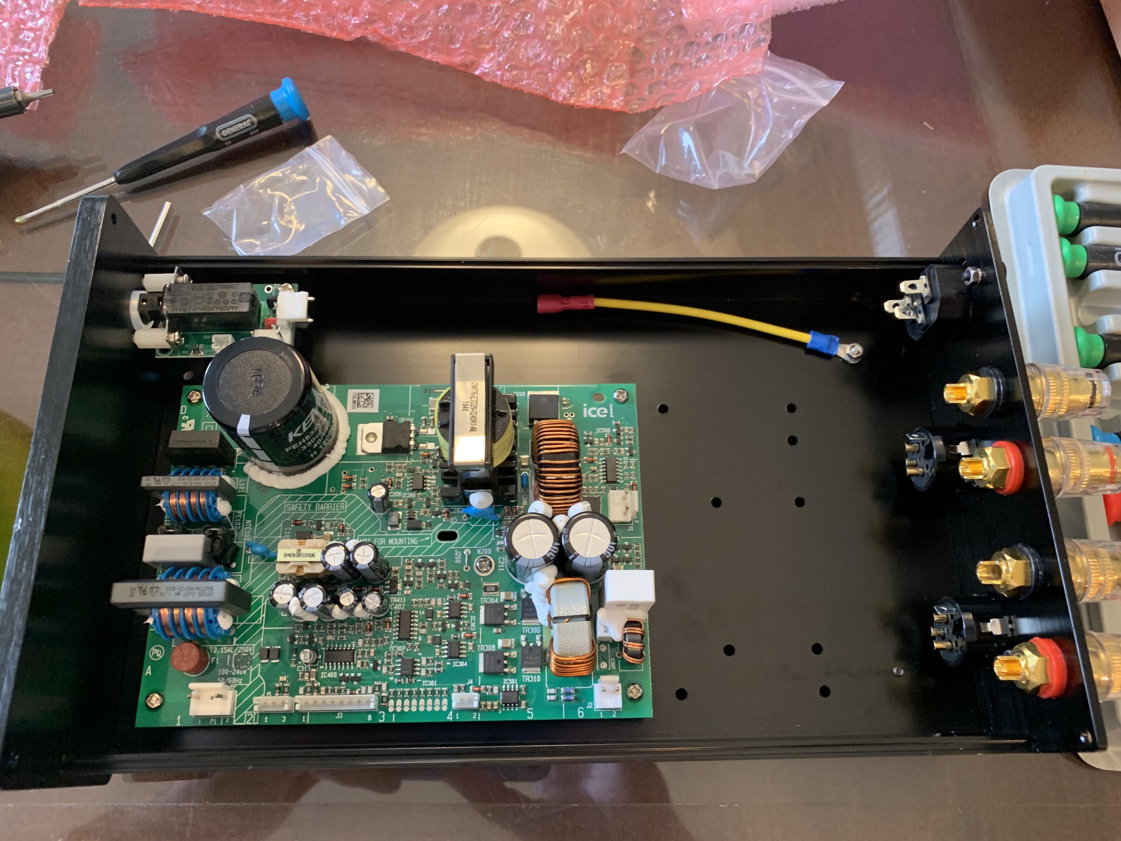

I just built a dual-mono amp this weekend with the excellent ICEPower 200ASC + 200AC boards and a Ghent Audio chassis.
Overall the experience was very smooth outside of having to mess around with soldering the binding posts. I used 123toid's video as a starting reference, but there were a few things I had to look up as he didn't go through all the details in his video.
After building it I then hooked them up to my pair of (admittedly hard to drive) Amiga MT's and compared them to my Emotiva A-300, with the MC-700 as preamp. Here are my impressions:
- The clarity was excellent. I noticed a lot of details that were harder to discern before, such as a dropped drumstick at the end of a track or a cough from a band member. Just lots of little things that were present before but not as revealed jumped out at me.
- The bass wasn't quite as full, though it did not lack in the clarity department. The Emotiva really wins here with just gobs of punchy, accurate bass. However, the ICEPower boards did deliver with reach (was able to hit cleanly at 35Hz) and not being too forward.
Overall, this was quite worthwhile and I'm going to be using this dual mono block as 1/2 of an active system using the Tang Band W6-2313 coaxial driver. I'm building a 50ASX 2-channel amp for the tweeters next and using MiniDSP as crossover.
The Class-D bug bit hard...I'm kind of glad!

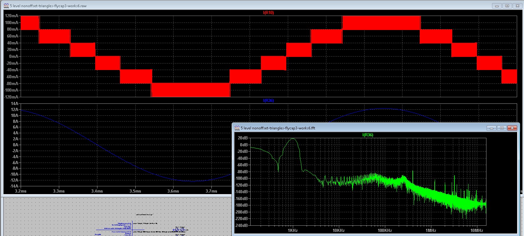

This child needs in time to be build, a multilevel version, -110db HD.
But wheere I can order the case for it?
The multilevel has a special feedback system, who correct the lowpass completely.

Seems a pretty straight forward build and looks very tidy inside. Thanks for sharing you have given me some inspiration to get off the dime. My home theater needs new amps and the ICEPower amps should work well with my 4ohm Linn speakers. I need 11 channels and if I am reading the specifications correctly 4 200ASC and 7 200AC should get the job done. Probably will split up boards between 2 separate enclosures.
