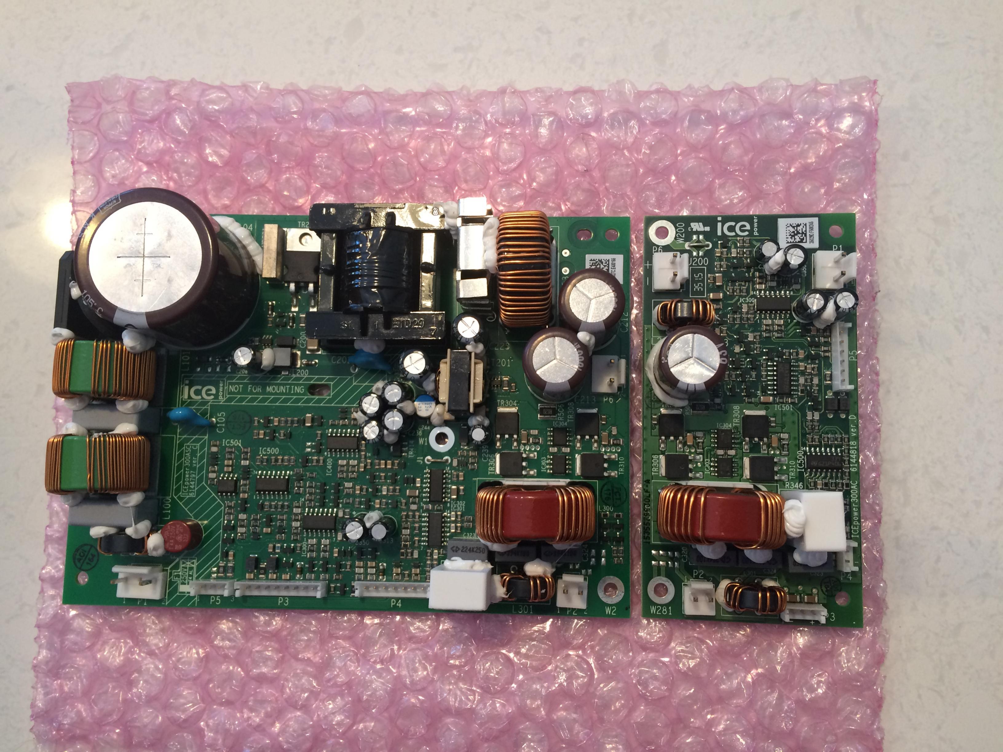

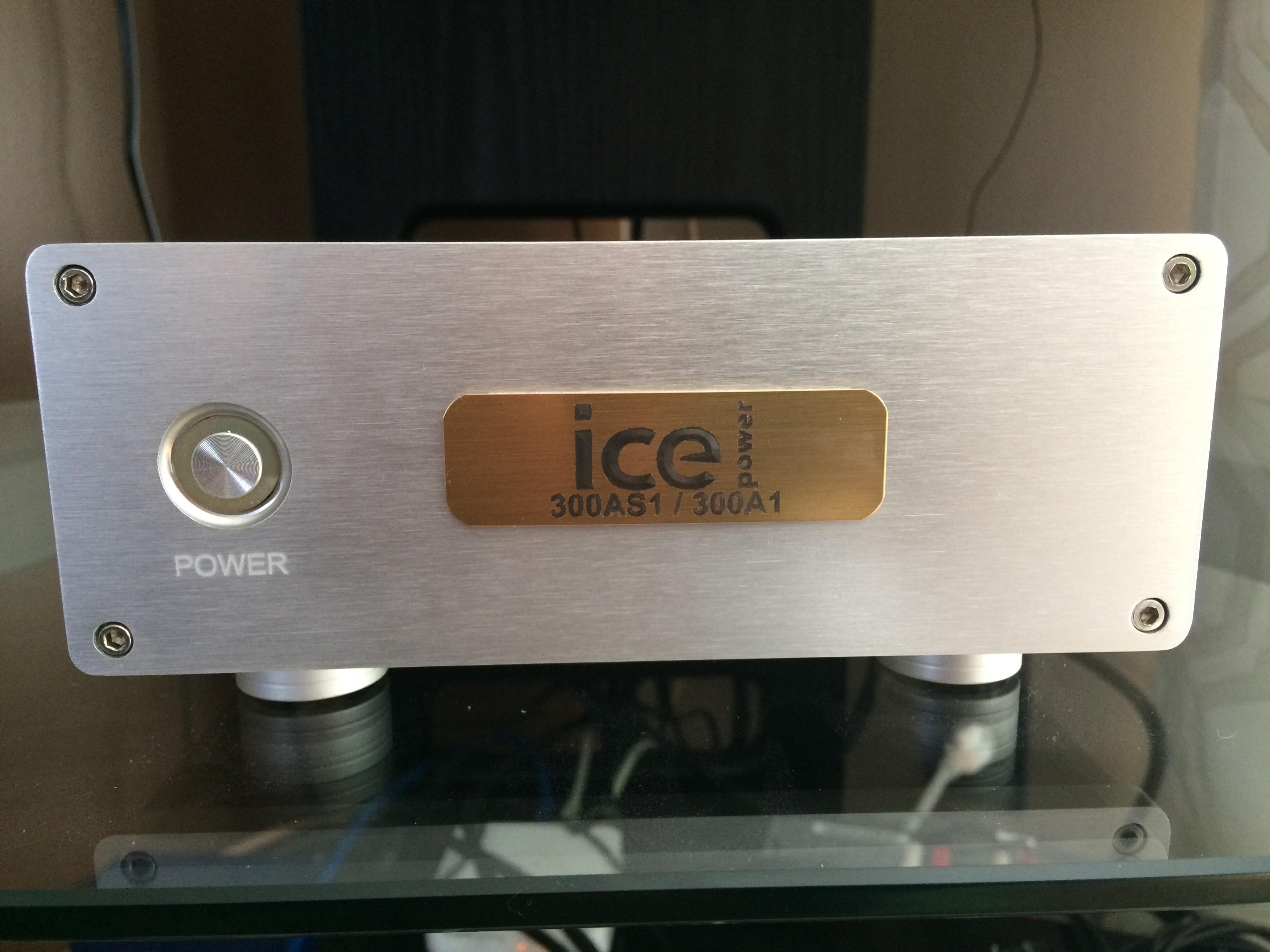

Here is my latest amp. IcePower using 300AS1 and 300A1
Enclosure is from Ghent Audio and custom label from an eBay vendor.
Also a pic of the actual modules.
Special thanks to Joe Bocani for making these amps available to DIYer.
BR
Eric

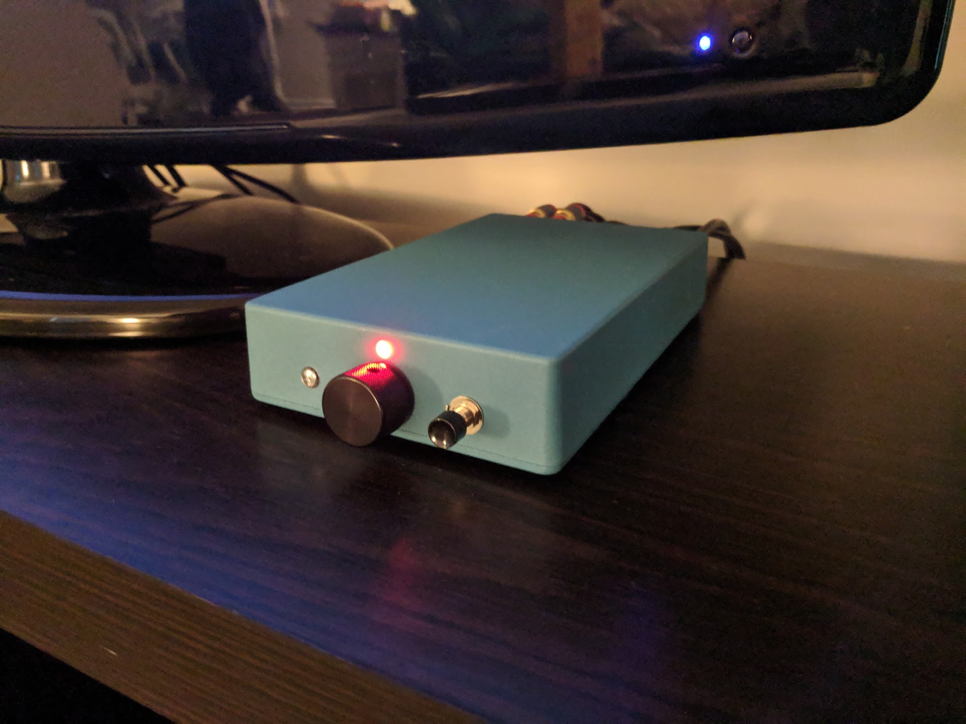

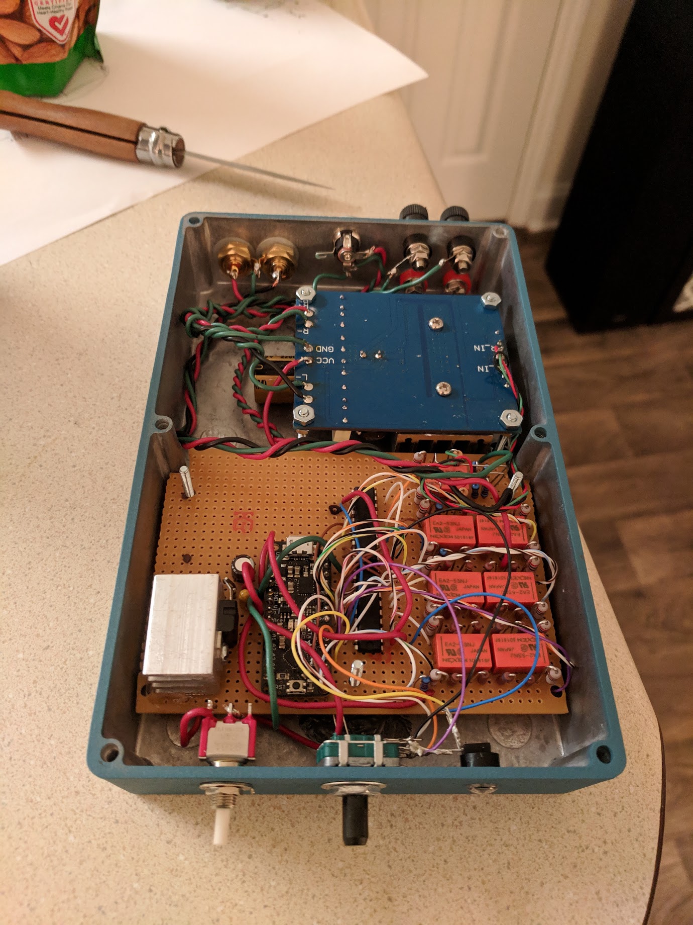

TDA7492 with log attenuator
HiLetGo TDA7492 from Prime
10k constant input resistance log attenuator
controlled via Arduino (Adafruit Metro Mini) by rotary encoder and AppleTV remote

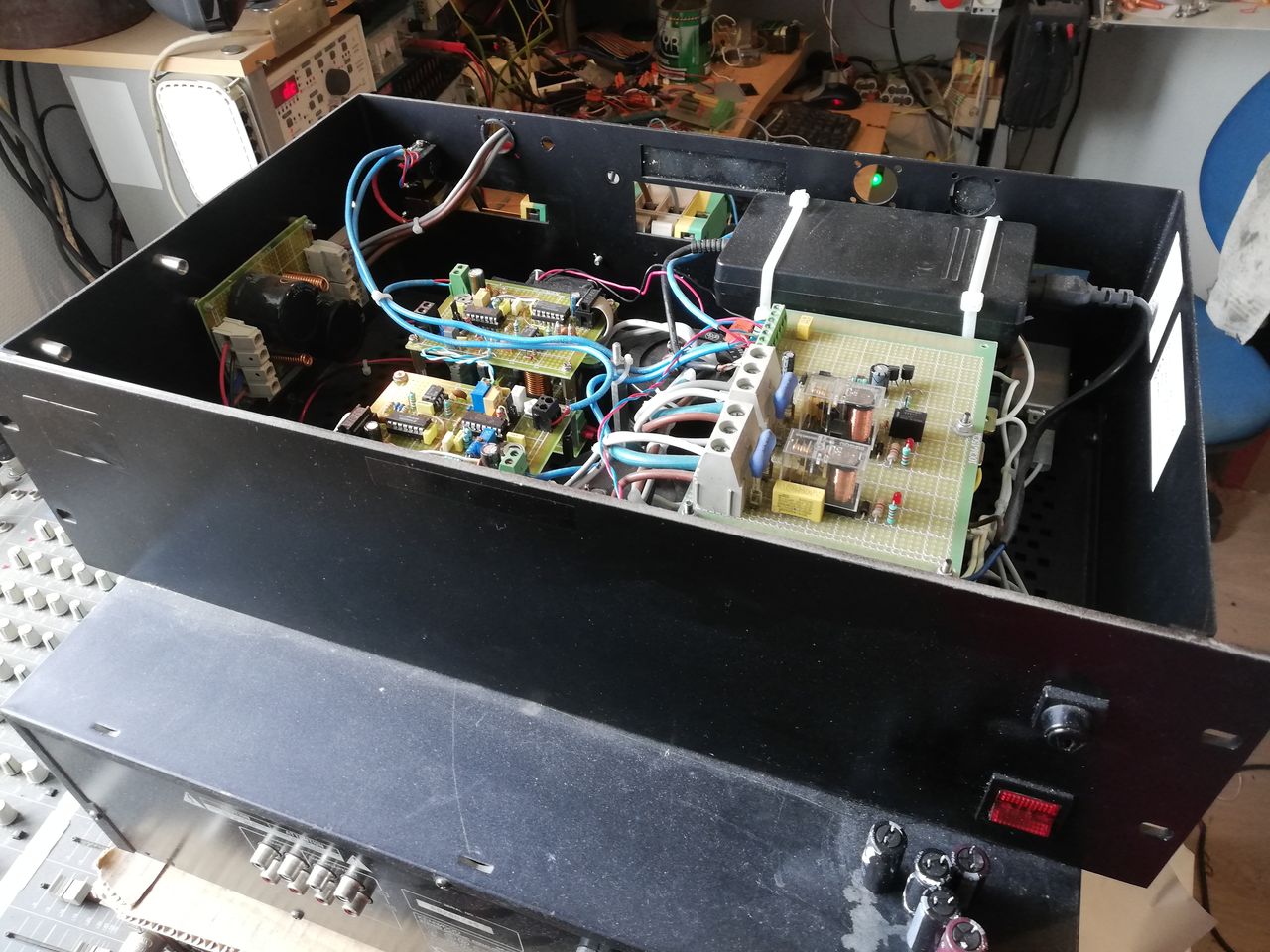

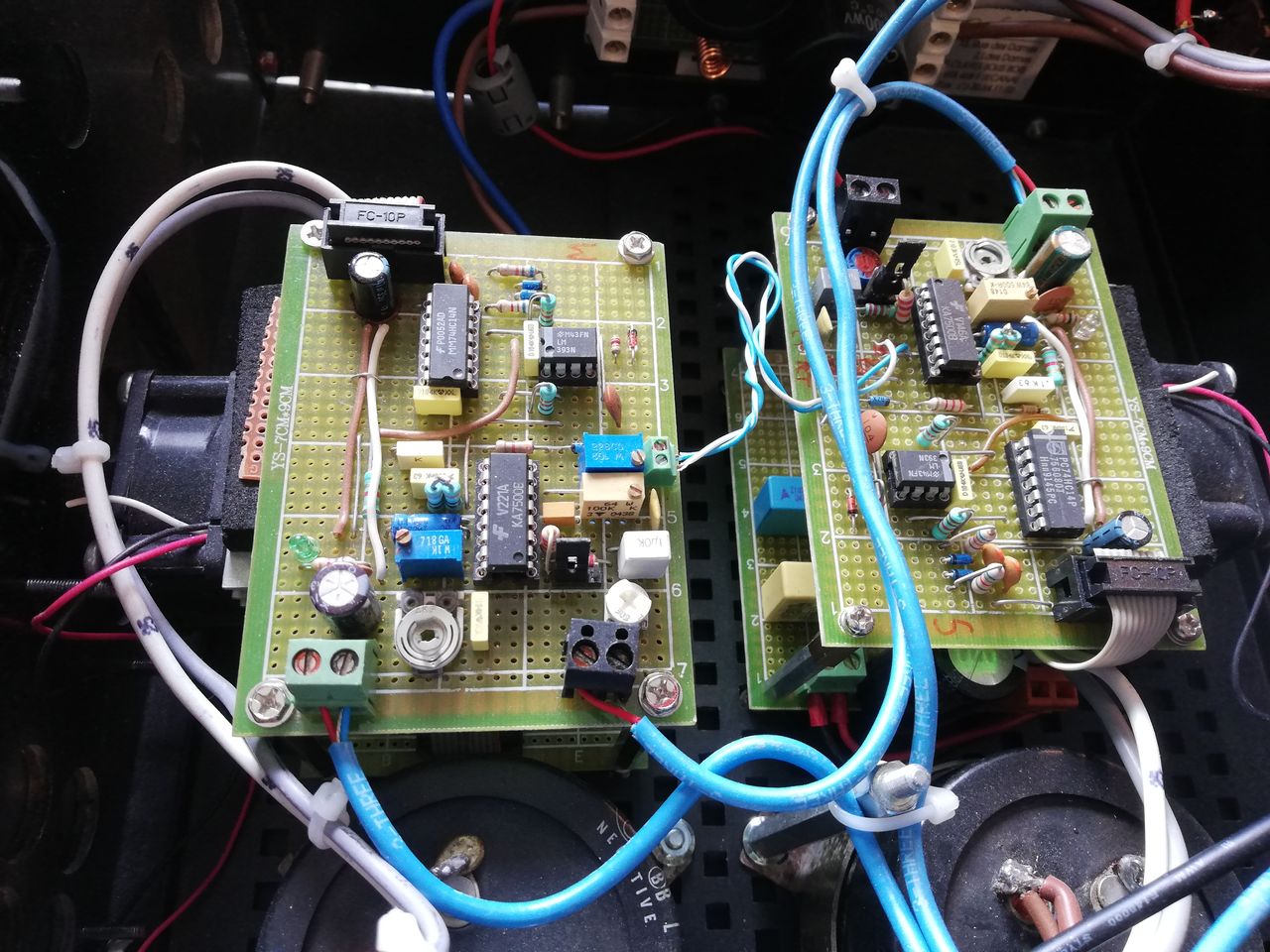

Stereo amplifier only made with recovered components from motor drivers or other industrial electronic devices.
2x200Wrms @ 2 ohms, based on TL494 clocked at 150kHz. Power parts are 20n50 mosfets drived by IR2110.
