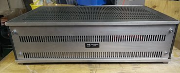

Hello Everyone,
I built this amplifier Sure IRS 2092, model 2 * 250w. I used a Sure PSU too. This amp power woofers SB29 6ohms in FAST mode. The TB W5-2140 fullranges are powered with the 3rd-audio TPA3251. preamp DCB1 and PI3 + dac AK4490. I am very satisfied with the overall sound. I still have to add HP protection.
So cool! I take it you were unable to use the Kenwood volume control, but is that the stock power transformer?
Mike
Mike
Thanks Mike,
actually I did not use the pot, the transformer comes from another much more powerful amplifier. It just goes under the hood. 🙂

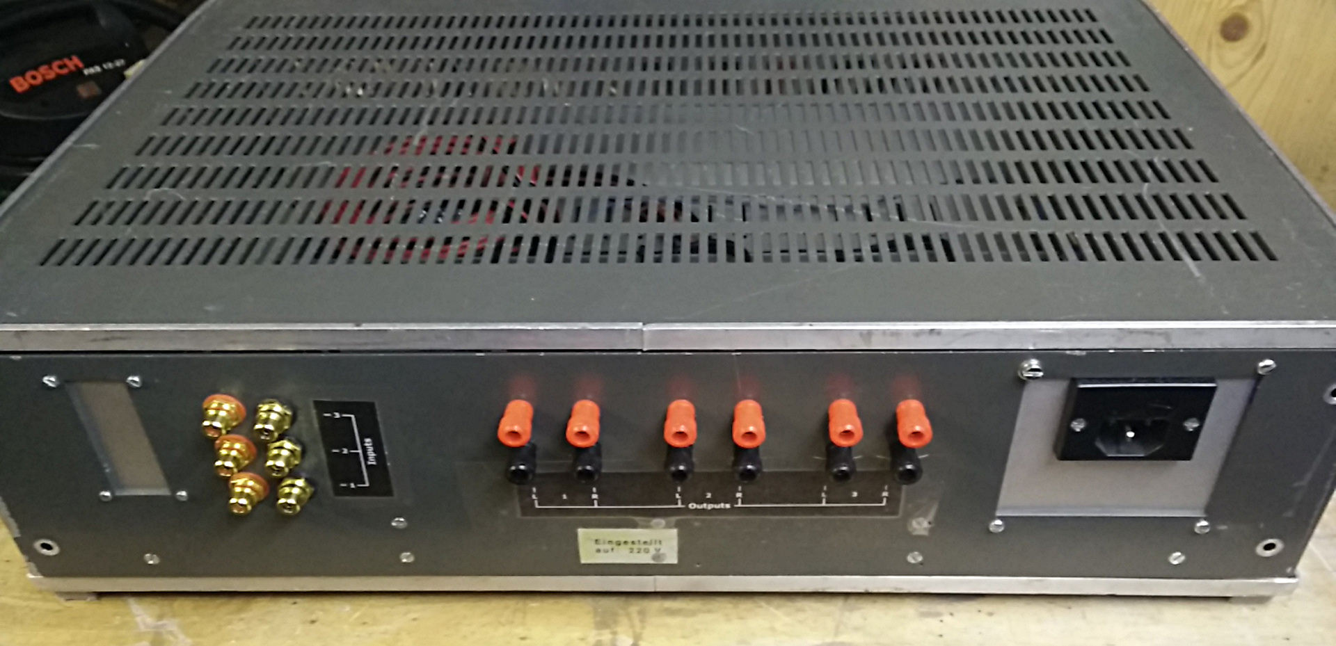

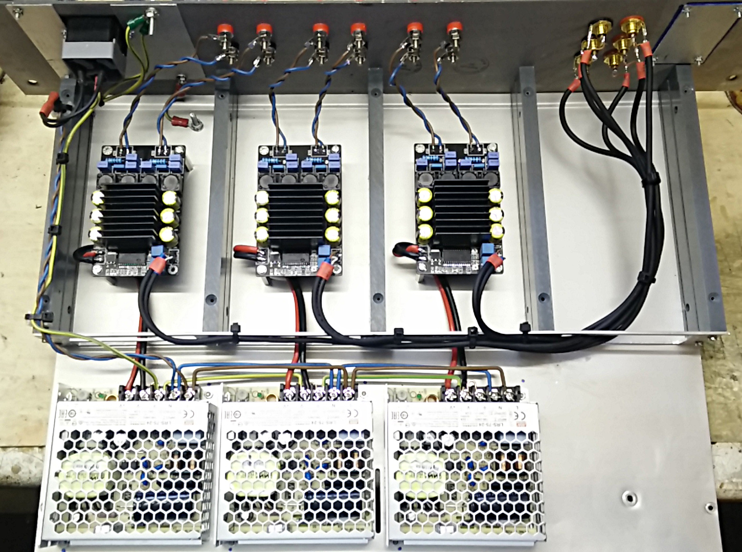

Hi there, just a very clean and unmodded build with TP2050 modules and Mean Well LRS-75 SMPS modules from aliexpress.
Cannot really listen to them right now because my speakers are currently disassembled for some cosmetics, but they are at least dead silent, no hiss, no humm. (And yes, I verified they are working 😀)

please re check your earth connection on all smps..on the pics it is look like you do not keep always the earth terminal
chris
Thanks for the hint but it is actually one solid 1.5mm² copper wire connecting all v- and all earth terminals. the connections between v- and earth is unisolated bare copper wire and can thus hardly be seen on the crappy smartphone photos (taken with a pretty old oneplus one).

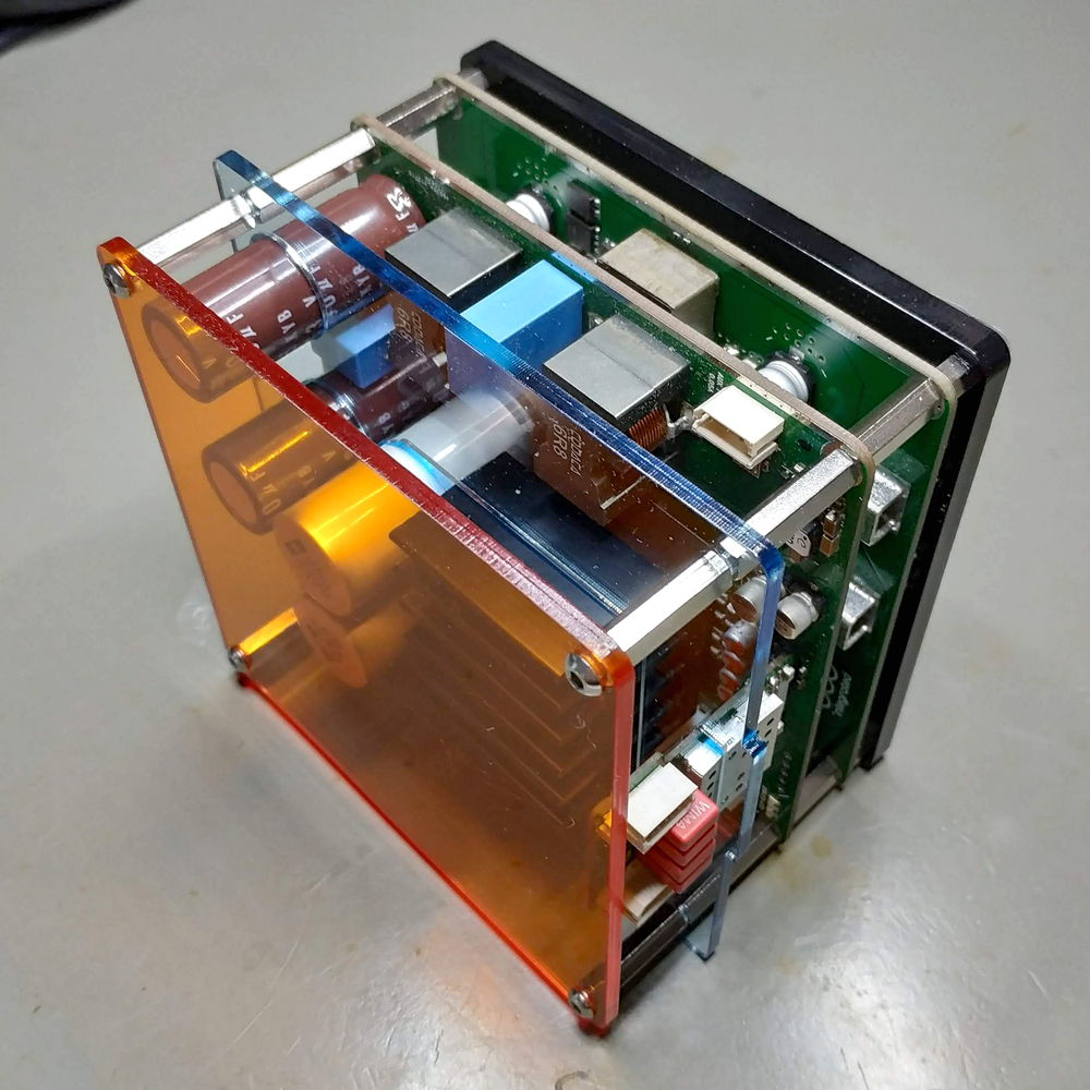

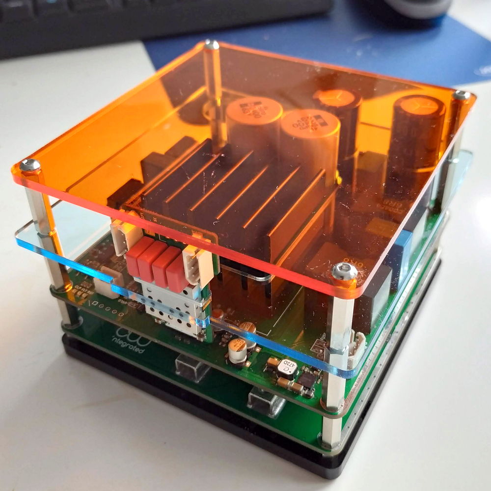

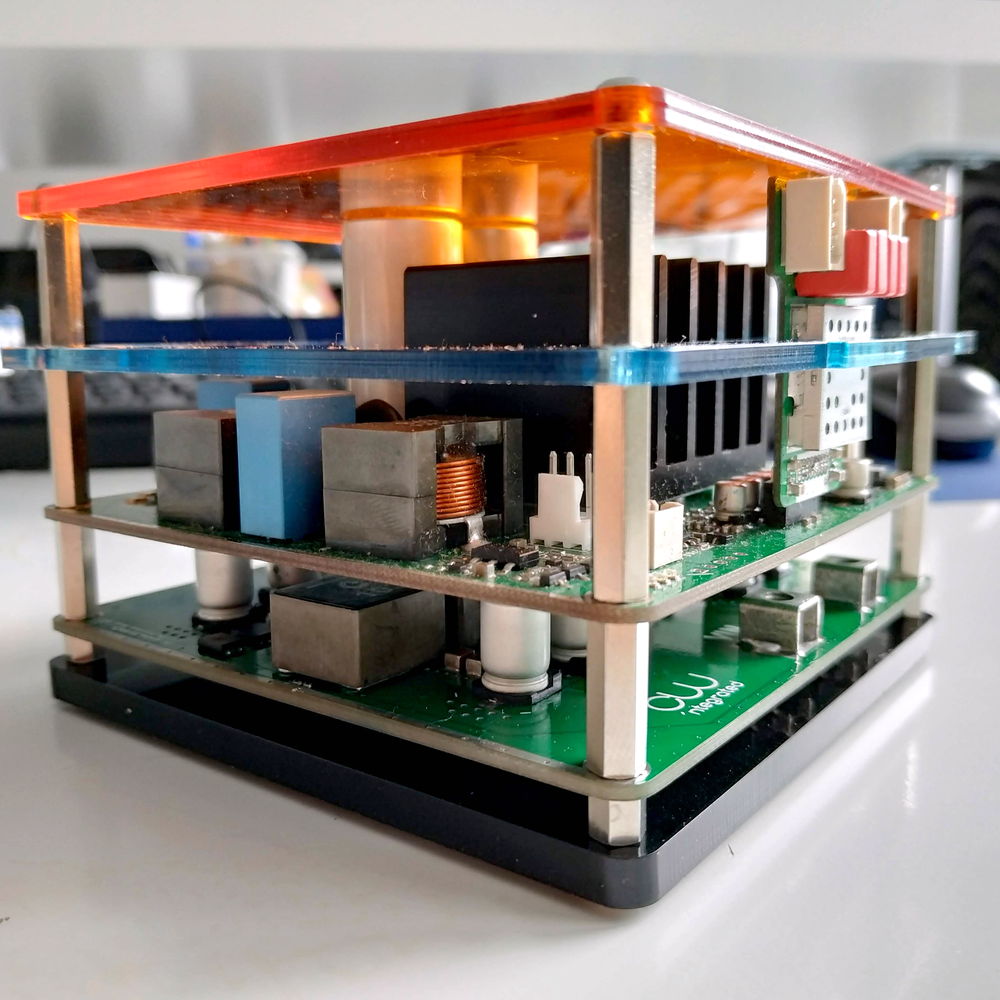

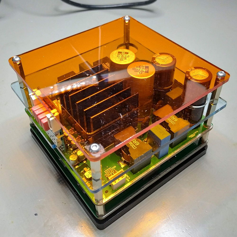

So, in the end they found together, TPA3255 2.1 100x100mm system in direct contact with the 1200W 4-phase LTC3784 boost-converter board, making it possible to go the distance with even only having 10V at the input to put out 600Wrms. As this asks for 1200W power into the amp and an realistic efficiency of 92% from the boost converter, this setup is asking for 130A at the 10V input. (Things get much easier when using a 36V supply) For the AFE module and bulk caps there is a mounting holder within half of the height to make good support for stability while driving with the bike. The whole thing measures 110x110x70mm, i'd call this a power-brick.

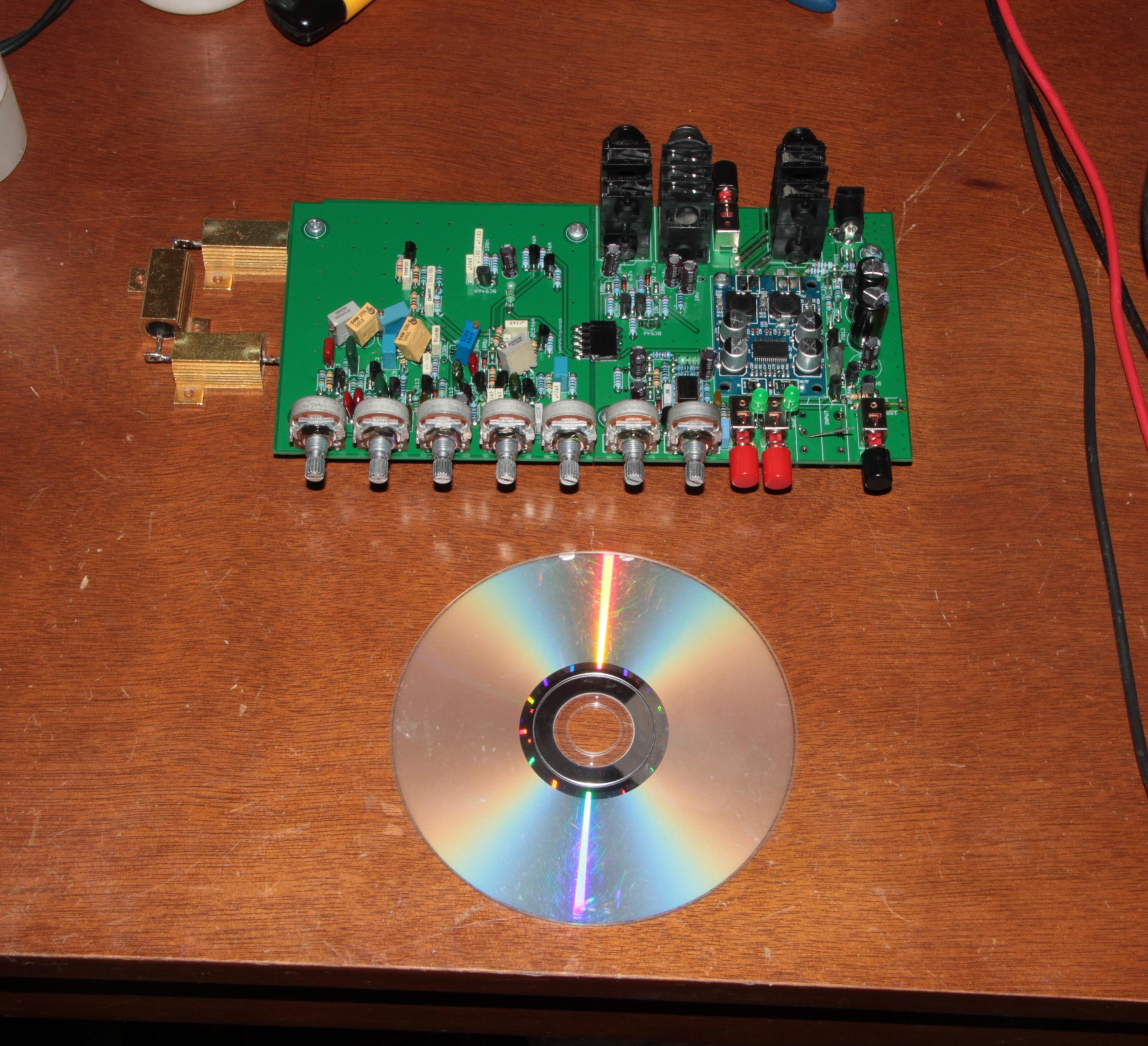

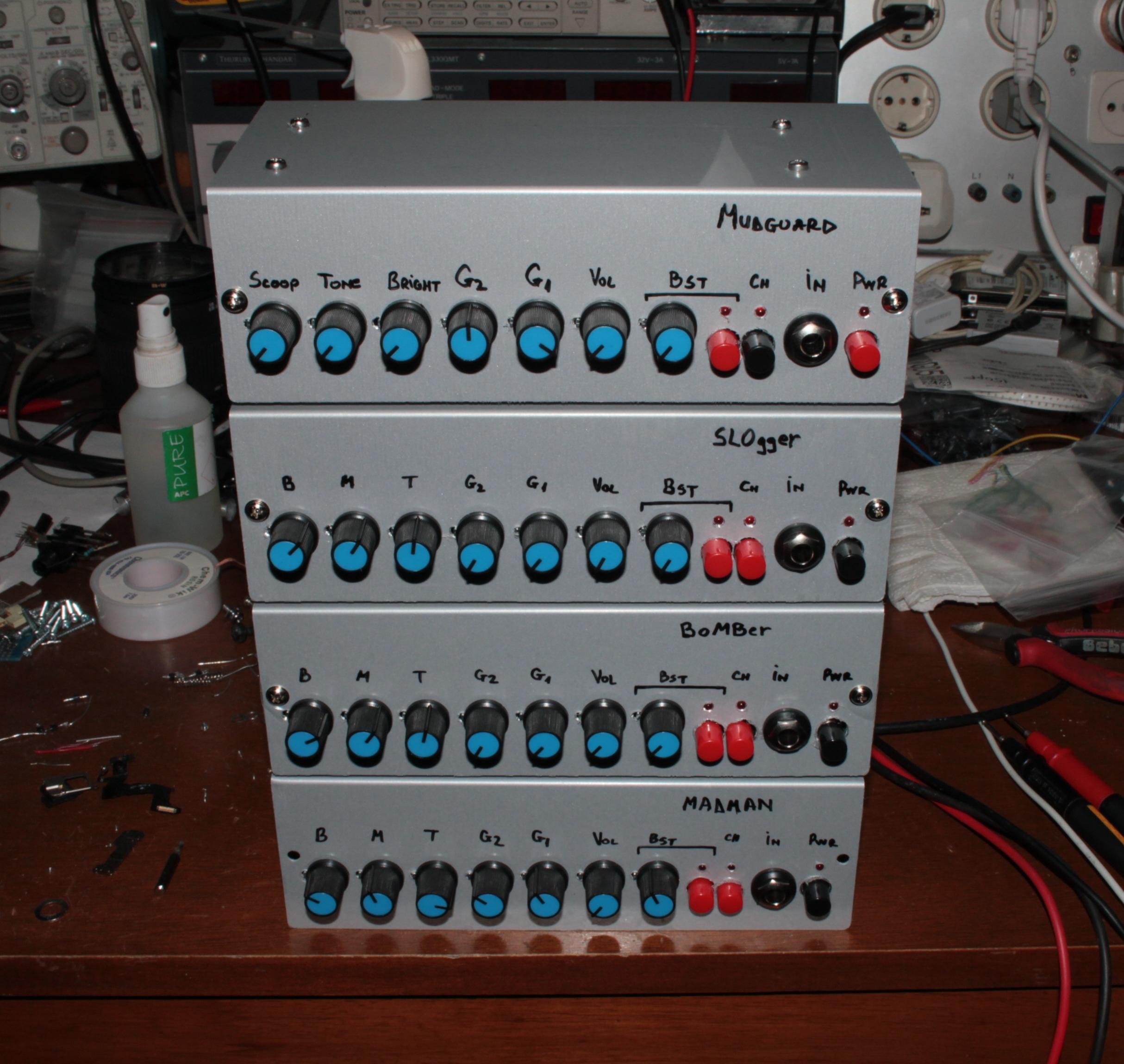

A little guitar amp project that's been bouncing around in the back of my mind for years, but finally got around to doing something about it (starting) a couple months ago.
"Even" managed to shoehorn in 120W HP laptop power bricks (OEM'd by LiteOn) in there 🙄
The cases for the prototypes are Takachi MB-12 (now discontinued, afaik), but if there's local demand, i've set my eye on some Hammond 1411TT's.
The little TPA3118 "daughterboards" have been de-gained down to 20dB (there's a good 4Vpp coming out of the preamps), are "SMD"-mounted to the mainboard.
Also, they have a glob of thermal paste in-between, and i left a soldermask-less area on the main board, to improve the thermal transfer.
CD for scale 😀
CD for scale 😀
You're too kind 😱
Well, there's only SO much i can do with a cordless drill and some cheapo eBay step-drills 🙄 AND while being a cheapskate / on a budget...
They ARE "only" prototypes, after all 😛 The first one (not shown) already went to my band's guitarist, and he's likin' it 😀
