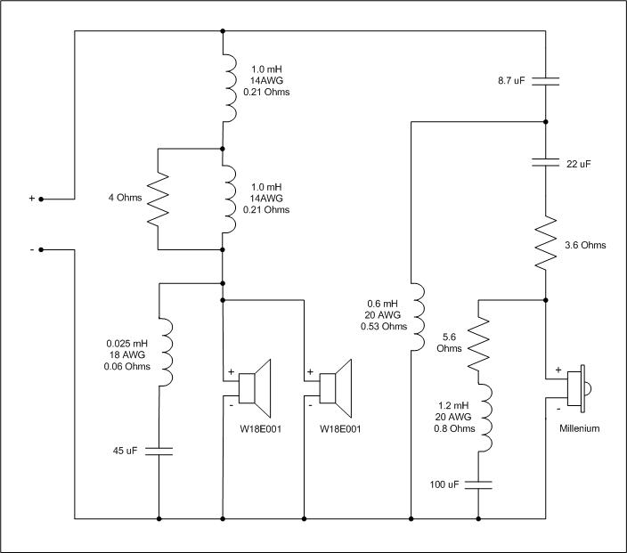

How should jimangies LR4 crossover be modified to work on a TM speaker with millennium tweeter and w18e001 woofer? i could keep the baffle as wide as the Thor and closed enclosure roughly 11 liter.
Graks,
Using only 1 woofer will compromise the SQ dramatically. Your could try to use this XO by increasing the R4 on the tweeter and adjusting by ear. Better would be to take new measurements and redesign the XO.
Krzys23, the XO should be compatible with the poorly designed original size box. jMangie was using the XO with a smaller cabinet too.
My guess is you need to double the values of the coils and half the value of the caps for the woofers. Then adjust the tweeter level down by 6dB.

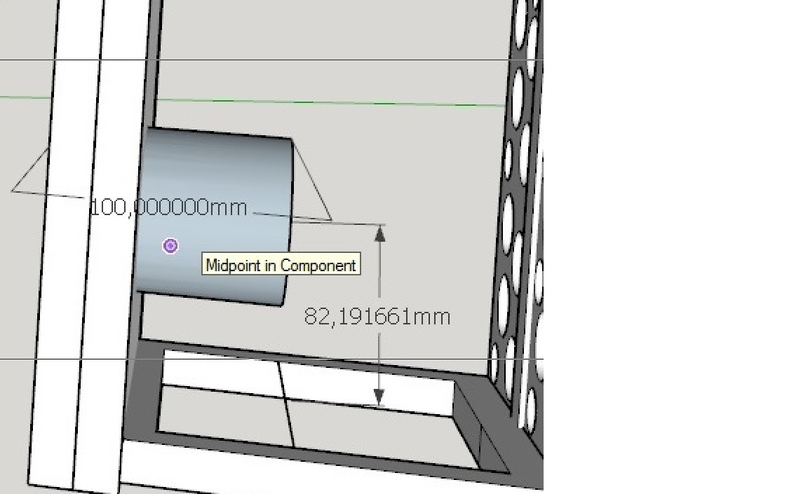

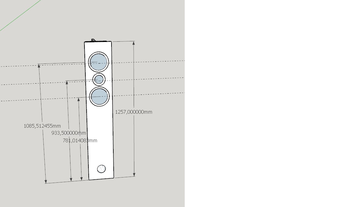

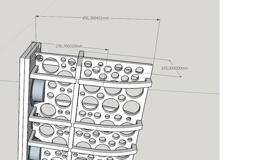

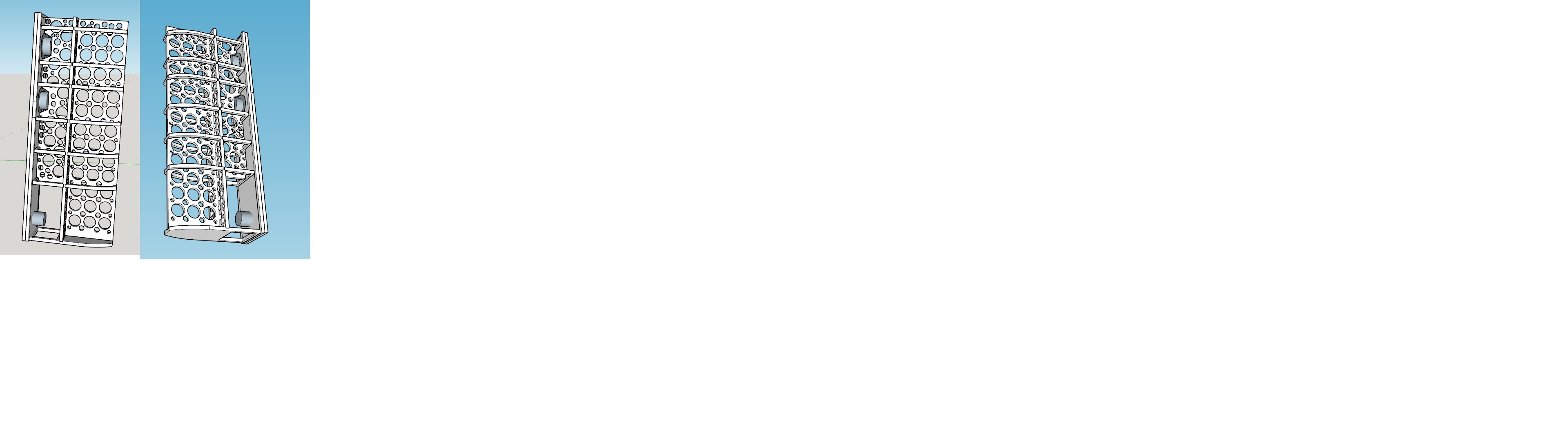

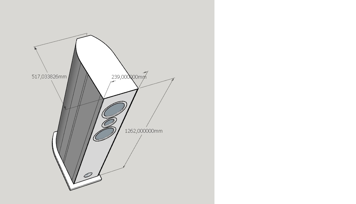

Hi all. First I have to thank everyone who has contributed in this thread. I read this thread and a lot of others. A lot of information Im thinking of building a set speakers and have made a suggestion to a curved cabinet from the drawings that you have made here. I have looked at Ron's drawing and added some more depth Like RON suggested in his Curved THOR thread. Internal volume of these sketches is a somewhere in between SMAL THOR and SHORT THOR. about 86 l.
Have tried to reveal dimensions in attached pictures and hope you can give feedback on whether it is worth realize this build. Appreciated all the help I can get.
