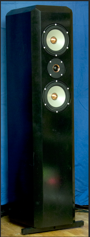

Good looking design, Thor's have an unbelievable voiceing. keep us posted on your build. pictures are good.
10 years old or not, MTM TM are a nice speaker design. New drivers and designs are always being developed. You decide.
Size and weight go hand in hand with cost, material dependent. Sound differences? Bigger is bigger Bass for bigger listening spaces.
changing any driver in the design is a new design, mostly your on your own
All said and done, I've been very satisfied with the Thors. Only recently have I found a new speaker to build which will better the sound, IMO. It costs roughly 3 times more to build. I certainly don't expect 3 times the sound quality. The carpentry is much more difficult and that's a large part of the challenge for me. I'll still keep the Thor's though.

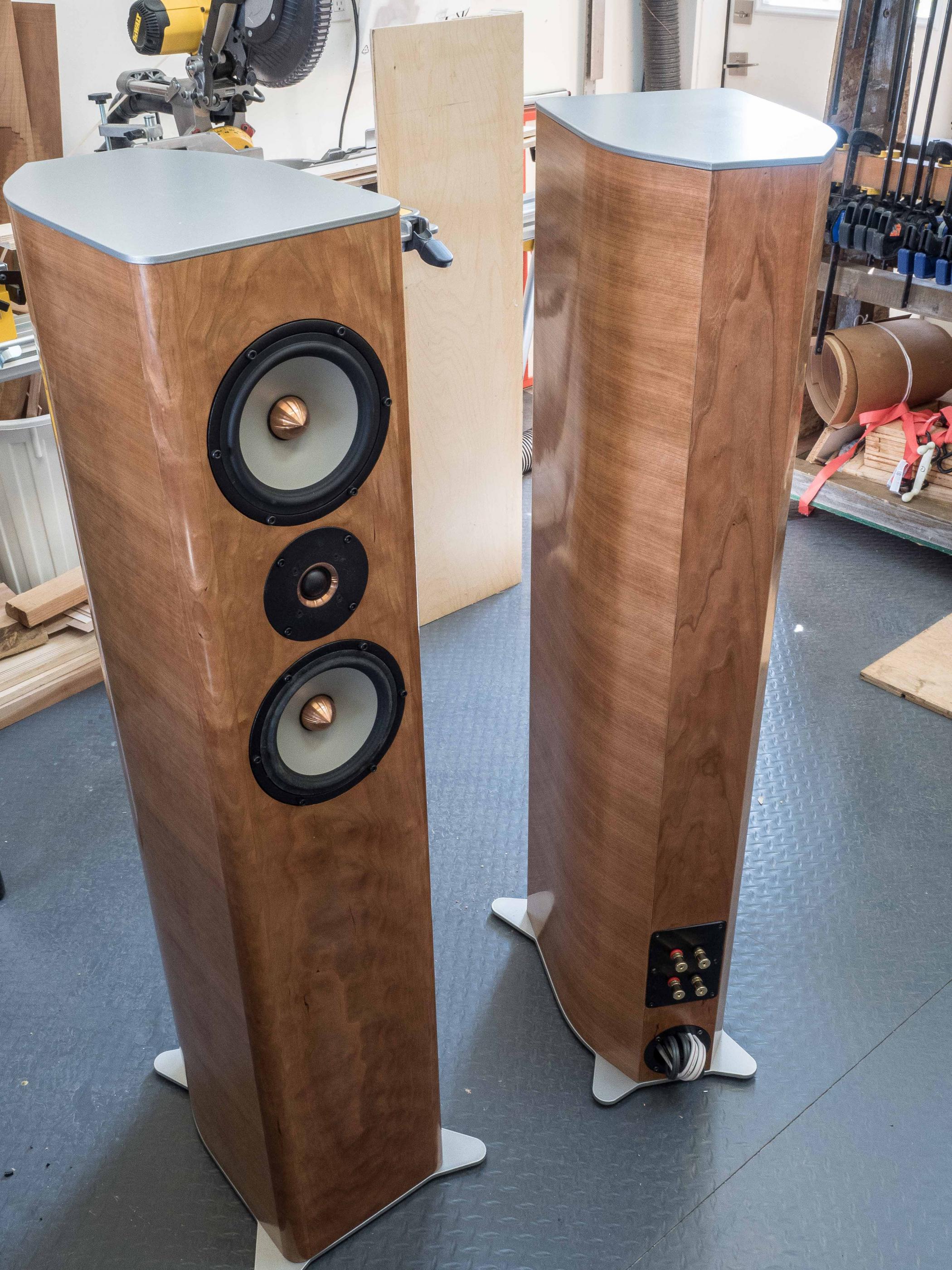

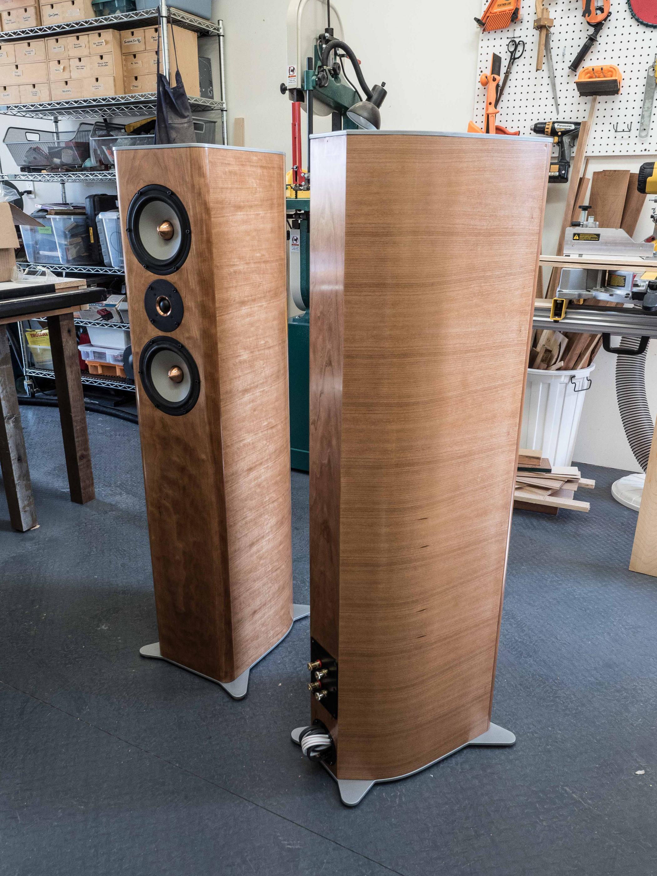

Hi Folks!
I've just started a build thread on my 'curved side' Small Thor project - taking after Renron's excellent build thread. Started with the crossovers using jimangie1973's latest design, which I don't believe has been posted yet - or at least I couldn't find it - I contacted him directly via PM. If you are interested in seeing it go to:
http://www.diyaudio.com/forums/multi-way/269850-curved-small-thor-redux.html
I'll be putting up more pics of the construction as it progresses.
Thanks to all the hard work and sharing that has gone with the various Thor versions by Renron, Scottmoose, jimangie1973, Planet10 +++ - I hope to share a few humble experiences with my build thread.
Cheers
Tim

Curved Thor's nearing completion!
Here's a couple of pics of my finished cabinets.
Am currently testing crossovers - jump over to my thread for progress on tuning next week once I get my parts in, if interested...initial impressions tweeters way too hot for both the Jimangie crossover and the SEAS version, but the SEAS version is less bright. Confirmed by Audiotools RTA and Impulse FFT measurements using my iPad.
Will be swapping the series resistor in the tweeter network with higher values next week, per advice from Jimangie. Will try a 2.7, 3.0, and maybe a 3.3 ohm if still too hot. Jim says he is using a 2.7 in his current setup. Jim exceptionally helpful, BTW - many thanks!
Woofers probably need to break in some more as well...plus all the wires coming out of the port are probably breaking up the port contribution - will try to tidy that up.
