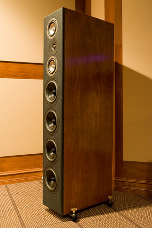

My favorites are my Ardents designed by John Marsh. $$$$$ though.
Official Wavecor Ardent Reference Thread - How we realized the Dream

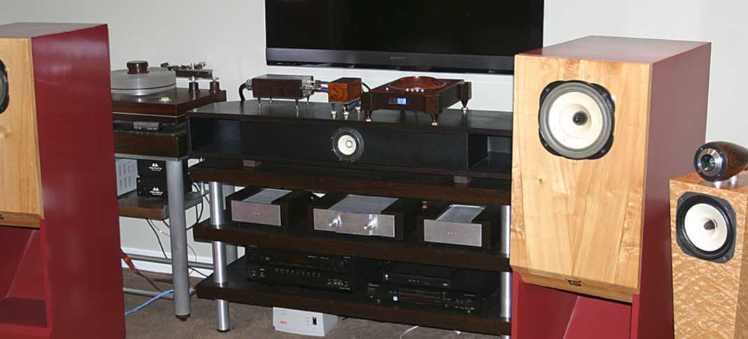

If the RS225 makes the speaker too wide for WAF. Then maybe these from Clearwave.

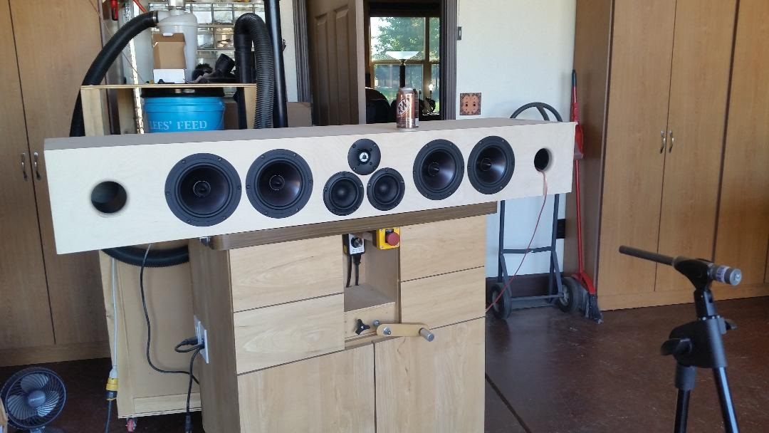

picture of my stupid huge 60" wide center channel. 😀
Dave gave me good advice while I was building my Thors.
Thanks again Dave, Mr. ScottMoose too!
Ron

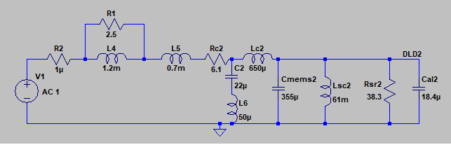

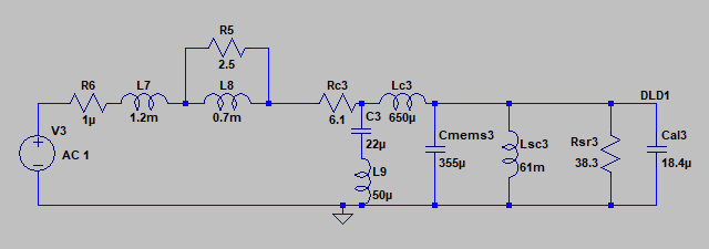

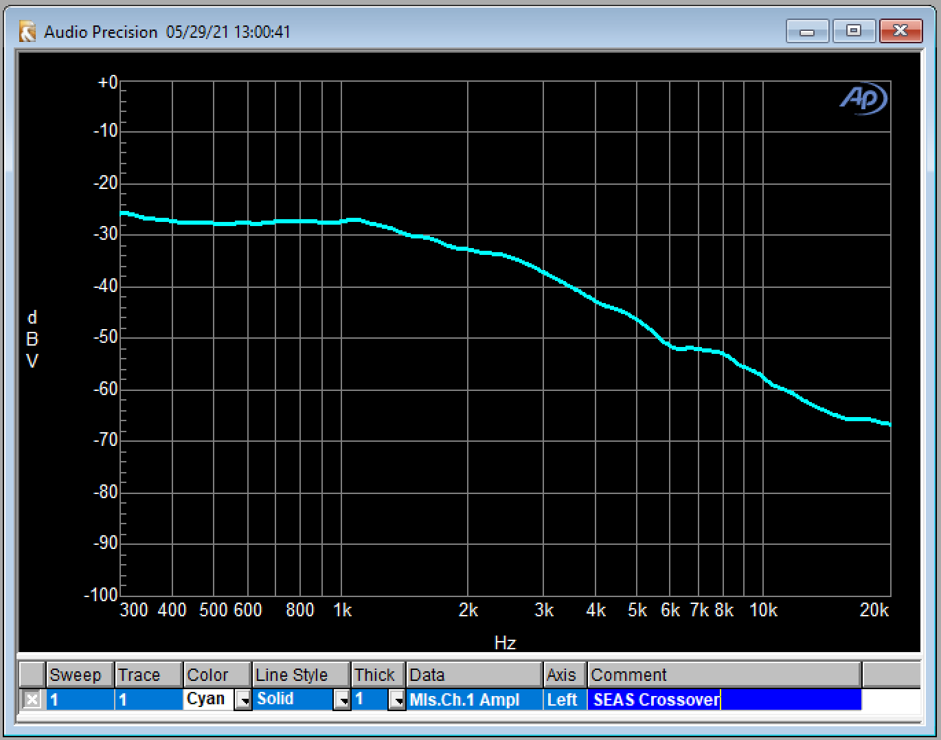

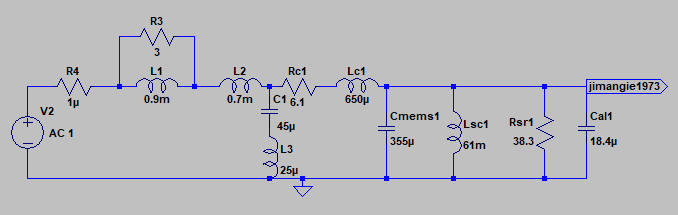

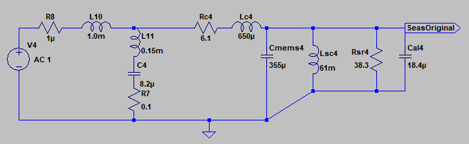

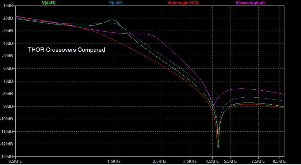

It's been a while since we flogged the crossovers.
I just used the electrical model and compared the Original SEAS with JimAngie, DLD1 and DLD2 for the schematic shown on the SEAS website.
Will measure this afternoon.
DLD1 & DLD2 would have been someone else’s, perhaps more of Jim’s work.
dave
Yes, sorry, I copied it from one of the engineering drawings you had rendered.
No problem. I do a lot of drawings of other’s work. I try to make sure proper credit is given.
dave

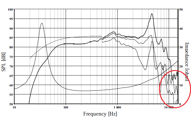

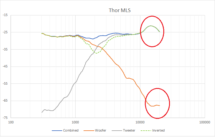

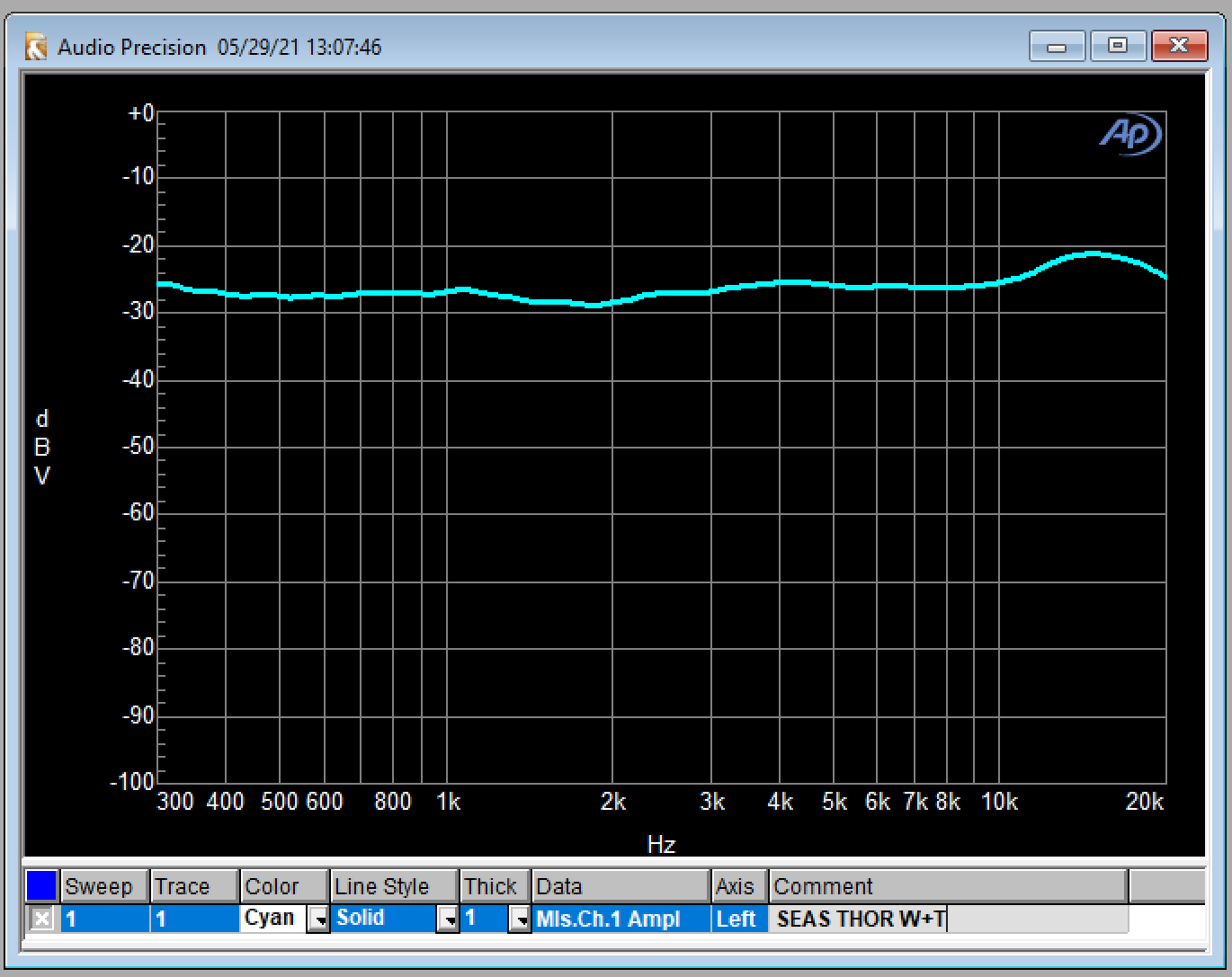

Putting in some more smoke, no wonder the THOR's were screaming at me. The AX design. As others much smarter than me have opined, the crossover left a lot to be desired. The response of the 2x W18E001's does not continue to rolloff as stated in the 2002 article thus the boost around 14kHz.
The woofer has no impact on tweeter peak response at 15khz, woofer output is -50db below tweeter output at that frequency
