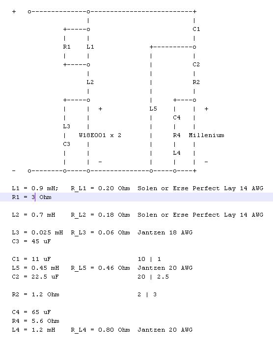

Hi all,
Im thinking on rebuilding my old Thors. I have few questions. What is the difference between Fat Thor and Fat Thor ML sound wise? I really like the old Thor for the not boxy bass and mid. So am I wrong to think that Fat Thor would be better in that region?
Then about the crossover. Ive found a couple of schematics for a new xo. One on the link on Renrons post above and this one:
http://www.diyaudio.com/forums/atta...as-thor-kit-reduced-baffle-step-crossover.jpg
Is the latter one the latest version from jimangie1973 and can it be used on Fat Thor?
Thaks in advance
Juhi

I have not heard either the Fat Thor or the Fat Thor ML versions of the design.
I would guess, it's only a guess, that they would sound VERY similar. Pick one! You'll be happy.
Can't help you with the XO question, sorry. Send Jimangie a PM.
Ron
Ron

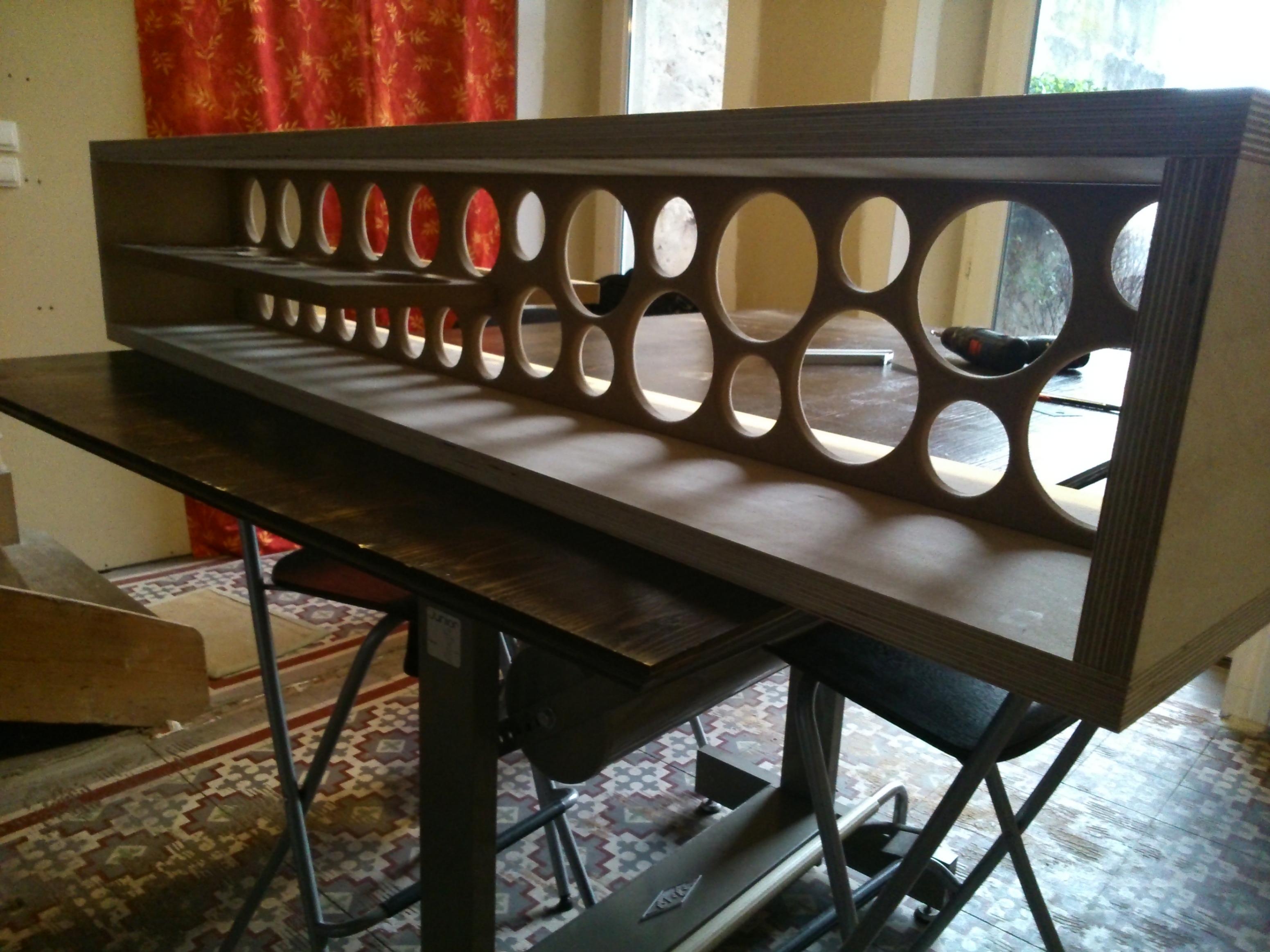

I backed off on the percentage after seeing yours and greenie's swisscheese. You want to use the holes to let air flow freely, to break up resonances, but not so many that they compromise the structural integritiy of the brace. Some of ours likely get as low as 30%.
dave
Hello,
I build "small thor" I read the whole topic but I had to miss this passage.
I think I removed too much when I do my swiss cheese .. : ( what will be the impact on the final result, is it serious?
Thank you in advance for your answers.
