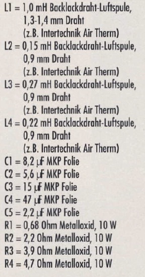

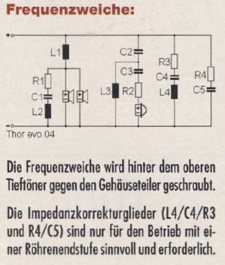

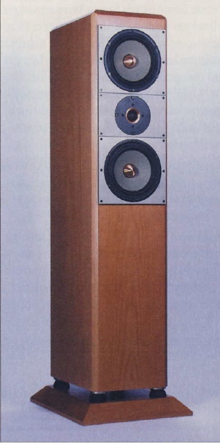

Hello there,
i quite like the thor and this thread, and i am wondering if any of you have seen, or better heard this Transmission line version of the thor, published in Hobby Hifi, 2004/04 ?
looks promising ,
cheers
Yurgs

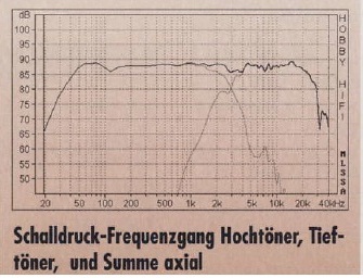

I am not quite sure,
looks like they did a mod on the xover as well, the alum panels at the front.
They also mention that the dip in the freq response is caused by the shape of the frontpanel around the tweeters (so rounded edges should fix it).
apart from that it looks the same to me.
I have finally been able to carry out an FR plot. This is for the Small Thor with D'Apollito crossover. As has been stated before there doesn't seem to be any problem with suppression of the hf resonance in the magnesium cones.
