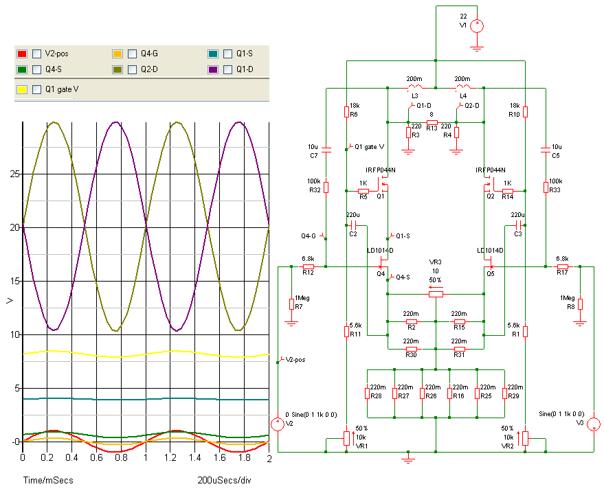

carpenter said:Is this close to what you're designing, Magura? I've been working on this for several days when I came across this thread.
Woody - you don't have much benefit of cascode modulation , when going symmetrical .
you can freely toss these modulation parts out .
besides that - what's use of these bunch of 0R220 , near gnd ?
they're too small for any practical benefit , if I see them correctly - as sort of Tail in LTP .
edit - just forget question regarding these resistors ..... they're obviously here for same modulation I saw ........
tired eyes ........ or is brain ......... ?
