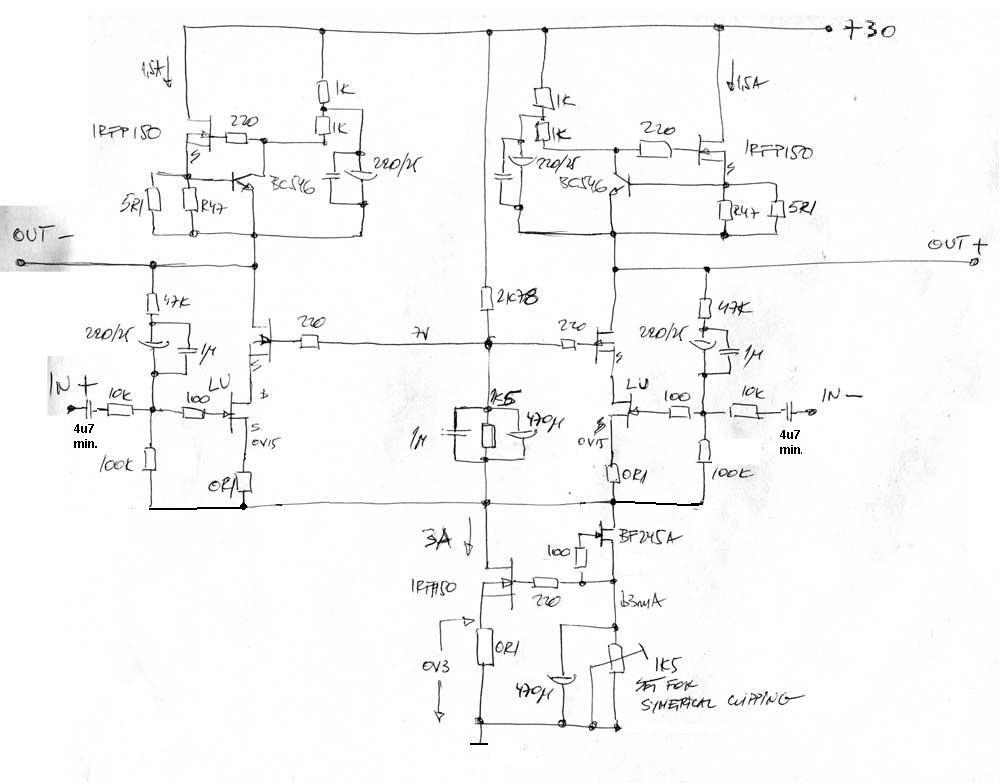

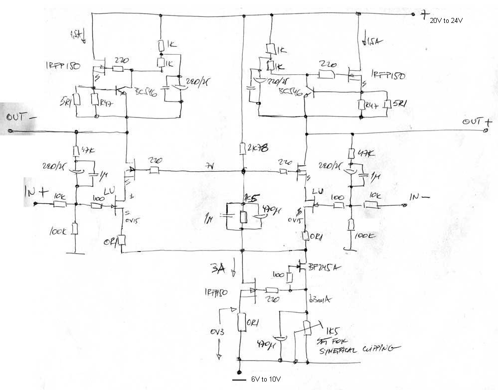

Re: Where was a mistake ?
No inductors, low bias.... 😀
Magura 🙂
Magura 🙂
Re: Re: Where was a mistake ?
nope ;
I'll call your version - Nail Melter .....
Magura 🙂
nope ;
- Choky Susy F3 for LU1014's
