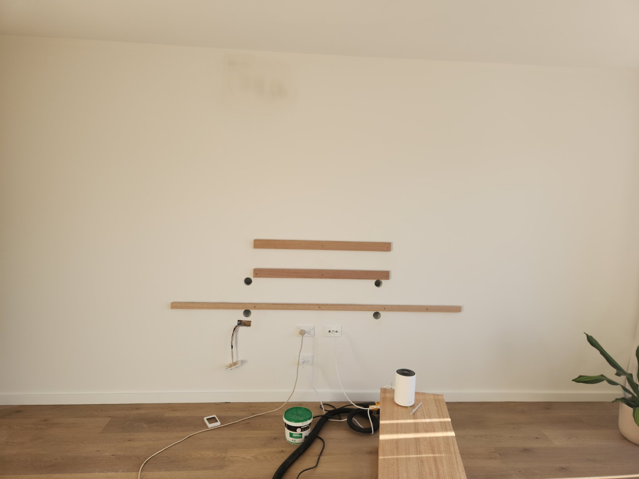

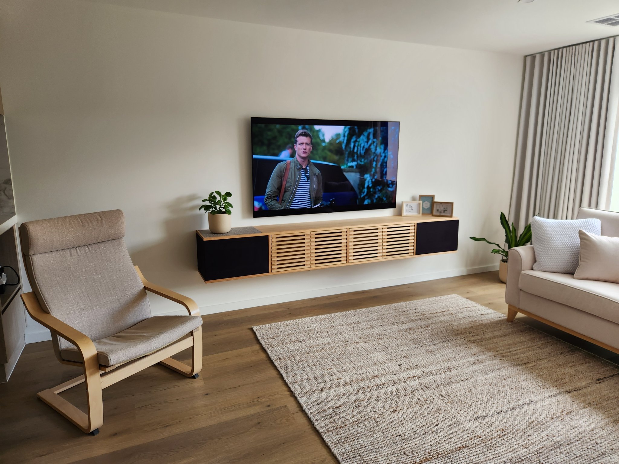

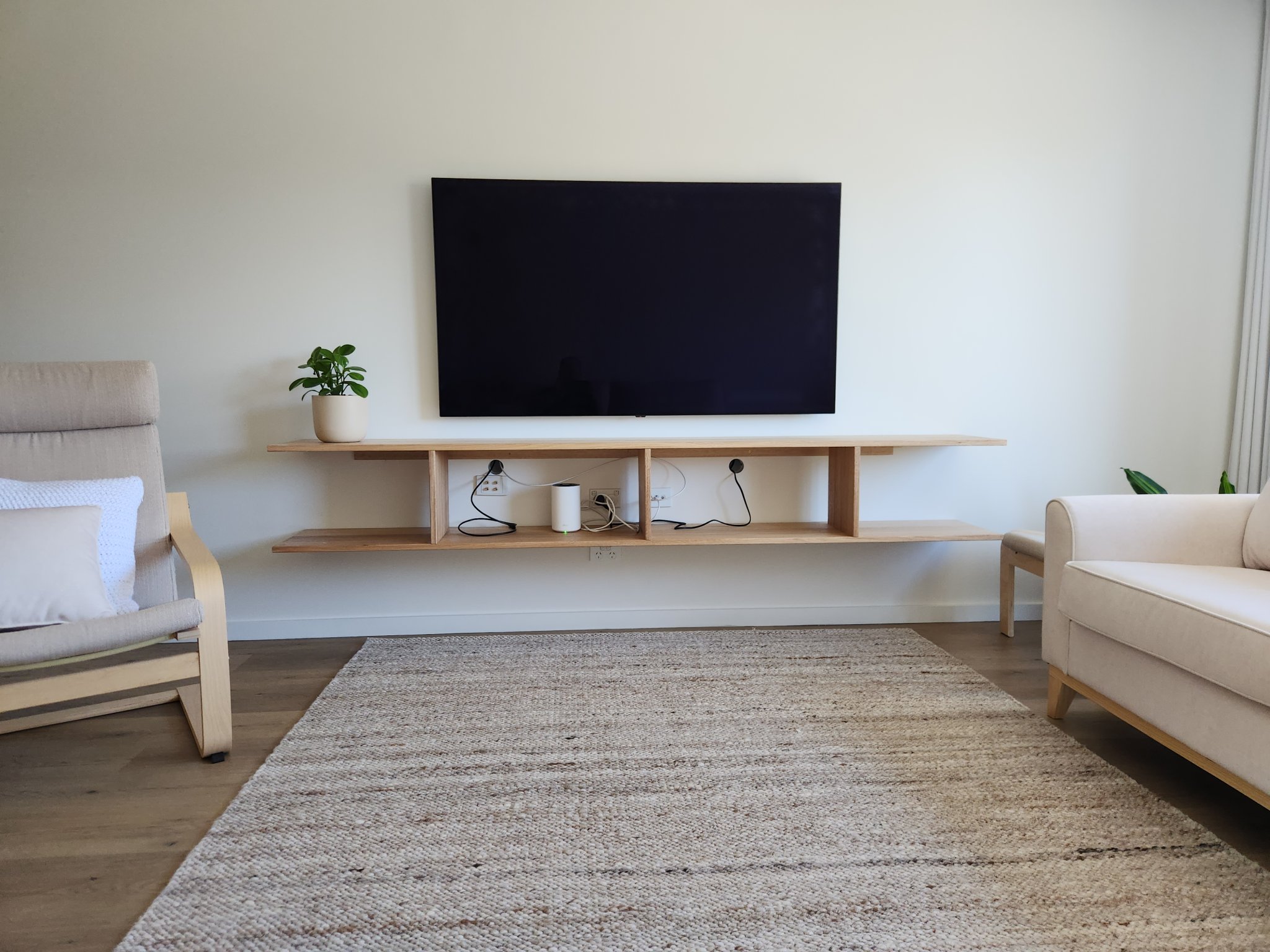

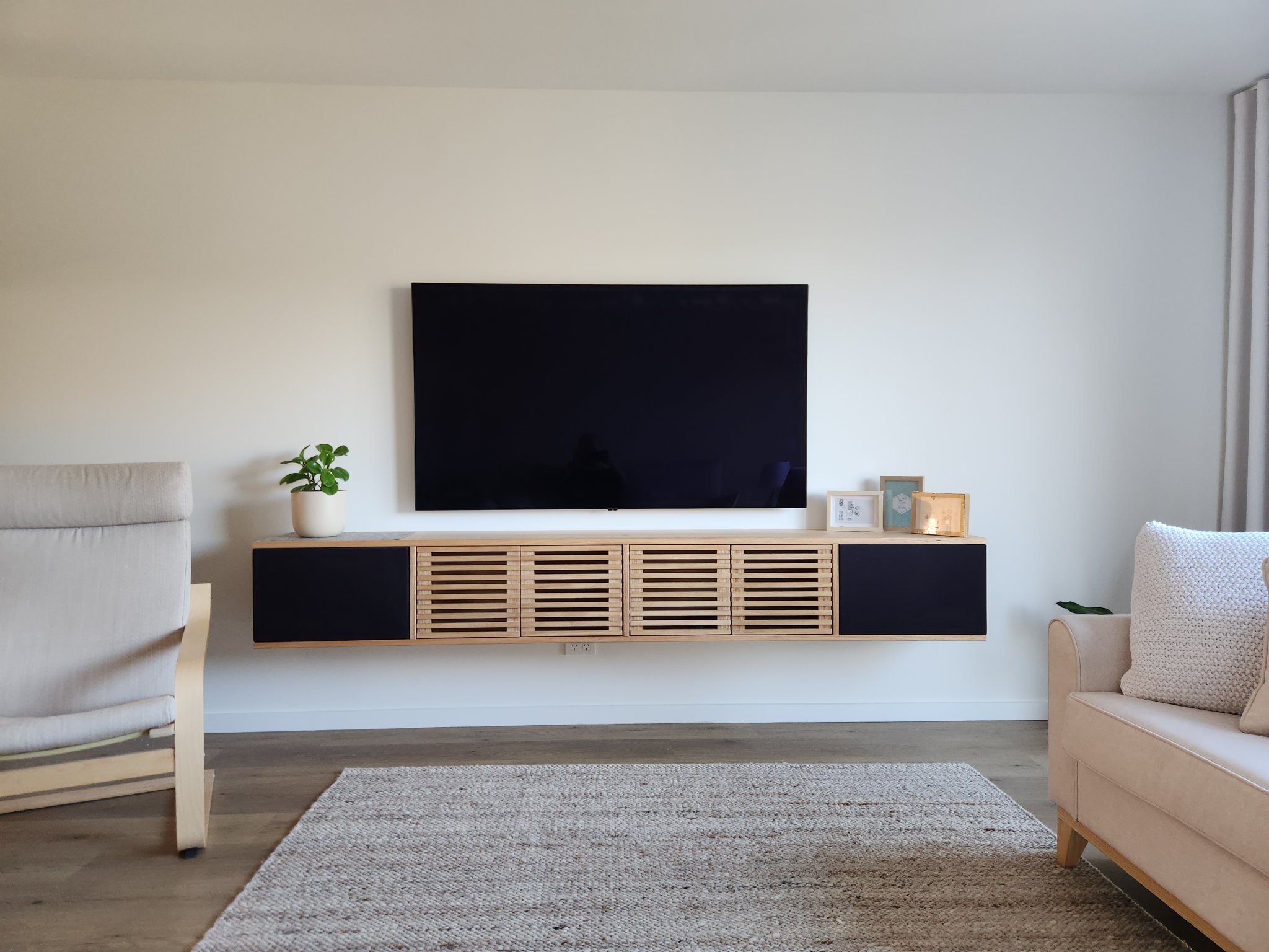

@cowanaudio - I like the floating console/cabinet. Did you design it? I have thought about a wall mounted cabinet like that, but I have been fearful of som heavy guy leaning on it and popping it loose... what attachment mechanism did you use, and what kind of weight limit would make you feel uncomfortable?
G'day Jim
Yes, I designed and built the cabinet myself. I finished the Tasmanian oak timber down to about 21mm. Being a hardood it is pretty tough. My biggest concern was actually the strength of the lower shelf, because that carries the weight of the speakers. To that end there are 30 8mm dowels and glue holding the five pieces of the main structure together. The cabinet is secured to the wall with a full length french cleat that is screwed into five studs with 75mm long screws through the 13mm gyprock into the timber behind. I'm not a big guy, but the cabinet had no problems holding my 75Kg weight when I sat on it. I have no concerns of my grand daughter pulling it off the wall. It is very easy for my wife and I to lift it down from the wall, should that ever be required. I lifted the cabinet without doors and speakers onto the wall cleat myself.
The cabinet has a removeable false back that is set forward 50mm. The amplifiers, speaker protection and cables live behind. Only the Flex-8 is visible when the doors are opened.

It looks fantastic. I will NEVER show that to my wife.
How deep is it?
I suppose it could be built with legs ( I have a pocket door behind part of the wall, so I can't put bolts all across the width.
My problem would be where to put the big speakers...
But, it looks FANTASTIC.

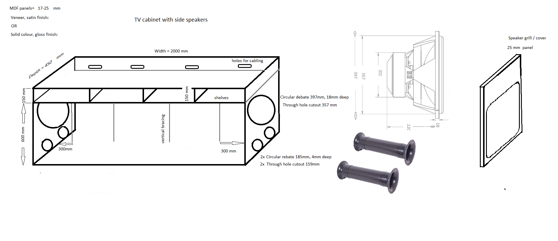

Some time ago, I designed some Side firing dual opposed subwoofers, integrated into the custom TV cabinets but never got around to completing its.
Once you cover 40-150 Hz cleanly, it affords you small monitors much more easily.

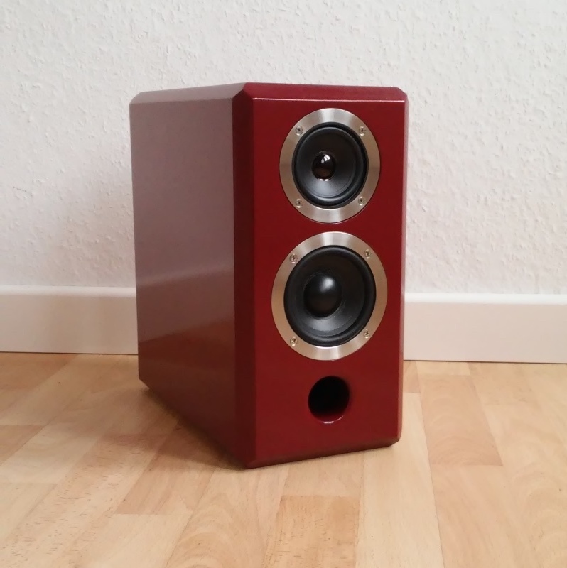

anything here for WAF?
try Google Translate
https://translate.google.com/?sl=auto&tl=en&op=translate
https://www.werner007.de/lautsprecher/kompaktboxen

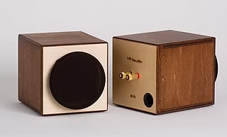

Similar type small speakers
MH audio- Japan
https://www.mh-audio.com/about-mhaudio

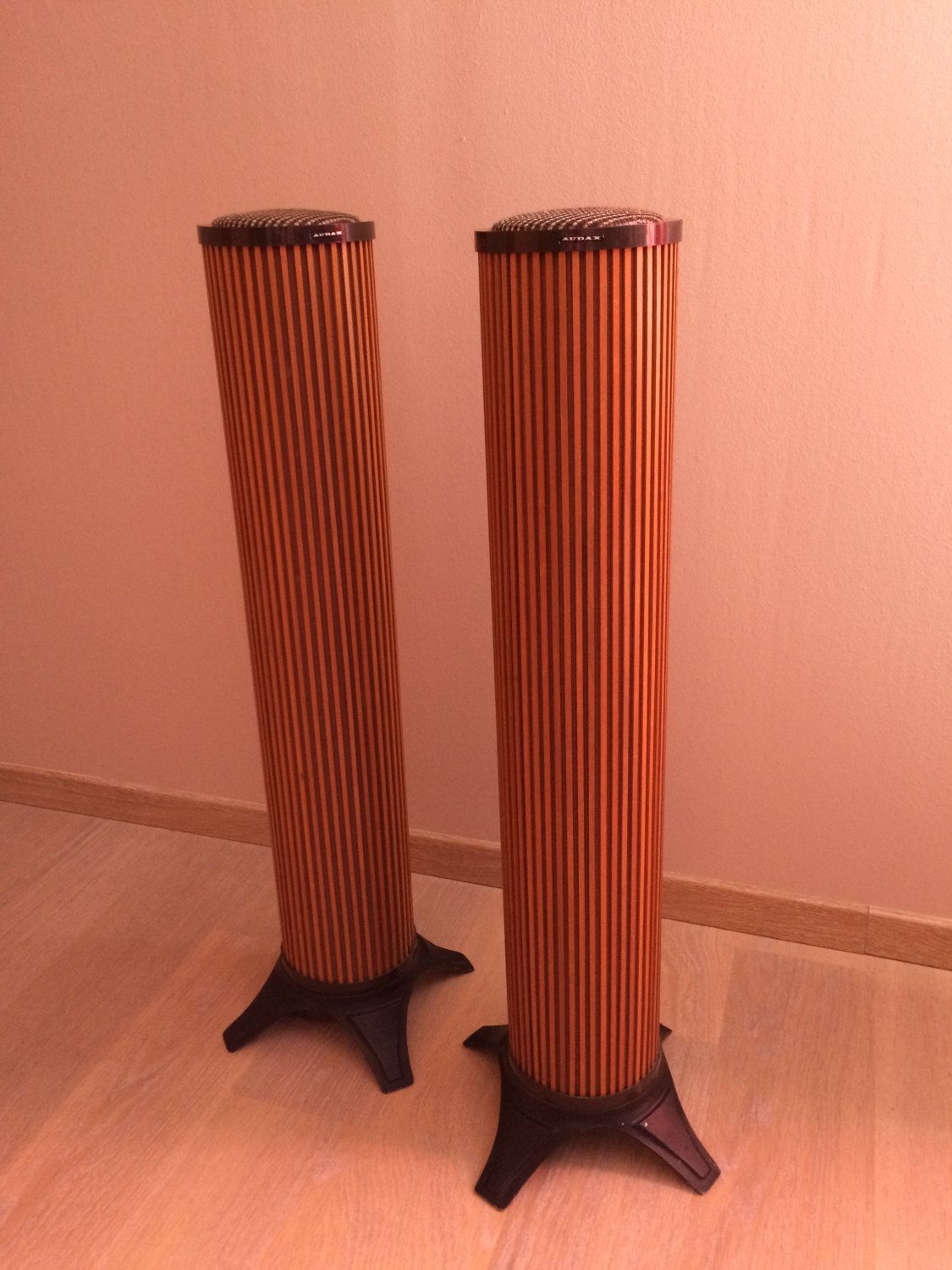

Tube- Audax Super Gyraudax
http://www.hifi-vintage-audiophile.fr/Enceinte-AUDAX-super-gyraudax-de-luxe.html
