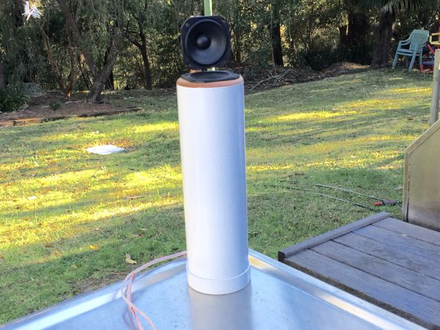

another TC9FD18
xrk971 Flat Wall Mount Stereo MLTL using TC9FD's (2)

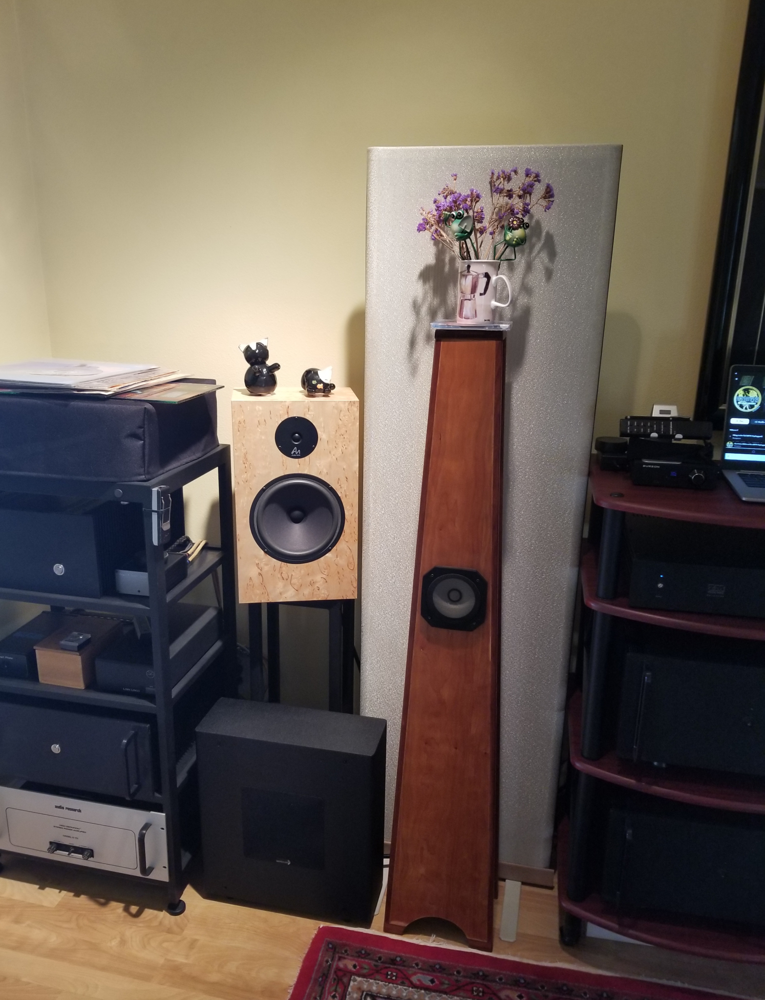

I know your problem as I share it. What's more, I love low power valve amps which tend to work best with large speakers.
My compromise works well and has very good WAF, being just over 8 inches wide and 1 metre tall. Arguably, a tower speaker can be more elegant than a stand mount speaker of the same width as both tend to be of similar height.
Have a look.
If you are interested, I can give full build details. The value is very high as the drivers are high quality but medium price, well behaved needing little correction (just a small cap to fix a very slight peak in the tweeter); can't go wrong.
