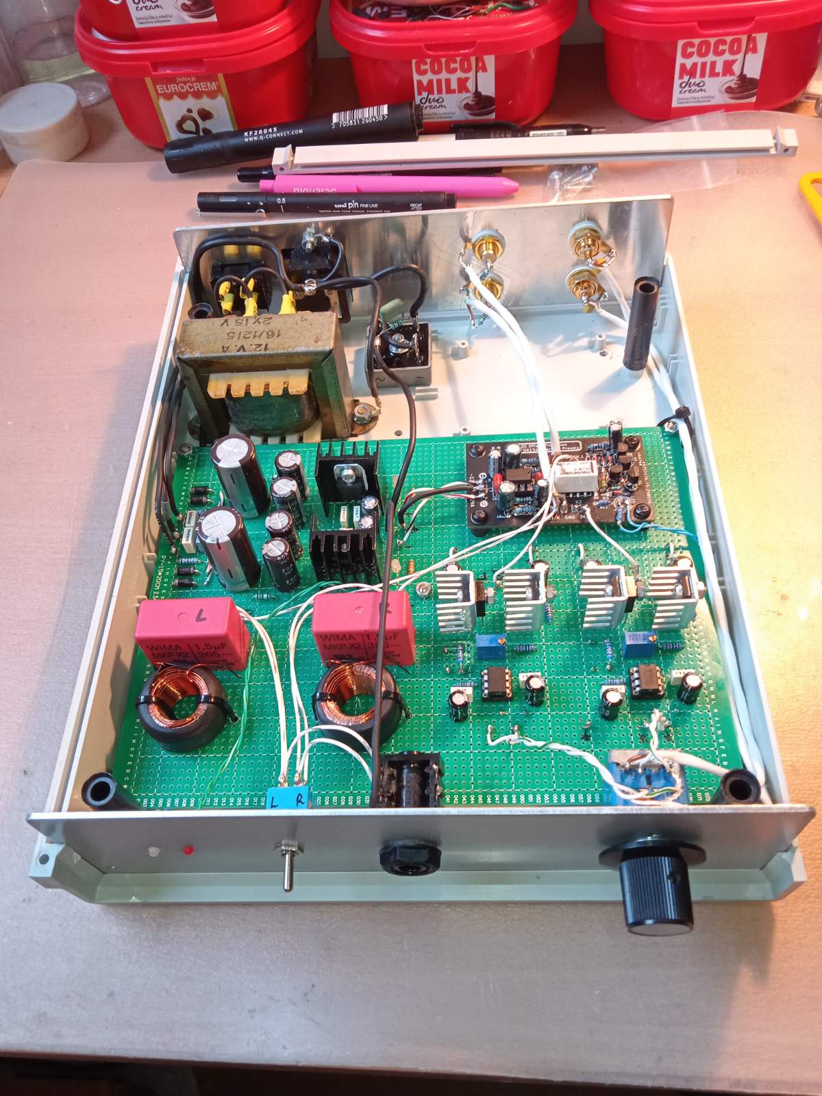

I am looking purely practically, I have various opamps, SOIC and DIP. As much as it's argued, it still doesn't sound the same. Otherwise, I make such simple devices point to point. At least for a test. It's always better and easier to work on a PCB, but for one piece, point to point and you try everything out nicely. This in the picture is very similar, opamp + BJT output stage with VBA multiplier. This is a headphone amplifier. PSU is CRC, and then 7815/7915.Why not, both are abundantly available. Besides almost any decent op-amp will do. I used TL081 and sounds great. I would rather put a dip package and SOIC, it would be easier as pinout is the same, just wider as NIXIE recommends.

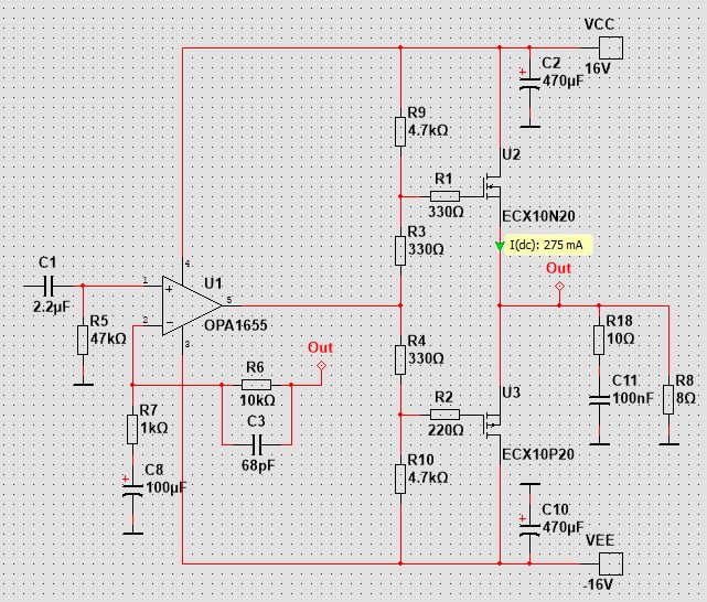

I post my chosen circuit for any newcomers.
This is what we aim for in this thread.
It can deliver 10 Watt RMS into 8 Ohm.
And even more into 4 or 6 Ohm.

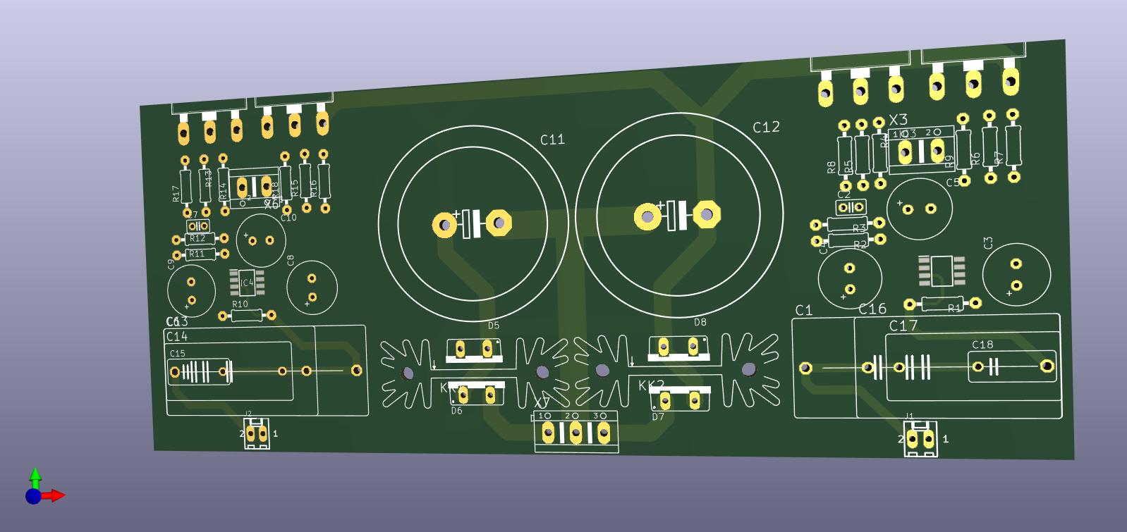

So here we go...
common rectifier - MUR diodes (TO220)
capacitors 35 mm diameter
OP-amp-SOIC
several sizes of capacitors at the input
Question - should the diodes be placed on a common radiator with the power transistors?
Or will I optionally add additional small radiators of the SK104 type, one for each of the two diodes?
OP-amp-SOIC
Add small radiators of the SK104 type.So here we go...
OP-amp-SOIC
Isn't it 4 diodes??
@ZoltanChivay
Look alright to me.
Stereo in one PCB. Super!
Can not see C11 in your PCB. C11 in my schematic. R18 + C11 in the output.
Look alright to me.
Looking good ZC👍🏻
Please add six mounting holes for M3 fasteners to support the board on standoffs.
One at each corner and middle on the long sides.
Yes It's trueCan not see C11 in your PCB
From my experience - it's better to solder zobel network directly on the output terminals
Of course I will add it. It's just the first draft.

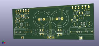

First attempt
Someting like this?
This is a neat, organized layout. Here are some suggestions :
I believe getting the bypass capacitors on the opamp would be a good idea per the manufacturer's recommendations. One of the downsides of using high-performance opamps is that they get more fussy about bypassing and track lengths to the input connections. Most opamp data sheets show a recommended layout near the end of the document. My experience has been that the faster the opamp, the more critical it is to follow their recommendations.
Also, I can't tell, but does the speaker return path go directly to the midpoint of the supplies, i.e., the big power supply filter caps? If the return current shares copper with signal currents, it increases the likelihood of oscillation or perhaps distortion.
Also, I can't tell, but is there a low-pass filter on the input to keep out RF, etc.?
I like this design and am keenly interested in how it turns out.
