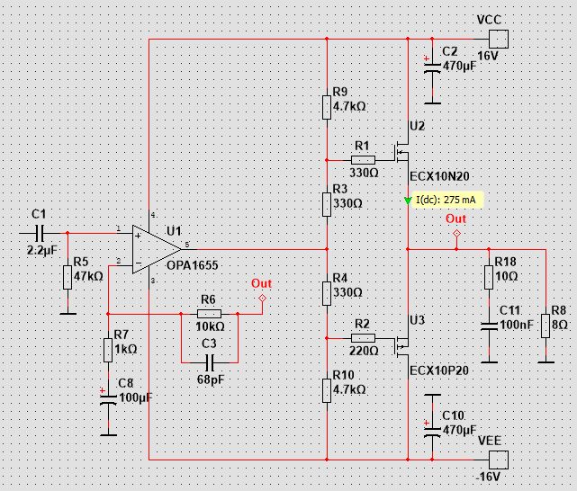

If your sound source has a capacitor at the output (if you are 110% sure about it!) we can skip the input capacitor in the amplifier

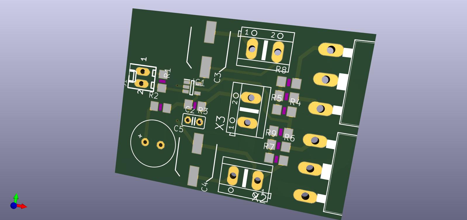

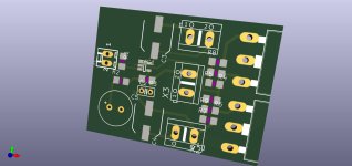

If someone cares about space - here is a mini version with smd elements 48x36mm
I left the capacitor in the feedback through so that I could use green Muse ;-) or something like that
The compensation capacitor is also tht
Most ancillary equipment has output capacitors, I am sure. What is more is that you have an input capacitor in the amp and one in the output of the ancillary equipment is in series and will affect the LF performance. I would say not to add the input cap, it can be added on the input if the user so please. What you think Lineup

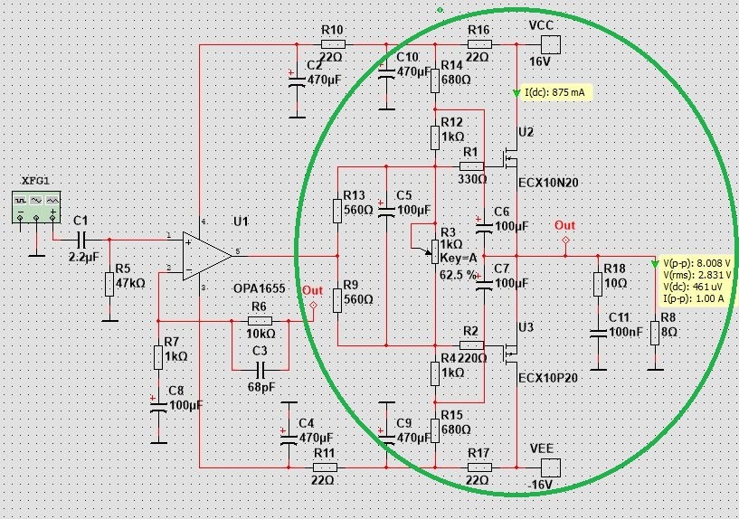

since U2 & U3 gates at input of your A-class OPS are boostraped via C6 & C7 I wonder what is the average OPS input impedance ? , in that configuration I guess that is probably very high ? , but enough high to be well driven with one linear small signal tube ? ,

but still two-layers 😉That is a very nice little board, and will be less expensive.
OPA1655 is available in SOIC.If your sound source has a capacitor at the output (if you are 110% sure about it!) we can skip the input capacitor in the amplifier
Seems like you have added SOT-23 in your PCB.
SOIC it should be
Nice job. Can I ask on behalf of the DIY guys here that may not be able to open the Gerber, to plot a 1:1 negative of top copper, bottom copper (mirrored), and component layout and post it in PDF format, some will want to make their own PCBs at home.
according to the datasheet we have two variants of the housingOPA1655 is available in SOIC.
SOIC it should be
I chose SOT
In soic 3 pins are unused So why bother soldering them?
Only two vias???? 🤣 Why SOT23, because most people here will think it is an ant and try to kill it.
The impedance seen by the opamp output is 7567 Ohm. This is the Class A version posted earlier. With bootstrap.Lineup

At 1 Watt Output 1 kHz in to 8 Ohm
Holy crap that PCB is the same size as the two MOSFET. One can build it inside a headphone cup. This PCB will definitely not impress your audiophile friends so keep the chassis sealed. 🤣 🤣
