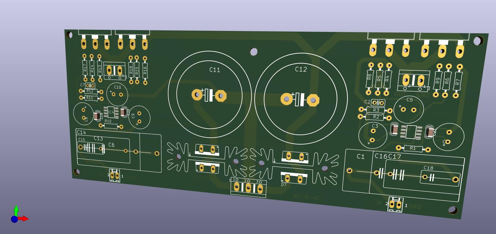

Thanx for Your commentsbypass capacitors on the opamp would be a good idea
Yes-good idea -two small smc ceramic aps near op-amp !
Ask LineUp ;-) Im just pcb-maker 🤣but is there a low-pass filter
There is no need, in my opinion, for a low pass filter on the input.This is a neat, organized layout. Here are some suggestions :
Also, I can't tell, but is there a low-pass filter on the input to keep out RF, etc.?
I like this design and am keenly interested in how it turns out.
Because with that 68pF compensation cap the upper bandwidth is 'only' like 200kHz.
We can say the amplifier itself has a built in low pass filter.
Those afraid can even use one 100pF comp cap.....

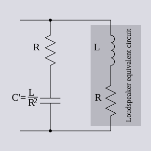

From my experience - it's better to solder zobel network directly on the output terminals
I see. That is okay, Zoltan.
unless you are prepared to model your speaker and cross over, then a Zobel is really a waste of time. It only screws with you response.

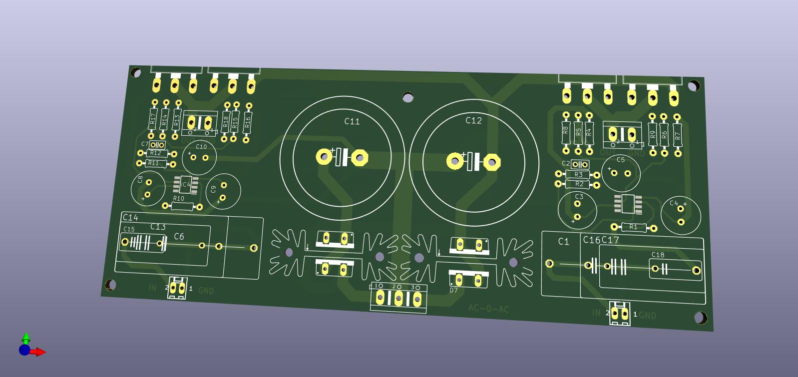

Zoltan, beautiful PCB!! I could not do it better even if I was paid, excellent work. I am proud to know you.
Yes, the PCB is fantastic.

In attachments gerber files, schematic with element numbering and values
I added decoupling capacitors (smd size 1206) around the op-amp
