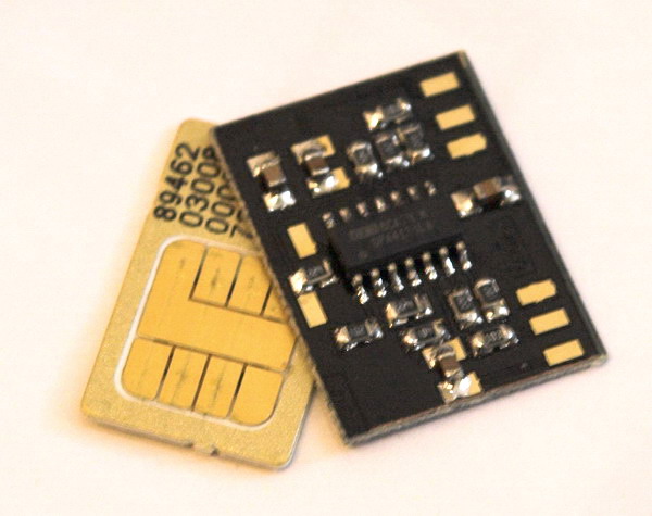

Thought I'd post some pictures of my current project. It is a basic bridge-parallel implementation of the NSC LM3886. I have designed the boards to be as modular as possible. I am at the testing stage.
Pile of unseperated, unassembled boards:
Single amplifier board:
Buffer board:
Power supply board:
Soft start board:
* The 10 pin IDC connector attaches to a uC board, not pictured.
Enough assembled boards for a whole stereo amplifier:
Anyway, really looking forward to testing these. Just waiting on the heatsinks, should be done any day now.

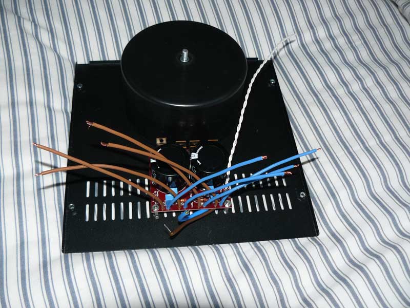

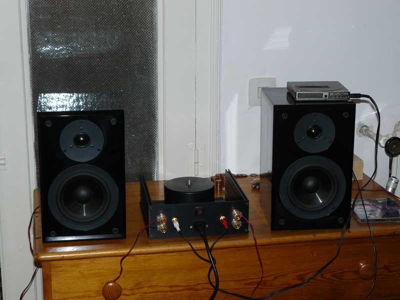

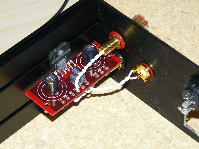

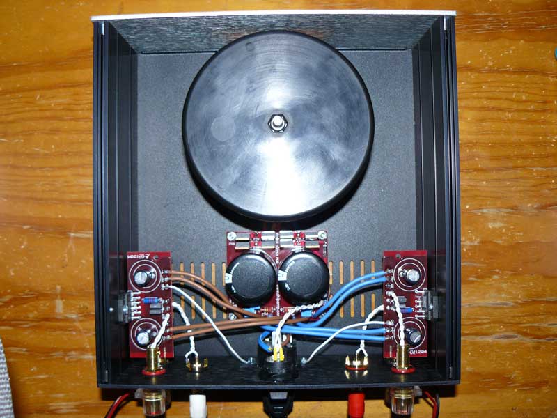

this is a rev.A lm3875 gainclone with PS and a big 300va 2x25v toroid in a hifi2000 enclosure, no pot, planning on using a pre (still undecided, probably a millet hybrid for now...maybe a kumisa soon).
i would apreciate some comments, specially regarding wiring, as i used what i had on hand.
mekanoplastik said:
...i would apreciate some comments.....
A dab of heatsink grease since the chip is on a groove, and a washer to help spread the pressure of the screw holding the chip down.
Those are suggestions, not requirements.
I "personally" would have used different color wires for the ps to avoid potential confusion but then, some times I can be... well, you know.
Absolutely beautiful execution.
