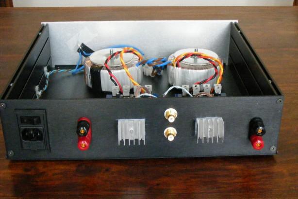

I have finally finished my Peter Daniels LM3875 Premium kit. It is a dual mono setup, with a passive pre (pot in a box type). I had a few minor issues with ground hum, but I sorted it with heavy duty ground cables and 10 Ohm ground lift resistors on each channel.
My total spend on the Gainclone and Pre was around the £150 mark, and well worth every penny. I could have spent more by using more expensive components, i.e Black gates in the PSU rails (not everyones cup of tea) or a more expensive case, but on balance I think I got the mix right. Sound for pound/bang for buck, the Gainclone has to be up there with the best.
The cases are from hifi2000.com (Italy) and the transformers are 18V/120VA from RS Components (UK). I used an Alps Blue 50K dual log pot for the volume control (HiFi Collective)
My review,
Kit, Lightly modded NAD C520 (Schotky diodes, Black gates in output, Muting transistors removed, NE5532 Op Amps replaced with LM4562NA Chips), NeoTech/Puresonic IC's, Wharfedale Diamond 8.3's with IXOS Bi Wire cables, Olson mains conditioning block. Test track's, Leftfield - Phat Plannet, Dark Side of the Moon - Speak to Me/Breathe/On the Run/Great Gig in the Sky, Led Zeppelin - Kashmir/Over the Hills and Far Away, Holst - The Plannets (Mars).
This Gainclone produces an open and detailed sound. The timing is precise, with no mushyness in the top end. Cymbals and snare drums are faithfully reproduced and vocals are clear and precise. Mid's and high's are especially open and detailed. Bass is a little lean, but well presented and controlled. IMO
I am more than happy with the amp. For a first attempt at DIY, I am blown away with what is possible for just a small outlay.
The picture on my previous post is a bitt naff, so I have enclosed another.
As you can see, I have only used small external heat sinks. The 3mm aluminium panel seems to do a good job. Even if I listen at high volume, it doesn't get too hot.

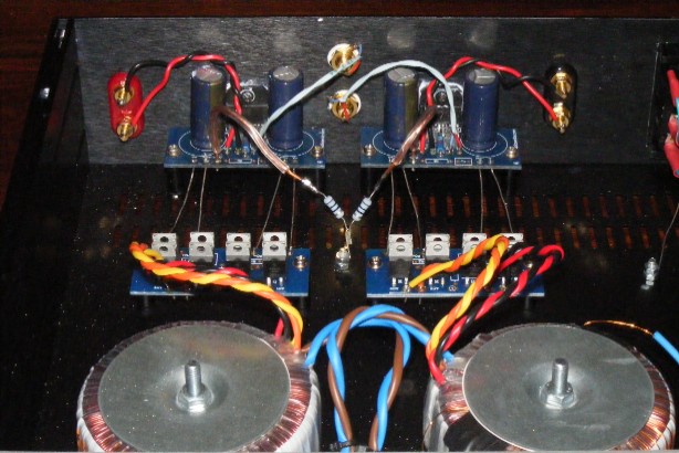

I can't seem to post more than one pic at a time so here is my last picture.
You can see the ground lift resistors in the middle of the picure. Also, on the R/H transformer you can just about see the extra winding for the blue LED on the fromt panel (18 turns of insulated copper wire, directly soldered to the LED).

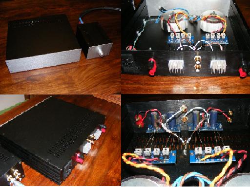

Peter Daniels LM3875 Dual Mono Classic Kit.
300VA torroid with 2x21 on the secondaries.
Built to my lancetta's with a sensitivity of only 80 dB/2,83 V.
My first intention was to run the speakers with my sonic t-amp but not surprisingly the load was to heavy. Bass was close to zero and midrange was hissing ugly .
The gainclone sounds great! I have read that gainclones doesnt come along with heavy load speakers but mine seems to do the job just fine. Could need som more bass though. If I "cheat" and use an equalizer (i use my laptop as source) the chipamp delivers bass the way i like it but it doesnt seems right to shape the signal before i send it to the gainclone...
Maybe a big buffer will help.
The case is oak and aluminium.
I have left som space in the front for a volume pot and maybe some other bling bling.
