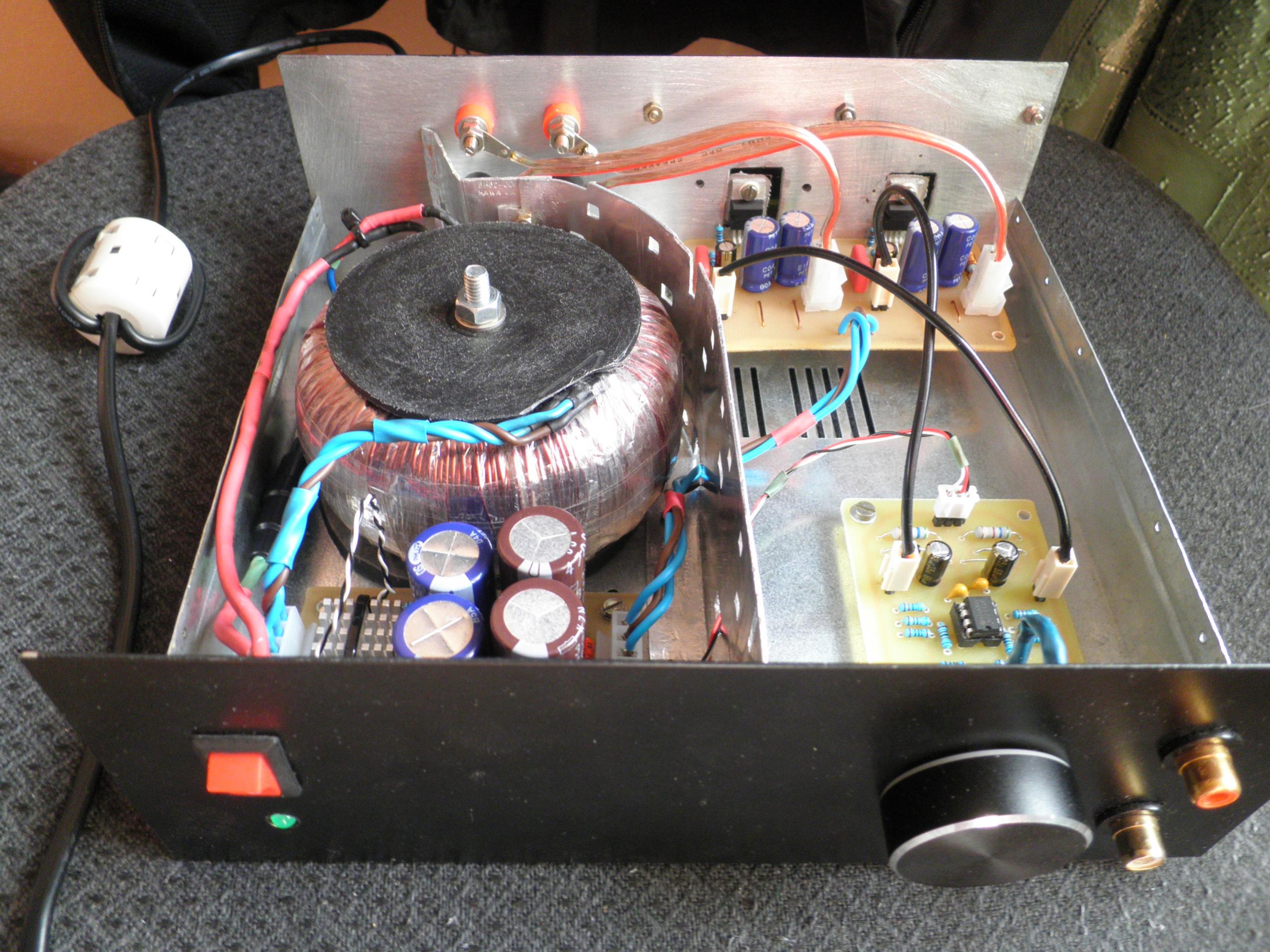

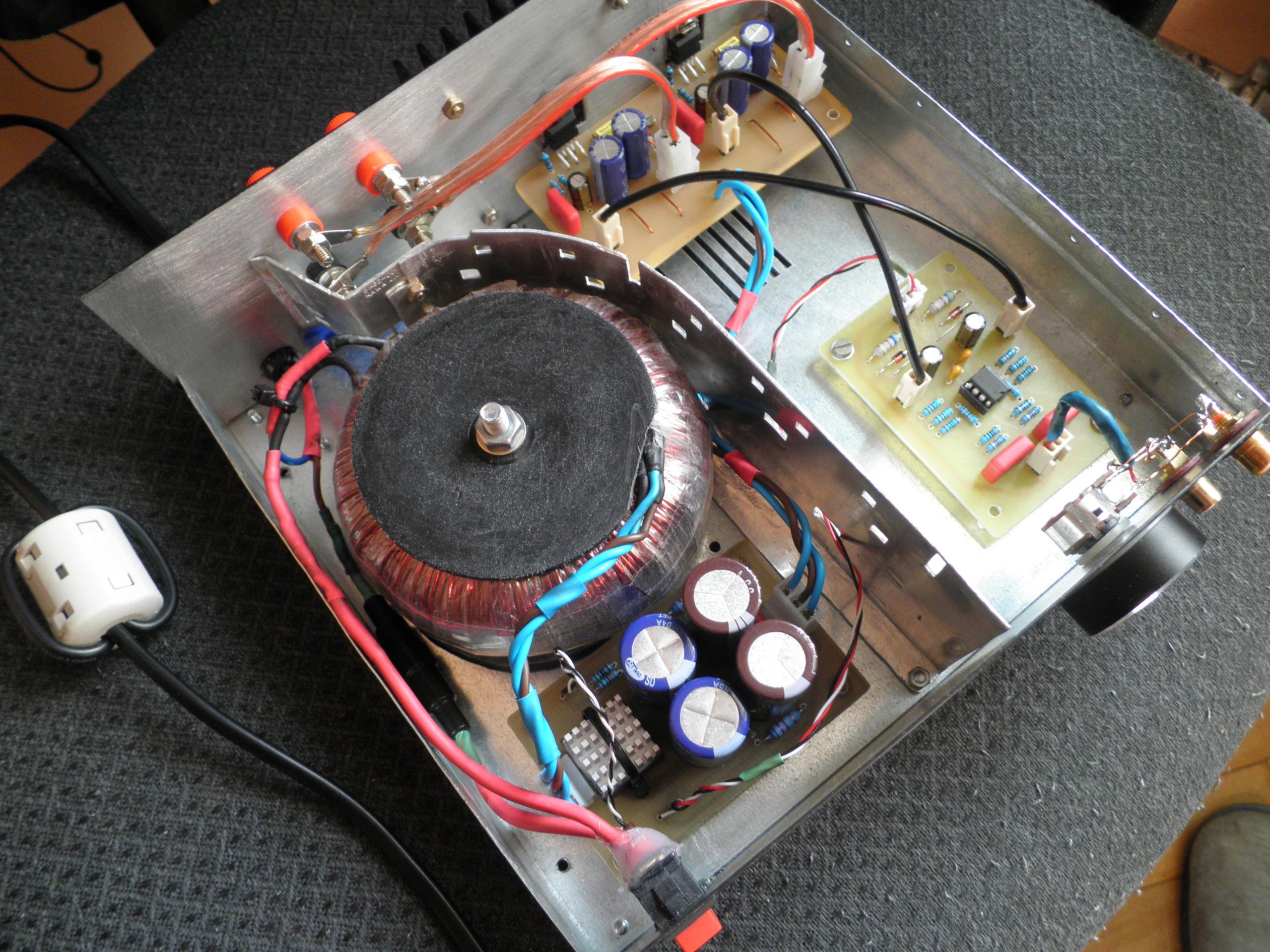

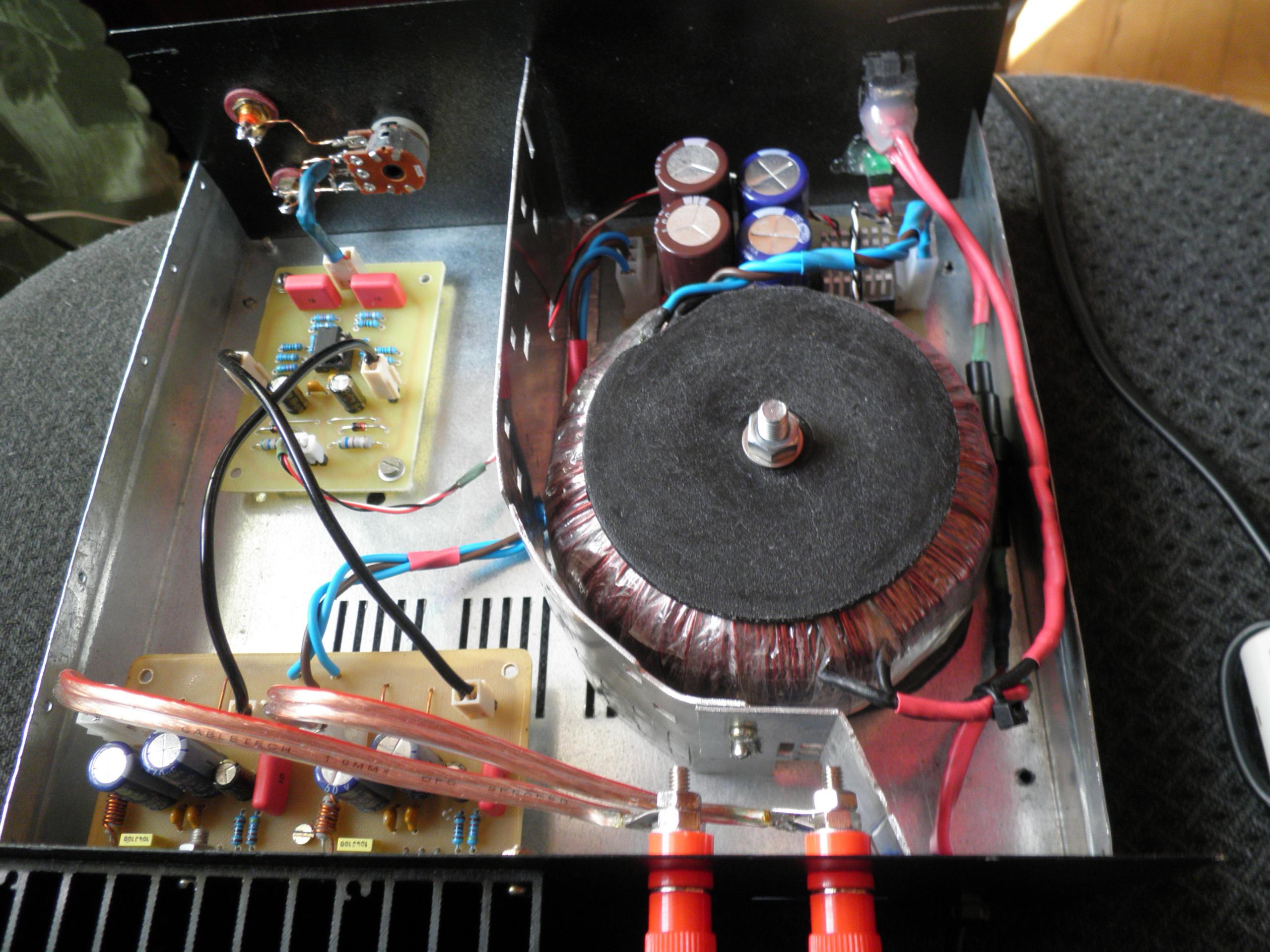

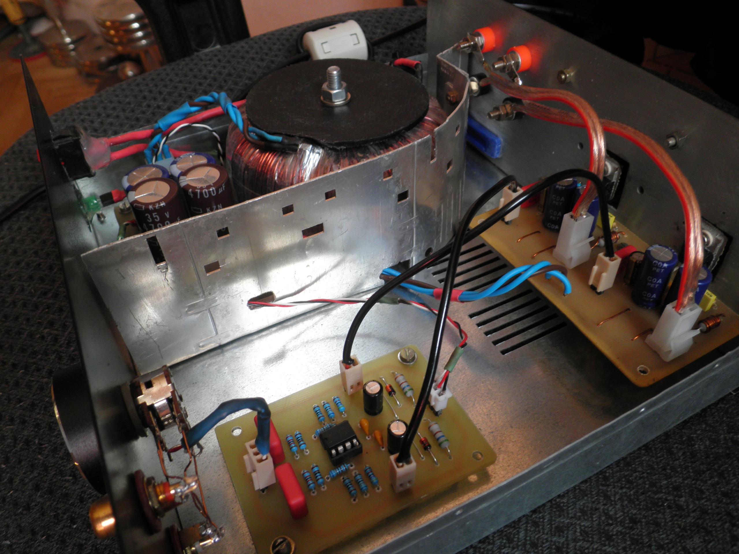

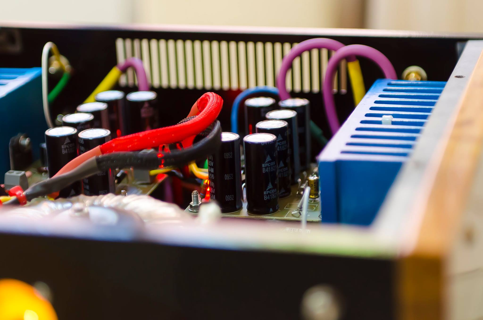

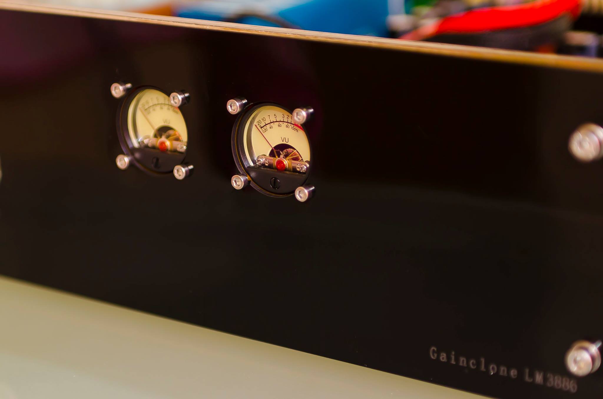

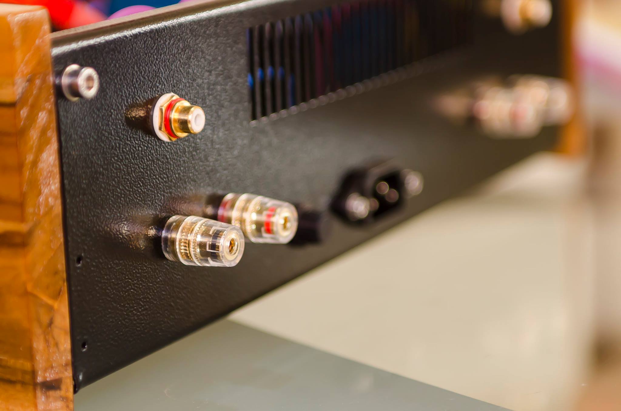

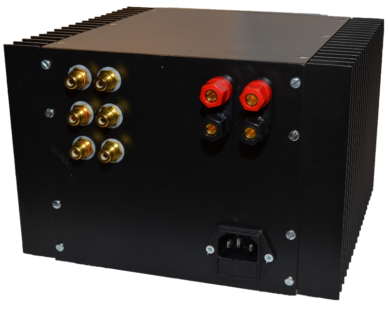

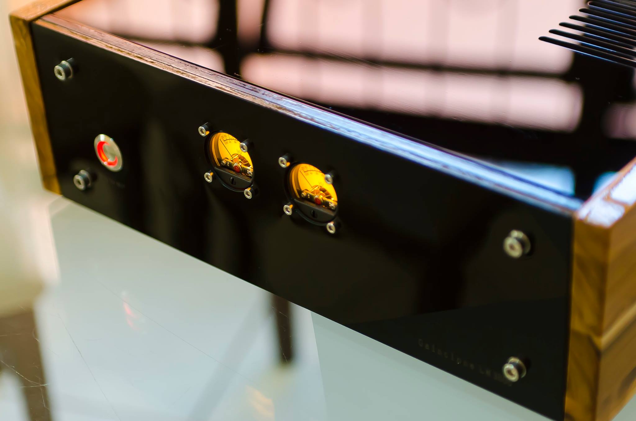

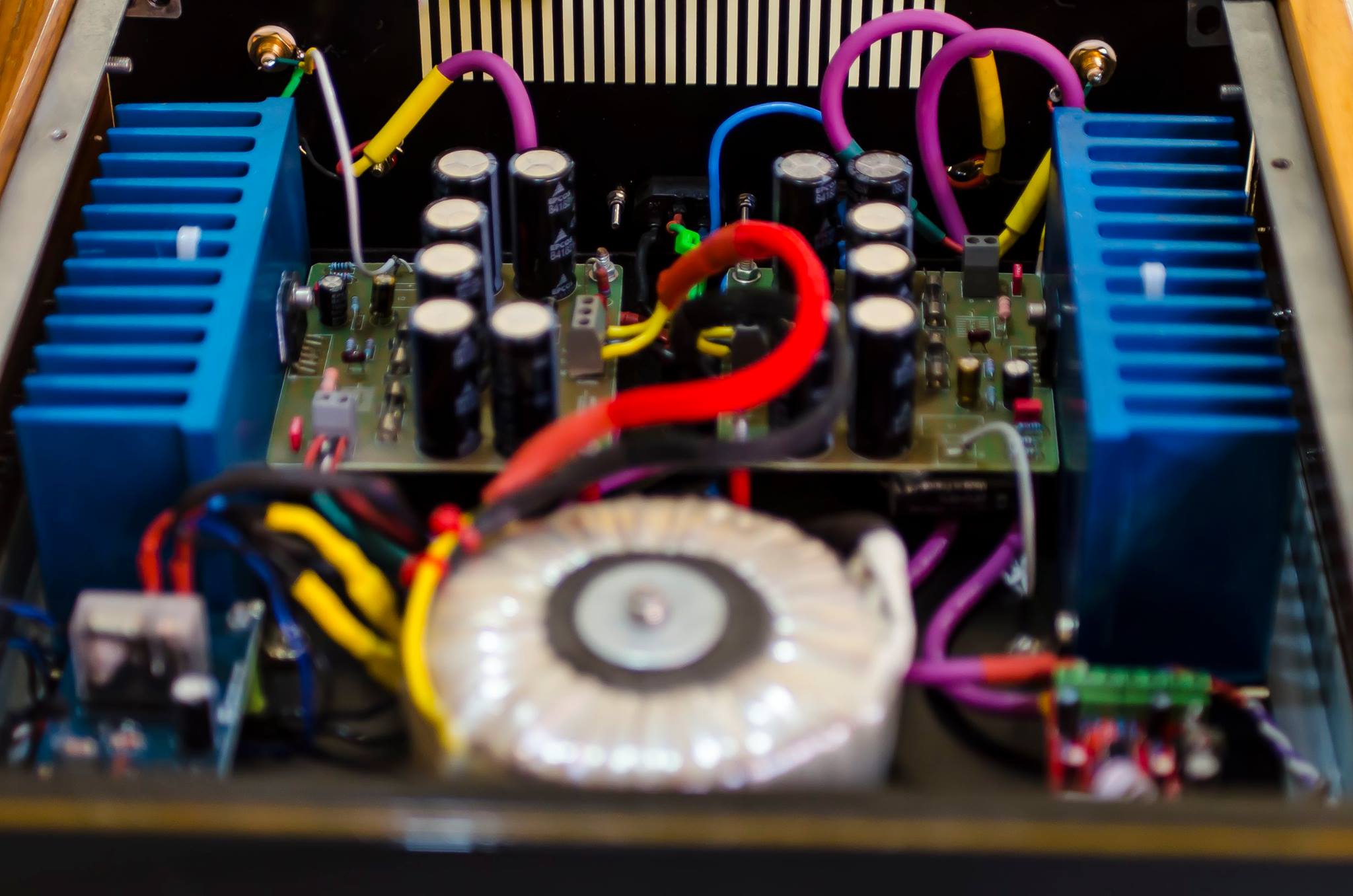

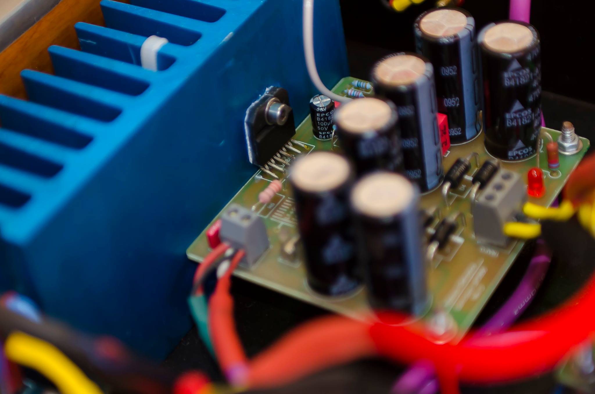

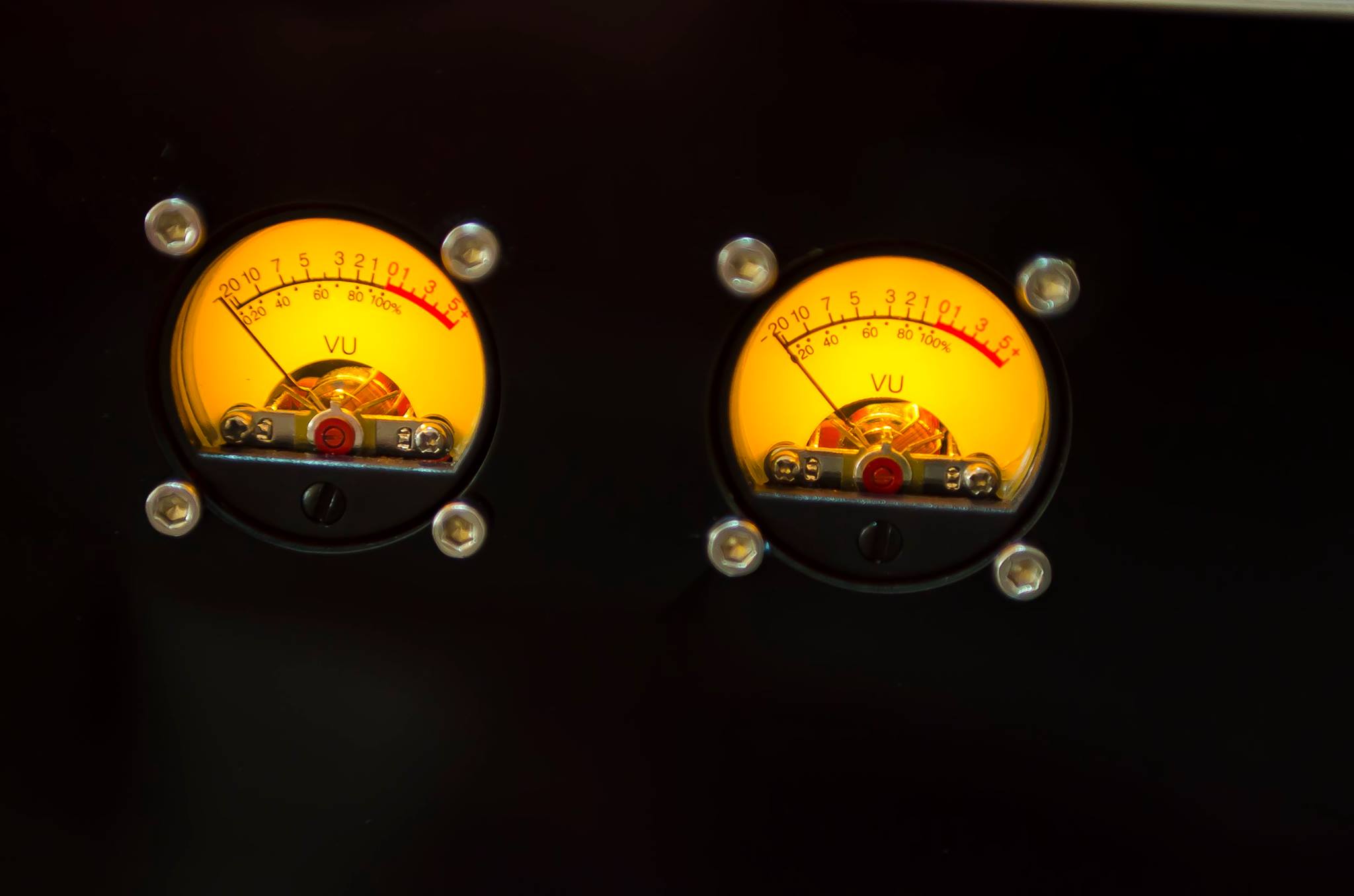

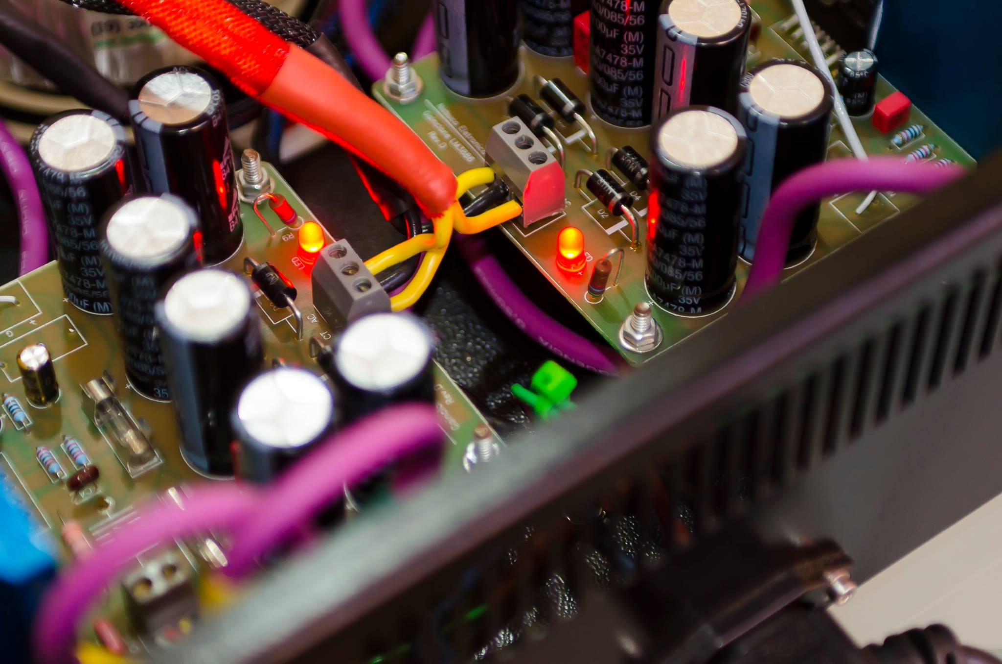

Some pics of my LM3886 composite amp I finished last year.

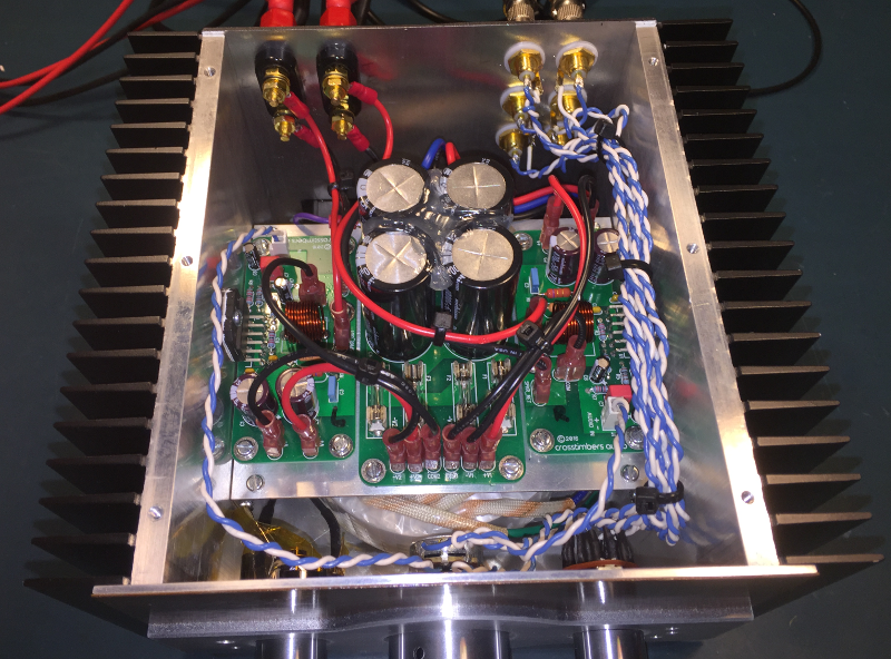

LM3886 Stereo Amplifier
Here is a stereo amplifier based on the LM3886 that I completed a couple of weeks ago. There's more information on my website at crosstimbers audio – Crosstimbers Audio
It's the first LM3886 I've built. So far I've been very happy with it.

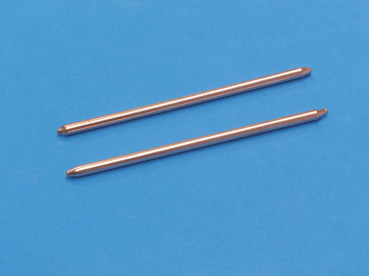

Hi,Hi Pjotr. I just finished electrically a PA03 chipamp. Building an enclosure is my next and final step, apart of replacing the OPA134PA opamps with BursonAudio V5's.
Can you give me a hint where to look for heatpipes. This would reduce the size of the enclosure significntelly!
I got these heat pipes from Farnell (Newark) as straight 6mm x 150mm pipes: SF-06-150-S - EUROPEAN THERMODYNAMICS - Heat Sink, Heat Pipe, Copper, 150 mm, 6 mm | Farnell element14 But those are widely available from Mouser DigiKey etc.
Those 6mm pipes can handle 18 - 20 watts each at room temperature. So for a LM4780 you will need 4 I guess. Be careful, it is not easy stuff to bend/handle. The wall thickness is about 0,2 mm so they dent easily and need special tooling for bending. Best is to get them ready made from the PC modders scene complete with mounting plates.

thanks a lot!

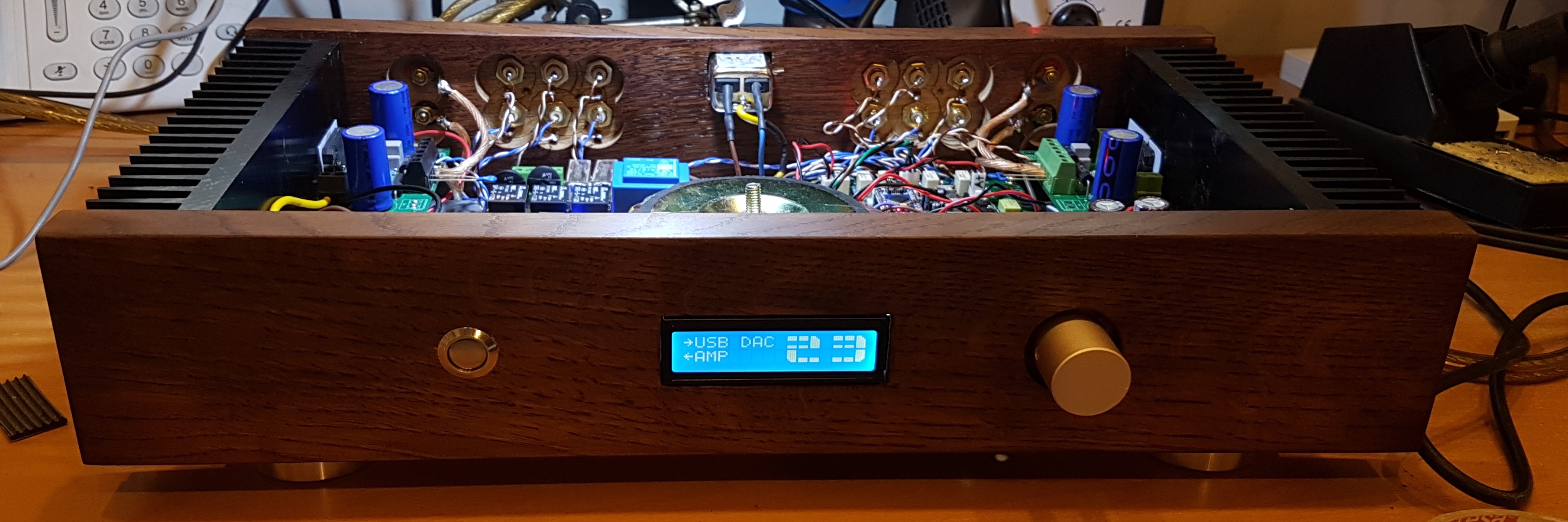

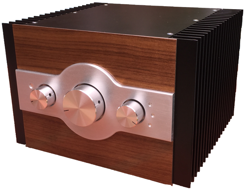

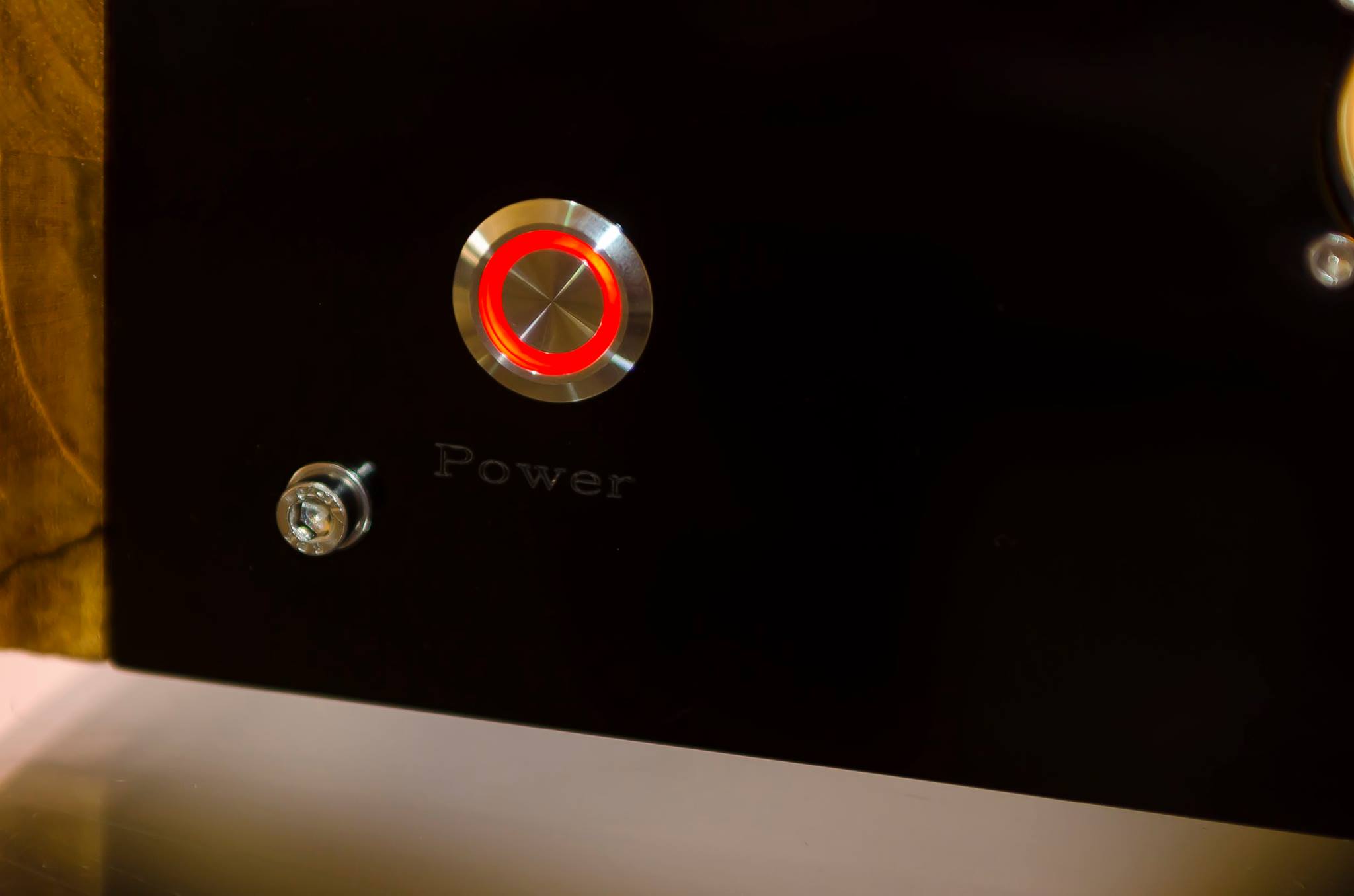

Gainclone revisited, new box and integrated with VxD LDR passive preamp.
Looks nice,Whats the top cover made of wood ? and how to do you attach it ?
Thanks. Heatsinks and wooden front/back are sitting on a steel plate, fixed with screws. Top cover will be steel too.
Sent from my SM-G935F using Tapatalk
Stands out by simplicity. Really nice work! I like the way how you implemented "big" characters on the LCD screen.
Top plate finished too.
