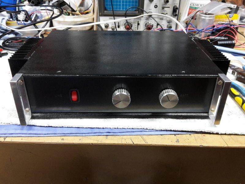

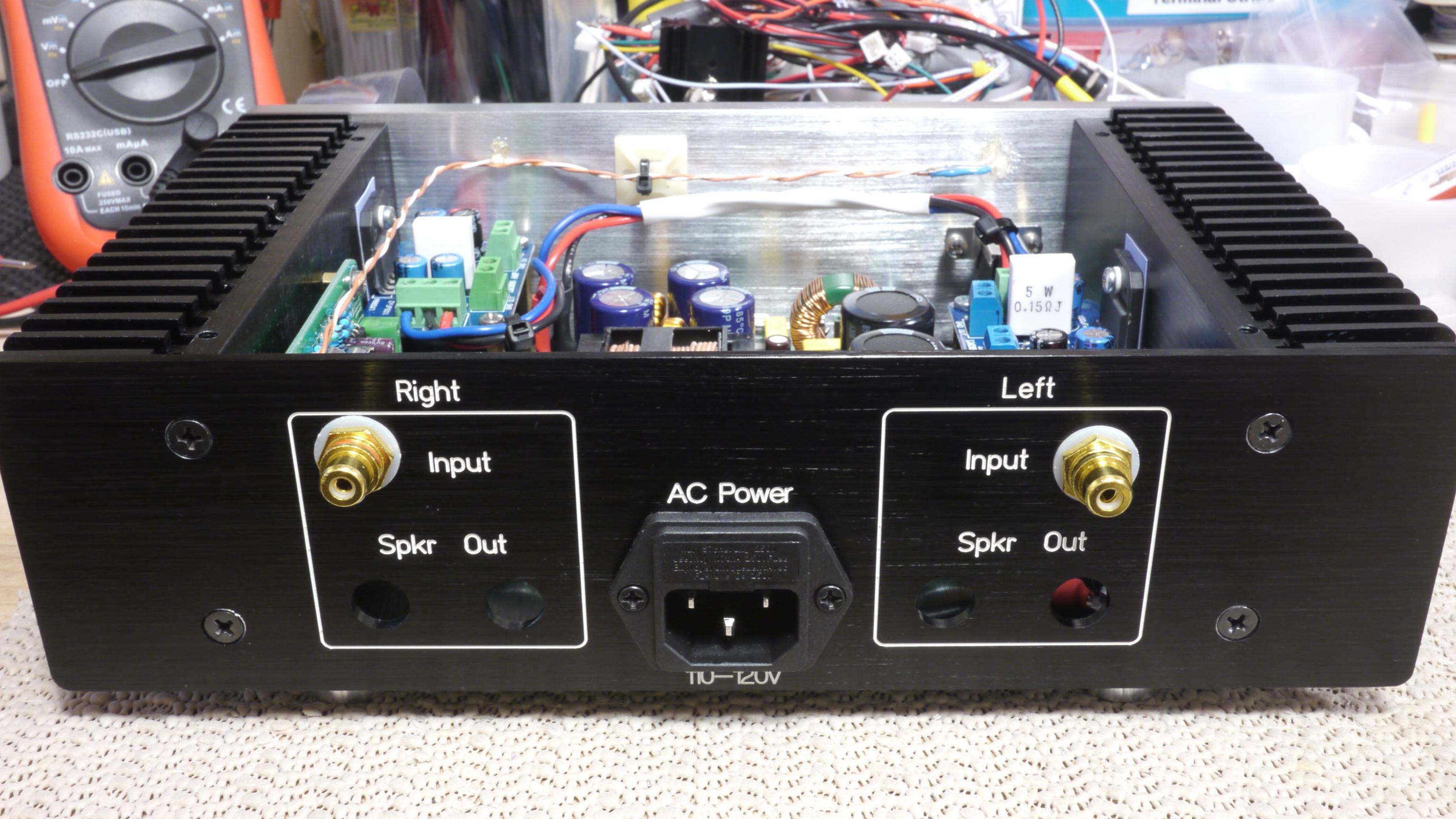

Here are some pics of my most recent chipamp build. I'm calling it the Mini 3886.
Rick
Rick

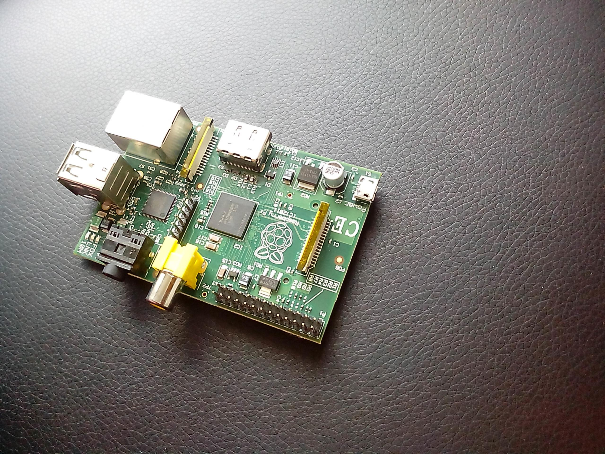

I have at hand one brand new old model - do not know whether suits - E2212RSV1.08 1.1. Please advise what else I need to buy in order to follow the project. The idea is to watch and listen to my concerts and manage the content of my SD cards /or hard discs/ by remote using the TV /hdmi/ for reaching the files and playing through DAC.

I think it is PI ?
I haven't seen that one. Digital out?
It looks like a Raspberry Pi ver 1. Go to the raspberry pi site for spec details and info re pins.

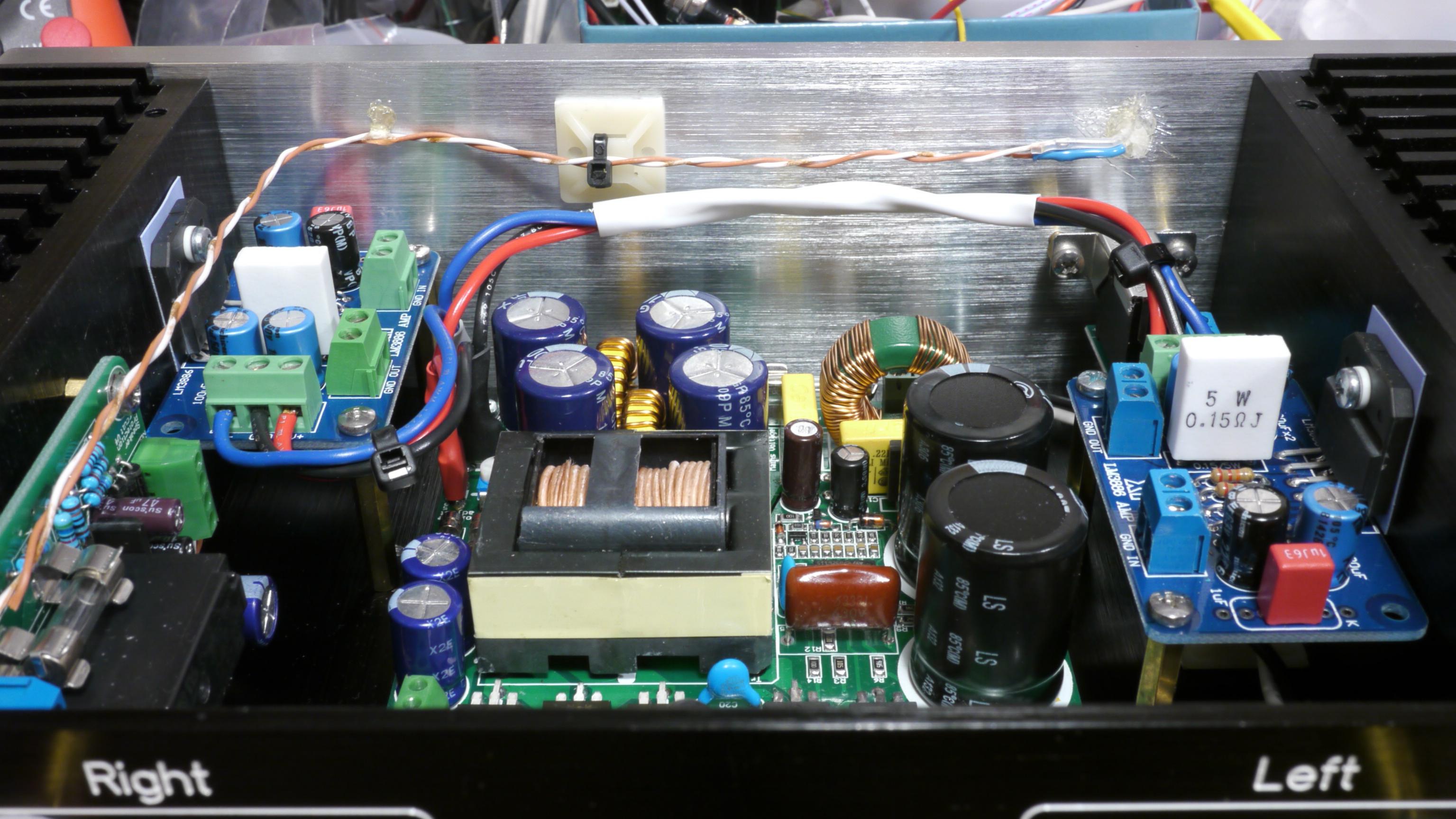

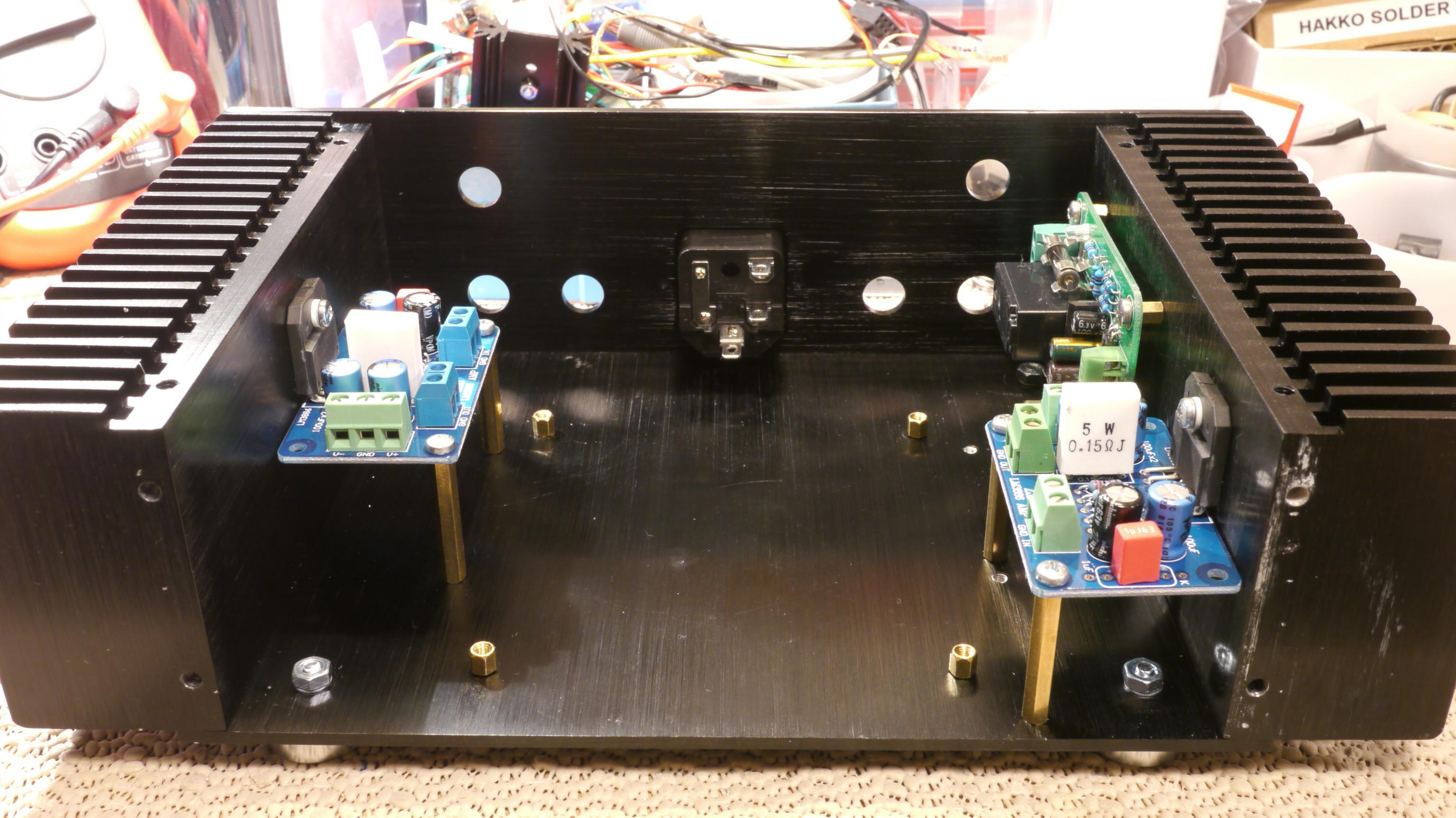

Rick

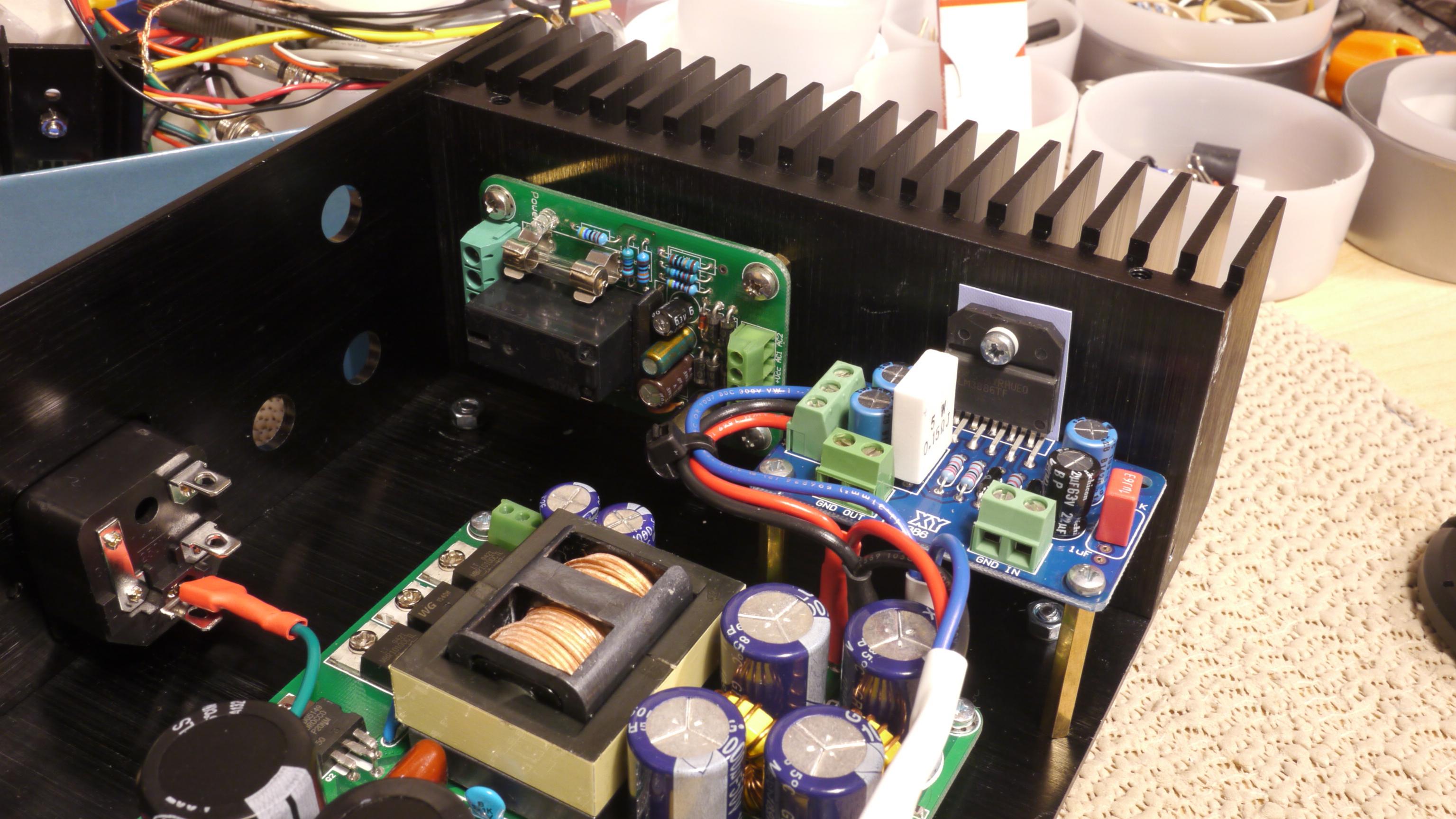

how is the switching PSU doing in this amplifier? no problems with high frequency noise?
I've had no 'audible' issues with using an SMPS. Most of my chipamps use an SMPS, except for the PA03, LM4780 I built last year. The PCB already had an on-board rectifier and filter caps, so I went with a linear in that case.how is the switching PSU doing in this amplifier? no problems with high frequency noise?
I find SMPSs much smaller, efficient and easily work well with these smaller amps. Especially, if you want to design something with an overall smaller footprint.
Rick
Nice build 🙂
Sure those are easy to work with and cost effective too. But regarding size you are still wasting space, you don't need that much heat sink for 2x LM3886. Putting them side by side also minimizes common ground issues with a single PSU. I guess my 2x mono build is about the same size (320 x 70 mm's): http://www.diyaudio.com/forums/chip-amps/79303-chip-amp-photo-gallery-75.html#post4663745
Rick
Yeah, I know the heat sinks were overkill, but the only small case I had on hand. 🙂 They'll never get hot, much less warm!Nice build 🙂

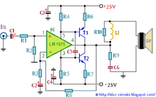

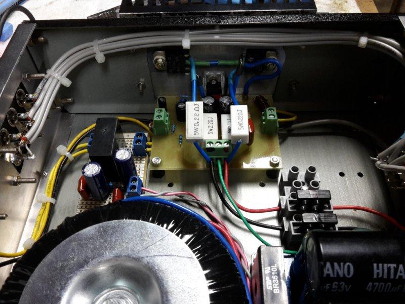

Boosted LM1875 Amplifier

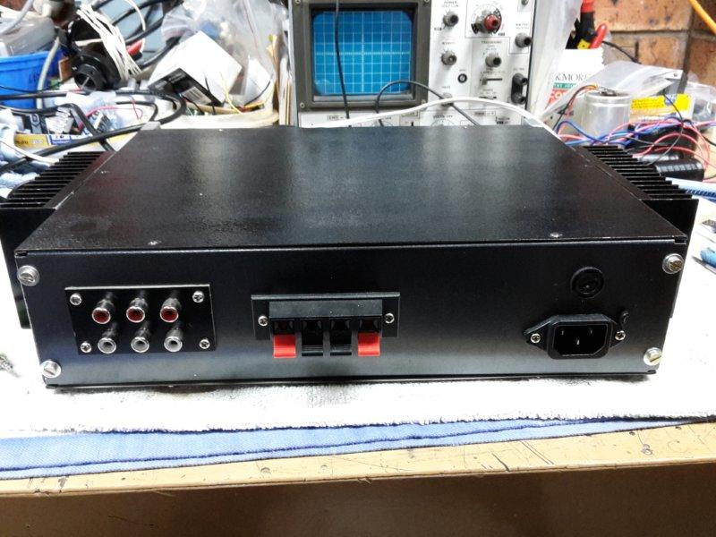

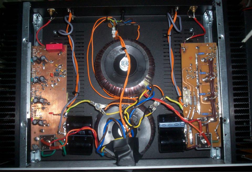

I have used an old kit from Jaycar/Dick Smith electronics called "The Schoolies Amplifier" (some DIYers in Australia will know this kit) which was very popular as a novice project for schools to build a DIY amplifier. I had some PCB'S lying around and saw it was very easy to modify and implement booster transistor outputs to improve the output especially at 4 ohms. This amplifier works a treat!. You still have all the great benefits of the LM1875 with gain, thermal protection etc. I am running this amp at +/- 29 volts which is the upper most limit of the chip. Into 8 ohms there is not much difference. I get 46 volts peak to peak which equates to around 33 watts RMS and at 4 ohms it is boosted to over 40 watts RMS (depending on power supply this can be more) Stand alone this chip fries at 4 ohms. It is not recommended to drive 4 ohm loads at that voltage level. But with the booster transistors most of the load is carried by the output transistors. Distortion figures are improved marginally and measure at about 0.015%.
Q1 = 2SC5200What are the power transistors?
Q2 = 2SA1943
Smart,
thanks for the link. Pity Billbo did not show that.
Q1 = 2SC5200
Q2 = 2SA1943
Smart,
Thanks to Google!
One must read the comments section below. It seems there are some mistakes in the PCB layout. But I am not sure.

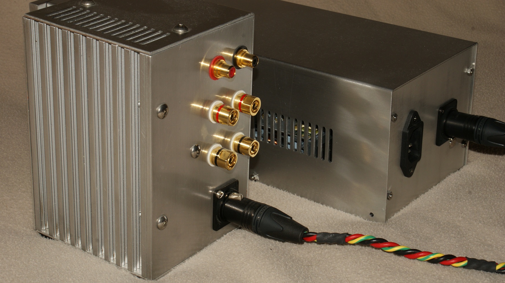

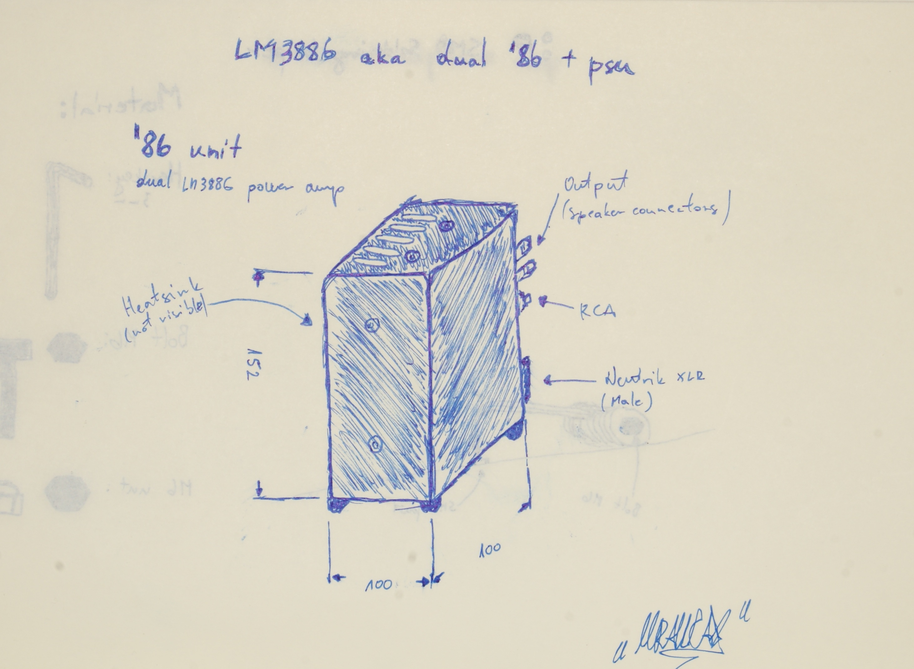

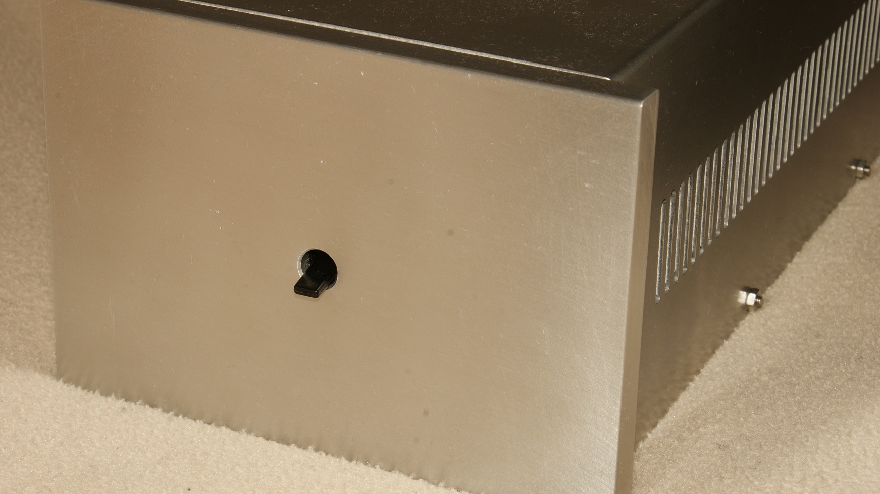

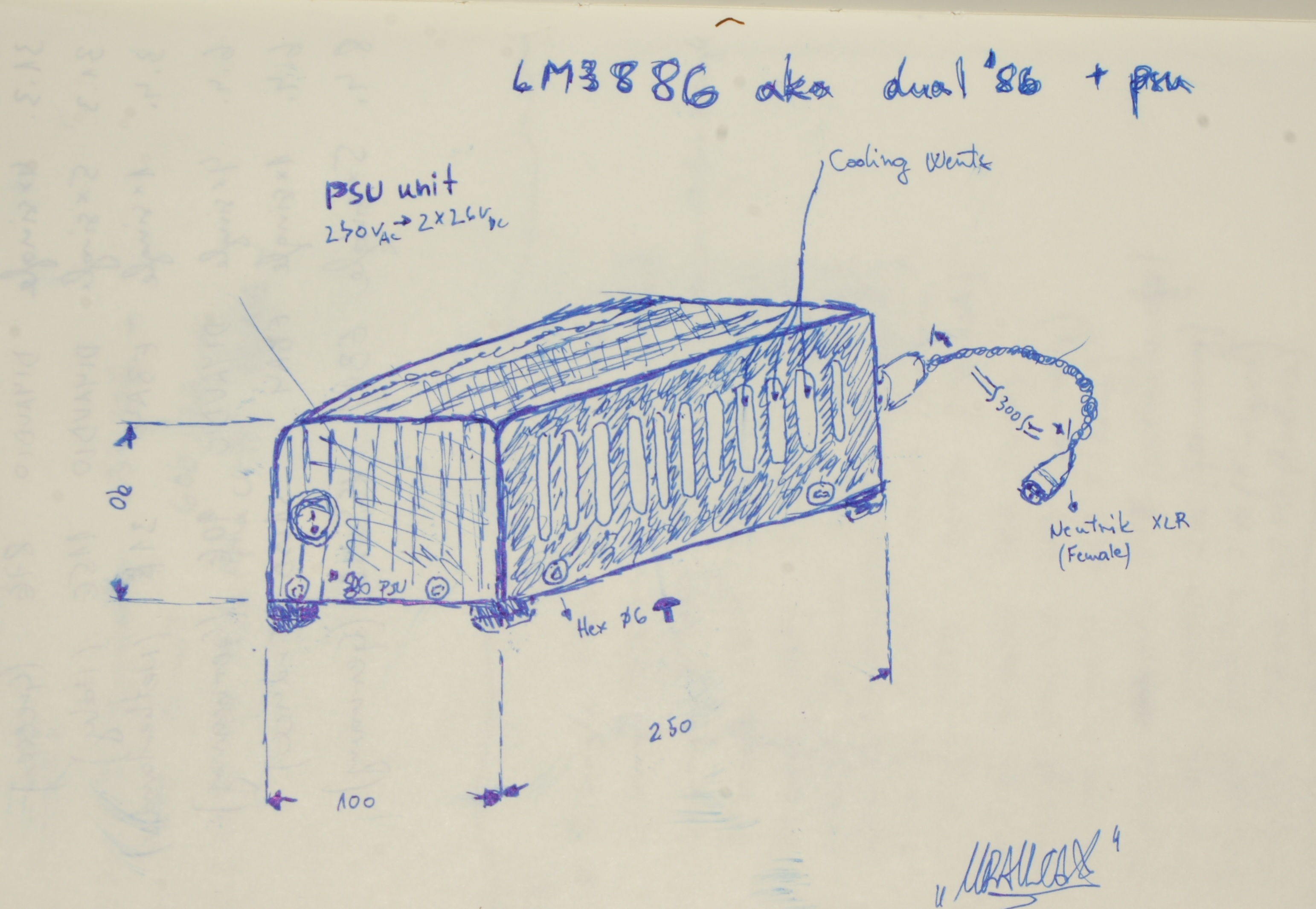

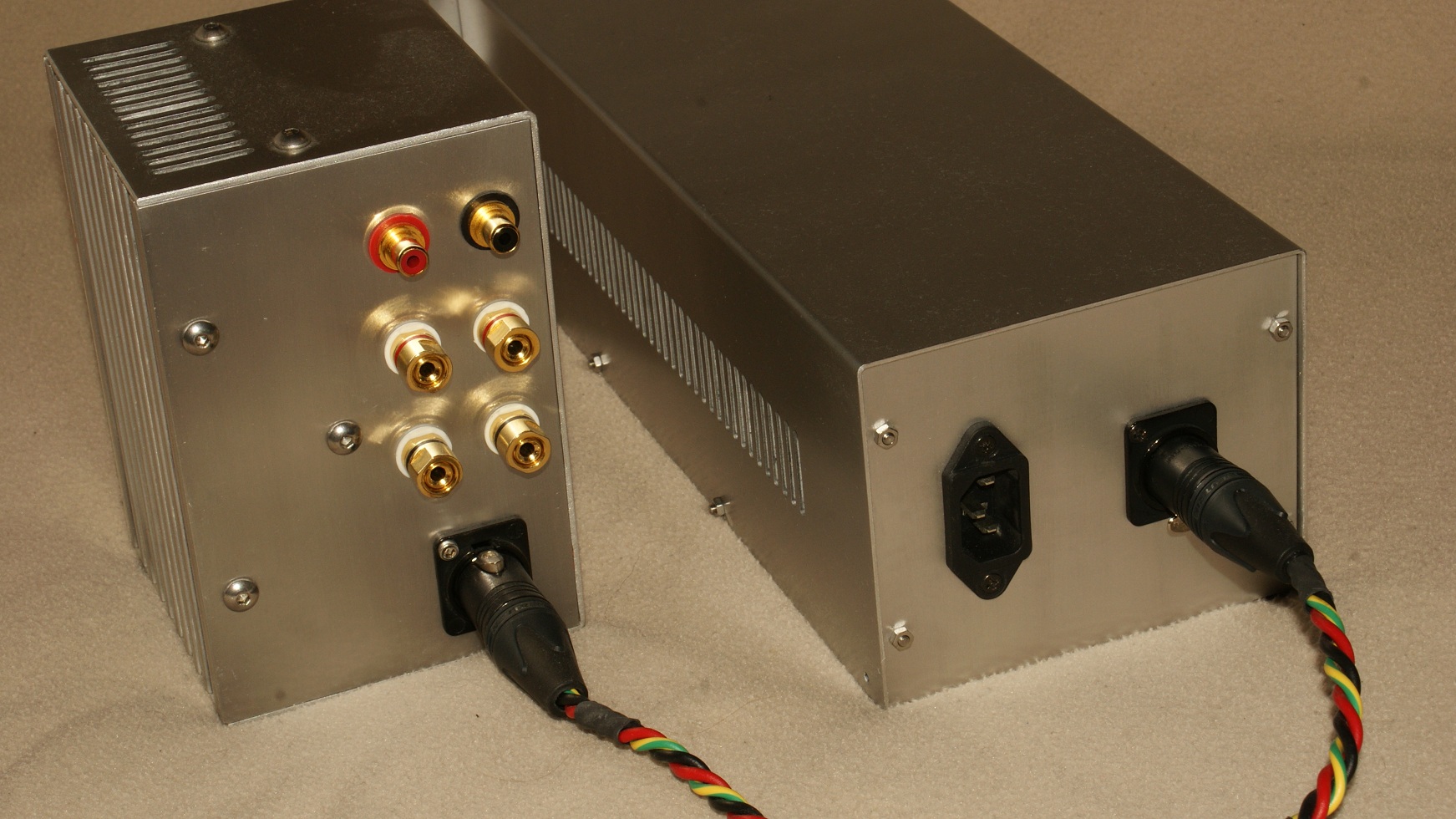

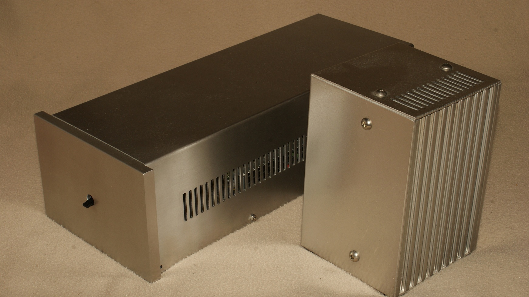

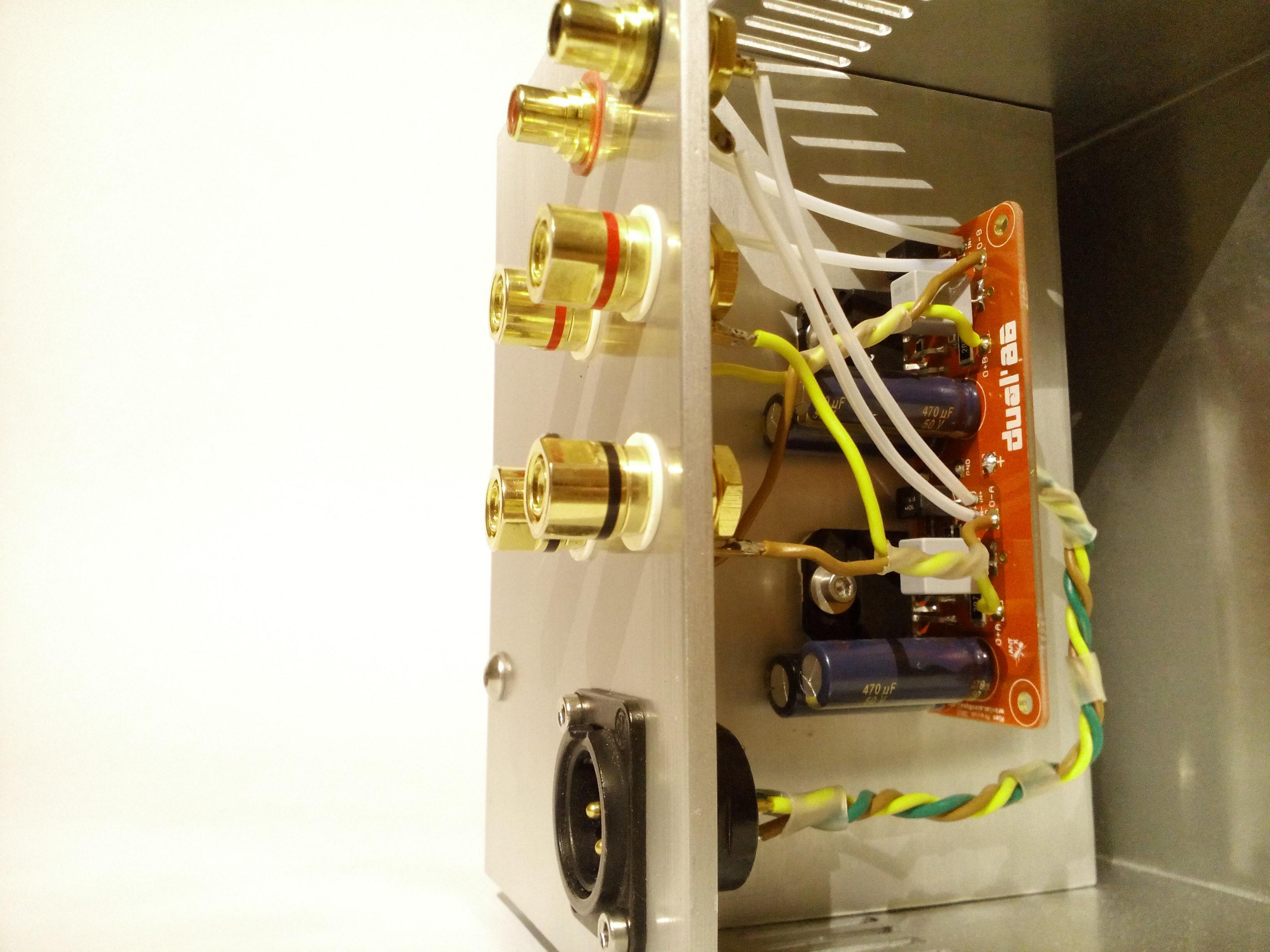

DUAL '86 stereo amplifier

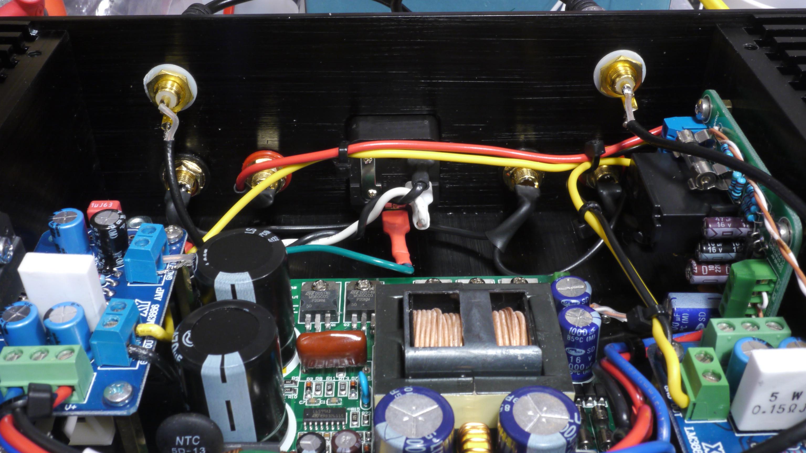

A while ago I finished my LM3886 amplifier. Power supply is in separate casing and it is made out of two Meanwell LRS-150-24 SMPS. On the PSUs outputs there are also two Panasonic FC 3300uF 35V capacitors bypassed with 100nF MKP1837. LM3886 PCB is my own design and you can find out more here: http://www.diyaudio.com/forums/chip-amps/267709-lm3886-smd-components-10.html. I have no hum or noise coming out from speakers and I am very pleased with the sound.
BR,
Aleš
p.s. M3 nuts on PSU will be replaced with decorative ones.
BR,
Aleš
