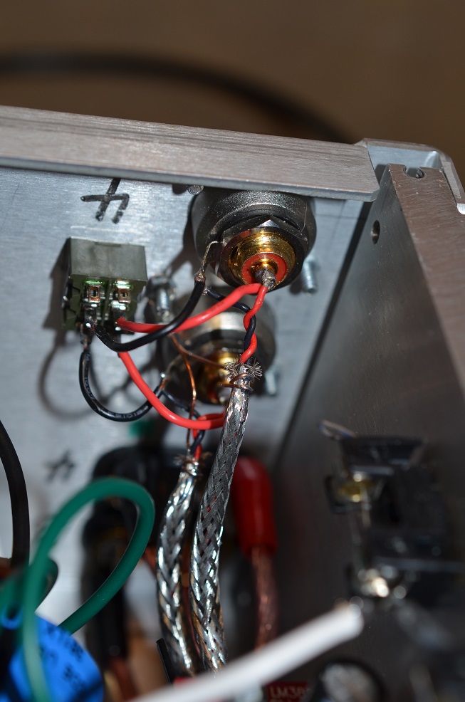

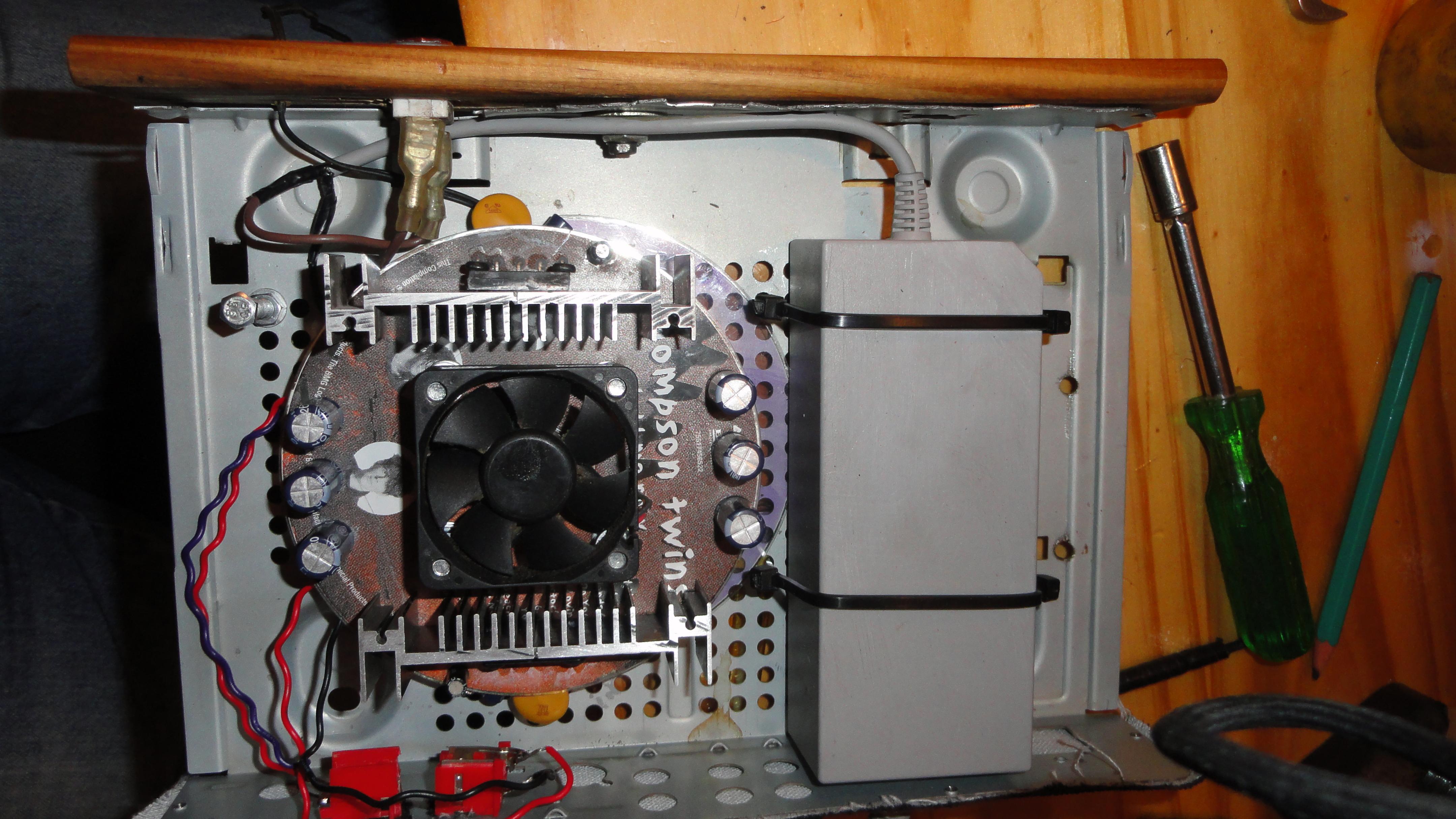

Hi Jeanie. The original build had a slight hum. The new build does not. I never found out what caused the hum. I suspect it may have been ground wires too close to the transformer. input wires were not shielded in the original, either. Now they are.

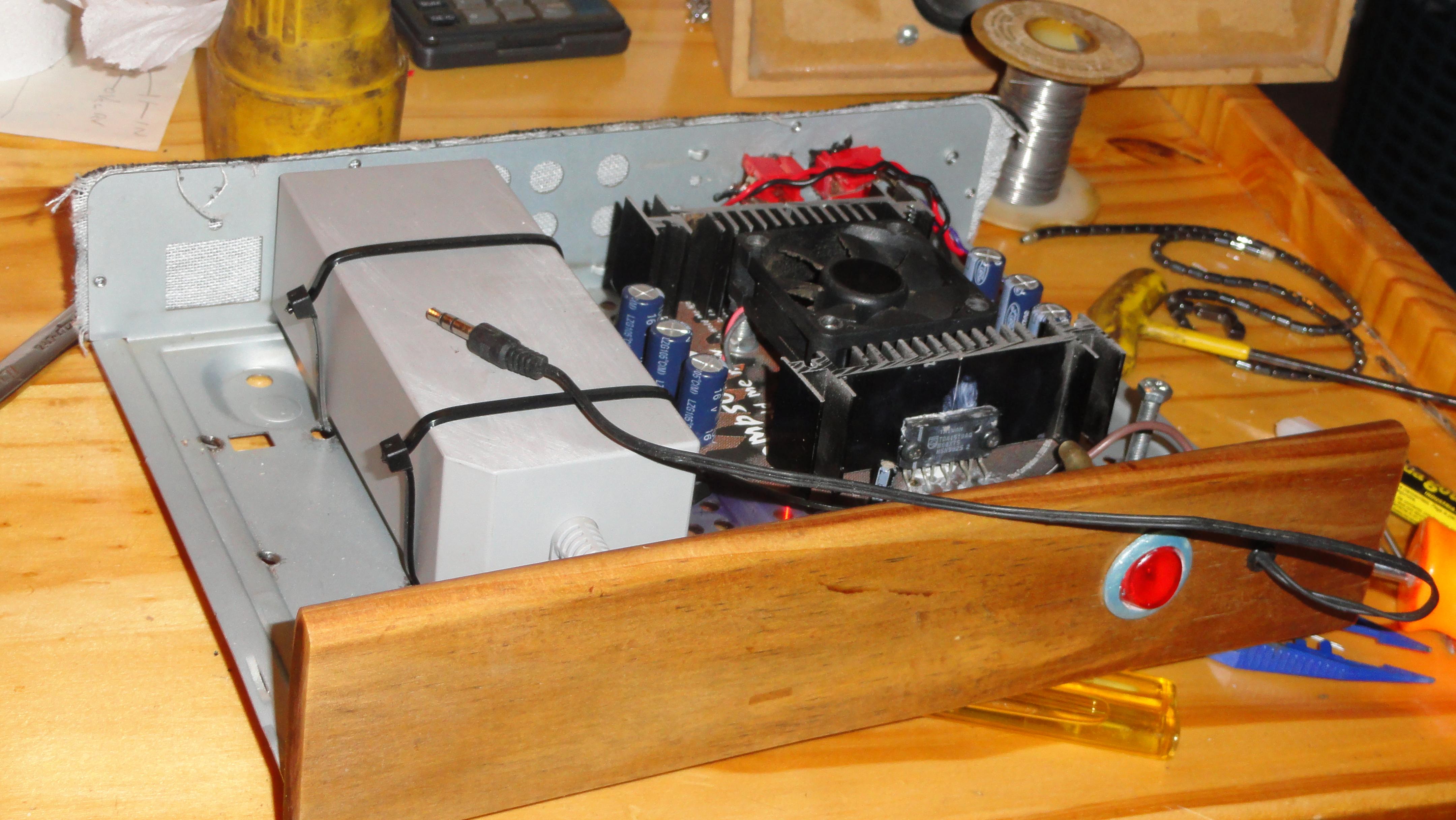

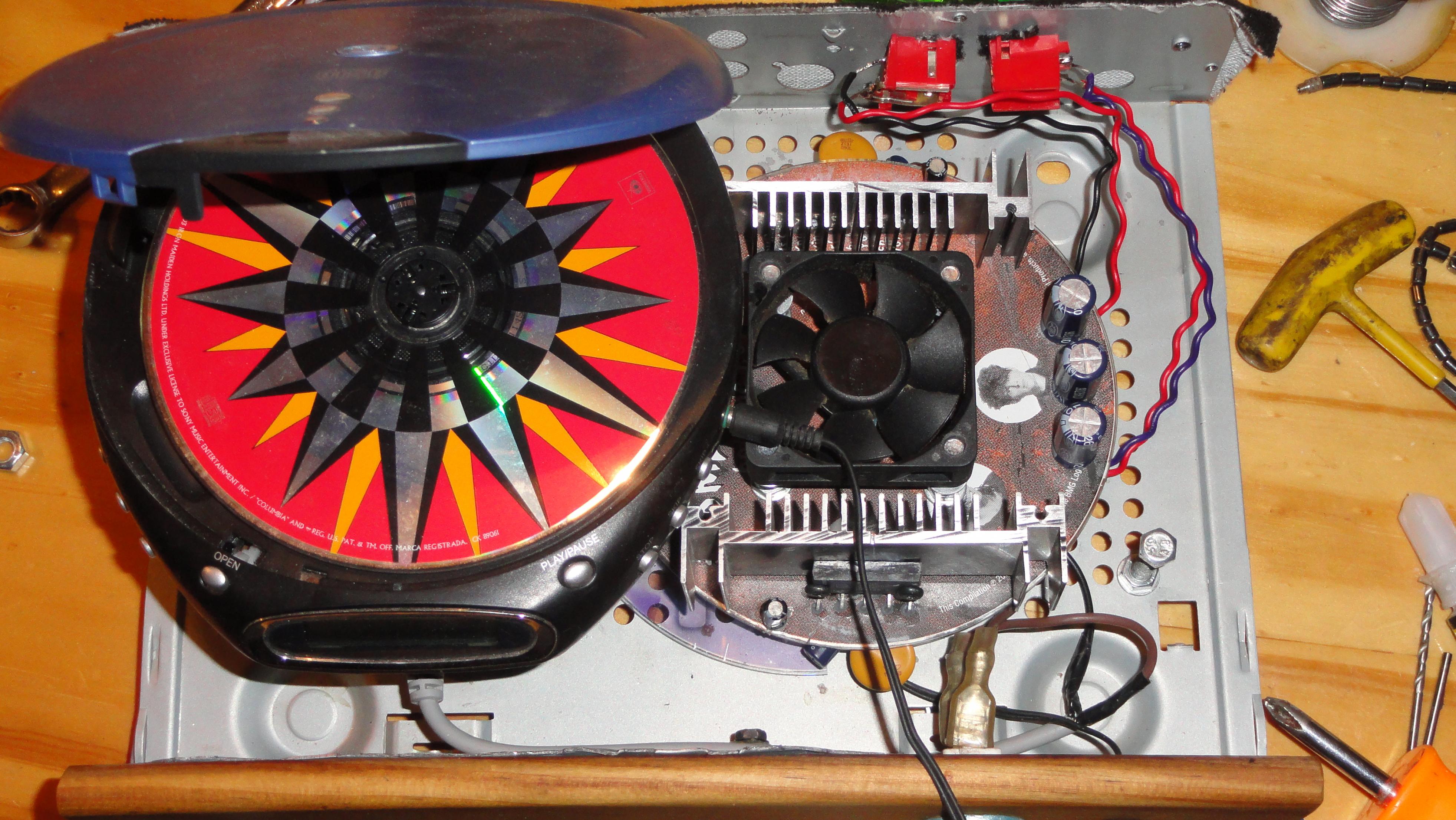

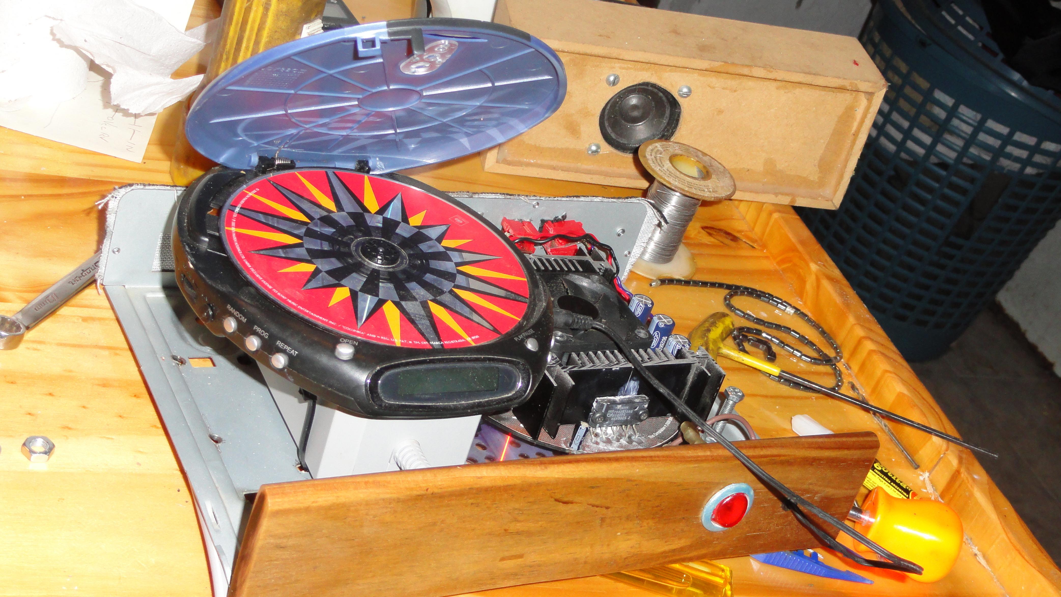

My finished product...made of essentially scrap parts...note the CD board.
Does someone know, does the pin eight, the mute, is it normally open to disengage the mute function?.....because it is not connected, I have no output.

Mute
Hi - my tda7294 wouldn't work either then I realised that the mute was not turned off (on). On the 7294 there is a spec for the voltage level on mute pin for turn on. As soon as I applied 3.5 volts the amp worked. On my PC board I needed to install Berg pins then short two of them together. I could have simply used a scrap piece of wire.
So far, extremely quiet!, mute...
Hi there Jeanie, that's what I was afraid of...the schematics I've found show the obligatory spst switch in the open position...& of course I assumed this is the default, disengaged state.
I'll get in there and apply a jumper....wish me luck.
.......Rick.....

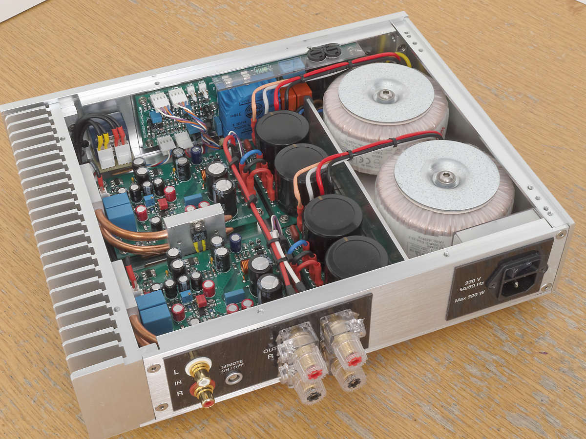

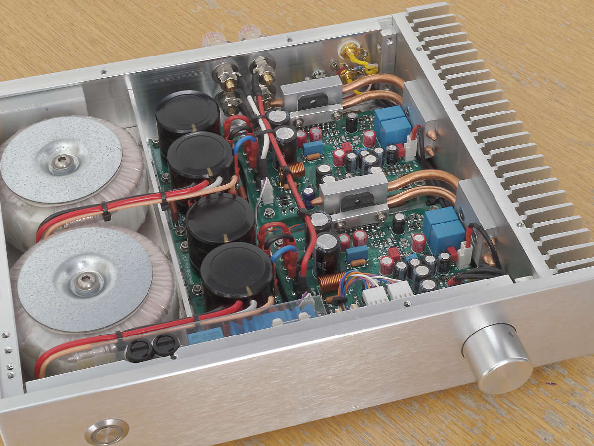

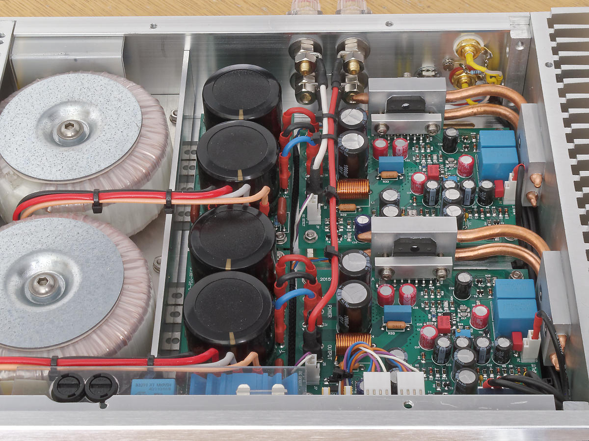

Thanks. To be honest electronics design is my main profession and fine mechanics a secondary. However I build this completely at home as a fun project. Just in my own workshop by hand with regular hand tools and an electric hand drill + drill stand. Only for bending the heat pipes I borrowed a special bending tool from a friend. Casing did come ready made (to some extend) from Ebay.
The PCB in front is the PSU control. It is the click-on-click-off and remote power control to power it on/off from my pre-amp. It also has the inrush current limiter, dc protection and over temperature protection. With 2x 120VA transformers inrush limiting isn't strictly necessary but it avoids the switch on "humpf" and less aggressively charges the buffer caps at power on.
Heat pipes can have the habit (but not necessarily do) to degrade after 10 - 20 years. So I added thermal cut-off's for safety.
Power is 80W rms_sine into 4 ohms and 55W into 8 ohms before clipping. More than sufficient for regular listening. My speakers are 6 ohms mostly.
Noise solution
After moving power leads and rotating the transformer the noise abated dramatically. I also relocated the input leads. As quiet now as I would expect, I'm very pleased with the BTL TDA7294 performance and quiescent noise level. The board on the front of the enclosure is a piece of Jarrah, indigenous hardwood to Australia, which covers holes from a previous project. Enclosures are very expensive in Western Australia, shipping parts from the U.S. is also prohibitive. Good used heatsinks are not available.

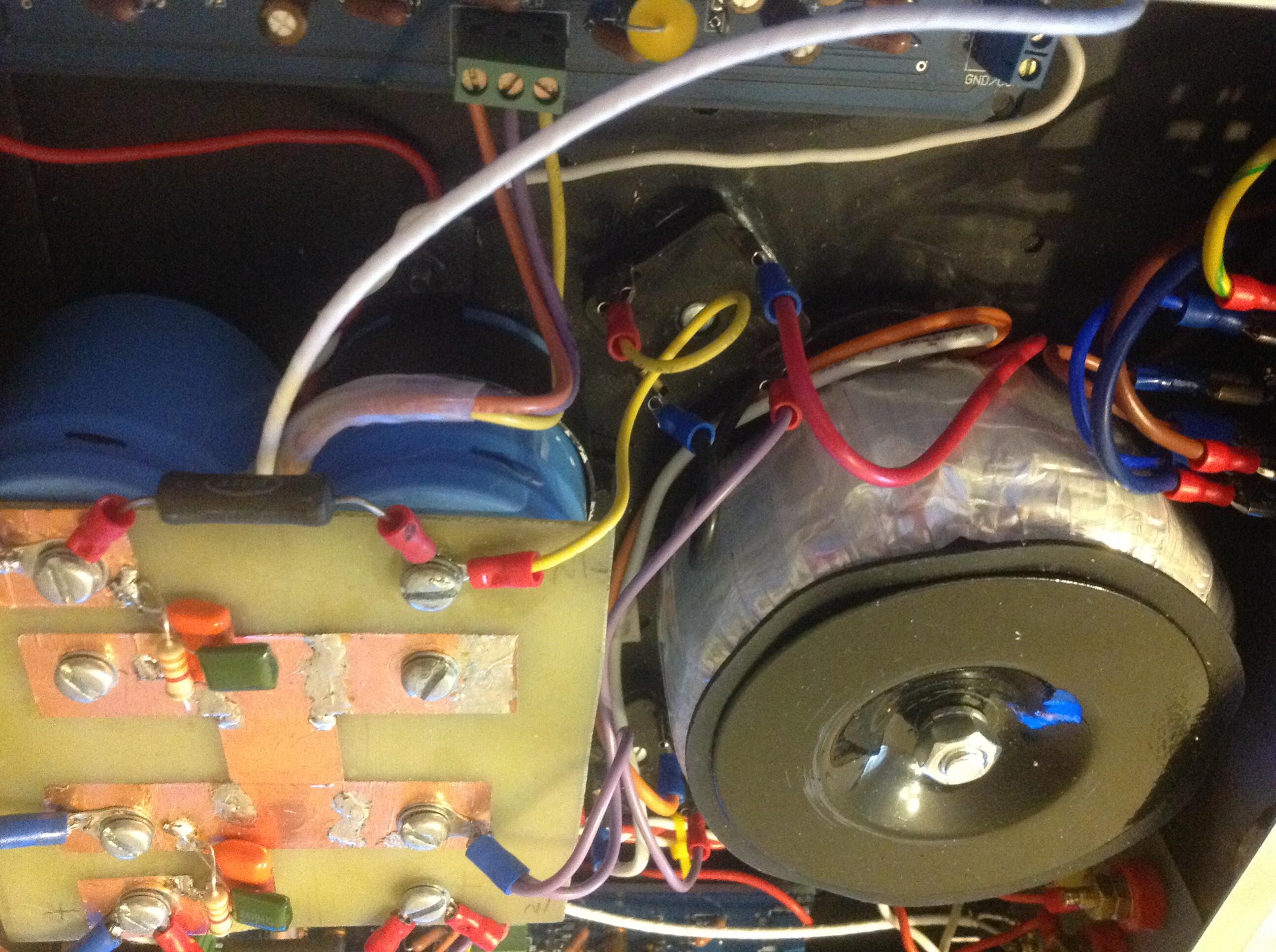

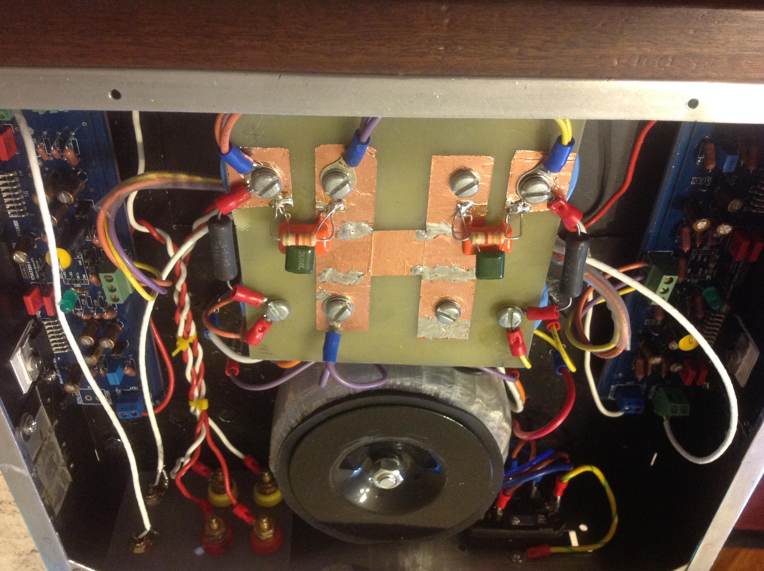

Here's my chip amp build. It has plenty of power, using 300VA power supply with 8,000 uF supply capacitors in C-R-C configuration. Displeased with level of hum which is masked with high volume levels. These 7294's are very noisy! Any suggestions how to lower noise?
post2978
I see 4 wires coming from the centre "H" of the PSU smoothing caps.
That looks wrong to me.
The INPUT pair to the PSU comes from the transformer secondary.
The OUTPUT pair goes to the amplifier/s. The inputs and outputs must remain as close coupled pairs for the whole route from transformer core to amplifier PCB.
Deviating from this creates avoidable interference.
You seem to have an input and an output from one limb of the "H".
and a second input and output at the other "H" limb.
The "H" input/output bus structure flows from bridge rectifiers on the legs closest to the xformer, one leg minus, one leg positive. The center section is the "star ground". As the current flows into the first filter capacitor, pos and neg, then that is connected to the next filter capacitor through a 0.5 ohm 5watt resistor. The second filter capacitor (pos and neg) are distal to the xformer and from the output of that capacitor the flying leads wrap underneath the FR4 and loops around to the voltage inputs?

Maybe this photo will serve to clarify, the diodes are black as is the bottom of the enclosure. The negative is Yellow and the positive is Orange, 16 gauge tinned, stranded, high temperature wire. As previously mentioned, before moving the transformer and signal input cables there was a lot of 50Hz hum, I twisted (rotated) the transformer which pulled the xformer output cables tight against the toroid instead of looping? I made certain to keep any signal input as far away from the transformer as possible, following the square law of EM radiation.
It's your "star ground" that is wired incorrectly.
The wires from the transformer to the rectifier/s MUST be close coupled pairs.
The wires from the rectifier/s to the smoothing capacitors MUST be close coupled pairs.
The wires from the smoothing capacitors to the amplifier MUST be close coupled pairs.
Even better if the close coupled pairs are twisted pairs.
Taking single wires (that pass a varying current) to a star ground increases interference inside your amplifier.
Thanks Andrew, that's useful information which I'll use that in the future. I know you are very knowledgable I previously have seen your posts. My belief is problems associated with hum and noise are paramount in any design. Permit me to add thermal management is also given short shrift. If you are able to eliminate noise and dissipate heat then you are ahead of the crowd.
