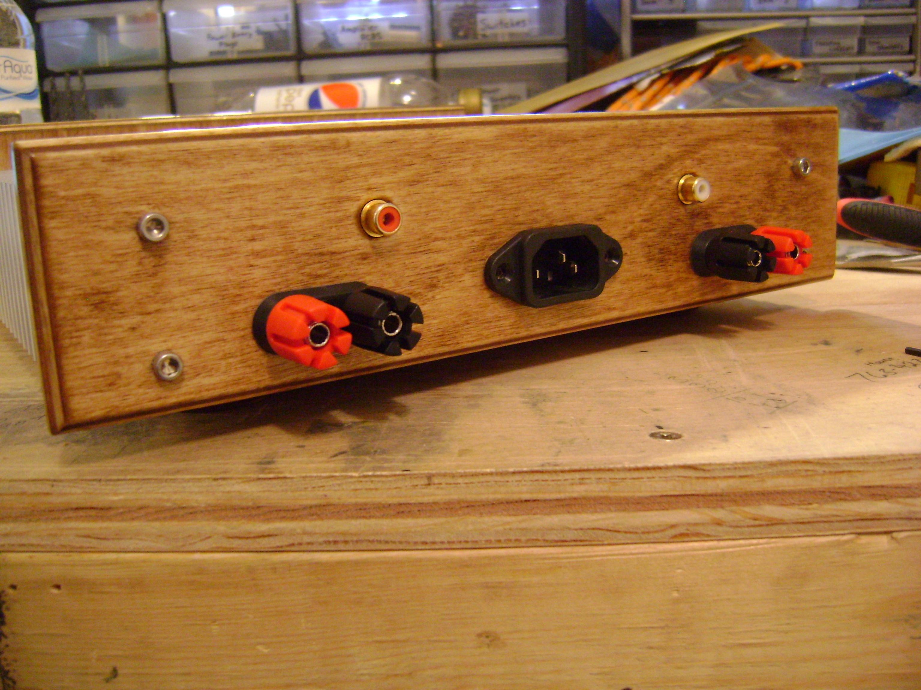

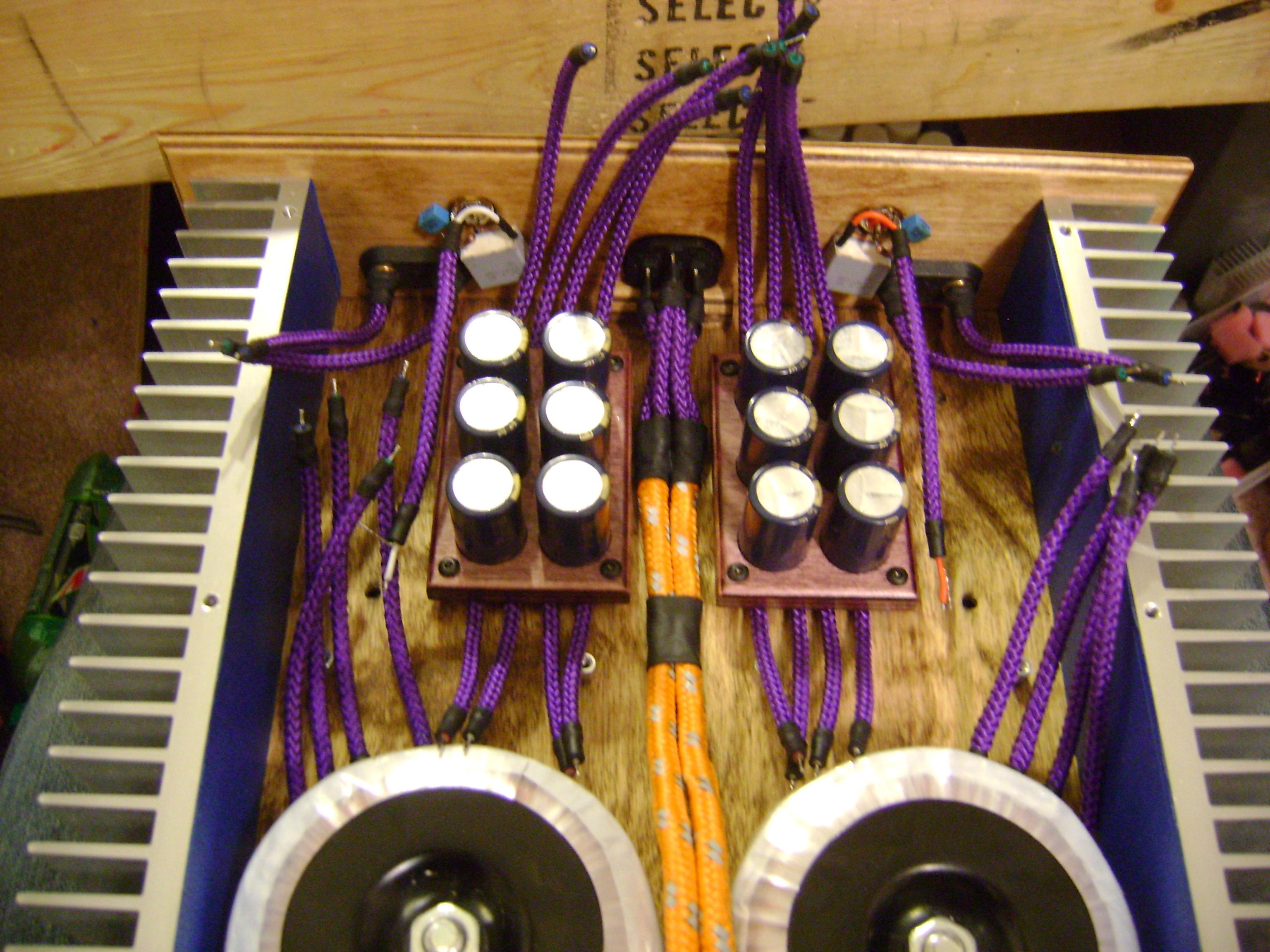

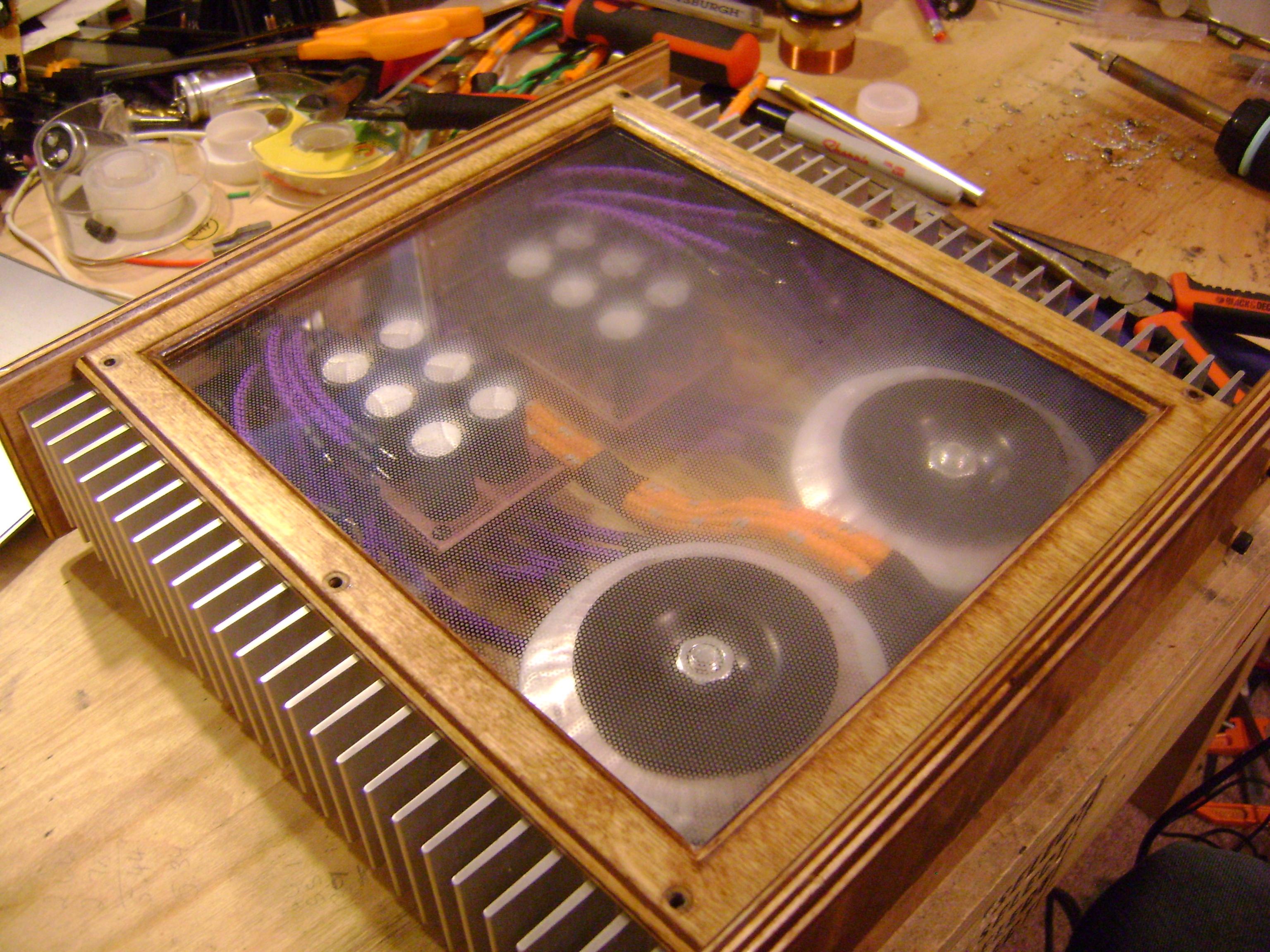

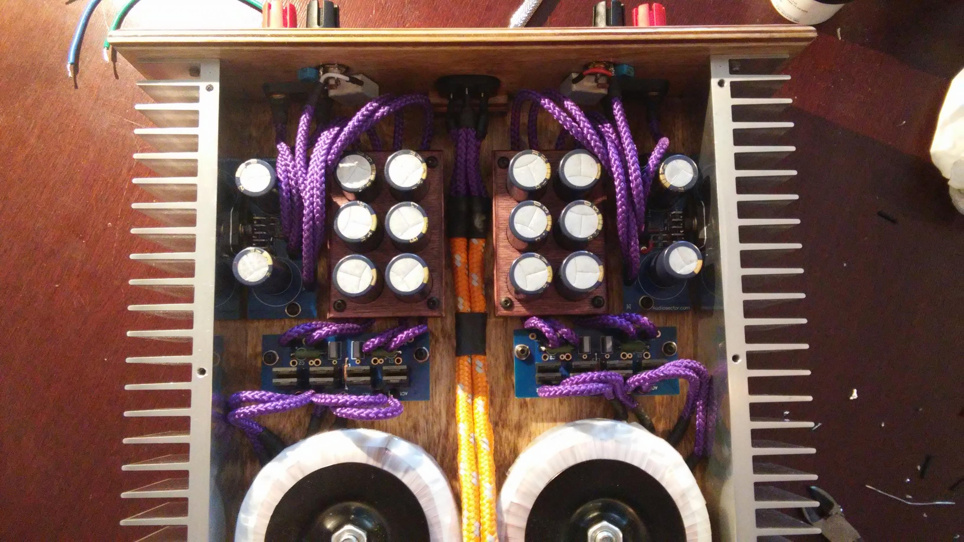

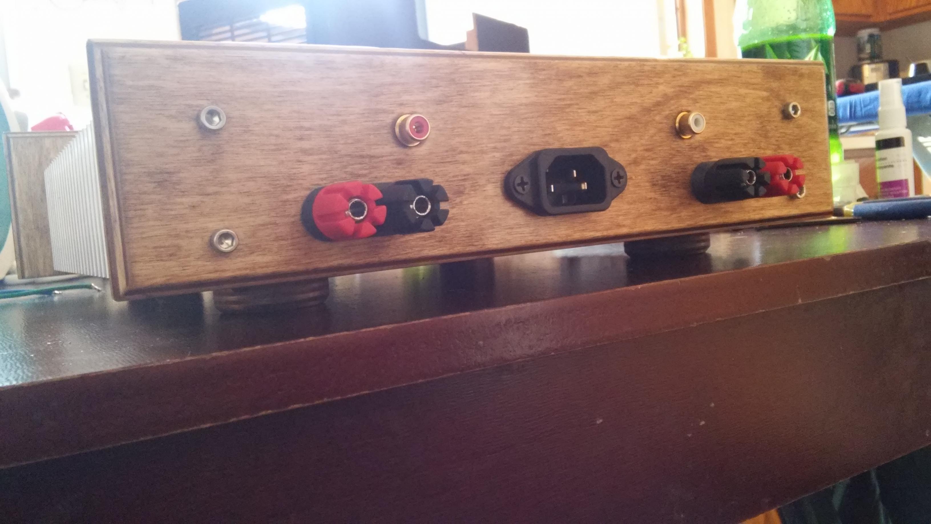

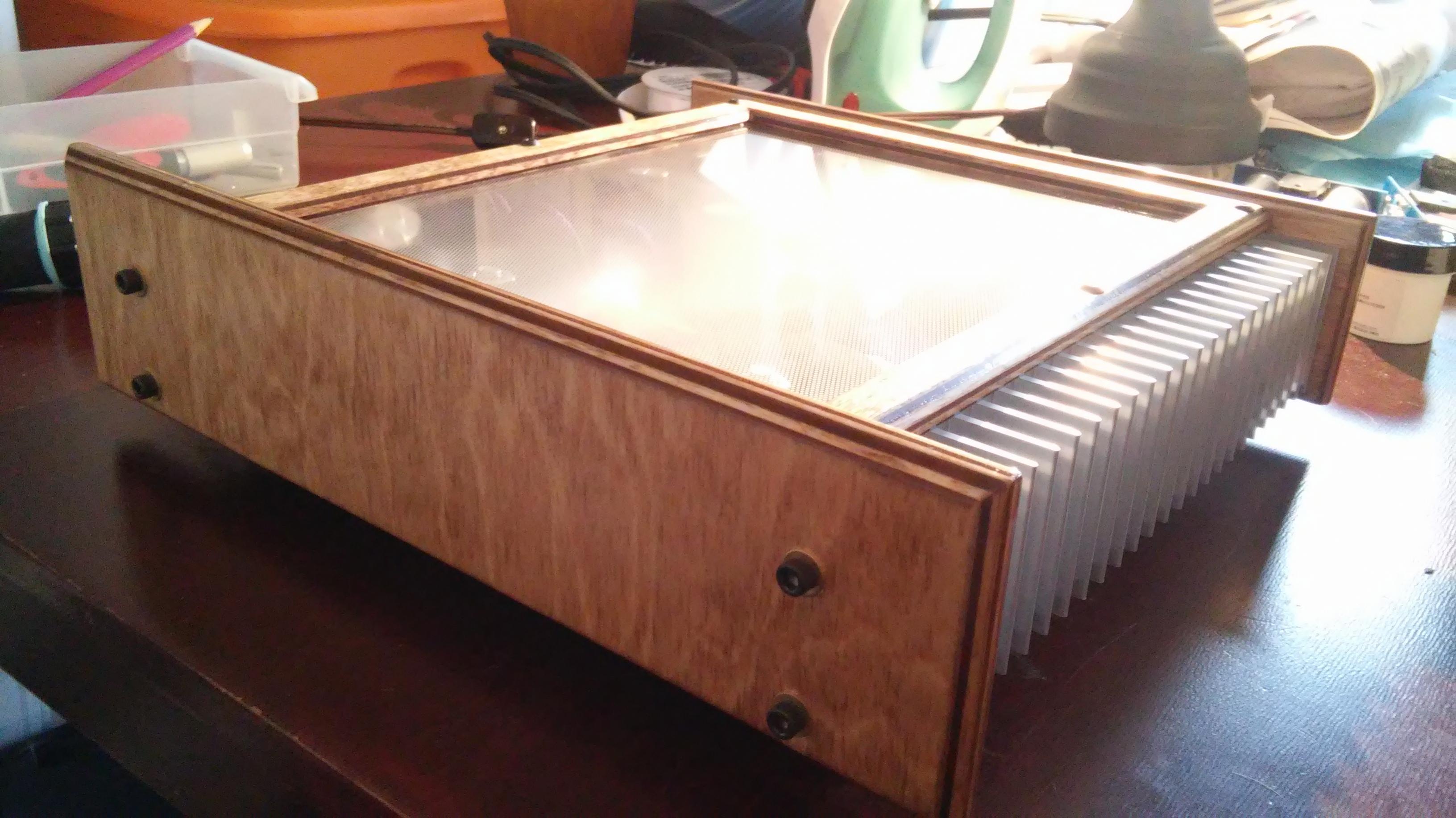

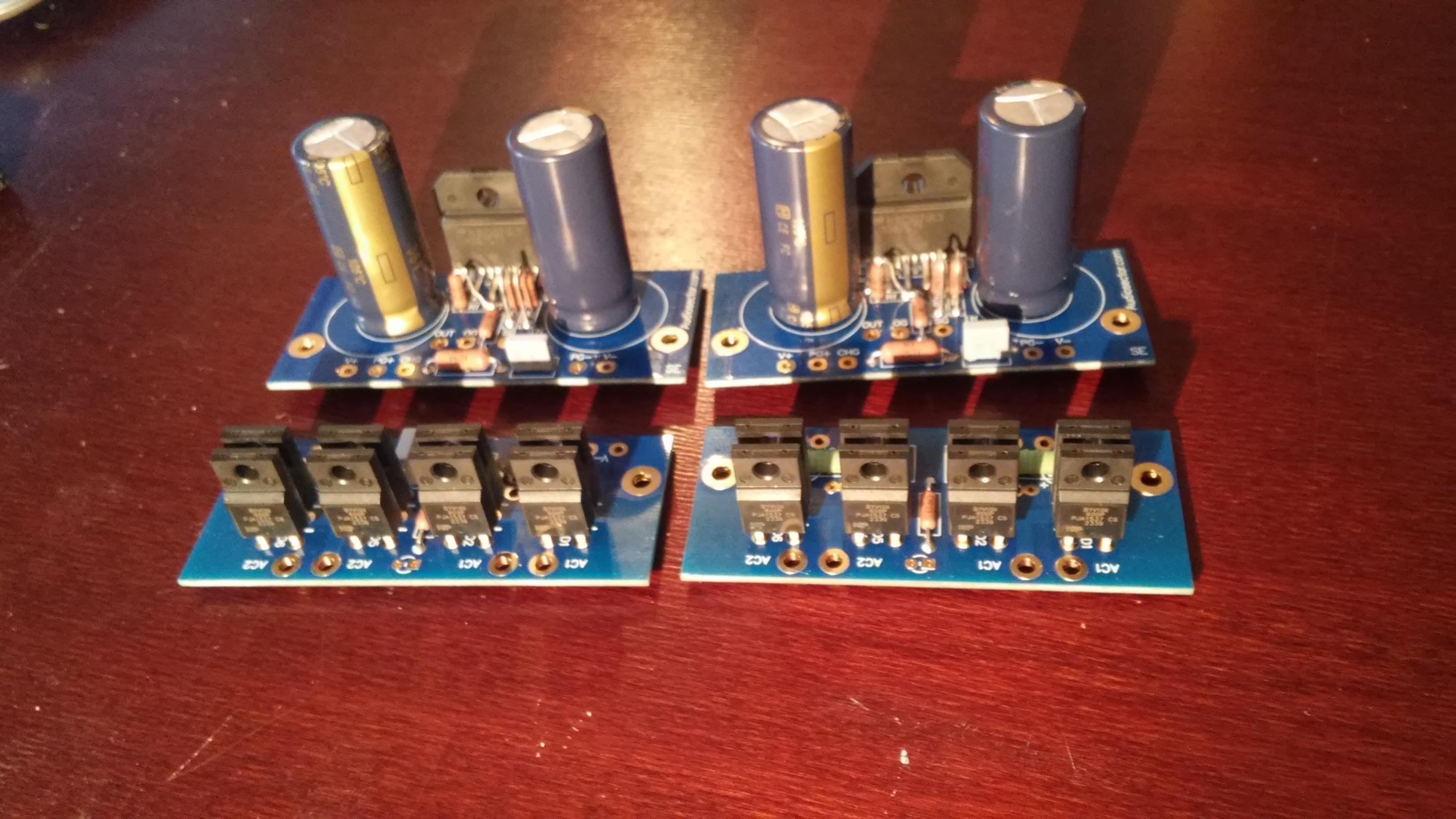

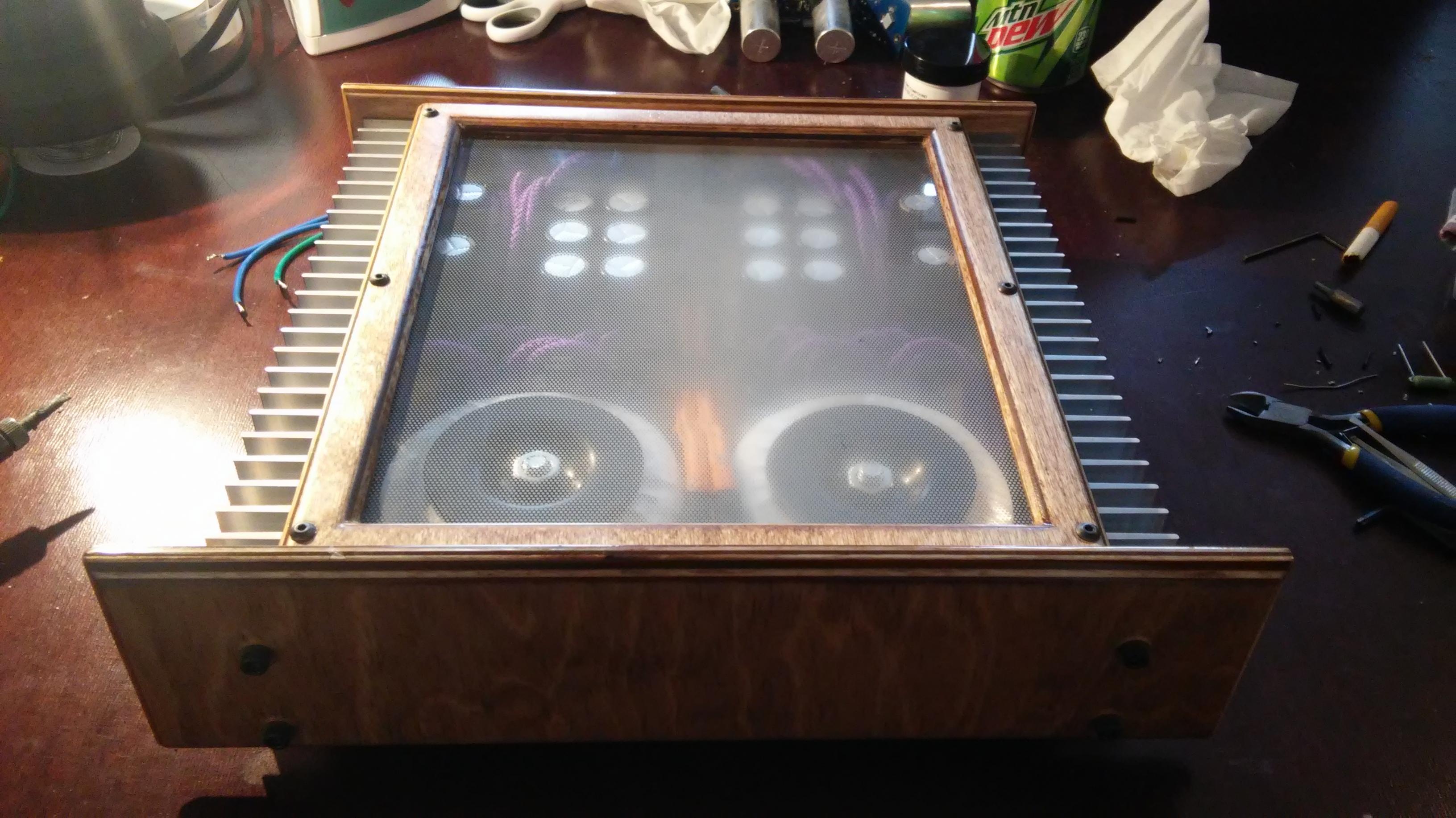

Hey everybody, this is my first post here, as I have known about the forum for a long time, but just recently joined. I have built a few amps over the years, and wanted to share my most recent build, which was done for a family member. A full collection of photos from the entire build are in one of my Flickr albums - https://www.flickr.com/photos/tesladude19/albums/72157661955974493

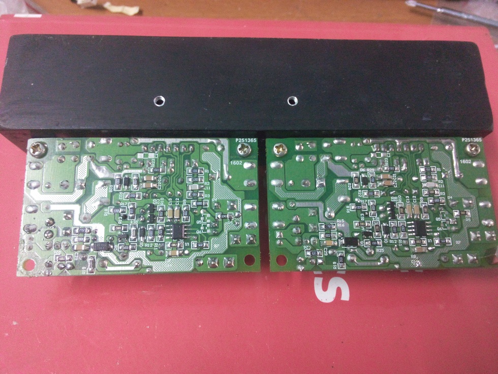

Its technically unfinished.. as I dont have the actual amp boards in yet (I threw my old ones in to test fit everything in the case, as can be seen in the last photo) but I should be getting the new boards for this amp in a few days.

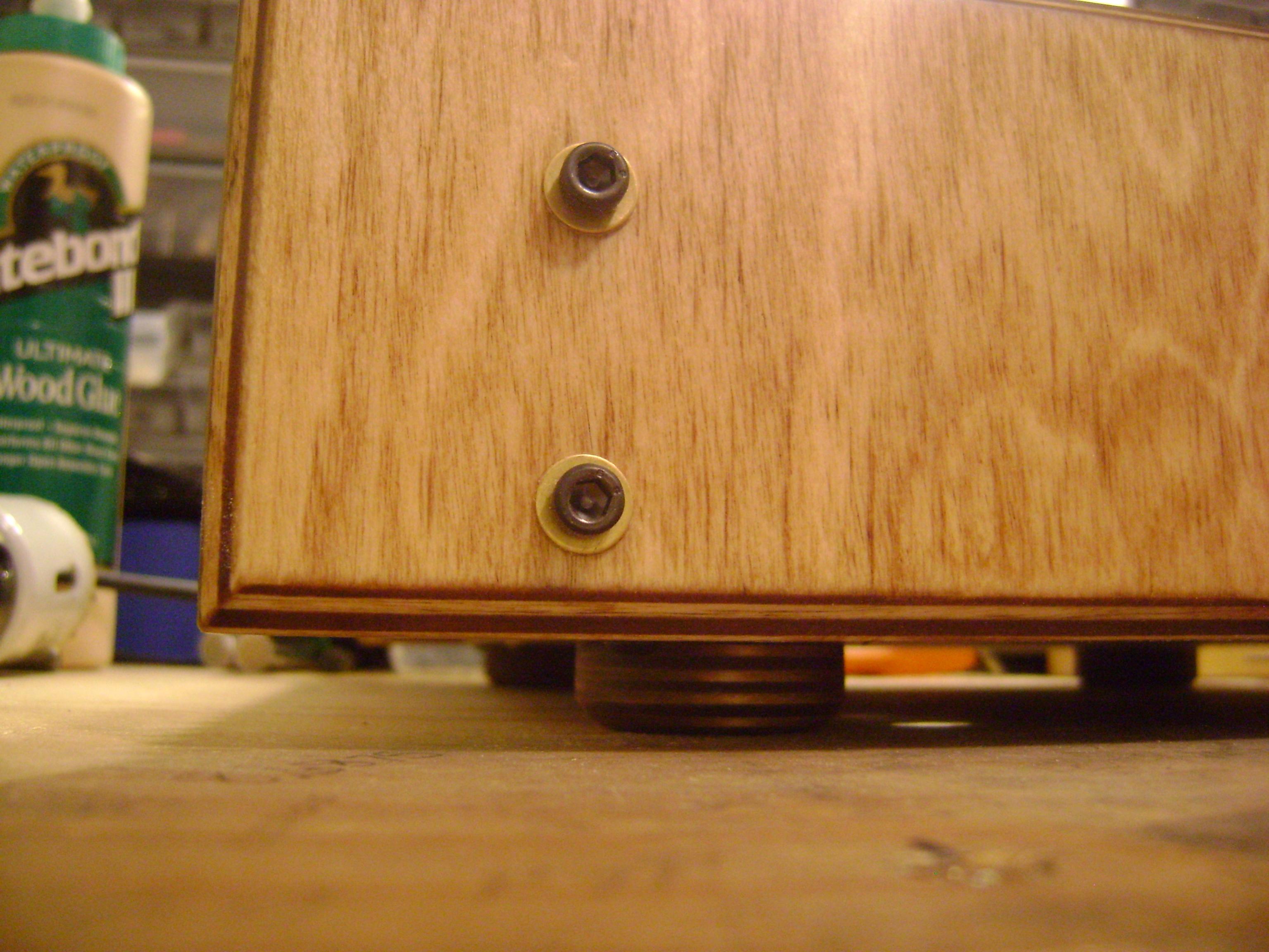

The case is made from plywood, and the heatsinks make up the sides. All wood pieces are stained Early American, except for the boards that hold the capacitors, those are Black Cherry. I used lacquer to give the wood a real smooth finish, and I am rather impressed with how well it turned out.
Parts used/will be used - Antek 50VA 20V transformers, 10" profile 2" height heatsinks from HeatsinkUSA, AudioSector LM3875 PCBs, Panasonic FC series electrolytic caps, Vishay BC film caps (except for the 470pF in the low pass filter on the input, that's Kemet), Murata ceramic caps, Vishay Dale 1% resistors, Vishay BC 1% resistors, NXP diodes, 300V rated 22 gauge wire sleeved in paracord.
Enough of me rambling on.. here are some pictures:

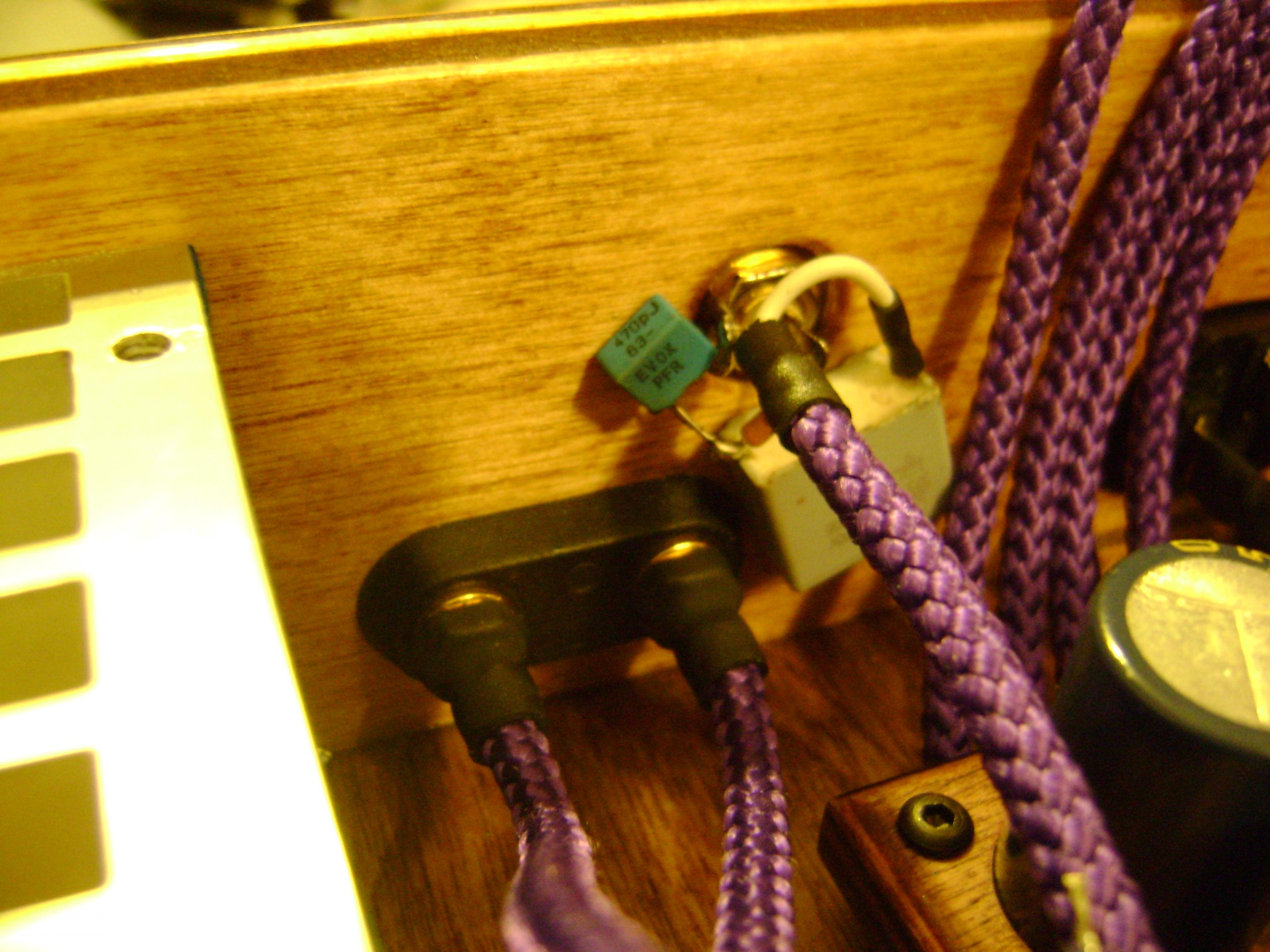

There is 470pF cap, and 681 ohm resistor that creates a low pass filter. This amp will be used with phones, tablets, laptops, etc.. some of which have rather noisy outputs. I have found it helps quite a bit.
I use a 47pF at the input socket. That capacitance only becomes a filter in association with some preceding impedance.
The interconnect cable has both resistance and inductance. There's the filter.
This filter attenuates external interference as the cable enters the enclosure.
The internal cable potentially picks up interference on it's route across the emi field contaminated space from socket to receiver. I fit the main filter at the receiver to attenuate all the interference. This is where I fit the R+C. This R+C defines the upper limit passband of the receiver. I also fit the lower limit passband filter here.

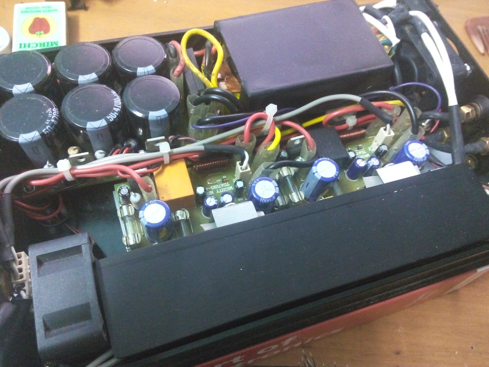

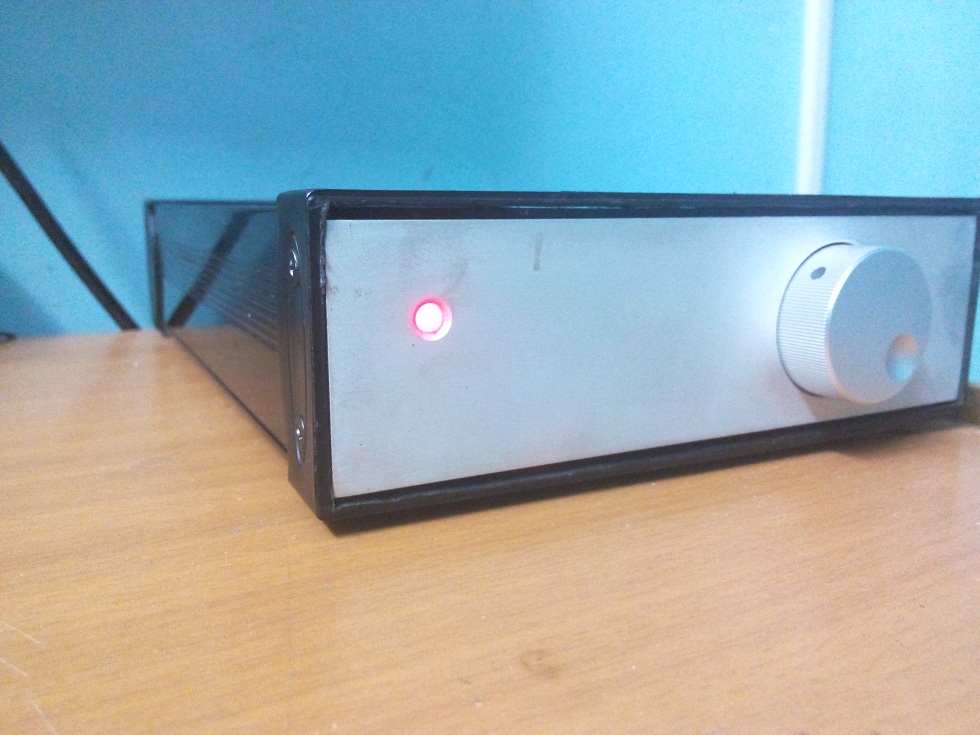

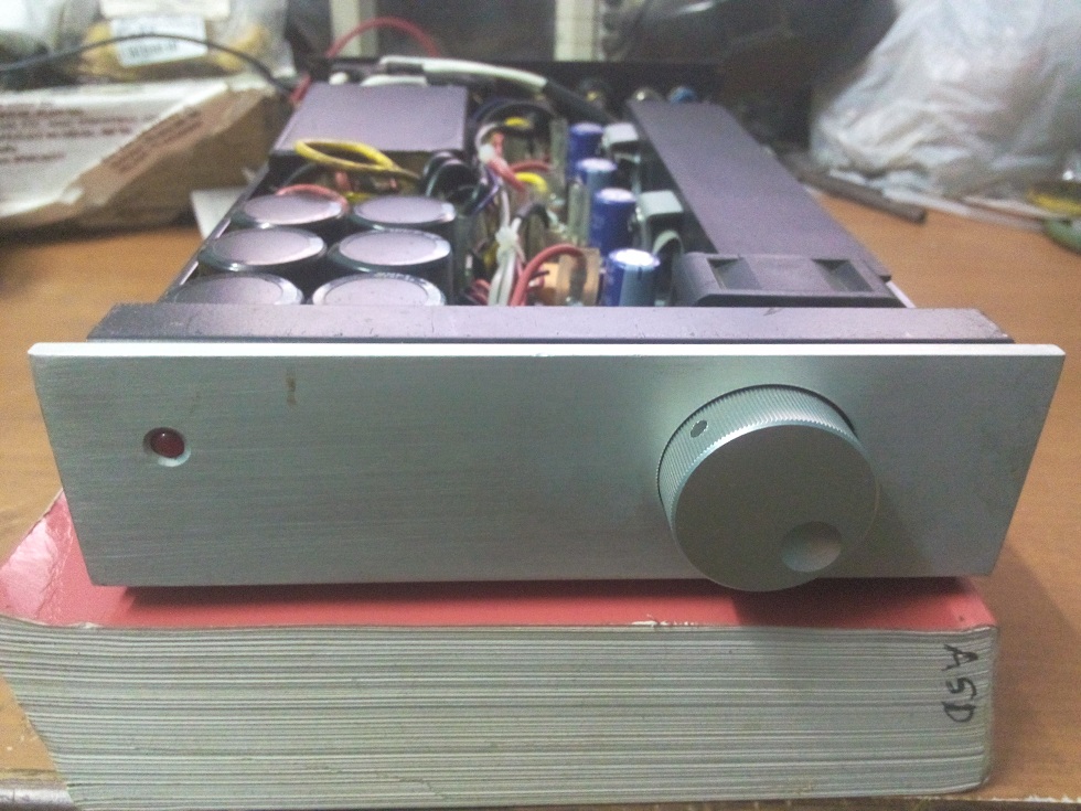

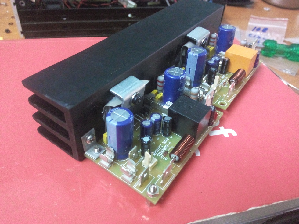

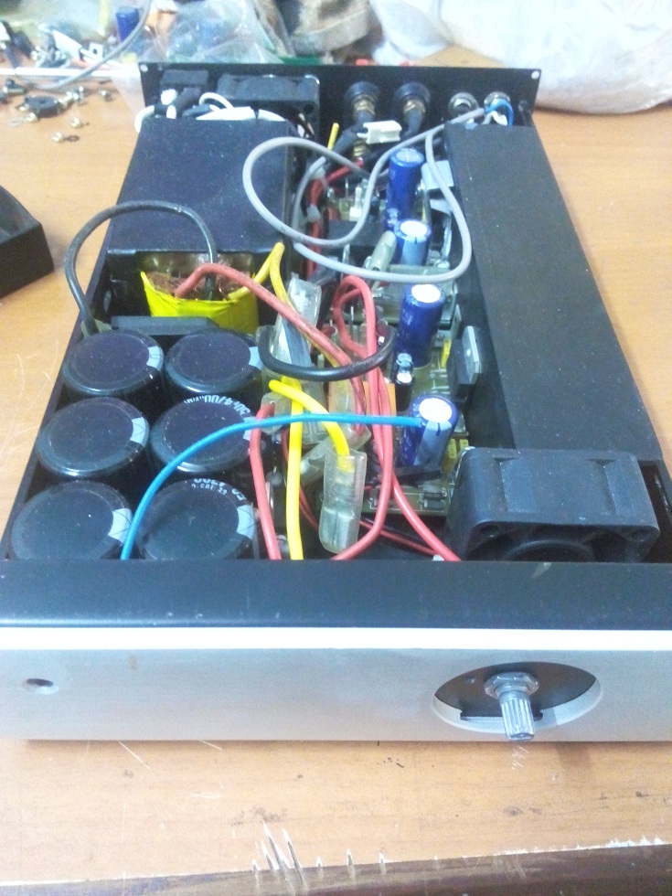

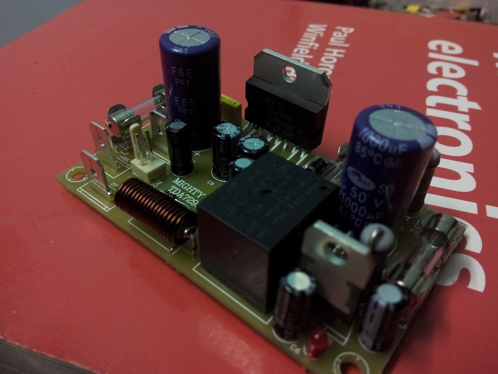

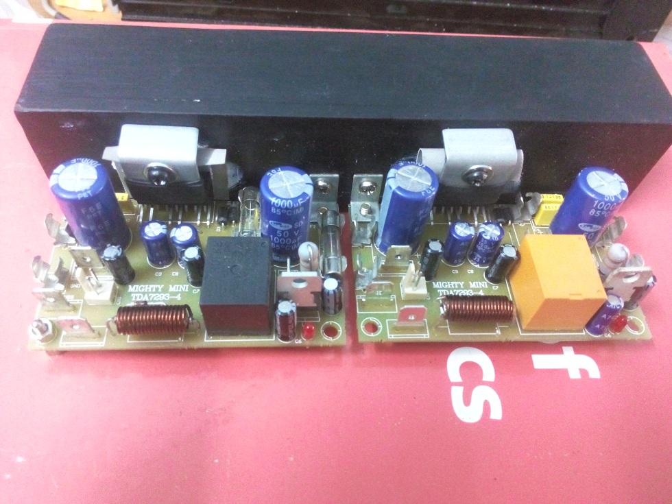

mighty mini build TDA7293 putting out a modest 30W in the smallist chassis .....took me more than 3 month to complete , but the end results were worth it ......😀😀😀😀

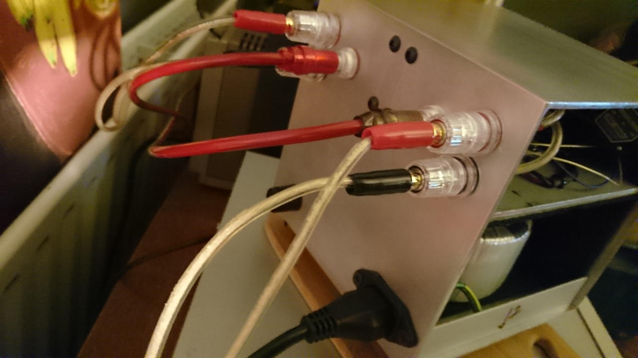

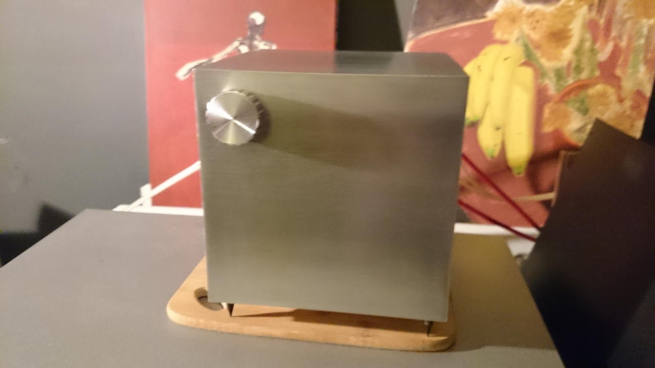

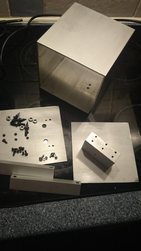

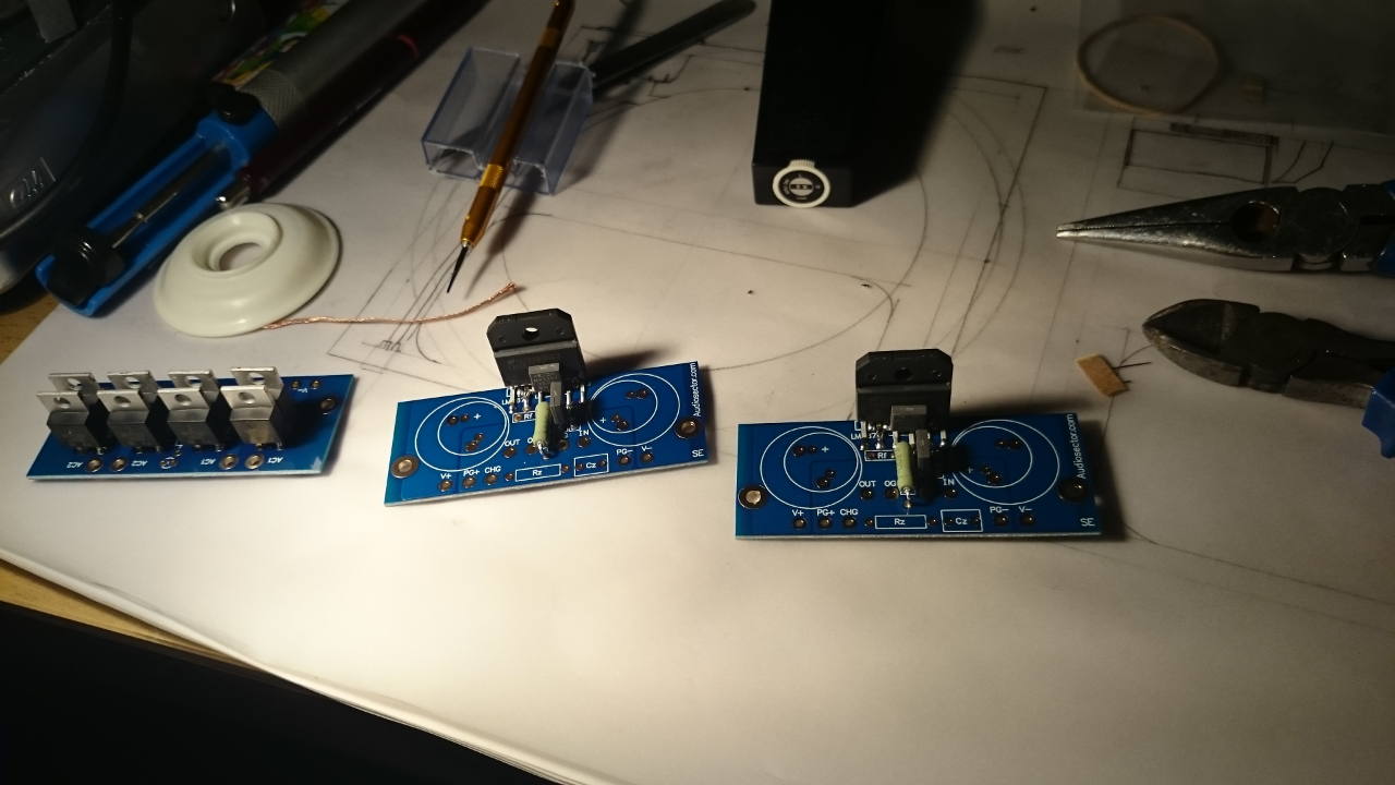

Gain Cube

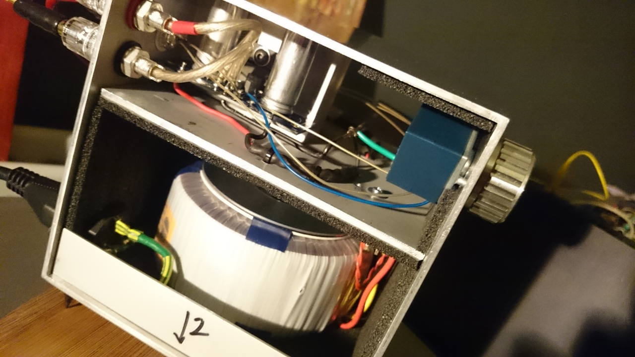

My latest bodge-up. Its an Audiosector LM3875 kit built into a 15x15x15cm aluminium extrusion costing a mere £8.25 which was the cheapest, nicest "different" enclosure I could make using the tools I have...it was bloody hard work squeezing it in without resorting to terminal blocks. The chips are mounted on a 2x1inch (apols for mixing my units but it's how they sold it) solid extrusion to take care of the heat. Sounds good to me and looks good to Mrs.Tonga (a very important consideration).
Apologies if the pictures are too big - I haven't worked out how to do the thumbnail thing.
Ben.
Ben.

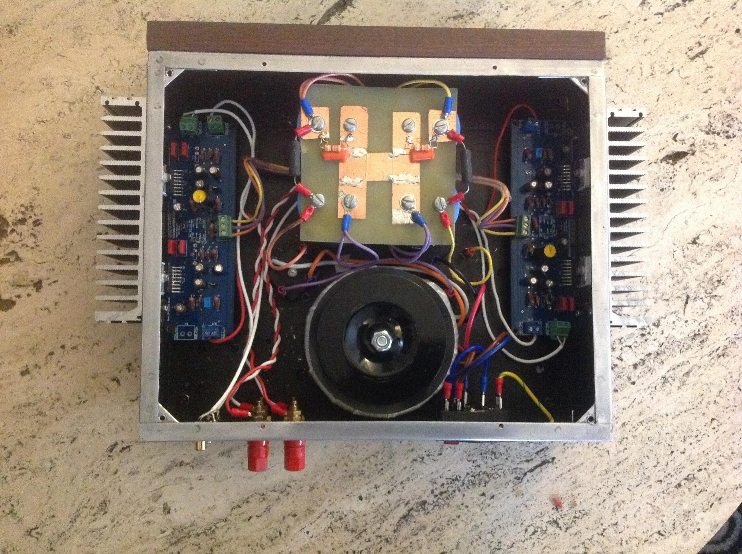

TDA7294, BTL mode, stereo amplifier
Here's my chip amp build. It has plenty of power, using 300VA power supply with 8,000 uF supply capacitors in C-R-C configuration. Displeased with level of hum which is masked with high volume levels. These 7294's are very noisy! Any suggestions how to lower noise?

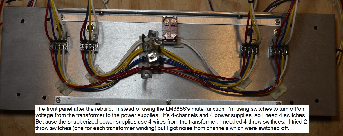

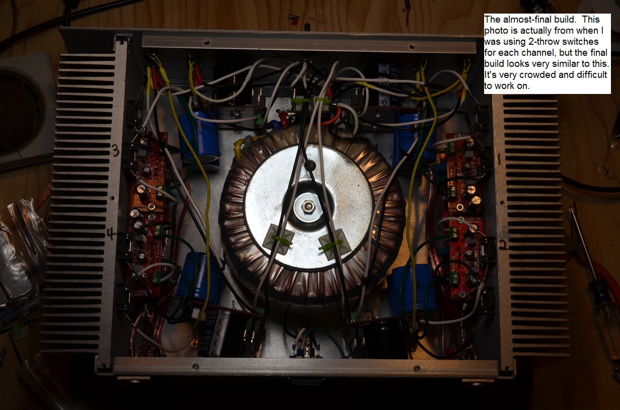

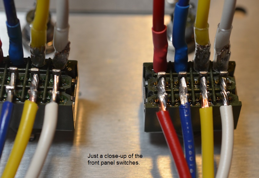

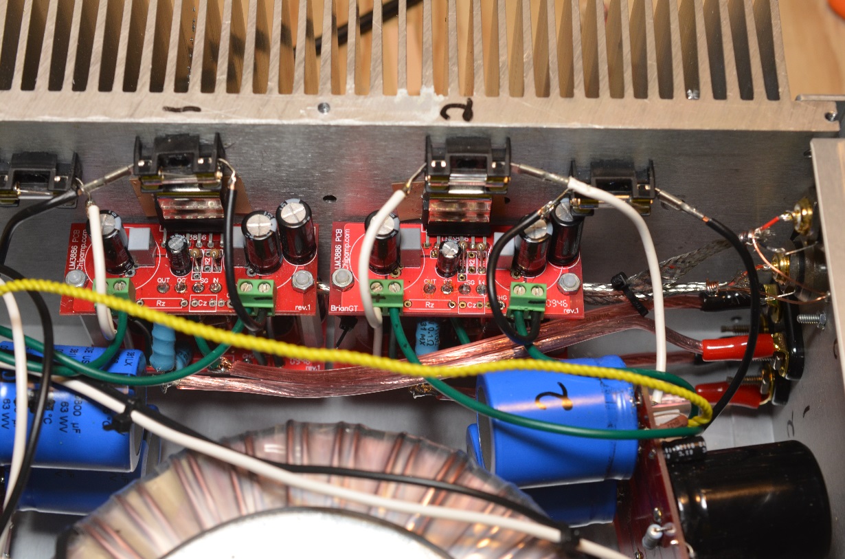

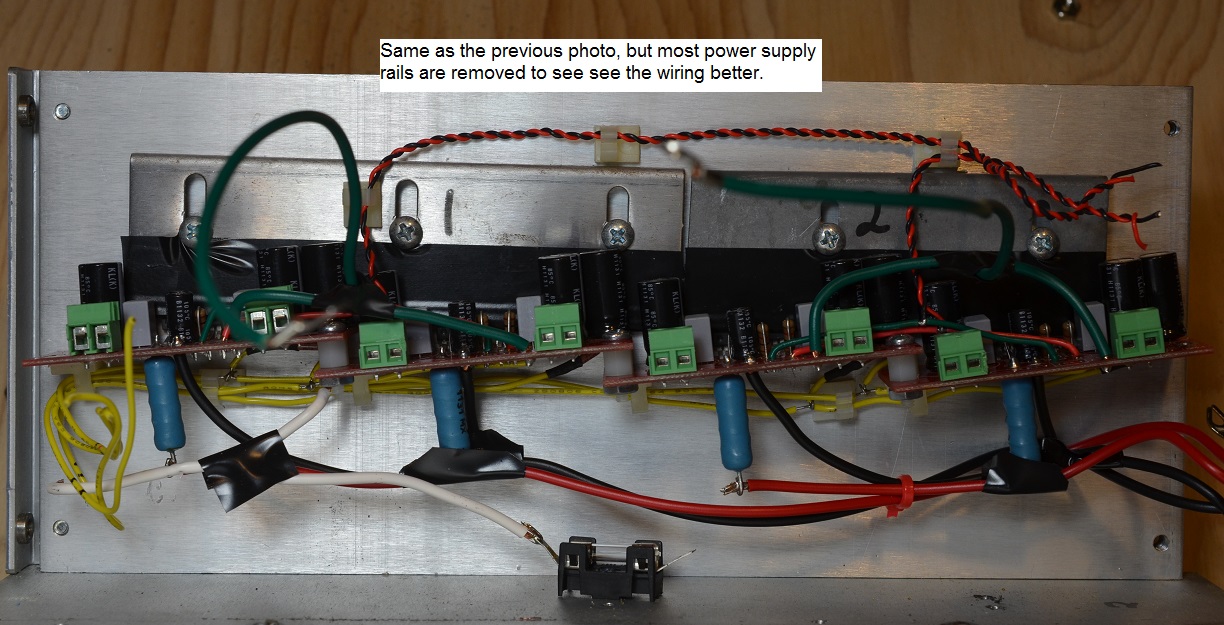

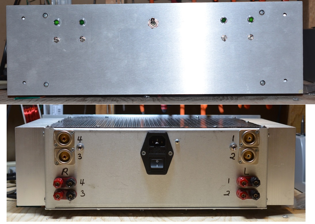

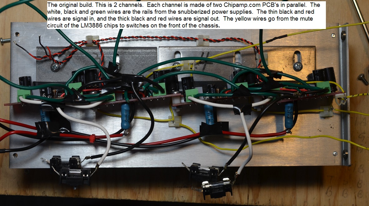

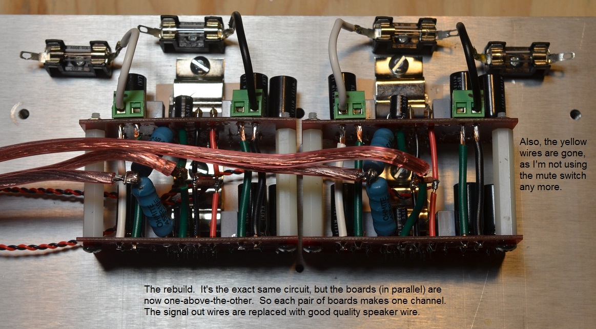

Introducing – not a new build, but a rebuild. Several years ago, I had the opportunity to buy a bunch of LM3886’s and Chipamp.com boards and a huge transformer really cheap. I realized that by putting 2 Chipamp.com boards in parallel, I could build exactly the PA100 described in Texas Instruments’ data sheet SNAA021B.
So I built a 4-channel PA100, using 8 LM3886’s and boards and 4 Chipamp.com power supplies. I posted it here: http://www.diyaudio.com/forums/chip-amps/79303-chip-amp-photo-gallery-220.html#post3132645 Well, it was a bit of a mess, and didn’t sound very good. All 4 channels had a faint hum which I just couldn’t get rid of. So I tore the whole thing apart and rebuilt it. Changes include:
· Parallel boards were moved from side-by-side to one-above-the-other.
· The mute circuit is no longer used.
· To turn individual channels on/off I use switches placed between the transformer and the power supplies.
· I’m using a copper braid to shield the signal wires.
While it works, and the hum is gone, it was really a lot more difficult – and more work – than I bargained for. The amp is over-crowded and has too many wires inside. It’s extremely difficult to get tools, fingers and probes in there to work on anything. Wiring two boards – designed for single chips - in parallel requires creative soldering techniques which really should not be used. Despite diligently testing each part before assembling the whole thing, I had to take the completed amplifier apart twice, because it didn’t work once assembled. By the time I was done, this project was no fun! It’s done now, and I’m going to take a little break from electronics. I’m going to build some wood CD shelves.
