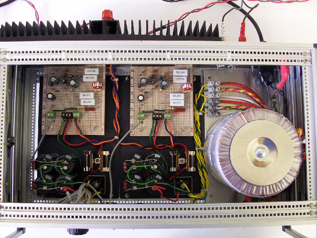

My attempt at a compact Bridged LM4780 Stereo amplifier in an old die-cast box, 220mm x 145mm (190mm including heatsinks) x 50mm high.
Made mostly from junk I had lying around.
Home made single sided PCB,s
The transformer is Mu-Metal shielded
4x 4,700uf/50v capacitors + 4x 1000uf/63v caps on PCB (one under each board)
DC protection circuit and relay at rear + Speaker fuses
65 + 65w RMS 8 ohm
85 + 85w RMS 4 ohm
130w RMS one channel driven for 1min test.
Given the transformer is so close I was surprised there is no hum and despite not using hi-end components (would not fit) the sound quality is still very pleasing.

" ... Given the transformer is so close I was surprised there is no hum ..."
'Cause the transformer is enclosed in a metal case of its own ?? = a quality shield close to the windings = 🙂
As long as the mu-metal transformer case remains grounded to the chassis = very little hum.
Q&A: how did you fasted the heat sinks to the case? ... and do the heat sinks ever get warm ??

The Heatsinks are attached with 6x screws into taped threads in the case and a strip of copper buss-bar helps spread the heat from the chip.
There is about 5w at idle so the heatsinks are just warm but get quite warm almost hot on hot days when the amp is pushed hard for long periods even into 8 ohm, I think the amplifier would over heat under the same conditions into 4 ohm.
PS rail voltages are +/-42v, I would have liked it a bit lower but I have 12 of these transformers from old computer terminals and wanted to use one.

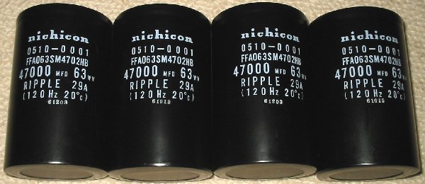

VLSI said:Should I put these in my next GC?
Came from a bit of telecom equipment I recently trashed (also had in it 12x 47,000/50v capacitors as well)
😀 These Nichicon are nice.
VLSI said:PS rail voltages are +/-42v, I would have liked it a bit lower but I have 12 of these transformers from old computer terminals and wanted to use one.
If you were not on the other side of the world I would have asked you to send here some of these trafos...

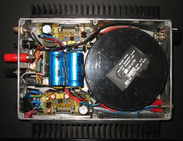

My_Ref_C being reboxed.
Also upgraded a number of elco caps to low ESR models, ceramics to cog and bypassed some other, and found 2 caps that were 470nf instead of 1nf, which I think explains my previous heat issues.
This rear part slides into a box from the rear... I will post pictures of the box later... just took a small smoke break quickly inbetween installing PCBs.
The heatsinks 2.5C/W 10cm x 10cm x 5cm x2

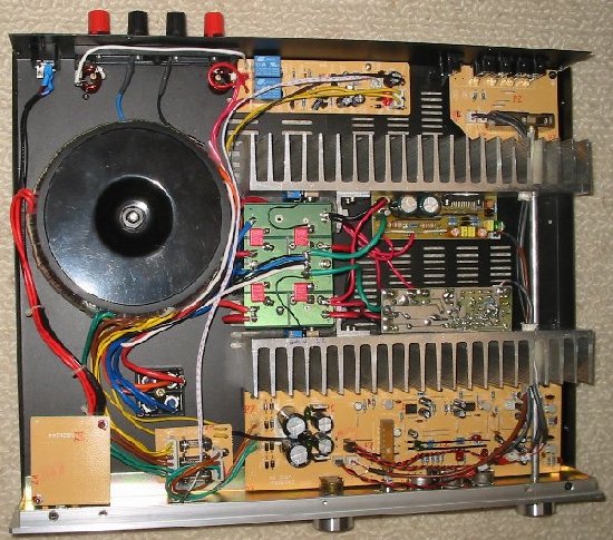

Almost finished my Bridged LM4780
Just need to remove the old pre-amp and make a timber front panel?
It is built in the chassis of a wrecked KODA 260 amplifier (A2760 in Australia) from DSE.
I was able to use the 300va transformer, 4x 10,000uf filter caps, DC protection circuit and input selector, New heatsinks though as the originals where too small.
The pre amp is disconnected, Just using the volume control till I can get a good quality Alps.
I designed and home made the single sided PCB’s
It has a regulated 5A PS (tested limit 7A) using 2x LMS 1585-1.5v regulators protected from capacitor charging inrush and output shorts by 2x 9.1v/50w zener diodes. PS input is 45v output is adjustable with a 10T trimmer in the ground lead and set to 38v.
The sound is very sweet and smooth almost valve like in quality, Probably the best sounding LM3886/LM4780 amp I have built, I really like using this amp.
I have used the amplifier modules before but they have not sounded this good. (Must be the regulated power supply??)
RMS outputs are 75w+75w 8ohm, 110w + 110w 4ohm (voltage regulators drop out with 2x 4ohm load) 75w one channel 8ohm and 140w one channel 4ohm
