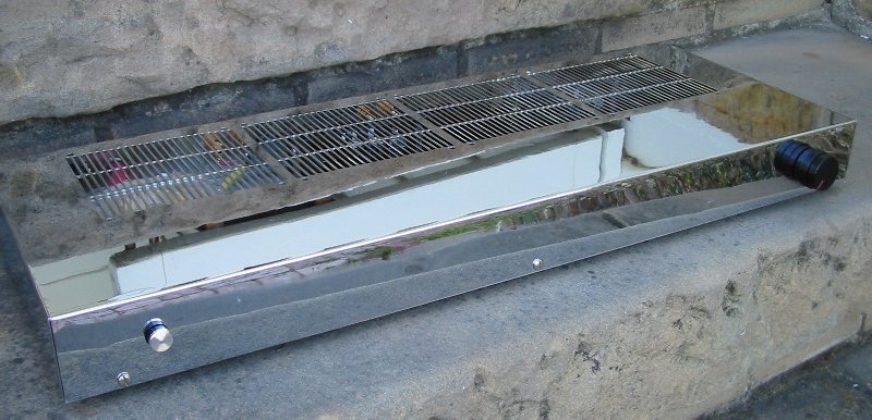

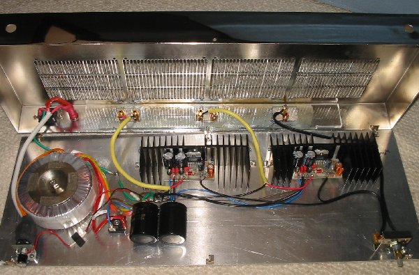

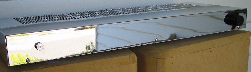

Last one...
Case was Par-Metal Series 20
PCB's were BrianGT's excelent LM3875 premium kits
All else was Steve's @ Apex.jr <-- Great stuff at good prices...
As you can see the buffer is not installed yet.. But there is room.. 😀
Work still in progress...

Nice case Troy...

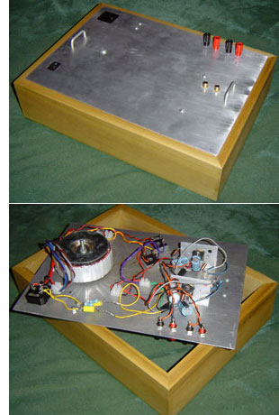

now for the front of my case
The wood is yellowwood. Which is an indigenous tree.
troystg: very nice !!
What type of case is that?? Might be perfect for my next amp project ...

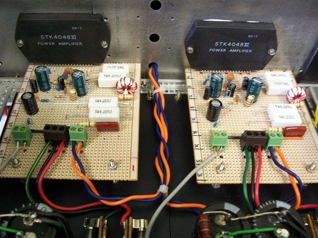

stk4048XI
Here is a closeup of the vero board design.
No oscillations. No problems at all.
135 watts at 100Hz 8 ohm
156 watts at 1khz 8ohm
205 watts at 100hz 4ohm
245 watts at 1khz 4 ohm
all at about +/- 57 volts
twin 300va toroidals
20,00mfd per channel
totally separate channels

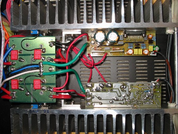

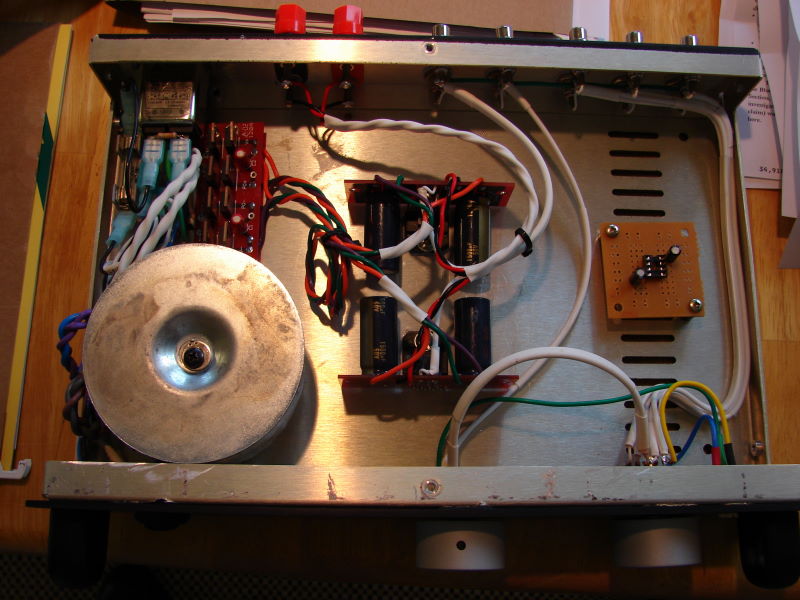

Brute force construction.
This amp is a gift for mother in law... she will never see the inside
The heatsink sits over three holes that lines up with the holes in the top.
It uses Rod elliot P05a PSU and the second version of his hifi preamp with balance and volume control using opa2132.
it is a bit of a mess, I was just going to put the little veroboard IGCs in and a PSU and well, you see what happens... once I liked the sound enough, I left it as is, the wires is a mess as they have to be pushed to their right places as you push the box together the rear slides in like a drawer
Better pics of My_Ref_C
It is a pseodo-plywood... I got the outer layer as offcut strips from the DIY shop and sanded them smooth. the wood is very hard and polishes to a shine with 60 sandpaper- I went to 1200
Because of the limited material ( I literaly had a piece as big as my hand left when I was done), I made an unusual constructrion.
The box is made of 5 sides the 3 outher sides have thick marineply boards underneath, the top is 3mm ply with the "veneers" on top.
The rear slides in and has those beveled tops to keep it in position.
I was going to come back to the case to add some vents, but with those giant heatsinks it hardly goes above ambient for a very long time.
Earth decoupling network is with the transformer, as this is offboard...
