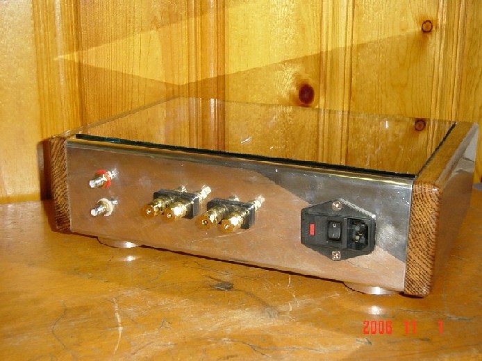

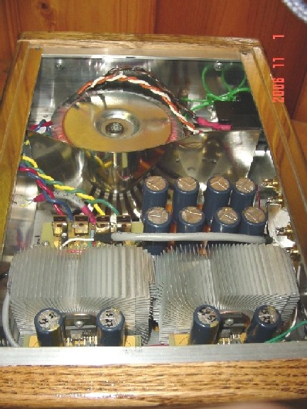

This is my attempt at a chip amp.
The boards are form audio sector.
The chassis is AIG
I added some poer supply caps
The connectors are Cardas
The lid is 6mm coated glass
Hammond trans
corcom line filter with fuse
Thank you,
John

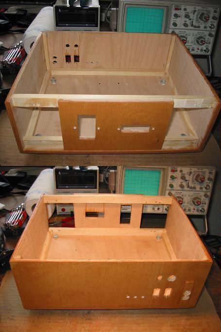

hi!
this is my first amp. i built it mostly out of "intuition", i knew nearly nothing about designing a case or how to get the electronics right. so the outcome is a bit chaotic, but it works fine and i like the sort of rustic look.
i received great help from this forum when i was in trouble with designing the chip boards, thx to spittinllama , jaudio and the others!
here´s the case without inner life:

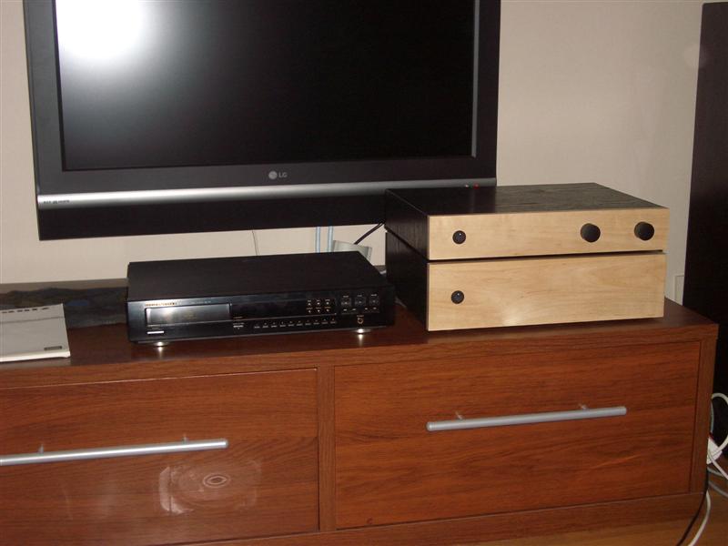

My latest contribution. A couple of things that I have spent the last month or two putting together for a friend (have taken my time at it) and have now got all flaws taken care of.
DC-offset can't be measured with my multimeter under normal use and with a pair of ZHorn Herukas (Fostex 168EZ-sigma) a light buzz is just noticeble at a range of a few centimeters so I am quite happy with it. Oh, It is a hardwired LM3875 Gainclone with dual transformers of 2x25V and approx 200VA each.
The preamp is a Freebird with one OPA134 per channel.
The CD is a Marantz CD-57 with some parts removed (thanks to the guys in the Marantz modificationthread!).
kmj: We notice a Marantz CD player in your system. Wondering if you have considered any players that will playback DVD-A (DVD-Audio) &/or SACD ... ?
I have a pioneer PD-656 which plays SACD and DVDA but I rarelly use it. I have never gotten hooked on these things, I have some DVD-As but seldom even play them.
That's a really fine pre-amp & amp setup ... wondering also if you have any inside pics?
Ah, you want nudiepics?

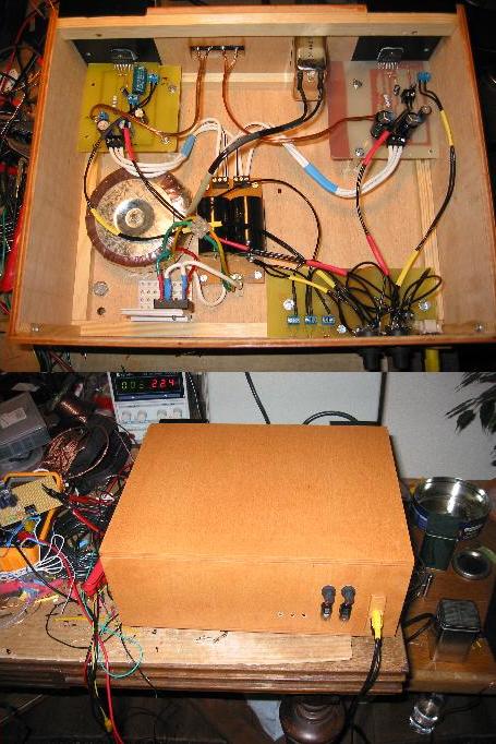

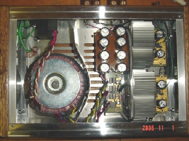

And the poweramp.
I had som buzzing in the beginning and tested to add aluminumfoil as isolation but the problem was ofcourse the grounding as usual ut since I glued it on it has to stay where it is.
It might look like a ratsnest but I swear that it is ok :D
And building the top and sides in one piece and the bottom, front and back in one makes it easy to fiddle around with ;)
Oh, EDIT:
the sugarlumps (Eurosockets?) came with the broken amps a salvaged them from and since they where already there I didn't bother to remove them. Doing that might make the layout a bit nicer but since it works fine I'll leave it as it is.
