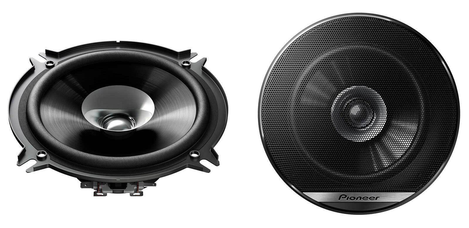

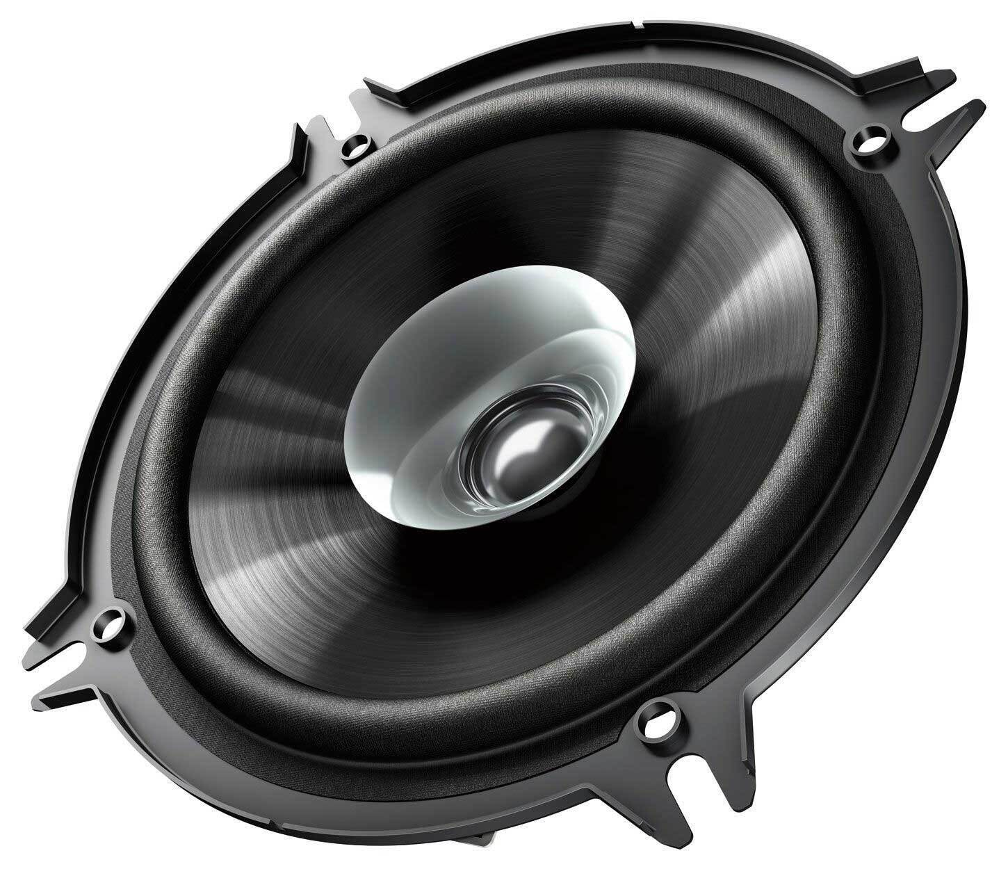

The fullrange driver is a
Pioneer TS-G1310F​
out of actual production.
It has a stiffer polypropylene double cone. This kind of cone would have been considered "High End" in the 80ies.
In a listening test it showed really good sonics and measurements also looked acceptable.
However the driver has a pretty standard driving system as there is no copper / faraday ring used. It means the impedance of the voice coil could be lower for better high frequency reproduction and the distortion could be less I am really glad to see and hear if the distortion goes down and bass and high tones will be accentuated.

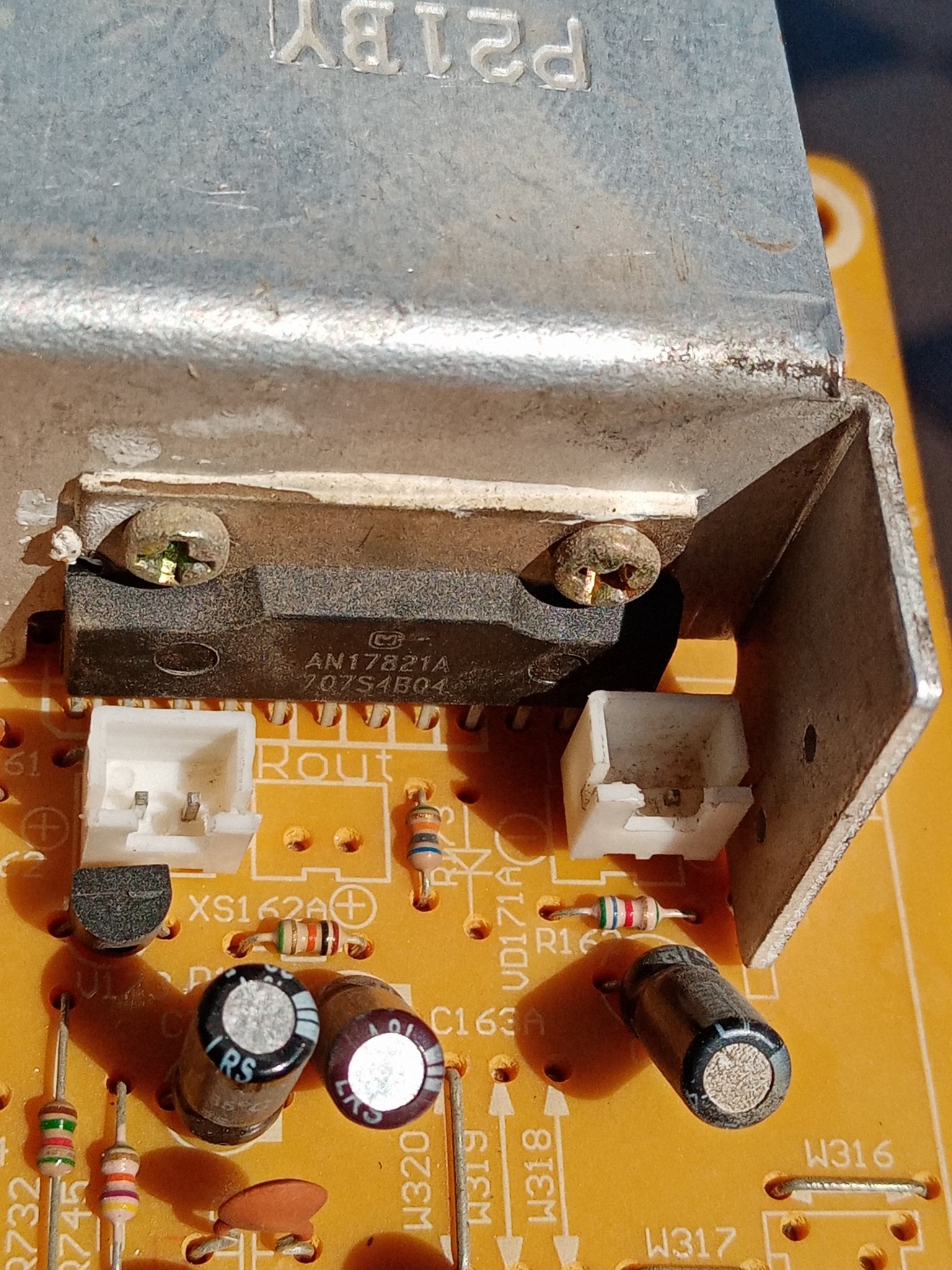

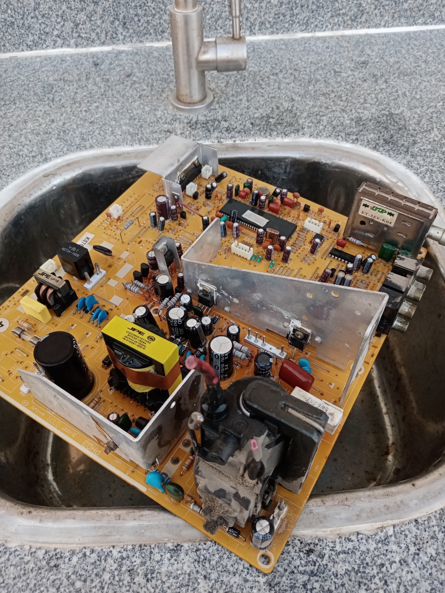

The amplifier in the television is an AN17821A, nice small BTL amp

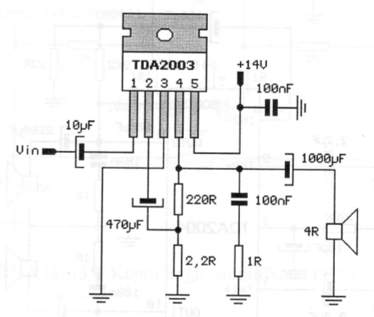

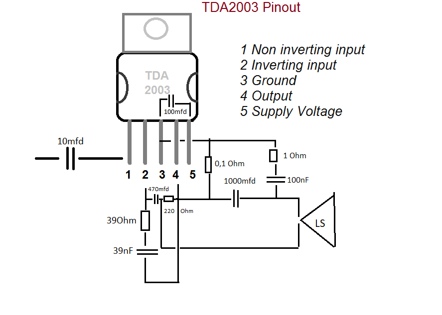

I was making a new schematic in order to plan how to hard wire the handfull of parts I need to make the "current feedback" amplifier with the TDA2003 amplifier as far as this is possible with a 2D schematic.
Does anyone know if I can use one SMPS for left an right channel (two TDA2003) concerning hum or noise? Or would it be better to use two SMPS besides the fact that I would have more power headroom with two SMPS (=separated power supply for each channel)?
Can I wire to the 12 Volt SMPS also the preamp (which has its own LM7805 to generate the 5 Volts it needs) - or is this not good concerning hum or noise?
Is a simple star grounding enough or shall I separate a little bit the power section from the input section? (Although I did not really understand why only some centimeters of separation on the ground shall help anything concerning noise and hum).
Yes you can power the preamp out of the same main 12V supply,doubly so if it has its own regulator.
You must be careful with grounding, but that applies everyhere.
What scratches me backwards is having a meager 5V supply for the preamp,what kind of signal can it put out?
Please post a direct link to it.

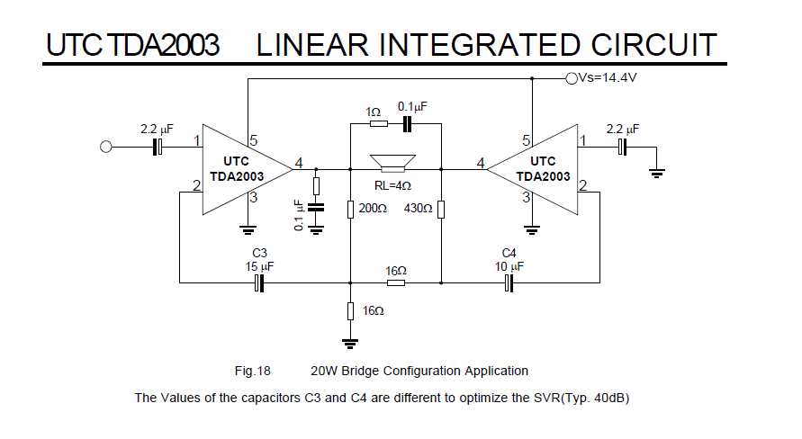

As I am not into electronics, what prevents BTL configuration being used with current feedback?
Why does the bridged amp not need the output capacitor of 1000mfd? Is there no DC in this configuration on the output?

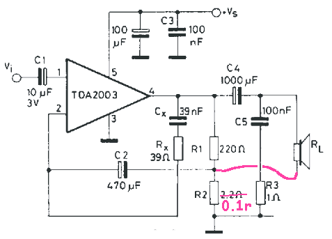

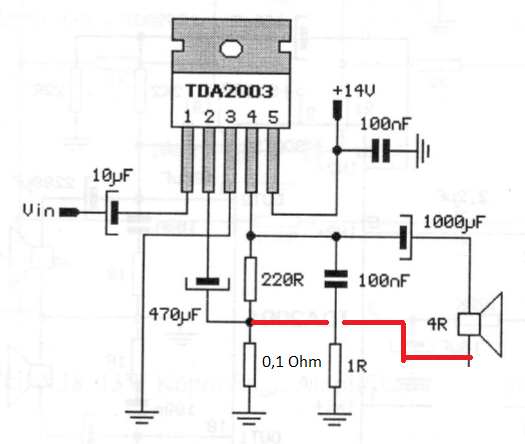

In the proposed current feedback schematic there is a 0,1 Ohm resistor instead of 2,2 Ohms - does this low resistance not prevent to let the electricity flow to the loudspeaker which has a higher impedance?

The .1R is in series with the loudspeaker load, not in parallel, so the current flowing through it will be approximately the same as what's traveling through the speaker. .1R is better than 2R because the feedback is set up to put a fixed current through the resistor (and thus the speaker). The higher resistance, the more power is wasted in the resistor (and a higher power resistor is necessary).
Is the 0,1 Ohm resistor setting the gain? I read that the 220 Ohms together with the 2.2 Ohms are setting the gain in the standard schematic for the TDA2003.
I appreciate 0,1 Ohms because the amp does not have much watts - and it should not be wasted.
