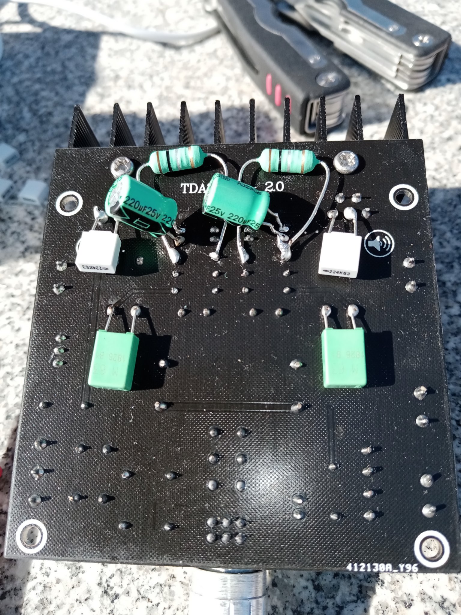

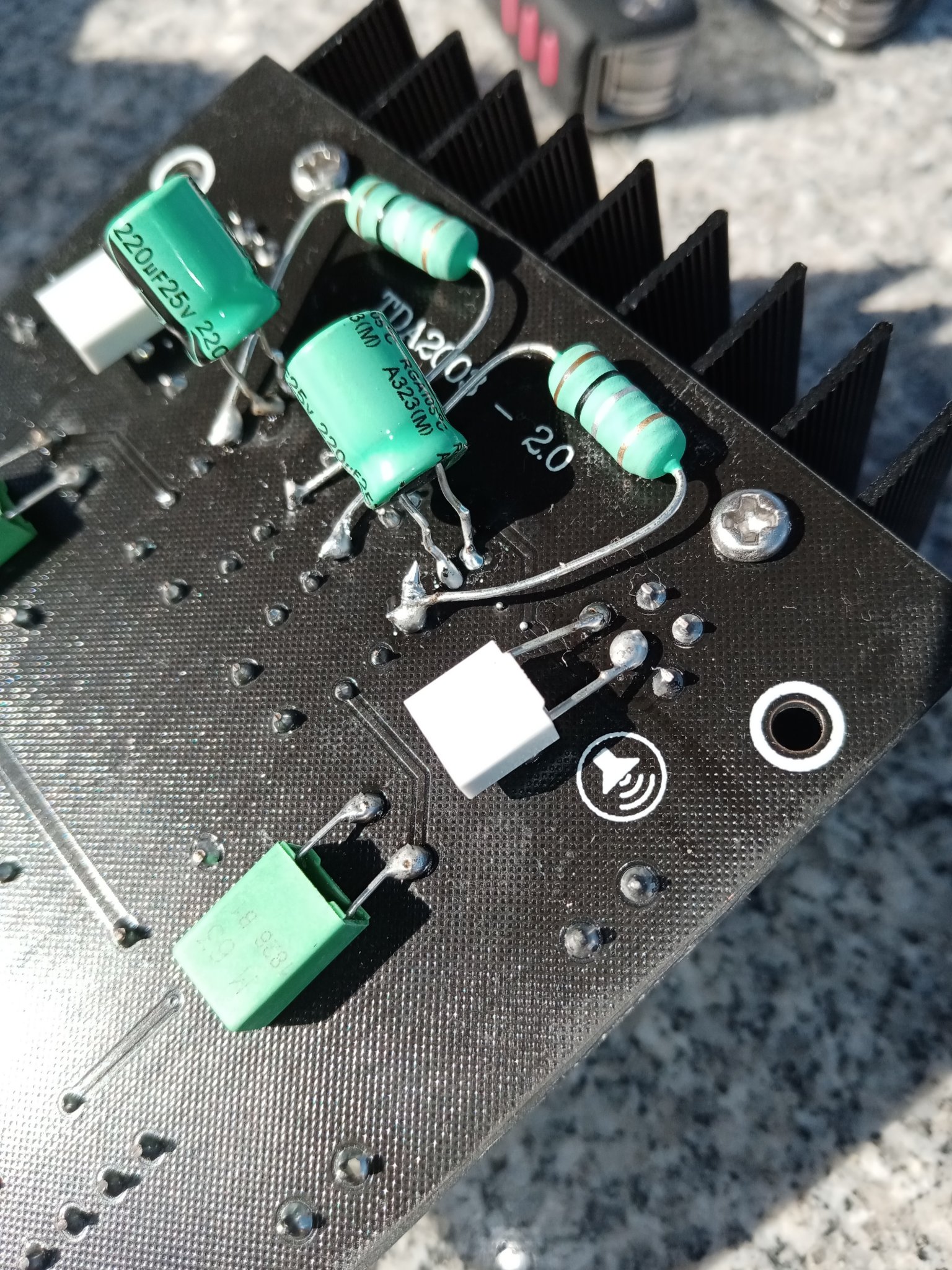

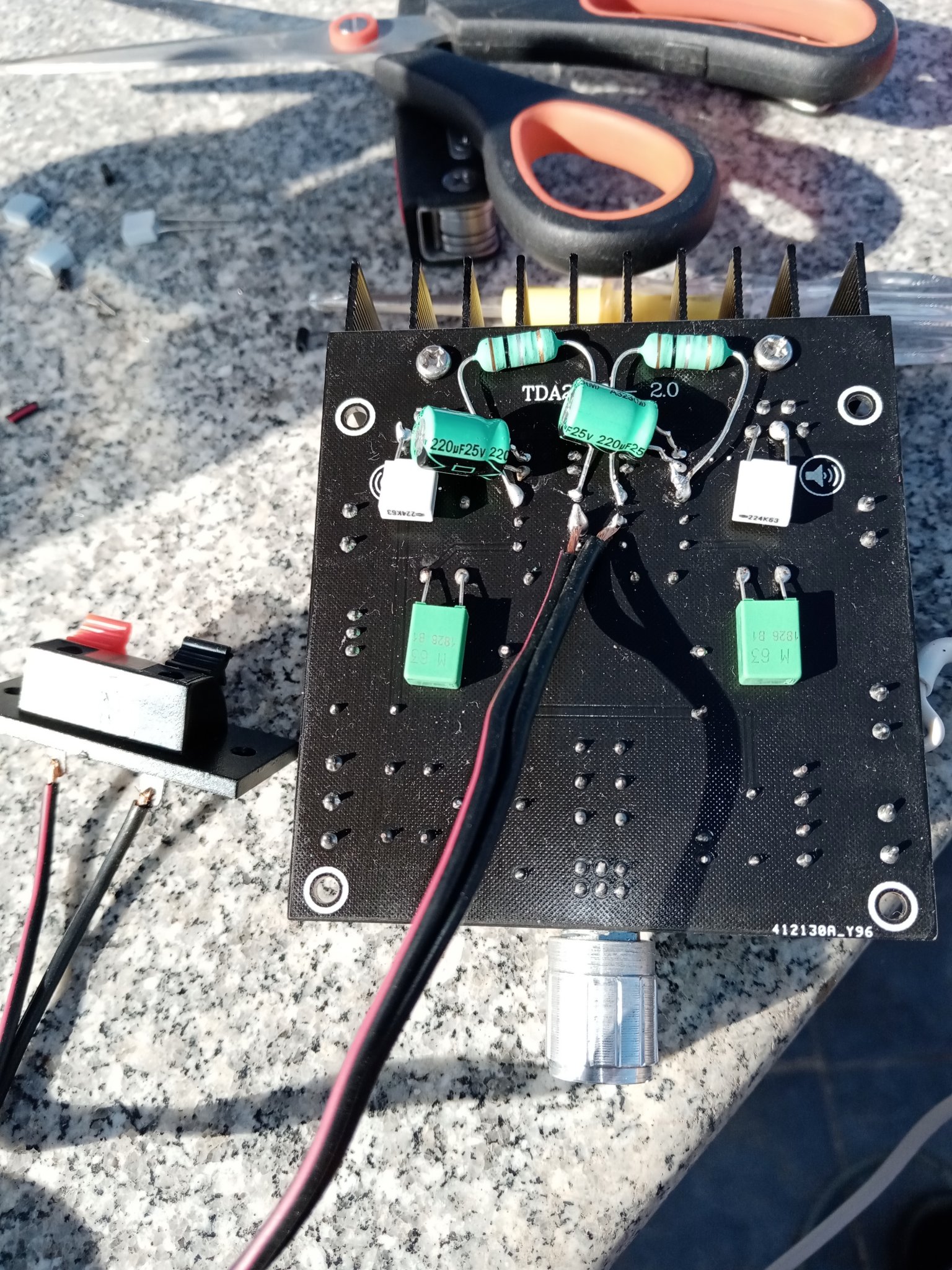

Now I soldered everything.
0.22 mfd foil directly to the pins 3 and 5 of each TDA2003 chip.
220mfd additionally to 220mfd on the board to come closer to the regular 470mfd.
1mfd foil for coupling capacitor on the output. On my board it's 2000mfd 25v.
0.1 ohm in parallel to the highish 4.7 ohms which are in the datasheet schematic 2.2 ohms.
Current feedback wiring (minus for the loudspeaker) derived from the point behind 220 ohms. Omitting the minus for the loudspeaker on the board.
Will make a soundtest now.
With one loudspeaker connected to the board and the other to the current feedback. Just to have a comparison.

First listening test: works good
Brings the Pioneer fullranges I wrote here about to high end level.
You do not need to add any highs any more. Instead of adding highs I have to put down 8khz by one or two DBs and 3khz by one db.
Bass is controlled and correct but not fat or too much at all. Speakers are now not close against the wall. If put close to the wall no extra bass is necessary.
As expected distortion gets down and brings this speaker to a new level of quality sound.
Quite happy with it!

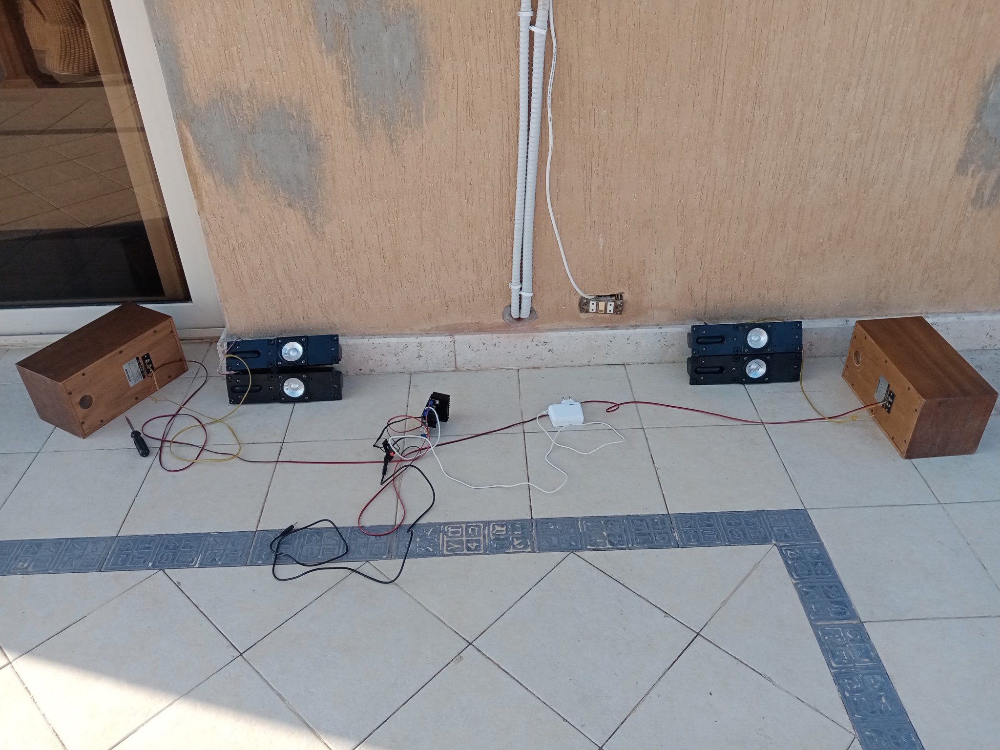

With the speakers down put on the floor no eq correction necessary.
I am quite impressed. Sounds very classy.

Today I tried another loudspeaker which has faraday rings - 8cm fullrange drivers - diaphragm covered with aluminium foil.
Current feedback with the TDA2003 has sonical benefits also for this kind of loudspeakers with faraday rings. Which already have less distortion.
It really brings these to a new acoustic level.
At all frequencies it is clearly audible. The bass becomes much better, too.

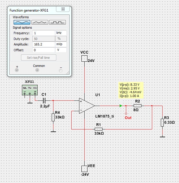

"I will try out now current drive or current feedback with the LM1875."
or? Will you try 2 things or are they the same?
I'm interested in making a LM1875 amp perform current drive - i.e. high output impedance....
I have purchased a LM1875 based amp ans waiting for delivery...

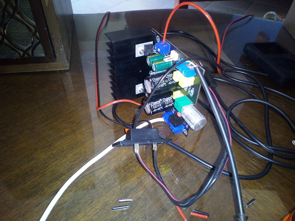

I bought now three stereo amplifiers LM1875 which I will try to make work with current drive/current feedback like in the schematic which I posted from this thread here. Three for 18 Euros from Aliexpress (directly from China). It will take some time until the amps arrive.
They are ready for use with a transformer 15-0-15 which has to be added. Hope I can do it. I will have to study the schematic and the parts on the board in order to find out how to change the wiring.
I already did that with a TDA2003 amp I bought. But now it is out of stock on Ebay and on Aliexpress. What is a pity.
Maybe LM1875 will sound better because there is no coupling capacitor needed.
Here the modding of a ready made TDA2003 amplifier to current feedback:

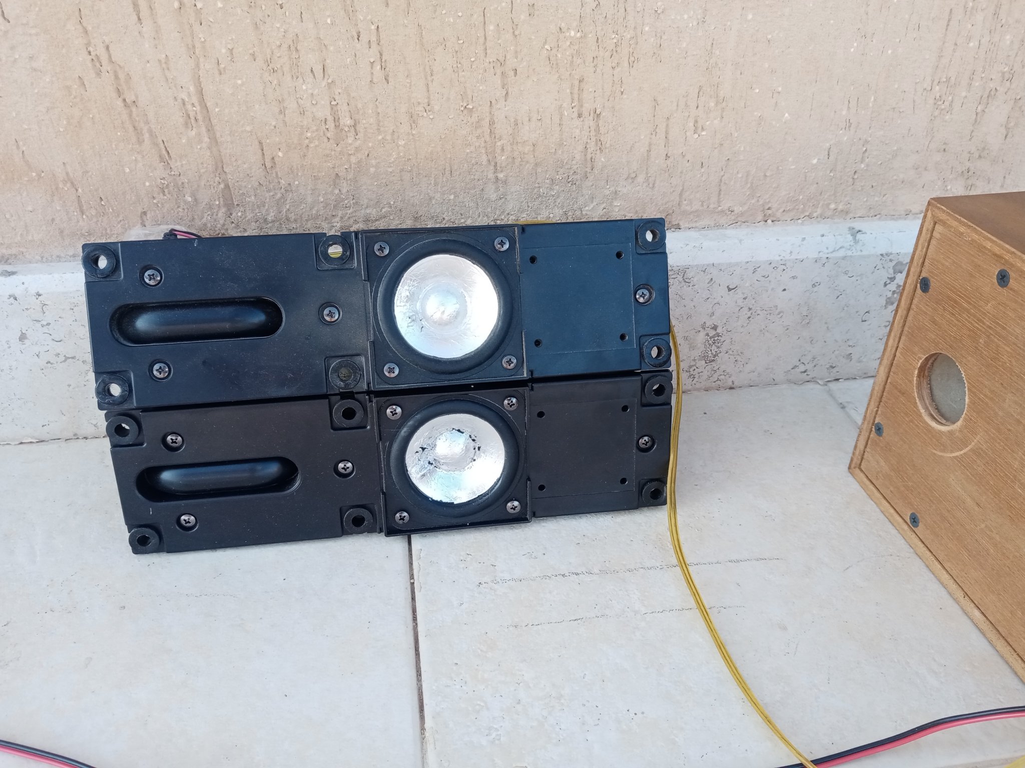

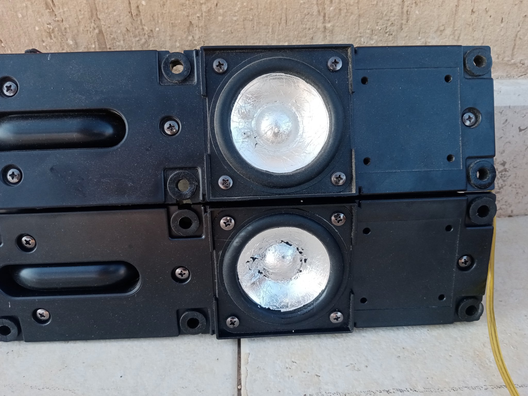

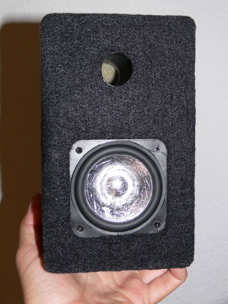

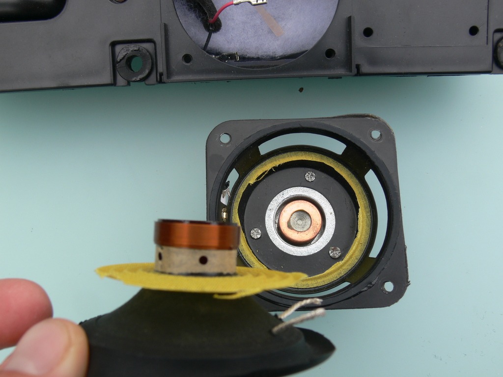

Just a side question: is the copper cap already present in this little driver you show, or did you mount it yourself? What driver is it?
Its a JVC fullrange driver from Pollin germany. It was part of a TV loudspeaker intergrated in TVs. Got many of them for little money. They are in 1 Liter PVC reflex enclosure from JVC linear from 65 Hertz to 18 khz. Ideally put against a back wall or between two walls like corner or on a desk close to the wall.
They work very well without room boundary reinforcement when taking four of them per side in a little line array.
Copper cap already there. You can add yourself copper with a 50 cent trick see this post
