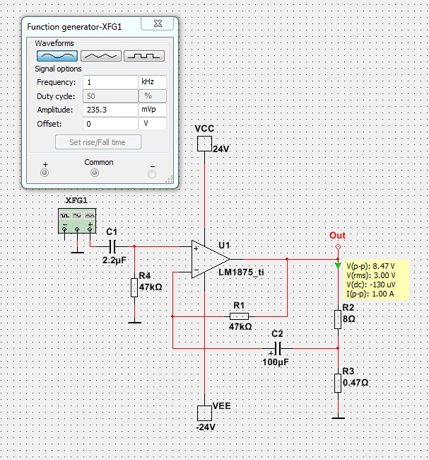

Here is my recommendation for CFA the LM1875.
The capacitor C2 is needed for lower Vdc offset on output.
Otherwise you end up with 4-5mV offset.

Thanks lineup! Could you please indicate what to change if I's wanted the lowest gain possible.
I will experiment with this amp for a 18sound 1095ND CD and dont want to do to much digital attenuation.
These are 16 ohm version but I now run them with 24 ohm in series driven by a small Anaview amp but still need 9 dB digital att.

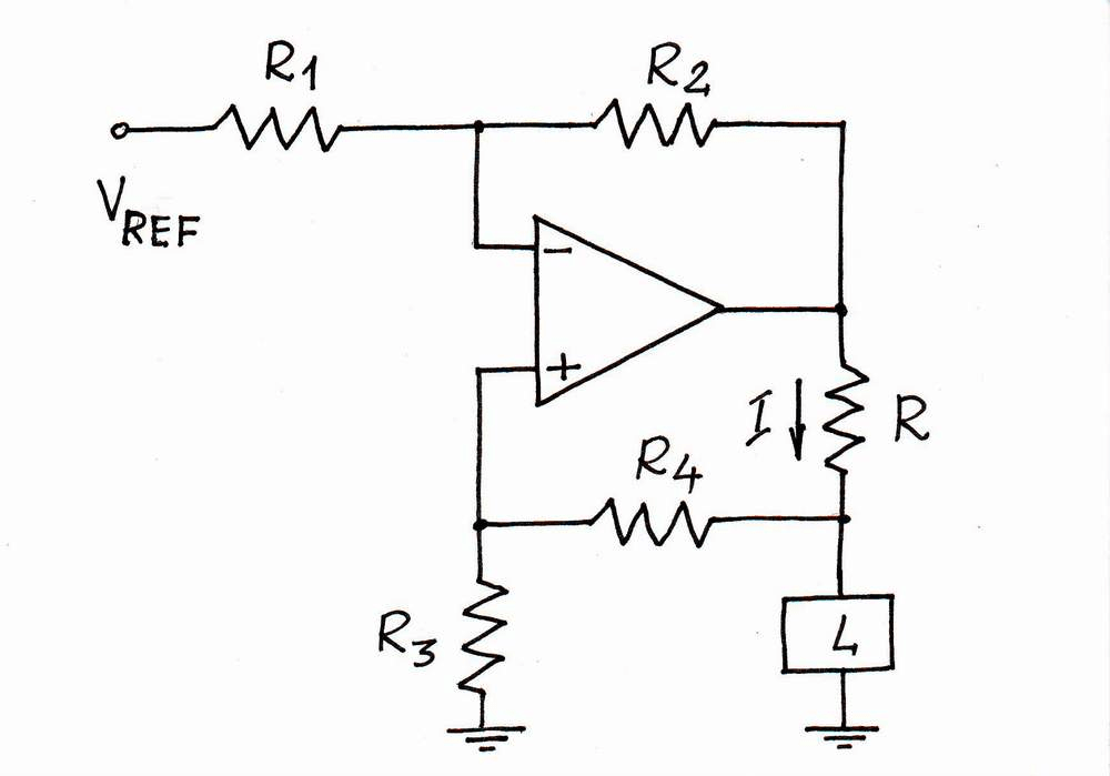

The current sense resistor does not have to be in the speaker return/ground. It can be in the supply rails or between the output and the speaker.
https://e2e.ti.com/support/amplifie...m/532277/constant-current-source-using-op-amp
https://www.edn.com/op-amp-can-source-or-sink-current/
This means that, yes, you can current drive a bridged amplifier. Since you are defining the current with the first amplifier, the second amp just increases the potential voltage available.
But I don't think actual current drive is a good idea. A better idea is a defined impedance that matches the speaker, which is also possible, but a bit tricky math wise, mixing negative and positive feedback. I did this years ago to match a 600 Ohms telecom application and modems did this.
https://www.researchgate.net/figure...ed-with-current-mode-amplifier_fig2_271530002
The change should be the 0.47 resistor.
Gain is 8/0.47 which is like 17.
If you take a 1 Ohm resistor you get Gain = 8.

Another thing.
8 Ohm speakers can have other impedances than 8 Ohm.
Probably 5 or 6 Ohm in some part of the frequency.
So, I would say a value of 0.47 Ohm should be a good thing.
Otherwise the Gain = 10 rule of LM1875 is violated.

What wattage on R3?
C2 = 100uF... if I know I will only run the amp from say the absolutely lowest... 500 Hz - can I make it smaller?
R3 should be at least 2.62 Watt.
This is with +/-24 Volt supply and R3=0.47 Ohm and 8 Ohm speaker.
So I would say it should be a 5 Watt resistor.
The capacitor C2 can be anything from 10u to 100u.
It does not affect the upp bandwidth. It stays at 300kHz in any case.
C2 affects the lower bandwidth, -3dB.
10uF = 7Hz
100uF = 2 Hz
And between those C2 can be 22uF, 47uF, 68uF

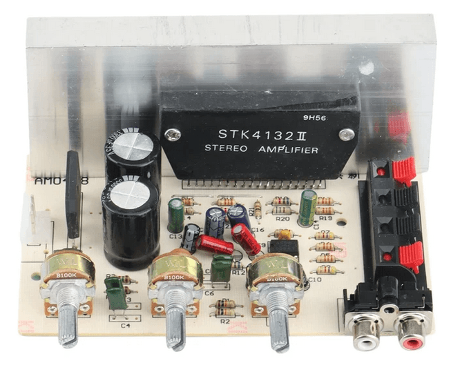

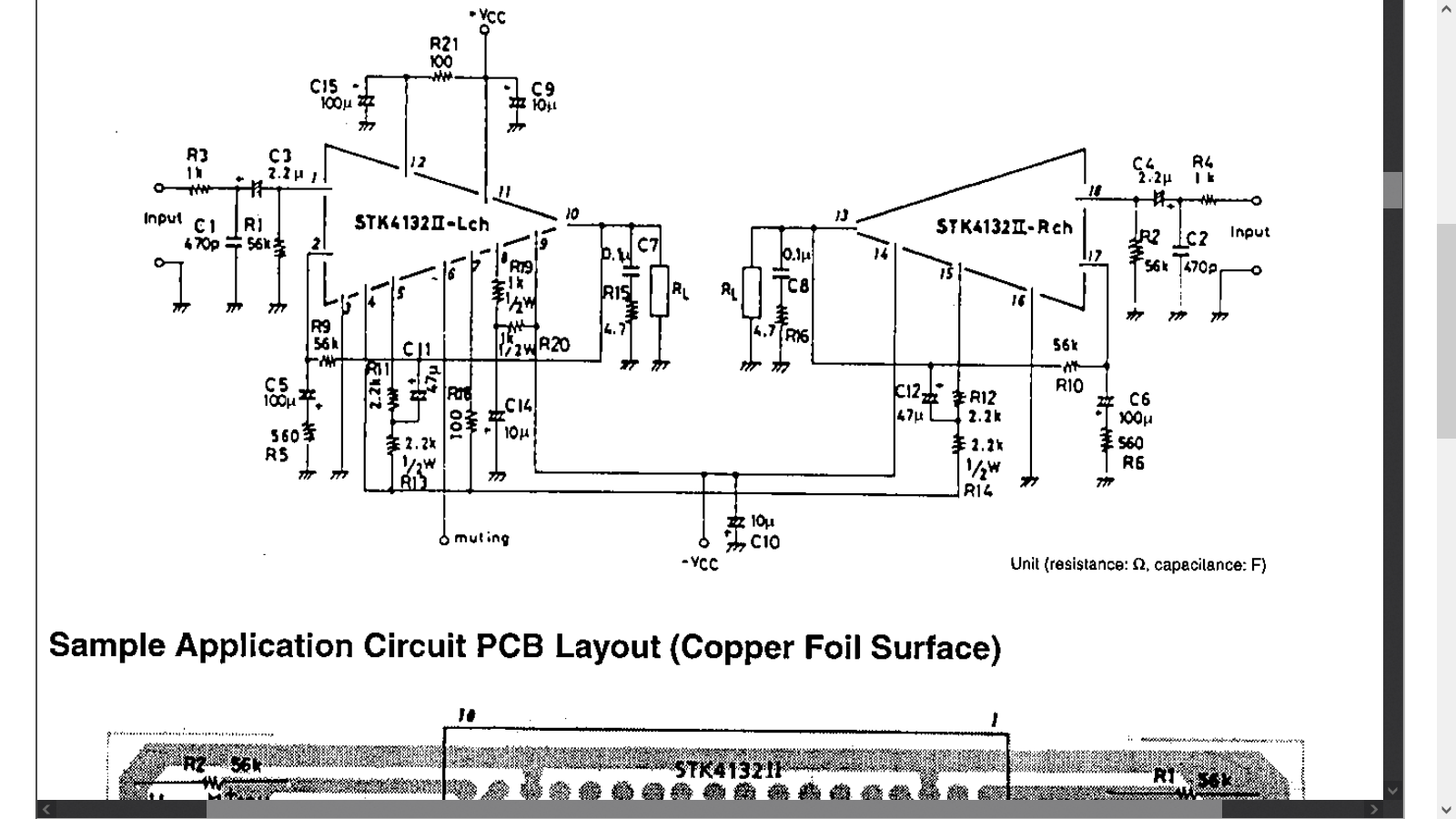

Does anyone have an idea how to convert STK4132 to current drive / current feedback?
Maybe similar to STK 4142?
I found a nice ready made board for doing it.

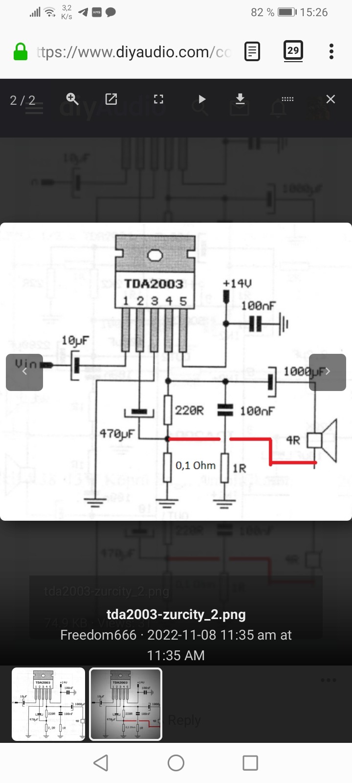

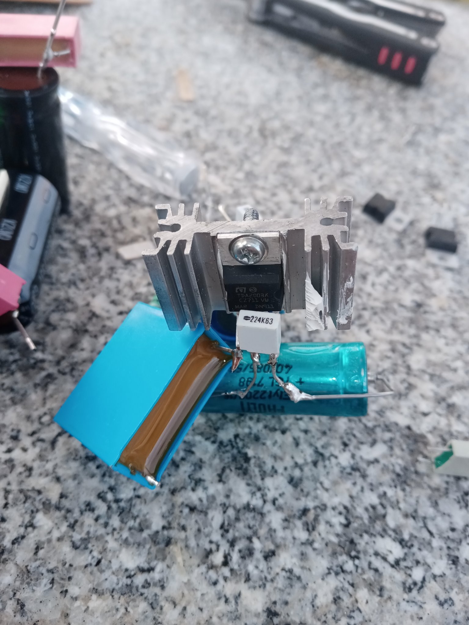

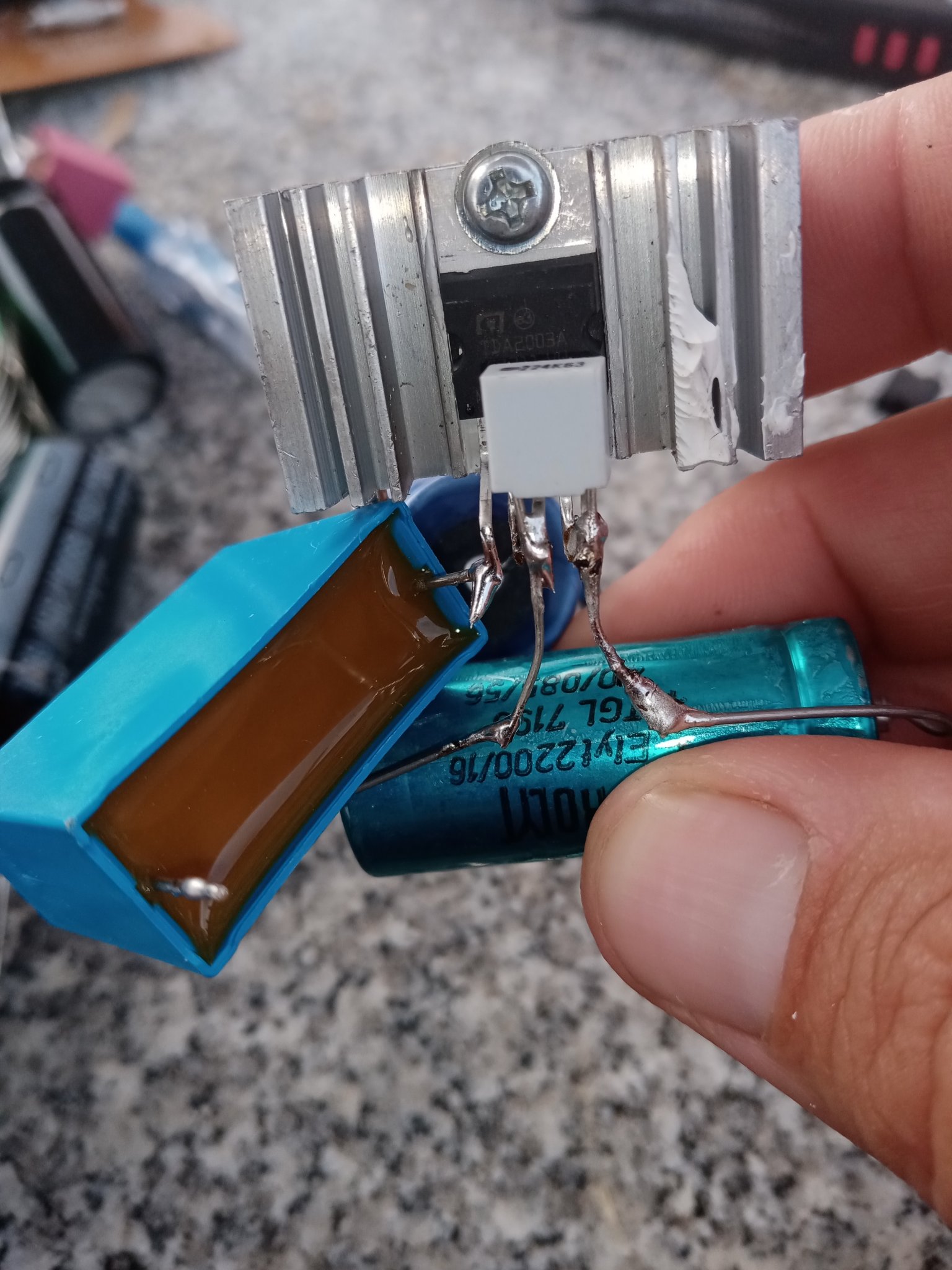

Making a hard wired TDA2003 now.
Does anyone know, do I need the Zobel of 100nanofarad and 1 ohm for the TDA2003 if I never put a capacitive load like piezo tweeters on the output?
I only use fullrange drivers with a voice coil and nothing else. No network at all.
Can I leave the Zobel out then?
