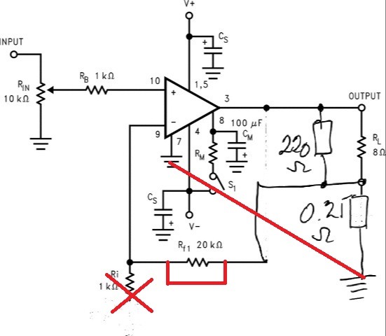

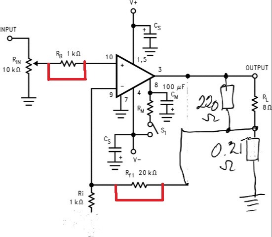

as i am not into electronics but want to understand well is the the schematic now proposed? (See attachment)
Just tell me where to attach the 0,25 Ohms to ground in the amplifier? To GND at the LM3886 chip in the shortest way?
So this schematic is for 33x amplification.

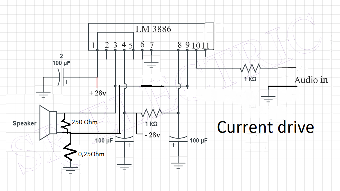

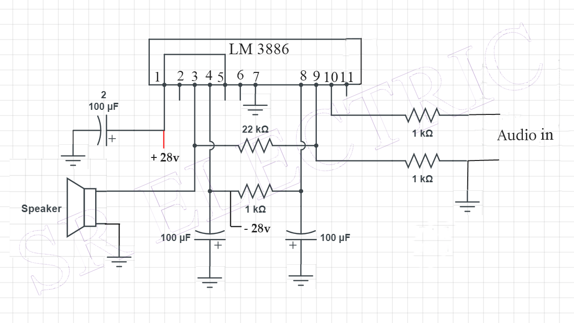

As I maybe want to hard wire this amplifier I found a schematic for doing this on this website:
https://srelectrics.com/2021/02/03/how-to-make-high-bass-100-watt-audio-amplifier-circuit/
Current drive would look like this. If there is a fault please tell here.
Attached Files: Original schematic for voltage drive, modified schematic for current drive.

What is the intention of the 220 Ohm resistor between plus and minus at the loudspeaker output?* I didn´t even mention the 220 ohm resistor since it´sway higher than any impedance an 8 ohm speaker can take, so we can safely ignore it and simplify Math.
Is it necessary for stability or current drive operation? Or could it be left out?
Leave out that resistor. Disconnect the speaker. The amplifier has no NFB, wants to run "infinite" gain, goes out of control.What is the intention of the 220 Ohm resistor between plus and minus at the loudspeaker output?
Well-behaved amps will just go to the rail and stay there. Many amps and layouts will squeal, perhaps supersonic.
I'm not sure 220r is the 'ideal' value, I'll leave that for fans of underdamped speakers. We do see it a lot in guitar amplifiers as a fair approximation of zero-feedback power pentodes.

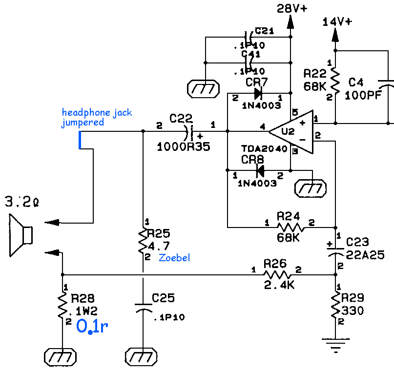

Hello, interesting to see this one. Could be used with simple Laptop power supply. Could be tried, too.This worked for Peavey. The multiple feedback loops give the designer more things to tweak. Yes, it is "drawn backward" with a funny style and is single-supply and a different chip.
However I think +28 is the main power supply positive rail. What is +14 Volt in this schematic for?
Should'nt C22 (1000 mfd 35 Volts) be of a bipolar type?
I use that 220 ohm just as precaution if there is no speaker connected. If there is no load, current drive amp will raise the voltage to produce current, but nothing will flow. Than someone will plug the speaker and get surprise.
If you are sure you will not mistreat the amp, you can omit it. I would not.

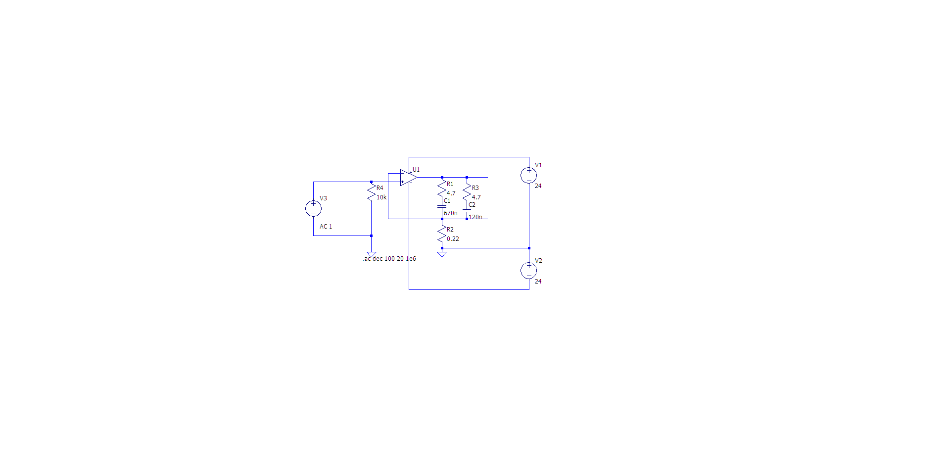

my 2c: all you need is to ensure 3886 stability if you use DSP to EQ. I'd use 0.22 | 0.25 Ohm in series with spk; instead of a single 220 Ohm: {4.7 Ohm + 10uF} || {4.7 Ohm + 330nF} bypassing "4Ohm" spk. Double R / half C for 8 Ohm. The gain will be ~20dB, Ft~200kHz. Basically, you need to repeat gain/tau from figure 3 in the datasheet.
Functionally, I'd think you need 26dB gain on audio frequencies and a drop to 20dB from 140kHz to 280kHz (for the sake of safe phase margin). That means in line with the speaker = Re / 20. Spk impedance grows as sqrt(f), so you need to limit it. So ... something like that.
