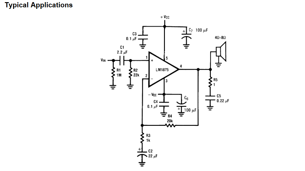

WHY would you put a low value resistor (9.4 ohm for an 8 ohm speaker) in parallel with speaker in a system designed to current drive the speaker?my 2c: all you need is to ensure 3886 stability if you use DSP to EQ. I'd use 0.22 | 0.25 Ohm in series with spk; instead of a single 220 Ohm: {4.7 Ohm + 10uF} || {4.7 Ohm + 330nF} bypassing "4Ohm" spk. Double R / half C for 8 Ohm. The gain will be ~20dB, Ft~200kHz. Basically, you need to repeat gain/tau from figure 3 in the datasheet.
5uF + 9.4 ohm (your suggestion) means that speaker will practically halve its impedance at around 3300Hz so it will lose almost 6dB at that frequency, worsening as frequency goes up.
That speaker will sound duller than a blanket.
Even worse, its impedance at 10kHz is 12 ohm increasing treble, ... but now it will lose even more, the combination will be 5.7 ohm so treble loss will be over 6dB.
Making current drive meaningless.

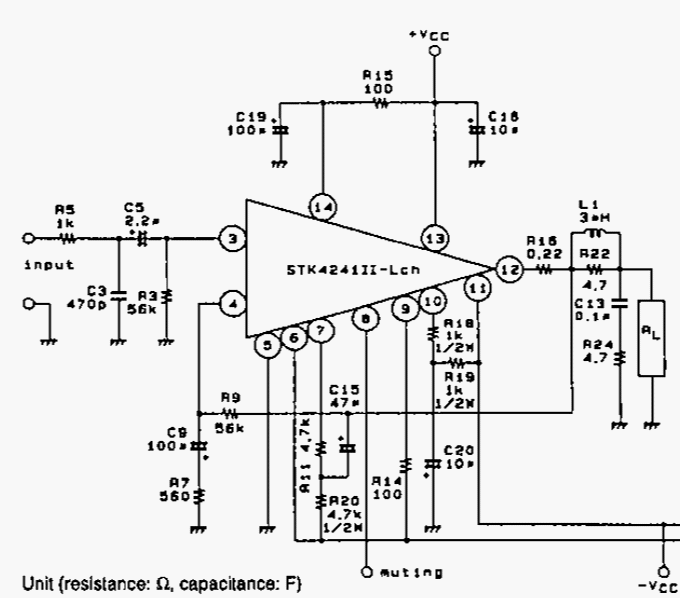

This is the schematic of the STK4241mk2.
The current sensing 0.22 resistor is located at the output of the amplifier before the load.
If no load is connected, the amplifier remains stable.

You are correct. 5u was a typo. I meant 0.5u - for 4 Ohm spk, what is 0.25u for 8Ohm. so 3k3 -> 66kHz.WHY would you put a low value resistor (9.4 ohm for an 8 ohm speaker) in parallel with speaker in a system designed to current drive the speaker?

I don't see how 0.22 senses anything. IMHO, it is a regular voltage drive with 40dB of gain.This is the schematic of the STK4241mk2.
Regards
Mike

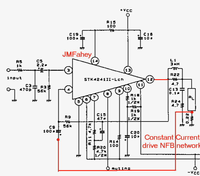

I looked up the schematic - it was the unchanged voltage driven amplifier from the producer of the chip as far as I could see.I don't see how 0.22 senses anything. IMHO, it is a regular voltage drive with 40dB of gain.
The 0.22 ohm resistor between STK output and speaker not only does not increase output impedance or lower damping (same thing) but also "it isn´t even there" because voltage Negative Feedback is taken after it, output, as seen by speaker, is pure voltage only.
Amplifier behaves like a pure voltage generator.
On the contrary , if we put exact same 0.22 ohm resistor between speaker return and ground, and take NFB from there, amplifier will still keep such output voltage stable , independent from load, that´s what voltage NFB does, BUT now it will be constant across the 0.22 ohm resistor ONLY, independent from what the speaker itself drops,so for the speaker, amp will behave like a constant current source.
Which is what we wanted.
Not difficult, definitely not "magic", once you understand how it works, it "clicks" in your mind.
That´s why I said earlier: you don´t need to hunt for a specific constant current chipamp, ANY one can be made to work so, by proper choice of NFB network.

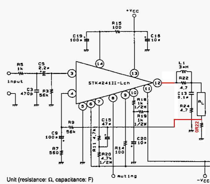

Thanks for the explanation.
I've amended the schematic for the current drive mod.
I think this is what you're referring to.
Since you are taking 0.22/8.22 of the output voltage, R9 should probably be dropped from 56k to 1.5k.I think this is what you're referring to.
IAC, C15 has to be driven from the chip, not the 0.22r.

Almost there but still a couple errors.Thanks for the explanation.
Too sleepy now, will edit and repost your schematic when I wake up.
Here, this is the proper way.
* you keep DC NFB , DC unity gin (so minimized offset)
* you have 100% current drive
* Now current into speaker is Vin/0.22 ohm
* Gain is RL/0.22 ohm
* Have been using this in my Guitar amps since 1972
Musicians call them "bold, brash, aggressive" or "Fahey amps have bite"
Simple, huh? 😉

That is really simple, like it. AND the chip is commonly available.
However, is there a parts list? I can not read well all the values. Like C3, L1, R22.
