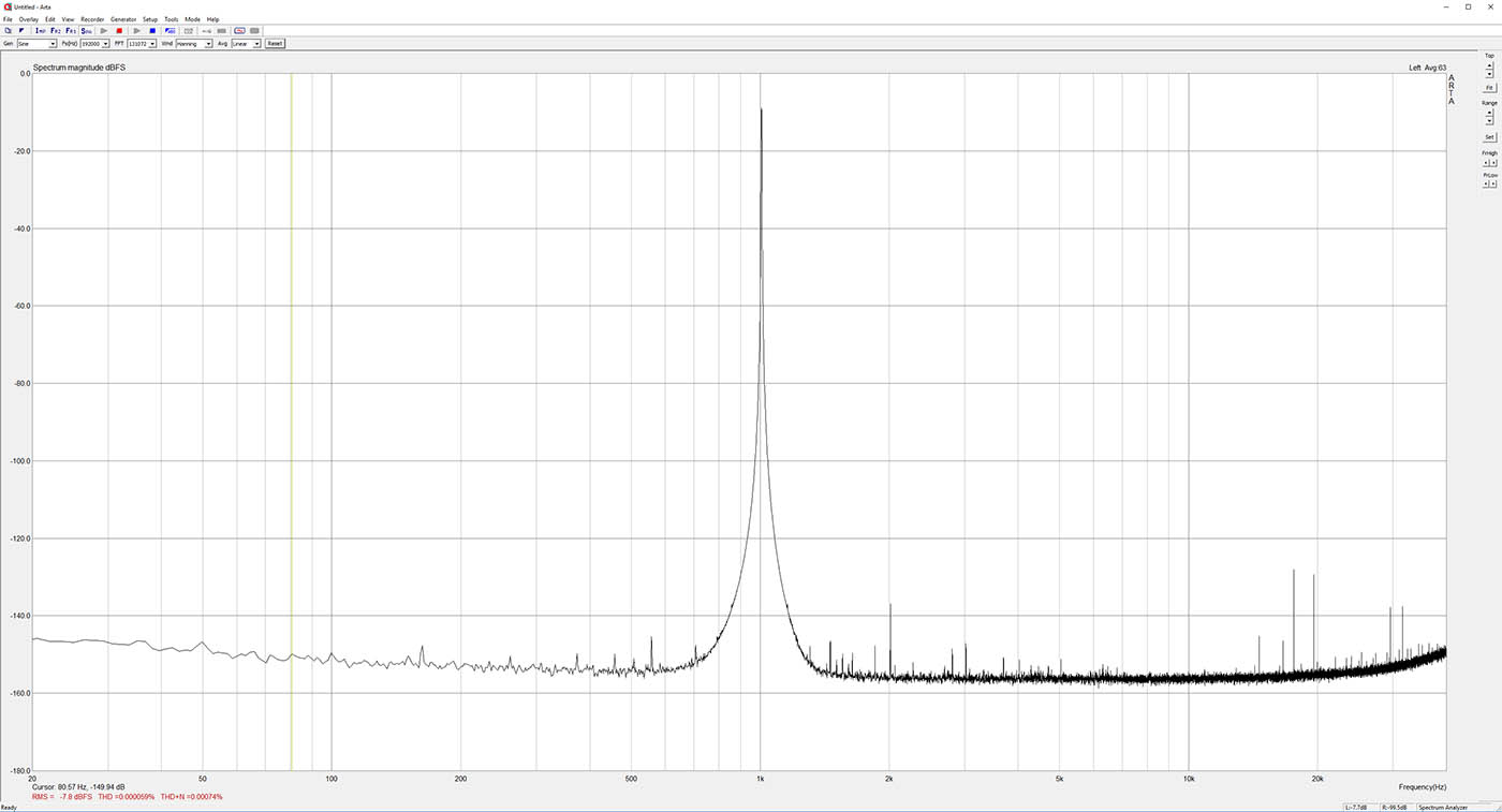

These are the latest measured results after a number of modifications. Unfortunately did not save measurements from before, but they were around -105dB distortion if I remember correctly.
Now, I will try to find a solution for the noise. Not that it is audible, but for the heck of it. I hope to post pictures before and after.

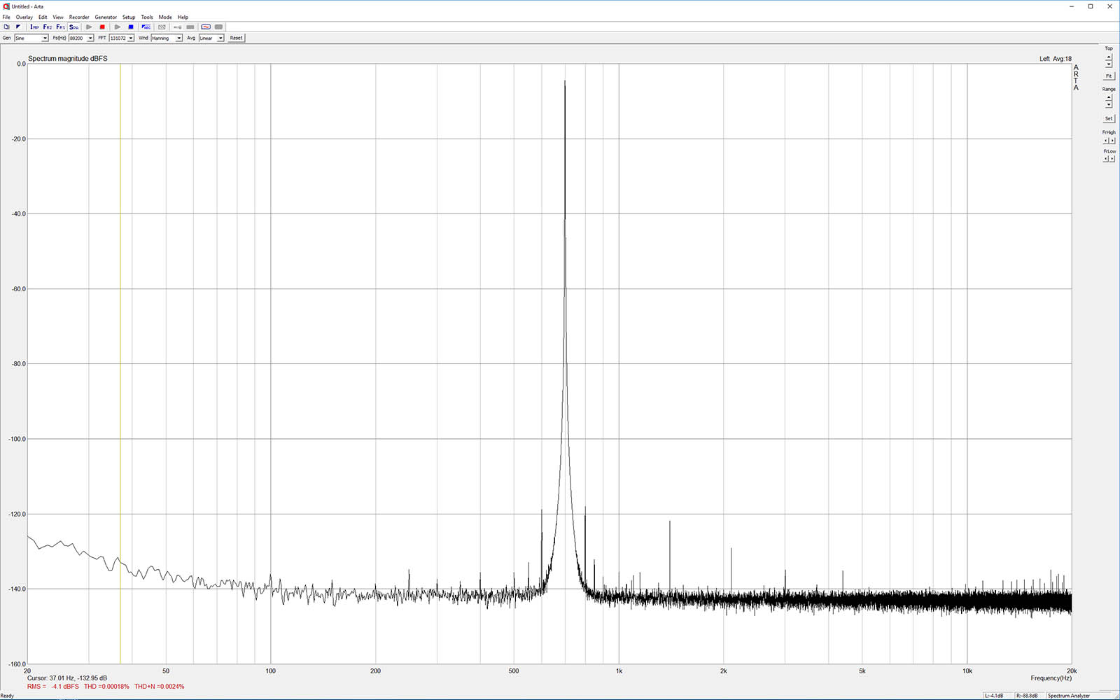

So, as you can see, distortion is pretty good. However, noise isn't, as the following measurement shows.
We can see two things in this measurement. The first is that as a percentage, noise is more than 10 times higher than distortion. Since distortion is extremely low, that in itself is nothing to worry about, but it ain't right. The second thing that is visible are the sidebands around the 700 Hz central peaks, which are exactly 100 Hz right and left from the central peak. This is indicative of amplitude modulation, and not very nice to have. As to audibility, it is at an extremely low level, but it just should not be there.
As soon as RS delivers (which should be today, but one knever knows) I will make a slight adaption in the decoupling of the AK4497, which I think is responsible for this. That should also bring the noise level down.

< -120dB distortion from a 200 USD DAC!

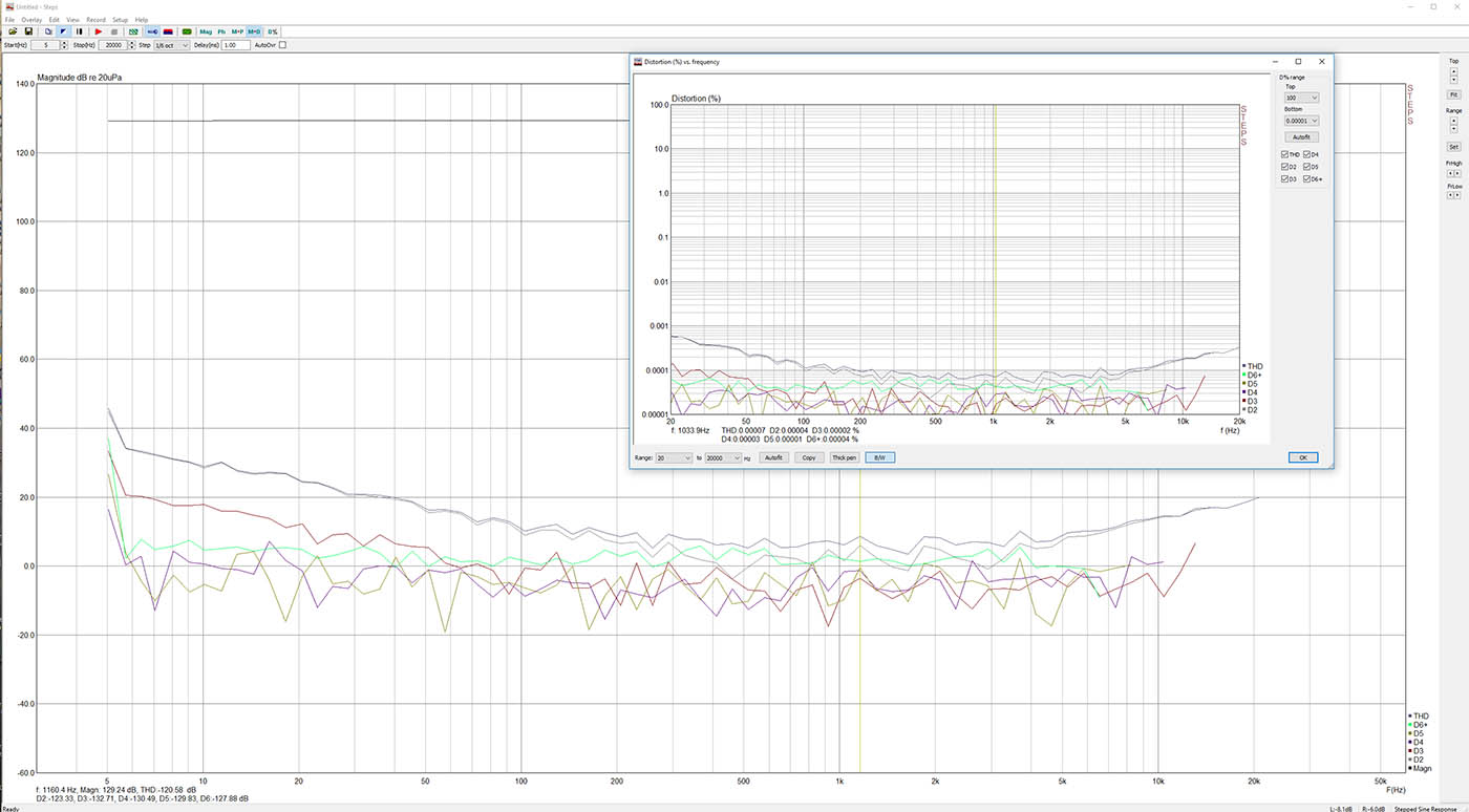

The more I have worked with this board, the more I am amazed at the untapped potential it contains. Look at these two measurements.
Headlines: 0.000056% THD, 0.00074% THD+N @ 1 kHz. I want the noise down further, but it is uncased right now, so that might make some difference.
<-120dB distortion from a 200 USD board!

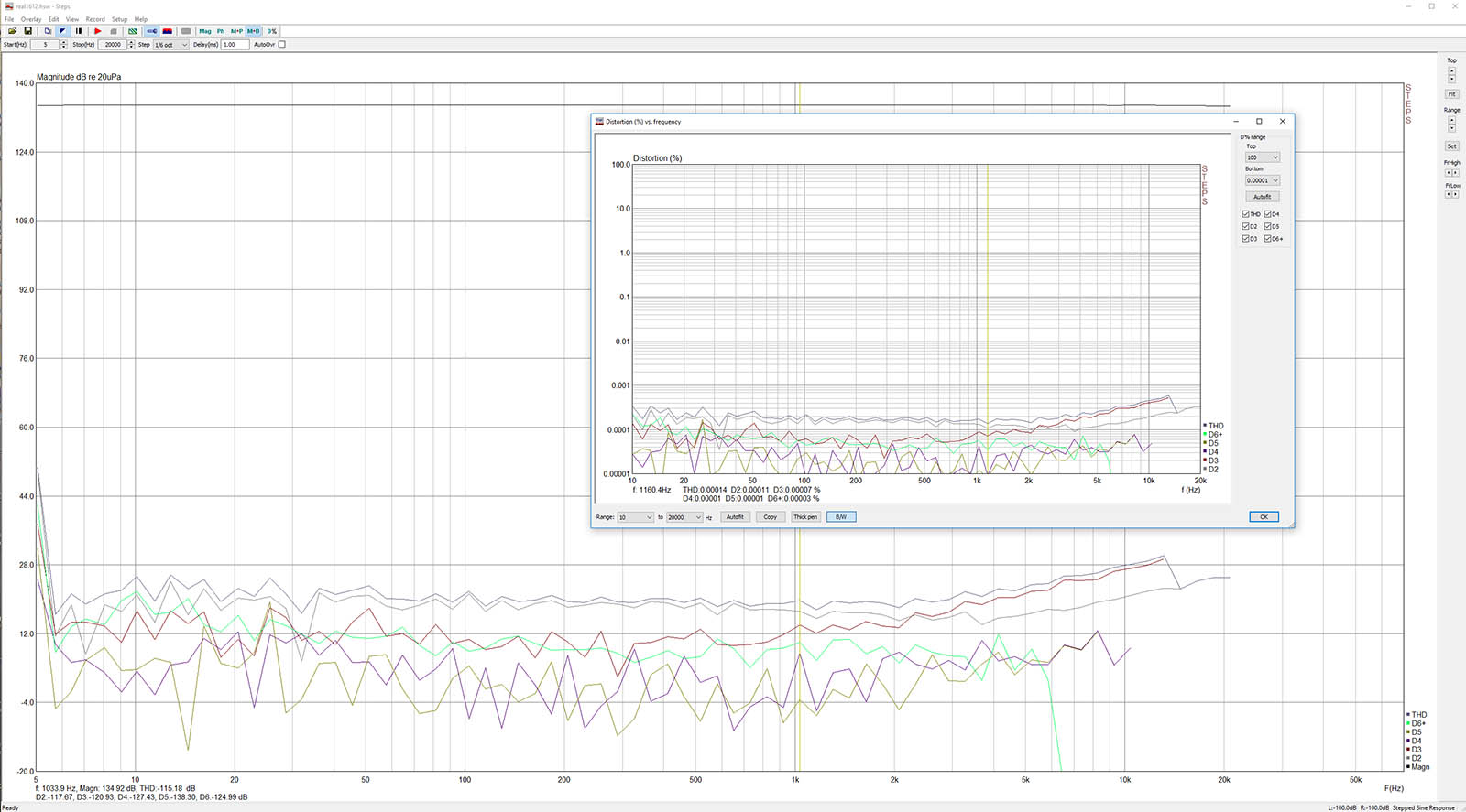

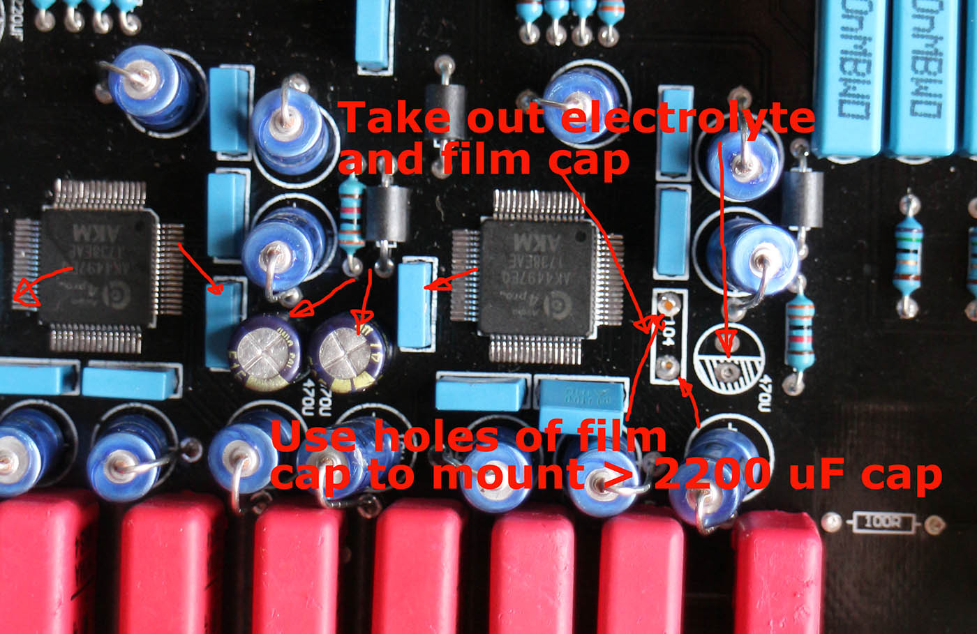

I found the cause for the AM-modulation that was made visible in the former FFT, and it is gone. The board contains one major error, as well as a number of other shortcomings, more about that later. But first another measurement showing distortion versus frequency.

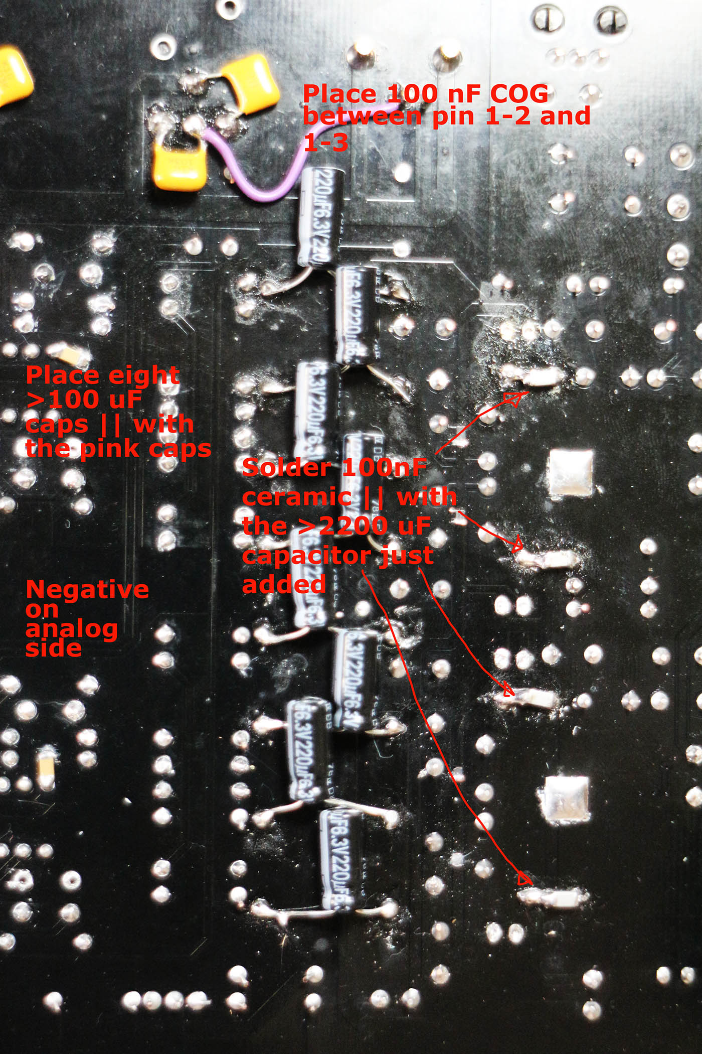

This modification is almost mandatory. The 1 uF coupling cap from the digital section is too small to drive the 10k resistor to ground on the analog side; 3dB point around 15 Hz. AKM recommends 100 uF coupling caps. I used 220 uF because I had them laying around. Adding these makes a large measurable difference and also make the bass sound a lot tighter.

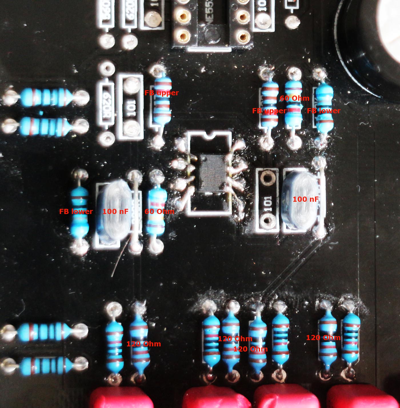

The coupling cap runs into a Sallen-Key connected opamp. AKM recommends a second order low pass filter with f3dB around 180 kHz. The values chosen on the board as it comes deliver a filter with a much higher corner frequency. I calculated the proper values for the SK-filter, but for reasons I don't want to spend time on, this created high DC-offsets. Therefore the solution chosen is to split the second order low pass in two. This here creates the first pole. 120 Ohm drive 10 nF for the required corner frequency.
This mod is equally recommended.

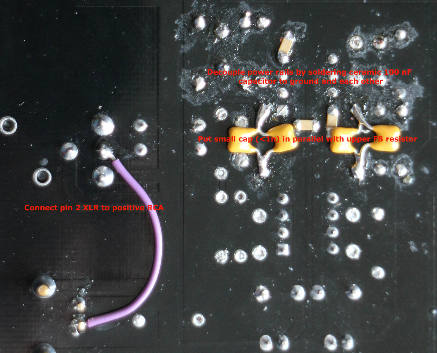

Below the opamp, proper decoupling close to the pins.
Easy to do and every little bit helps.
The other two pictures show a lay out error that has to be corrected as per instructions. The smal 47 uF needs to be replaced by something much bigger - 2200uF according to AKM. This lay out/ parts error in all likelihood caused the AM modulation.
In order to create the second pole in the filter, solder a 100nF COG across the active pins of the XLR to ground. Together with the 100 Hz output resistor, this brings us were we want to be.
Opamp used are OPA1612.
There is no reason to use a second opamp to drive the RCA output, it can only deteriorate sound. Therefore, the second opamp is ausradiert, see pictures.
It now measures better THD-wise than the published specs for OPA134 🙂

What I don't like is that at the low end, distortion has slightly increased after the changes. I will look at it tomorrow.

Thanks Vacuphile,
That's a nice write up.... The board is not in yet.
And i guess i have to sleep a night or two to do those mods... I would like to though.
The first picture looks simple to do... The others looks more challenging.
But it can be more simple when i have a vision on the board.
The Red text with the resistors those are replaced with the mentioned values?
And the SK opamp is not necessary I understand?
Thanks again.
Thanks again.
