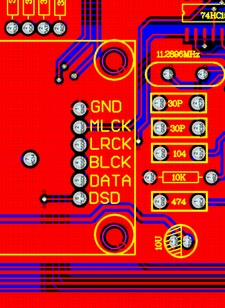

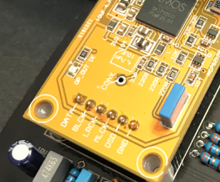

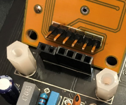

I've connected it as per the earlier diagram rather than vertically (XMOS pins to DAC board pins underneath).

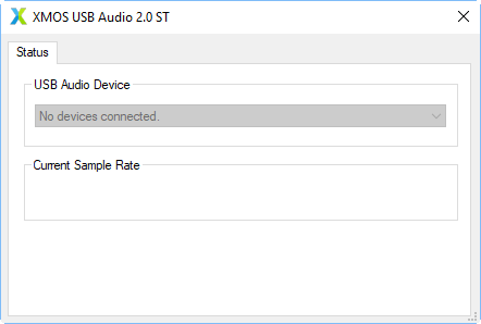

Windows 10 doesn't recognise the card. I assume I need a driver. I didn't receive on with the board. I've done some searching.

They should have advised where you could download the driver.
Hopefully the JLsounds driver recommended by phase will work otherwise contact vendor.
T
Try this U8 driver.
Thanks. This is the first one I downloaded and it works. No output from the DAC board though when wired according to this:
I haven't connected the pin labelled "COAX" yet though. I'll try that next.
If it still doesn't work I'll ignore the previous image try connecting vertically like this:

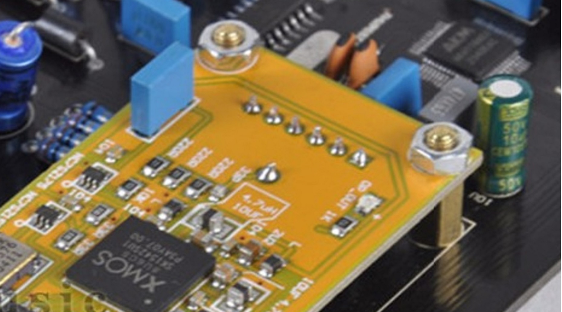

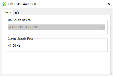

I connected the USB board holes directly to the corresponding DAC board holes.
and played a 44.1kHz track using Foobar 2000. The DAC board display showed the correct sample rate. Success at last!
However, the sample rate display was flickering so I thought I'd connect the central pin labelled "COAX" to the DAC hole directly underneath it as in the picture posted earlier:
665069d1519738722t-chinese-ak4497-dac-dual-chip-decoder-board-4497-5-jpg
The "xCore USB Audio 2.0" device disappeared from the music server and the OP_OUT LED on the USB board was no longer on.
I tried removing the link from the "COAX" pin but it didn't make any difference.
If I unplug the USB board from the DAC board the LED lights again and the "xCore USB Audio 2.0" device reappears on the music server.
I can only guess that linking the COAX pin on the USB card to the pin directly underneath it on the DAC card has caused some damage. Maybe it's just a coincidence that they are aligned.
