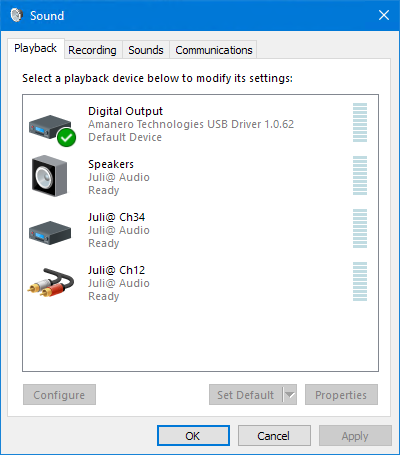

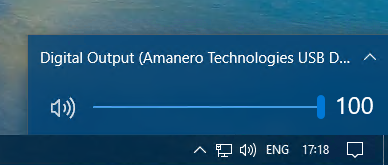

I found a source of 3.3V under the board (on a 10uF capacitor as suggested by the LT1963A datasheet). GND is one of the pins on the connector.
I'm still not getting any sound from the USB input though.
I've selected Digital Output (Amanero Technologies USB Driver 1.0.62) as the playback device in Windows as per the attached images.
I adjusted the Supported Formats tab as shown in the 3rd image. The Test buttons appear to be greyed-out though.

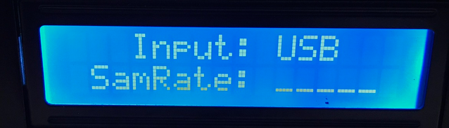

I've selected "USB" using the remote for the board. The "SAMRate" display flickers between "-----" and "DSD"
Any suggestions please? Am I missing something?

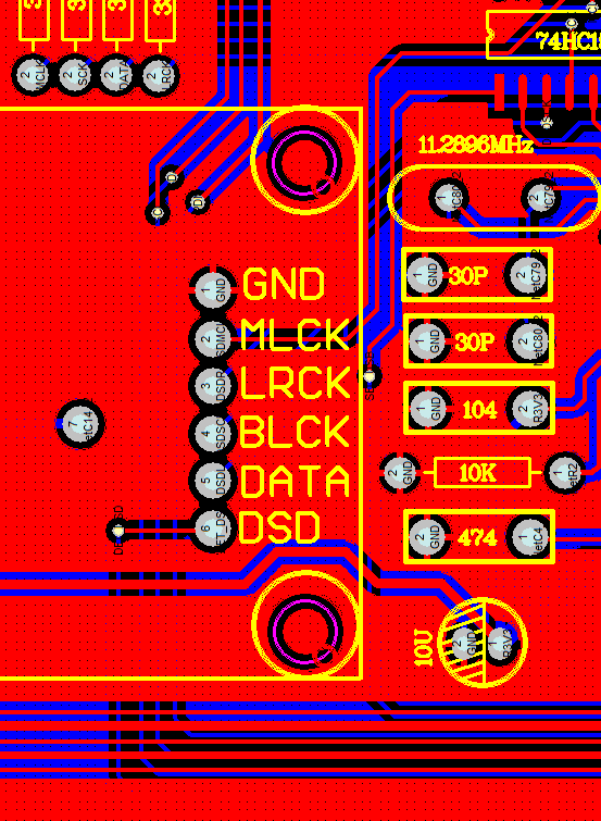

Seller says exactlly
Pls Note: the board is not compatible other version xmos usb card and Amanero usb card, Because I2S pin definition is different, so if you need USB Input, Pls buy the Xmos Version or Upgraded Verion , thanks )

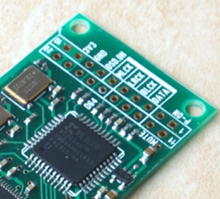

So you must connect all 4 i2s lines, DSD on pin and gnd from Amanero to dac board with max 10cm 6 pin flat wire or maybe even suits if you solder this 6 pins and put it directly into dac board.... I dont see 7 pins as you wrote
From left to right ... gnd DSD on MLCK, LRCK, BLCK and DATA.
Make a photo of your connection.
Do not feed 3,3V for amanero from dac, because it is feeded from 5v usb trought adp151 regulator in front of amanero board. If yes then you must cut output from adp reg.

I reckon your amanero board should go into the rectangular field on the right bottom side of the DAC board, right? There are 5-6 pin holes there ... If this is the case I reckon one or more of these pin holes are GND - if this is so this is where you connect the Amanero board's ground. Not elsewhere ;-) And you have to make sure that the other pins on the DAC & Amanero boards are connected correctly (!)

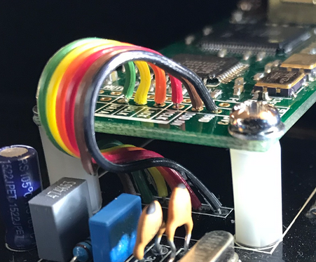

I've aligned the Amanero board directly over the DAC board and made the connections with a 6-pin PCB plug and socket.
I confirmed that the DAC board hole directly under the Amanero pin marked GND is indeed GND on the DAC board.
Am I correct in interpreting androa76's post as saying that the DSD.ON, MLCK, LRCD, BLCK and DATA may not correspond with the holes on the DAC board directly underneath them or is the the I2S somehow different?
I didn't see any seller stipulation regarding the USB card and assumed that I2S was a standard.
Thanks, Dave.

Joined 2007
Hi Dave,
You're welcome ... If you'll allow me a suggestion I would look up for sure which of the pins on the DAC board has which designations. And if they are different from the Amanero (and they may well be) then be welcome to post them here and I shall be pleased to help align them if I can. I'm not entirely sure what androa76 wrote so I cannot comment on that ...
You may also find this useful:
https://www.amanero.com/drivers/combo384-D.pdf
It is a preliminary datasheet for the Amanero board including description of the various pins.
I2S is a standard but the pin placement to my knowledge is not.
Jesper

I finally returned to this project after receiving a new Amanero USB to I2S board. I’ve fitted it in accordance with the AK4497 DAC dual-chip decoder board pinouts as shown below:
as can be seen in this photo:
Still no output from the AK4497 board. The display shows:

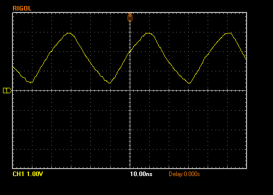

MCLK:
This 25MHz waveform could well be degraded by the 50MHz limit of my oscilloscope.

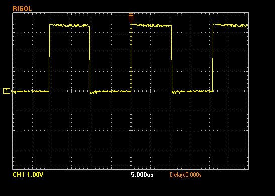

LRCK:
This looks to be 50KHz.

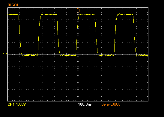

BLCK:
Looks to be 3.3MHz.

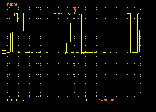

DATA:

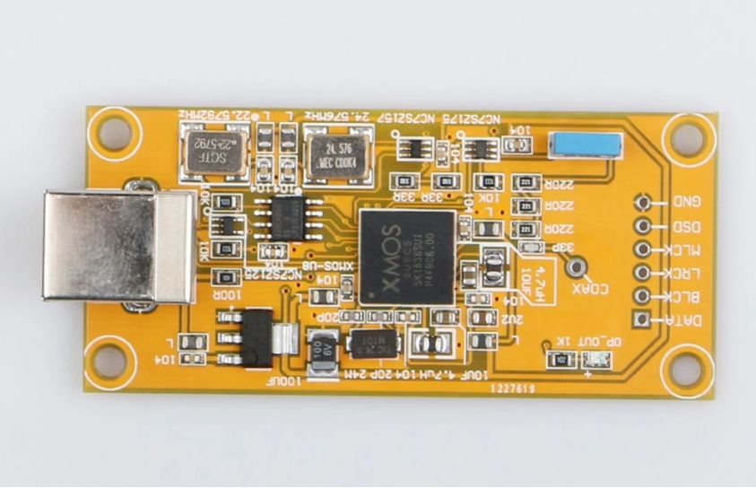

Androa76 said the seller of the board specified “XMOS or upgraded version USB to I2S” (the ad on AliExpress is no longer available) but every XMOS board I can find for sale has the same pinout as the Amanero board that I have.

Hi if i see correctly it is that board for your dac and pins are
DATA, BLCK, LRCK,MLCK,DSD,GND.....you have DSD, DATA,BLCK,LRCK,MCLK,GND try my connection.
Thanks. I tried your connection originally. That's the direct connection of the USB/I2S card holes to the DAC board holes directly underneath them. It didn't work which is what started me off on this debugging process.
