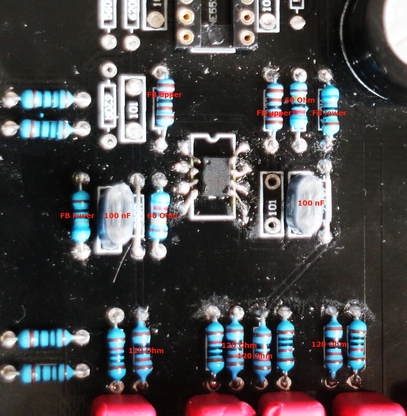

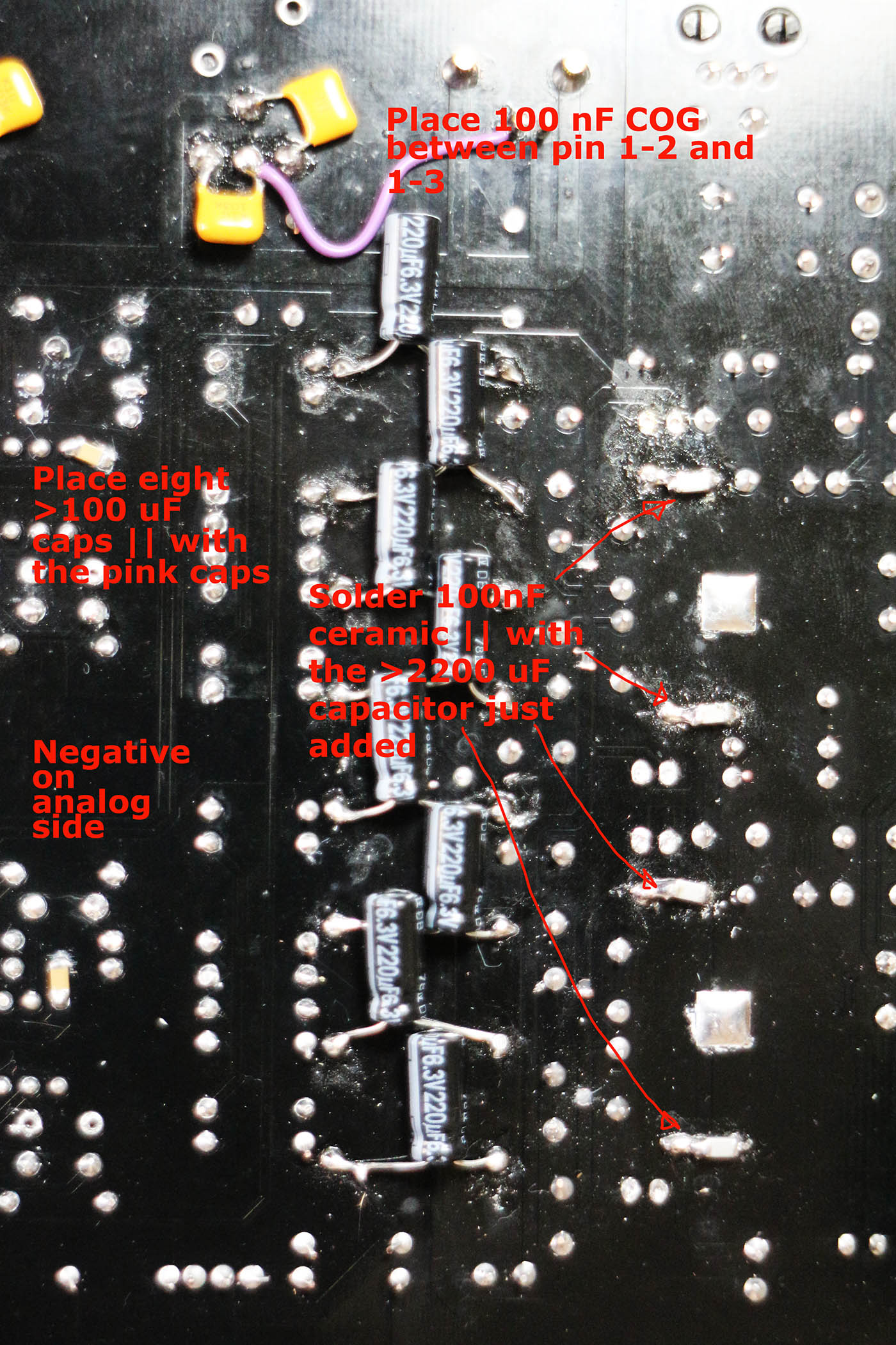

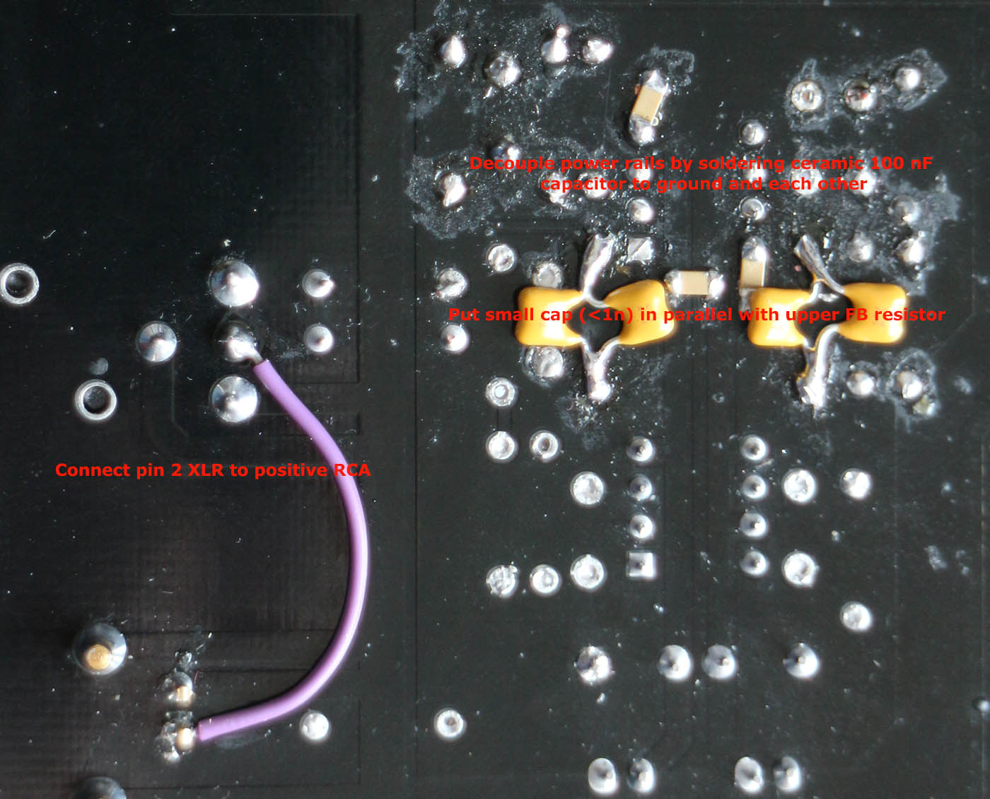

This modification is almost mandatory. The 1 uF coupling cap from the digital section is too small to drive the 10k resistor to ground on the analog side; 3dB point around 15 Hz. AKM recommends 100 uF coupling caps. I used 220 uF because I had them laying around. Adding these makes a large measurable difference and also make the bass sound a lot tighter.
The coupling cap runs into a Sallen-Key connected opamp. AKM recommends a second order low pass filter with f3dB around 180 kHz. The values chosen on the board as it comes deliver a filter with a much higher corner frequency. I calculated the proper values for the SK-filter, but for reasons I don't want to spend time on, this created high DC-offsets. Therefore the solution chosen is to split the second order low pass in two. This here creates the first pole. 120 Ohm drive 10 nF for the required corner frequency.
This mod is equally recommended.
Below the opamp, proper decoupling close to the pins.
Easy to do and every little bit helps.
Hello, i am planning to do the mod done by Vacuphile as well, but as i read the post i have some areas in which i am confused with,
please forgive me if it is something obvious XD (noob at this).
first question is in this picture
, since we replace the film capacitor with the 2200uF caps, what should we fill the empty holes (from previous capacitors) with?
second question is in some of the pictures, such as View attachment 666948
i do not know what FB Upper and Lower means XD
Last question is similar to the first one, in this picture
there are some components removed, and as i read Vacuphile said that the second OP-amp slot will not be used since it will only worsen the audio.
so, i am confused as to what i should fill the empty parts with, since on the bottom PCB view View attachment 666938, all holes are soldered.
Please help me lmao, i am looking forward to modding this board 😛.
Thank You 🙂
Jsano,
It may help to look at the AK4497 datasheet, pages 98
- 100. Those are the AKM recommended circuits. Upper and lower may refer to where the resistors appear on the schematics. Checking the resistor values and or where their traces run on the PCB may help sort out if that is the case.
Dropbox - akd4499-b0-01e.pdf - Simplify your life

Also I am not sure how to get rid of the second opamps pair.
Is it still possible to go unbalanced without them?
