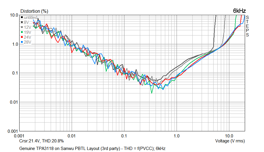

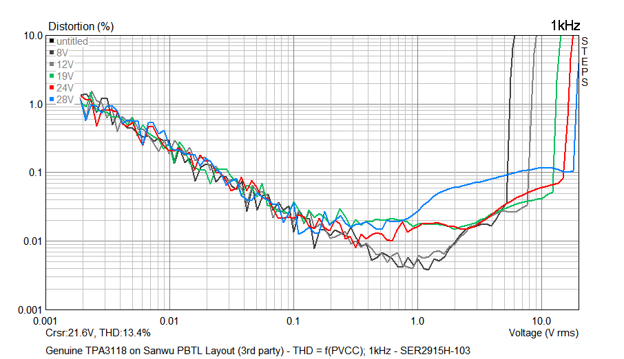

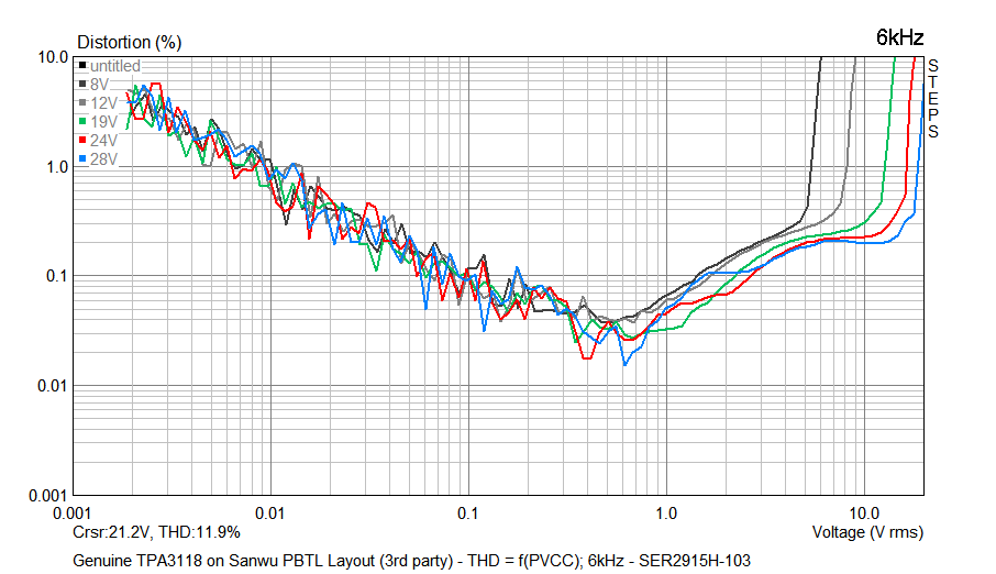

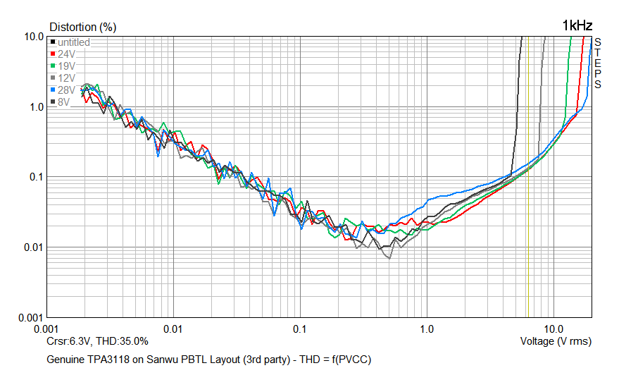

I changed the inductors for Coilcraft SER2915H-103 (10uH), knowing, these inductors wont saturate at all. Measurements where taken into 4R load.
Comparison at 1kHz:
Stock inductors:
SER2915-103H:
Comparison at 6kHz:
Stock inductors:
SER2915-103H:
To me it looks like the stock inductors start to saturate at ~4.5Vrms or 5Wrms or 1.6A. (Seems legit)

OK , we see proof for the assumption/empirical results that the stock inductors are too light as they saturate way below the power the chip can deliver. The one that is replacing it however is not a suitable replacement with regards to its size. I think it is better to avoid flying lead wires so a higher rated inductor that fits on the original pads of the board would be optimal.
Did you see the one that I linked to ? Or the Würth WE-PD irribeo linked to ? The Würth seems to saturate at thrice the current of the original inductors.
