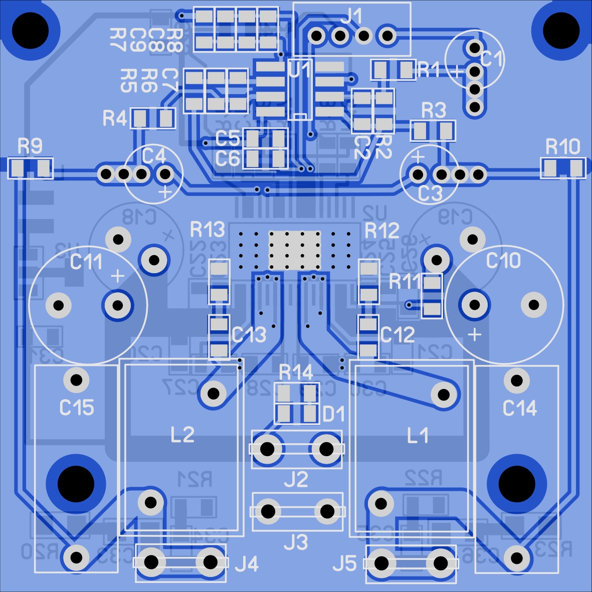

This next tpa3128/18 pcb would be around $28 BOM (Mouser) per mono pcb, Nichicon ES bipolar on input, Wima film adds around $5.
This one with opamp phase splitter and post filter feedback as tpa3251evm. Opamp phasesplitter is a benefit for single ended sources, even without the feedback that might not work with tpa3128 properly. Opamps can be noisy if layout is bad, so here it might be terrible 🙂 IceComponent 1D14 inductors. 50mmx50mm and two standoff mounting holes below polyprop outputcapacitors, so mounting sequence would be important 🙂

Nice board but tell me ho the mounting sequence should be as I think it is impossible to mount those screws 🙂 When you screw the screws in standoffs the caps will be soldered in not flush with the PCB. If you mount the board to the chassis and one of the standoffs comes loose it will be hard to correct.
Nice to design ultra small boards for the chinese sellers but for normal users the 1 Euro difference and the possibility to use normal parts and to be able to mount the boards normally are preferred I would think.

A banana connection block for PCB mounting would solve the screw item but I can not find them anymore. Then the board would be mounted with the connector block to the back cover.
First mount standoffs, then 15mm filmcapacitor, which doesn't have a flat bottom, epoxy is "hollow", small screwhead will fit, but needs a drop of glue too, or changing standoffs would be tricky 😀

Board can be as is but just some more PCB material at all sides for the mounting holes. Brings possibility for pads for a heavy duty screw connector too. More distance between spade connectors and coils so that you can put those amp connectors on more easy. Pads for a DC protection speaker circuit and relay 🙂
