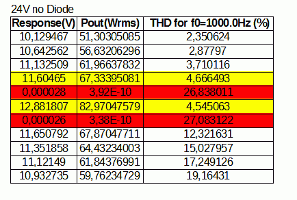

My conclusion is the best supply voltage is 24v.
The input power diode should be removed bypassed. It is for diy mistakes.
The output filter is not so critical as I thought.
The generic board layout is perfect or some miracle component behavior not yet understood.
I can rate for 30-35 Watts hi-fi, plenty of ommph headroom before clip.

Did protection trip at 90W 2R 24V ??
Can't say exactly, something happened in the 80W region before the supply foldback.
Most likely yes. I only plotted up to the first yellow line.
90W into 2R are 6.7Apk, pretty close to 7.5A trip point from datasheet. My supply only can put out 5A continously (lab-supply). Integration time was 100ms.
