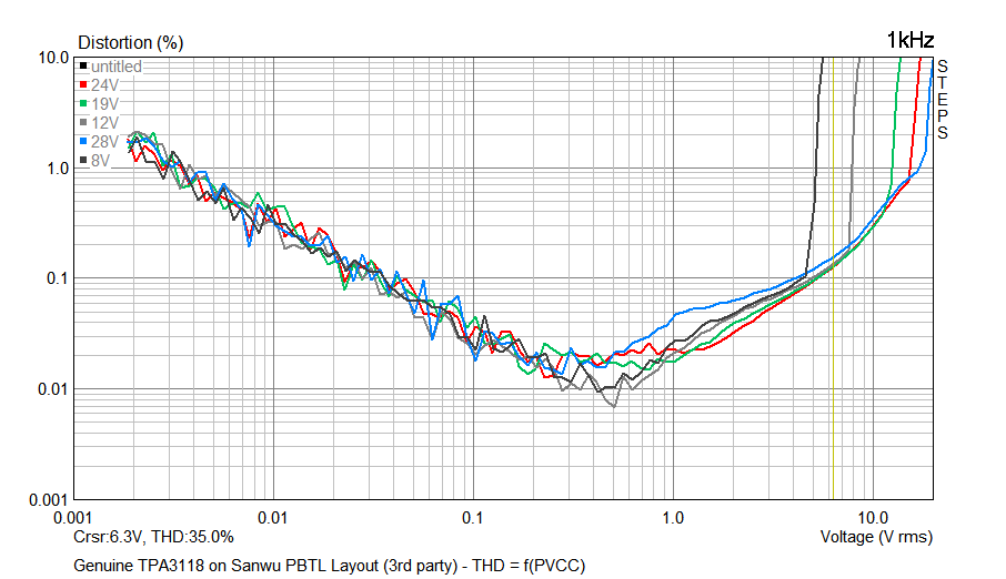

Just changed the IC.
At 1kHz:

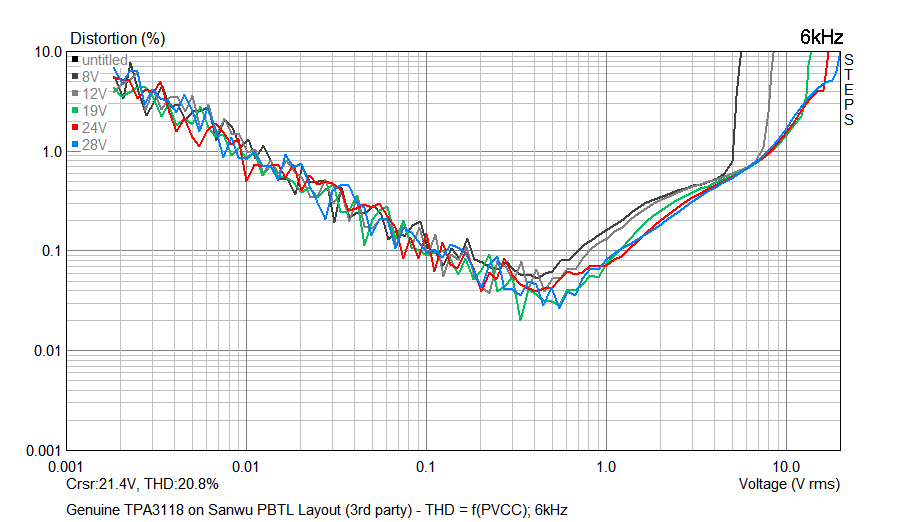

At 6kHz:

From the results, at 12V is "might" sound warmer, due to more K2.. :Present: But this is measured into resistive load.

That's 14.1Vrms - from the plot at 6kHz ~4% THD then.

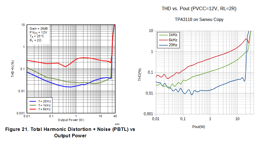

Take a look, 0.1% is 1/1000th, adjust your scale. PBTL has slightly higher distortion than BTL.
And? The measurement is more worse anyway.
The board is PBTL so i compare with PBTL figure. 2R will have more distortion than 4R. But even so, the EVM is "better" at 2R. To me, the measurement is not quite close to EVM.

TI BTL graph 4 ohm fig 7 shows higher distortion than PBTL 2 ohm fig 21, TI support mentioned with same load BTL has slightly lower distortion than PBTL. Difference graphs is more overdamped filter.

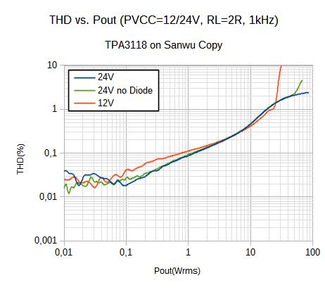

Bridging the diode didn't made any relevant difference. Test at 24V is limited by power supply. (24V 5A)
attachment.php
From datasheet, at12V and 2R -> 33W (1% THD) should be possible, we got 25W, okay.
NOTE: The "24V nodiode" plot is done with higher integration time, as the "24V" plot is a bit suspicious at higher power levels.
32dB, filtervalues, unequal much weaker inductors
Layout I now suspect to be superior even to EVM, I never thought that was really possible 🙂
Yeah, inductors are having the biggest influence, they're pretty much undersized. (At 12V and 25W into 2R it's "okay).
