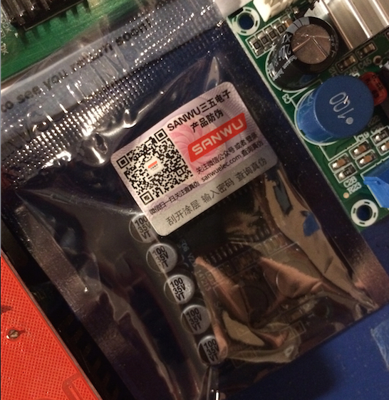

Some clarification: No laws broken, US or Mainland
If the item was advertised as Sanwu , and you purchased it from the mainland it will be genuine. A cert of origin is shown in pic.
If you buy directly from YJ a similar receipt is received.
If it was advertised as 'Generic Brand' then who knows. Its an evaluation piece and should never be sold or transferred without disclosure- much less be used in a final product.
If the generic 'blank' has a similar look, form factor and dimensions then still no law broken.
All of the generic brands may or may not have genuine TI dies. Even if markings and package out of spec, the wafer or chip-scale may have been legally transferred.
Assembly methods, overall quality of the generics is lower as can be seen from a visual inspection.
My generics meet all of the TPA specs I can measure. They could be seconds, over-runs or PolyPacks. don't know.
There are other possibilities but on the surface no obvious legal issue. You should get advice from someone more knowledgable than me.
I buy the blanks for hobby entertainment only.

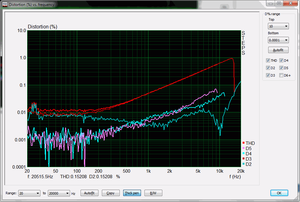

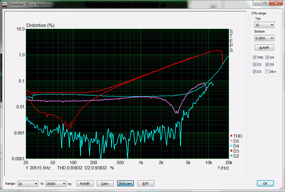

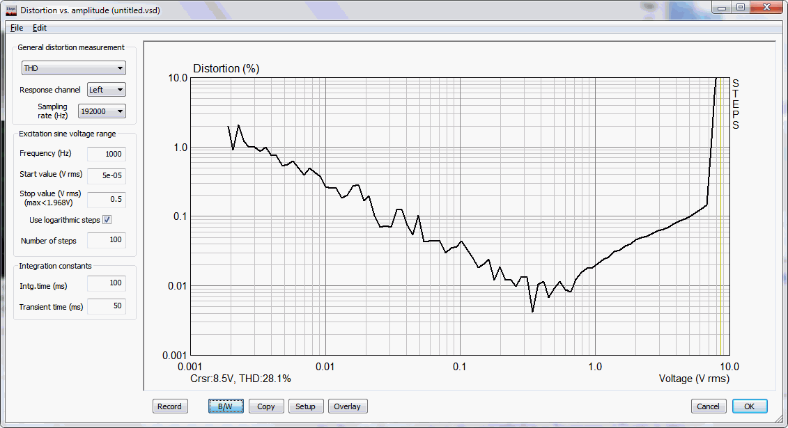

Measured one of the "generic" (Sanwu clone) PBTL boards with an original TI TPA3118 soldered in place.
PVCC=12V
Gain: 20dB
Load: 4R
attachment.php
1W:
attachment.php
10W:
attachment.php
Very close to EVM board. Too close for the +30% inductor difference I found I think, you replaced them too ?
