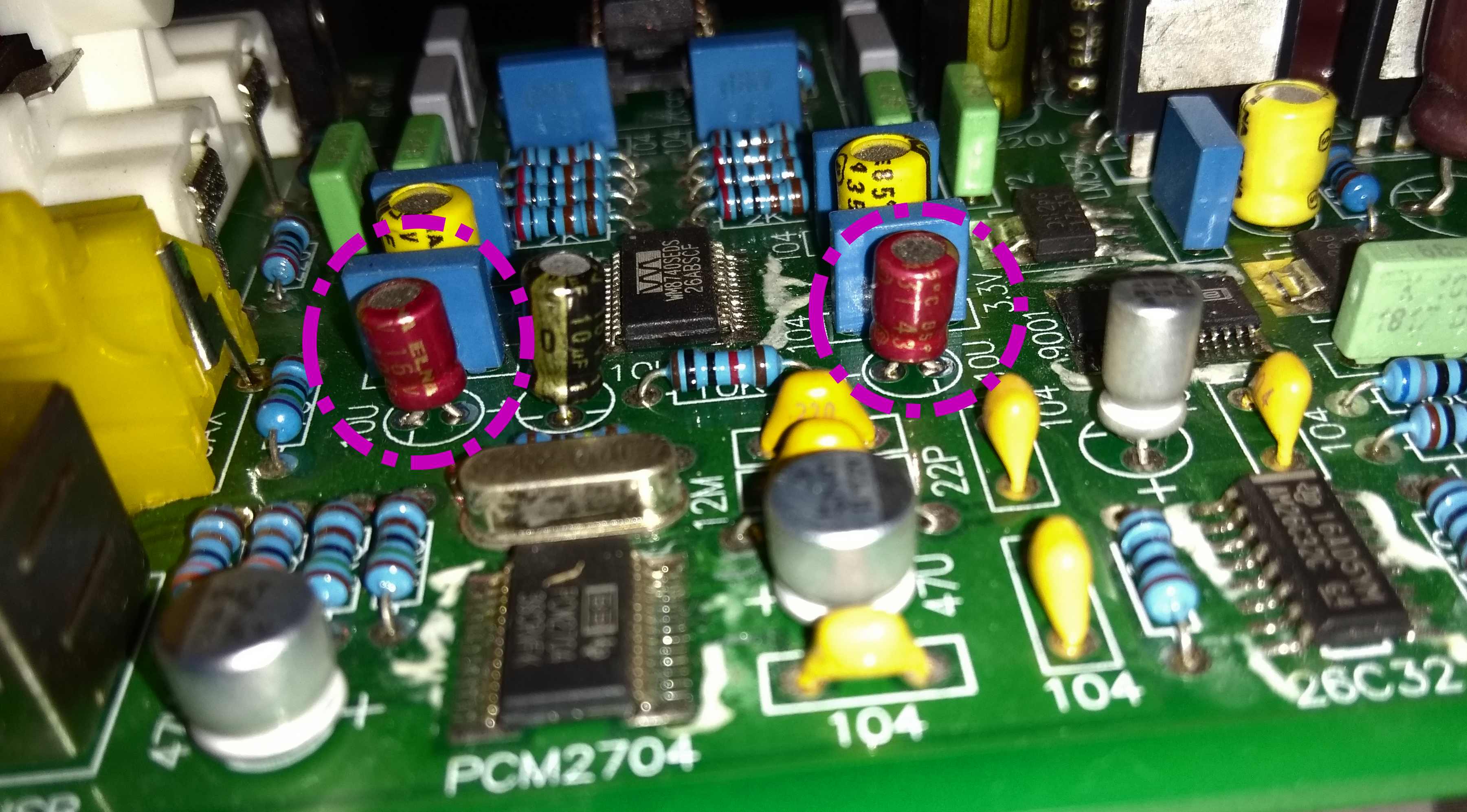

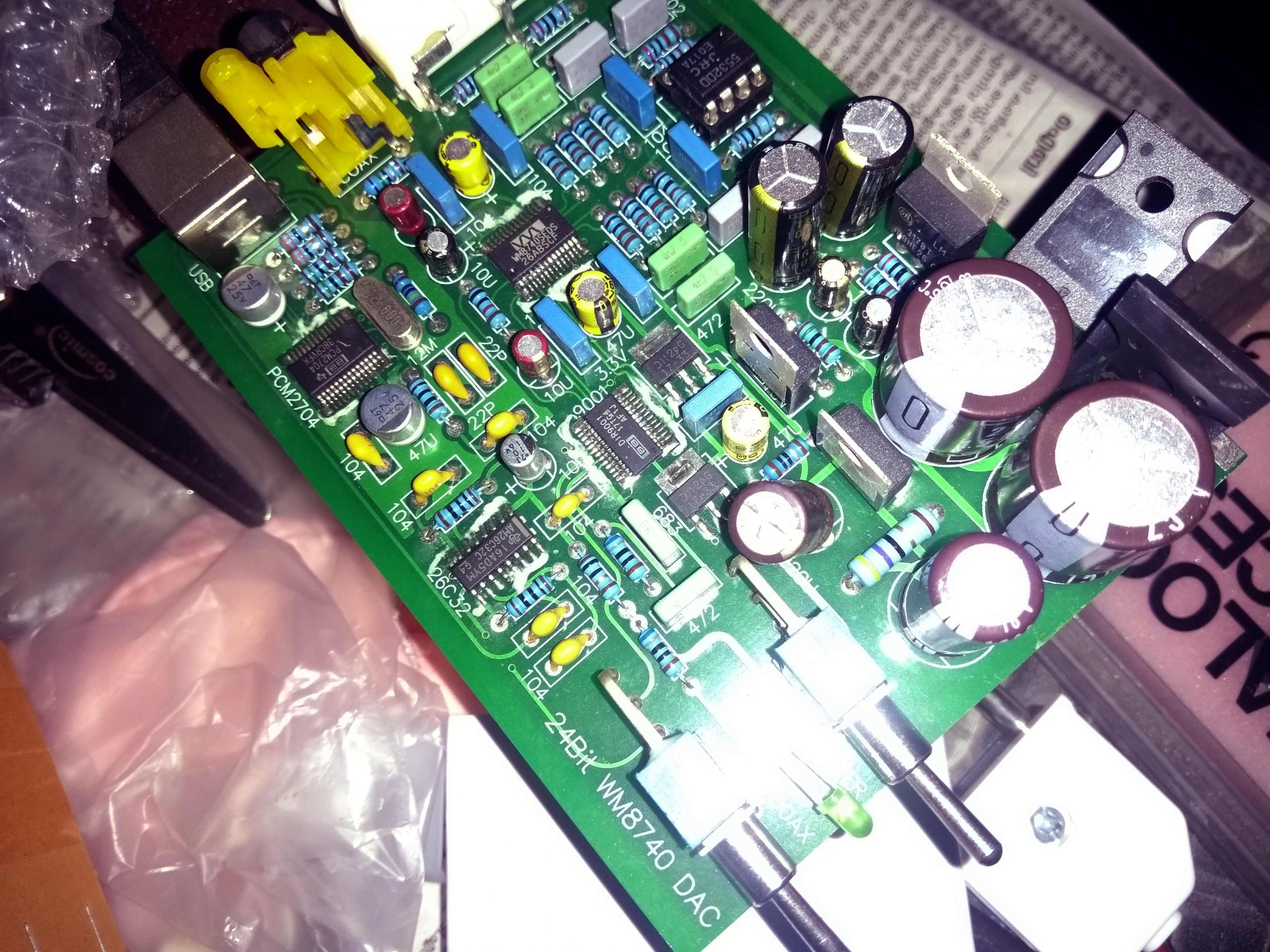

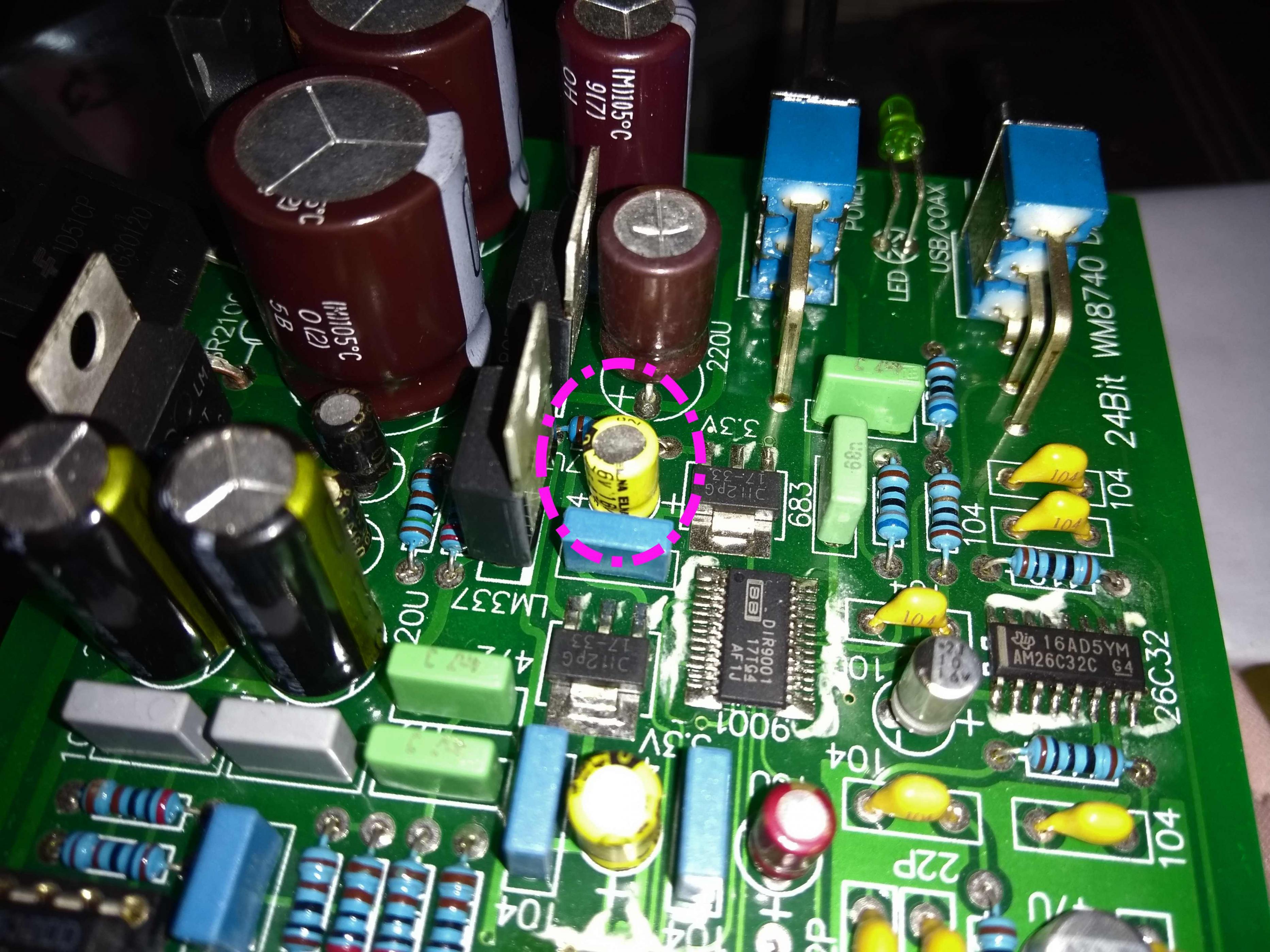

I have bought all replacement caps (ELNA SILMIC II) except for those mentioned above..... those small yellow caps are Elna Silmic 47uF 16V, the red ones - also Elna Silmic 10uF 16V, the long pair of caps on the right side of power supply caps - Chemicon KZJ 1000uF 16V, power supply caps - Chemicon LXV 1500uF 25V, the single cap just ahead of the power supply caps - Chemicon KZG 1500uF 16V, the cap closer to the SPDIF selection switch - Elna 330uF 10V (but silkscreen saying 220uF)...
Now, should I replace those too ?
I tried to see if the ELNA branded caps (shown in the pics) are genuine. The data sheet on the ELNA site mentions only blue, brown and silver caps. There are no yellow and red. But, in some other sites, there are mentions of yellow colored 'cerafine' caps and the ebay is full of the red coloured 'cerafines' like the ones on my DAC PCB.
I just don't know if its real or not !
If I get an opinion of you guys, it would be awesome as I can order new caps and replace them when I'm free. Any help would be greatly appreciated !

Here are the caps mentioned in that quoted message
Don’t get hung up on the audio caps thing, I mentioned it, or someone did, as that’s an easy way to find decent caps for the analog portions of your dac.
The Panasonic fm are great, just make sure and get the lower voltage versions and/or make note of the esr that they have so you don’t lessen the potential of the regulators to do their job. Different parts for different functions.
For the few dollars it would take to replace those yellow and red caps, it’s going to be worth just knowing they aren’t fake. Either those ka or Silmics.
