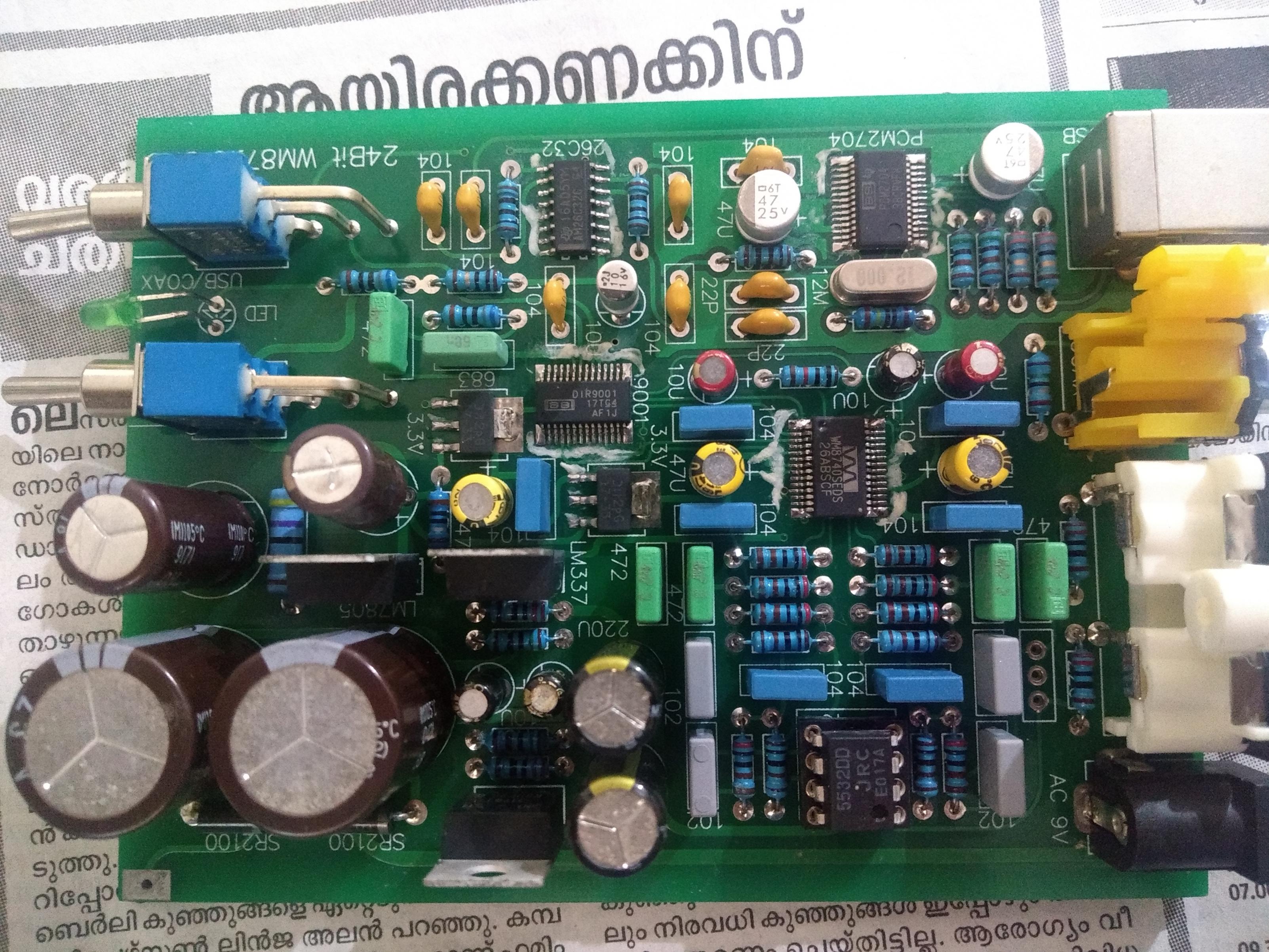

Sure, I'll get two clamp on Ferrites. BTW, the caps on the DAC board now is not that bad though. Many of them are 105C. Regarding the brand, there are Elna, Chemicon KZG and some others.

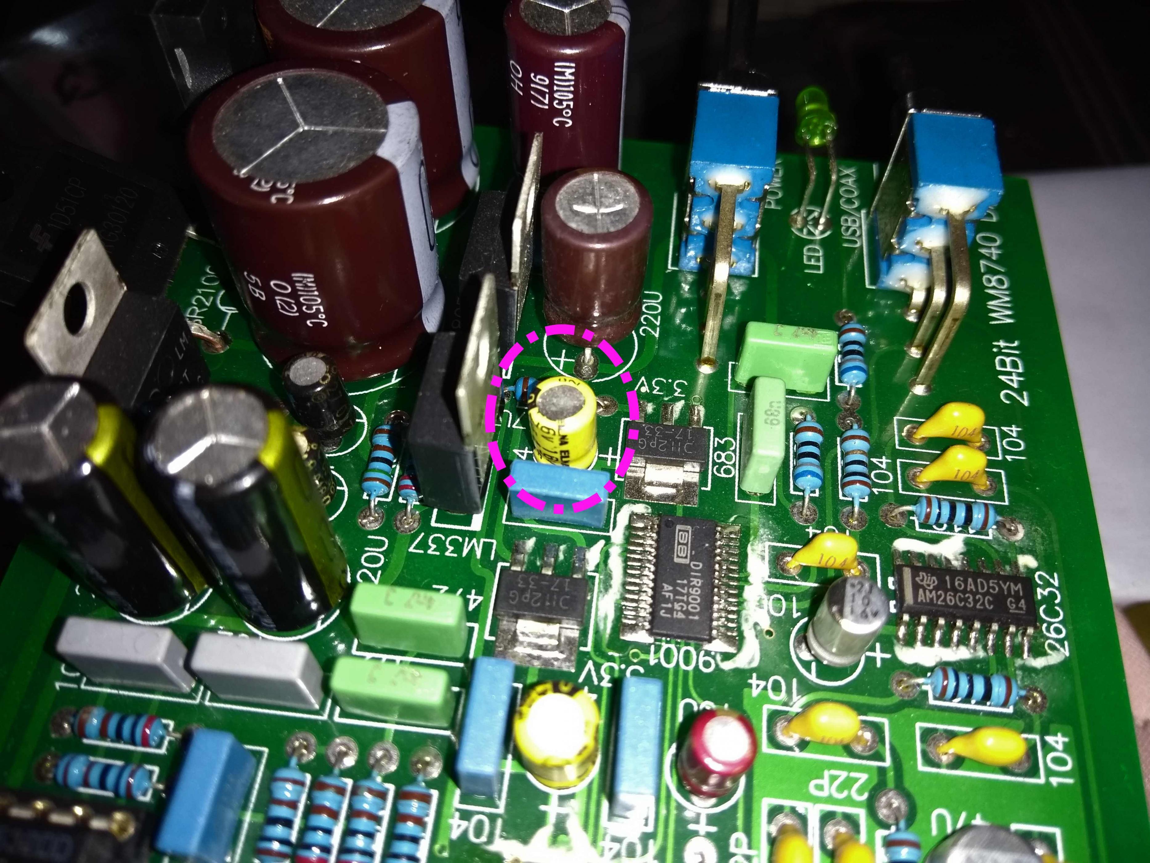

I just checked the WM8740 data sheet and they recommend placing some of the capacitors (refer page 24) as close to the DAC but in the actual DAC board, is it close ? Shall I do something about it ? https://statics.cirrus.com/pubs/proDatasheet/WM8740_v4.4.pdf

Those electrolytic parts on your board were likely purchased as surplus from a switching power supply production, are great parts for that, but I think you’d be surprised at what a better, low noise set of parts can do. The esr tends to be lower on those other parts also, and that can hurt the sound, in a non-optimized layout, or by resonating with the smaller caps, as Abroxolito mentioned already.
The heat rating isn’t going to translate into a more desirable sounding dac on its own.
Again, I would leave the ones just after the diodes, and focus on the ones right after the regulators, closer to the devices.
At this point, to not damage the dac chip should be your largest concern, I wouldn’t attempt to relocate any of the capacitors. That was mentioned in the data sheet because there are some ridiculous attempts where no decoupling occurs, or very long distances, and they are just pointing out the obvious in the data sheet to try and prevent that. You could place a small, smd.1uf ceramic part between the capacitor leads on the one that is connected to pin 8 on the wm8740.
You’re better off to try and do the simple mods using the best, reasonably priced parts you can find and enjoy it. Some further, simple, low cost power supply improvements can really help too.

The caps I bought are mainly Elna Silmic 2. I'm hoping it would not cause any resonance.
I cannot seem to find the Nichicon KZ caps. There are UKZ and some other types "for SMPS" caps. SO, I haven't bought any Nichicons !
By the way those small yellow caps are Elna Silmic 47uF 16V, the red ones - also Elna Silmic 10uF 16V, the long pair of caps on the right side of power supply caps - Chemicon KZJ 1000uF 16V, power supply caps - Chemicon LXV 1500uF 25V, the single cap just ahead of the power supply caps - Chemicon KZG 1500uF 16V, the cap closer to the SPDIF selection switch - Elna 330uF 10V (but silkscreen saying 220uF) etc.

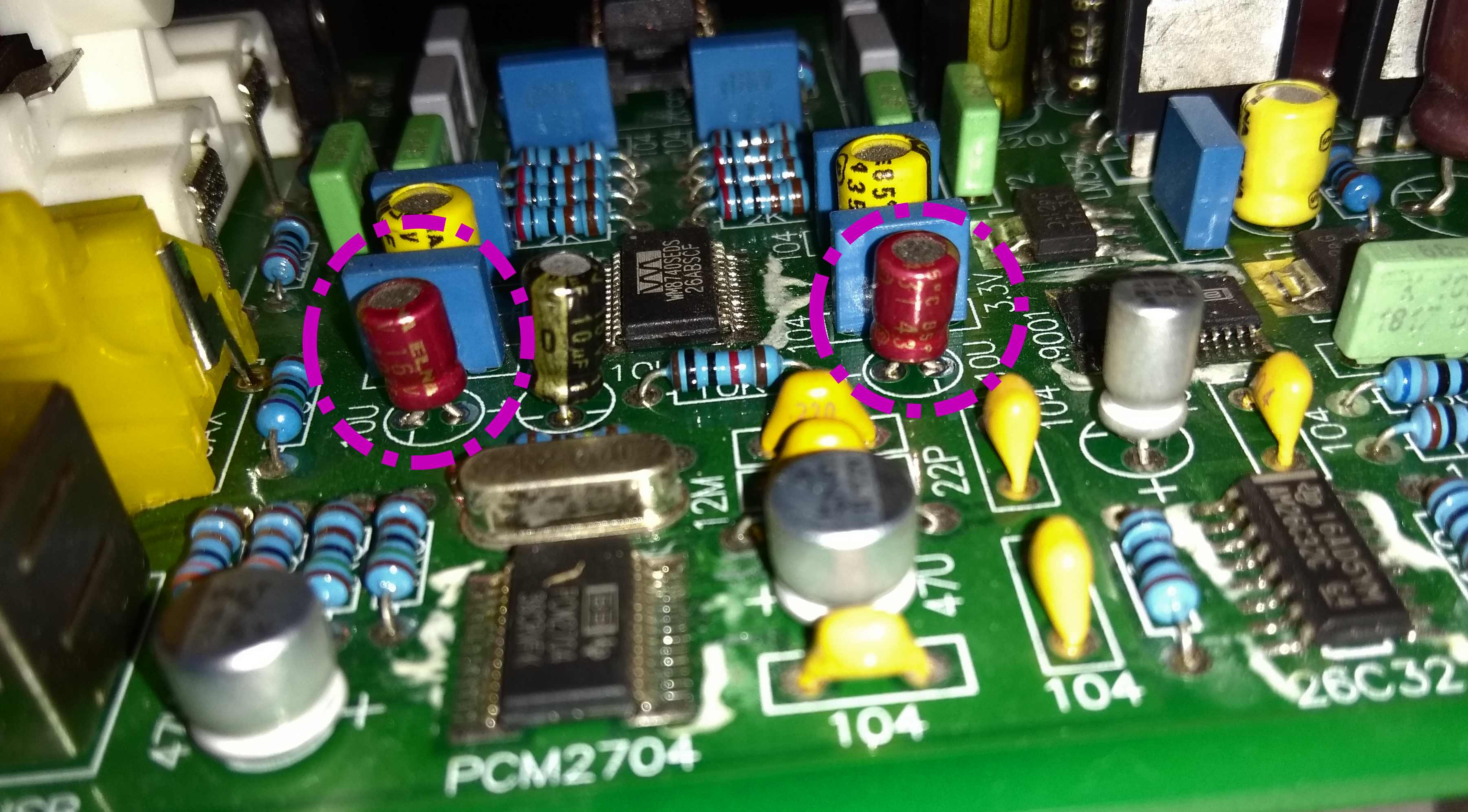

Do any of the red or yellow Silmic parts have a three letter name like rfs or ars at all?
Haven’t seen any red or yellow silmics...
Ok, 10mm diameter is a bit large, I was trying to save you some shipping thinking those would be available in a lower voltage, and work from mouser, sorry about that.
This is what I use along with some Silmic parts that I know are genuine.

Phase, have you checked the photos I attached ?
Is it a fake ?

I can’t say one way of the other if those are real or fake.
You could take one out and see if the leads are magnetic, the Silmic have copper leads, or at least they are supposed to.
Or for the relatively low cost, just replace them.
