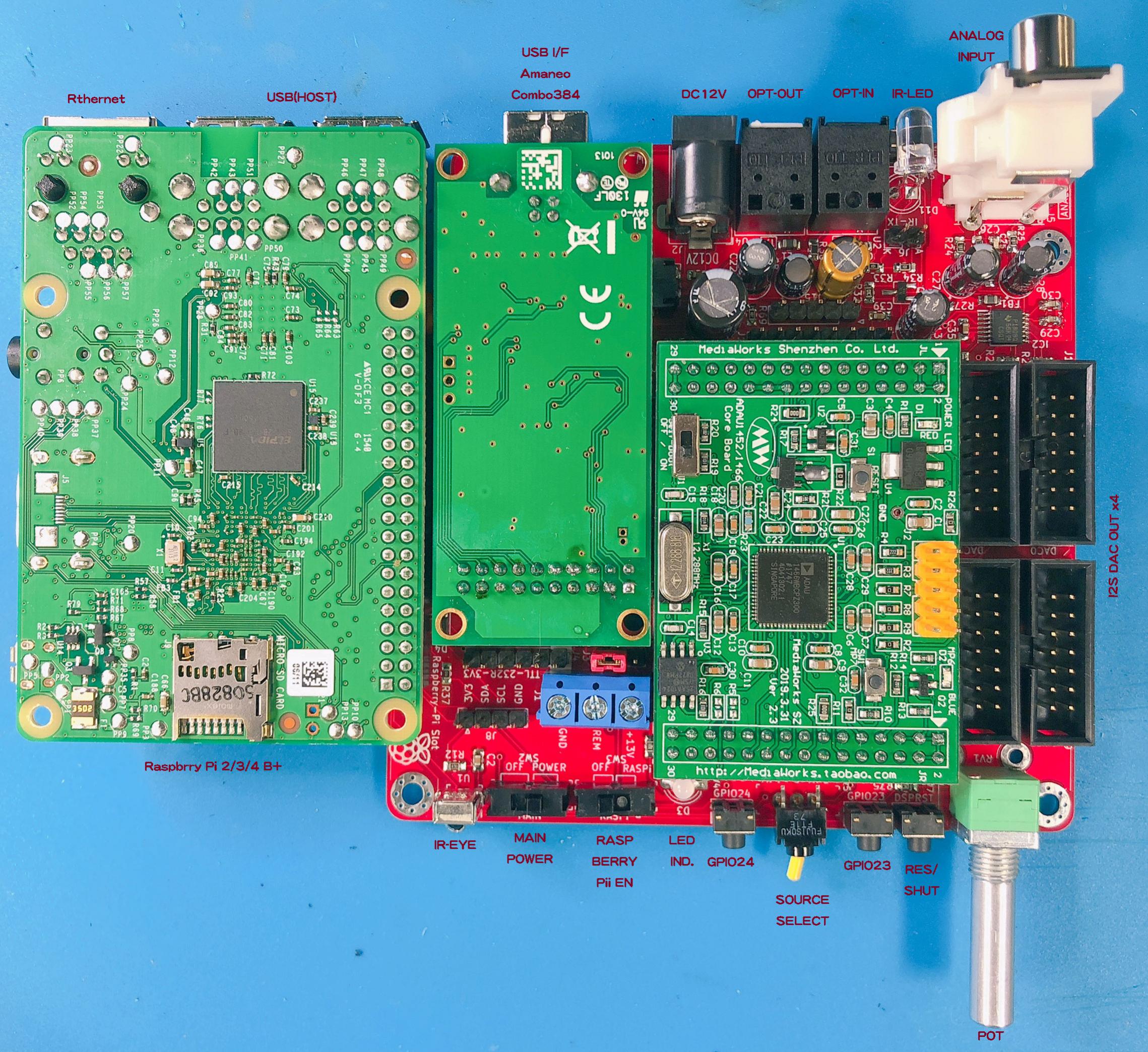

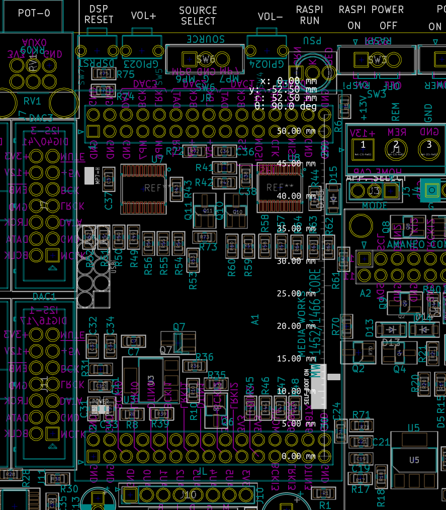

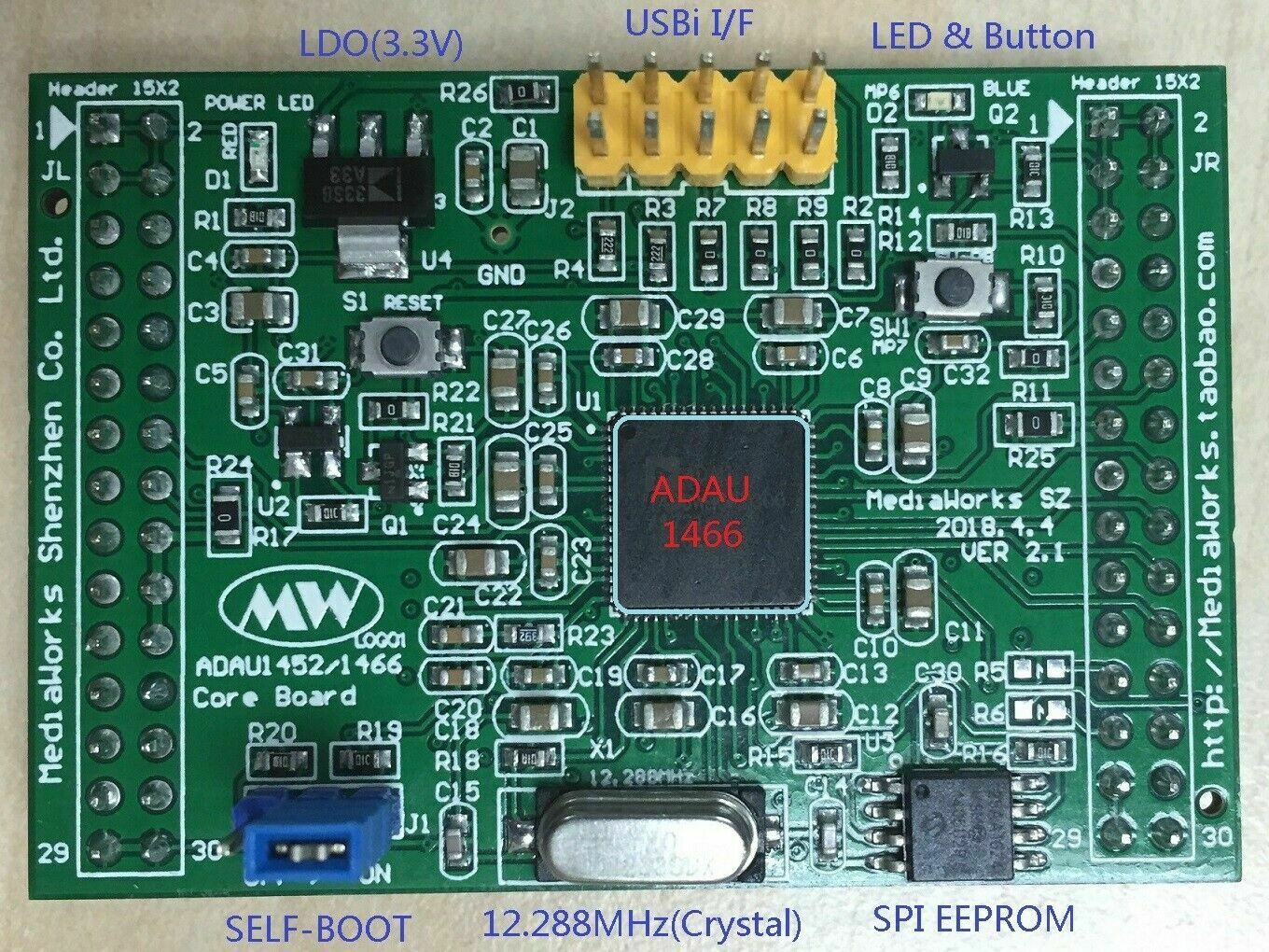

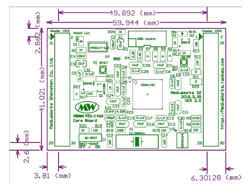

Received my ADAU1466 board today, the transistor is flipped over also. Must be correct so, wrong PCB footprint used during board design.
I'm a little bit overwhelmed by the plus on options compared to a ADAU1701 in SigmaStudio 😉

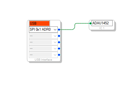

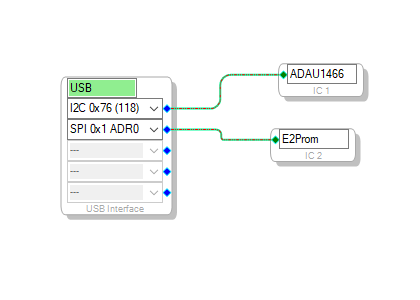

OK, I got connected to my ADAU1766 board, and SPDIF receiver is working 🙂
If one is using the Wondom/Sure programmer, the connection settings are like shown in the attached pic (EEPROM is SPI, not sure the address is correct).

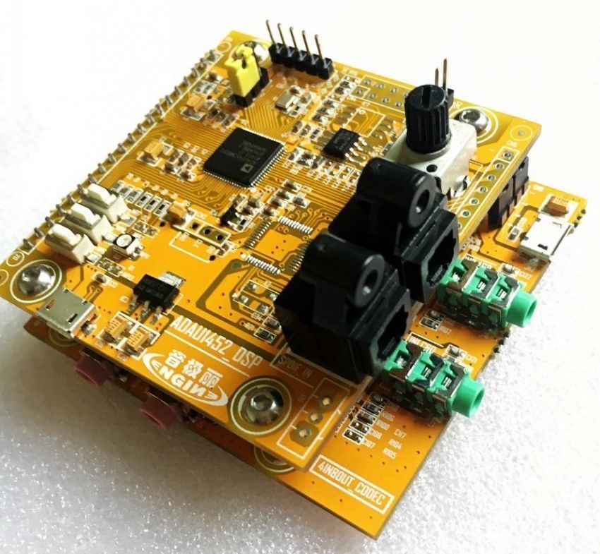

It would seem that eBay have 2 types of 1452 Board – the green one and the yellow one. If I wanted to incorporate it into a BALANCED (XLR), which one would you suggest??
Hi Markw4
Thanks for the reply.
No I did not mean to put the chip in the XLR. I just wanted to state that my entire system is balanced using XLR. As most people have single ended and use RCA.
I also forgot to attach the photos of the boards.
It will be a fun and steep learning curve.
D
Edit – My apologies. I re-read the entire thread and the Green Board is the go with a Tindie SingmaLink USBi.
As I am a total novice, any other ready-made boards, connectors that are available?
Thank you
D

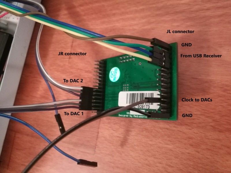

Hooking up ADAU1452 to USB receiver and two AK4490 DACs
Hi guys, just wanted to revive the thread a bit.
I got my ADAU1452 board working in SPI mode, I couldn't get it to run in I2C mode, but maybe I just messed up something. Anyway, it's working fine over SPI 0x1 Adr0, still didn't try the EEPROM.
At first when I connected my USB receiver (diyinhk isolated 768khz) I wasn't getting the I2S signal, and there seemed to be some kind of voltage over the GND pin because the DSP board LED wouldn't turn off all the way when I shut it down in SigmaStudio. At some point I disconnected the GND pin and it all started working, even with the GND pin back on. Weird, might have been some kind of ground loop or something.
Now to share some insight for those who encounter these problems: I have a USB receiver with it's own clock, and two AK4490 DACs that can't work without a master clock (MCLK) provided externally. I connected the I2S signal from the receiver and the two DACs like you can see in the photo, also note the JL pin 24 (ADAU clock out) and GND pin go to both DACs. That's not all, I had to go to ADAU1452 Register Controls tab in SigmaStudio, then Serial Ports tab and change the SDATA_IN0 settings: LRCLK Source and BCLK Source to "Slave from CLK domain 0", and then I got the signal through.
Also the first DAC is on channels 0 and 1, but I found the second one is on 16 and 17, because each bus (group) on the ADAU1452 has 16 channels (starting from 0).
This was some trial and error because I couldn't find a lot of info about I2S signal in the ADAU documentation. Will do some more investigating on different ways to use the clock, as I want to use the Ian's McFIFO both for reclocking the signal from USB receiver to DSP and from DSP to the two DACs.
On a sidenote, I'm controlling the DACs with an Arduino loaded with modified code that DimDim wrote.
This is going to be the digital crossover/EQ for my LX mini setup 🙂

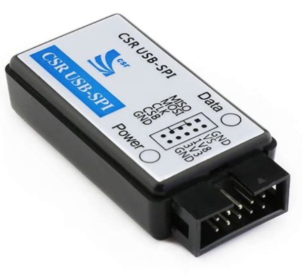

Hi All,
I cannot get Sigma Studios to recognize my ADAU1452 using a CSR USB to SPI converter with the Analog Devices drivers installed on it.
Does the ADAU1452 require the use of the EVAL-ADUSB2EBUZ to program? or will any USB -> SPI converter work? Is there something special about the Analog Devices converter that I am missing?
Any help would be great!
