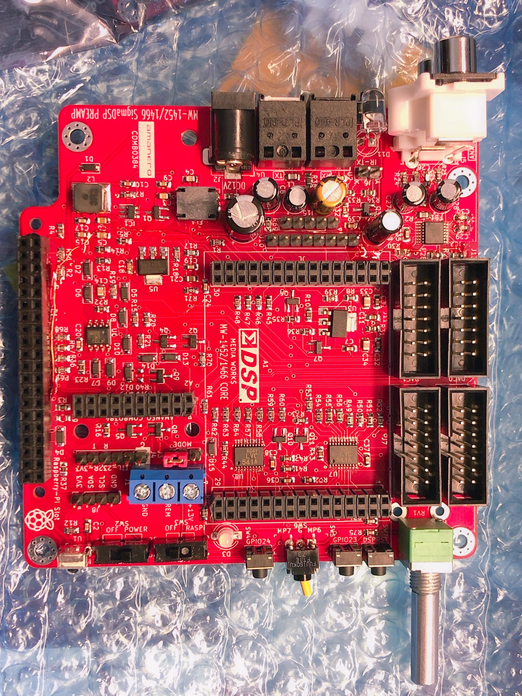

Now I will upload my MW-ADAU1666/1452 breakout board design information for this thread readers. This board has Pre-Amplifire like features as follows...
  • A DSP slot for MusicWorks MW-ADAU1466/1452 module
  • Single DC12V power supply and embedded On-board power supply for all embedded Boards and Circuits
  • Amaneo Combo384 Slot for USB-Audio Input
  • MP6/MP7 GPIO Header for source selection.
  • Header for AUX ADC
  • Raspberry-Pi 40pin I2S Connection Slot
  • Raspberry-Pi 40pin SPI interface for SigmaStudio's SPI over TCP/IP Connection. (TCPi)
  • Auto delay Turn-On and Auto shutdown support power supply for Raspberry-Pi Automotive Application (RP4 Compatible)
  • IR-Remote sensor for Raspberry-Pi
  • IR-Transmitter LED for Raspberry-Pi
  • 2 push buttons for Raspberry-Pi
  • Breakout Header for Raspberry-Pi I2C
  • Breakout Header for Raspberry-Pi UART
  • Raspberry-Pi disable switch with keep hold-on features.
  • 96kHz ADC for Analog Input
  • Optical S/PDIF Input
  • Optical S/PDIF Output
  • Rotary Pot for AUX ADC
  • 4times Buffered I2S Outputs

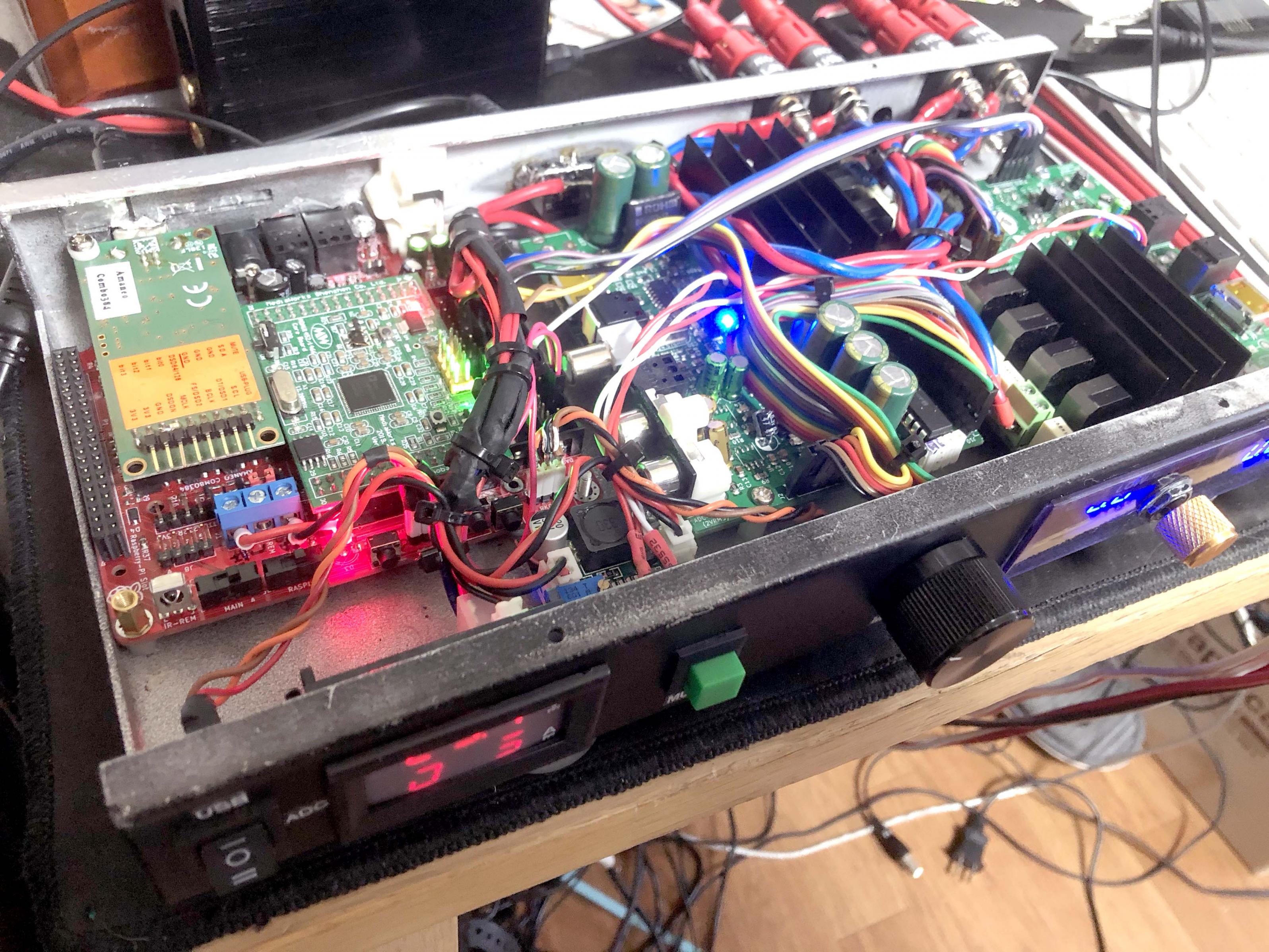

The First picture is initial version board.
Second one is an application example. Its my full-digital connected TAS6422 4ch Amplifier.
Enjoy!

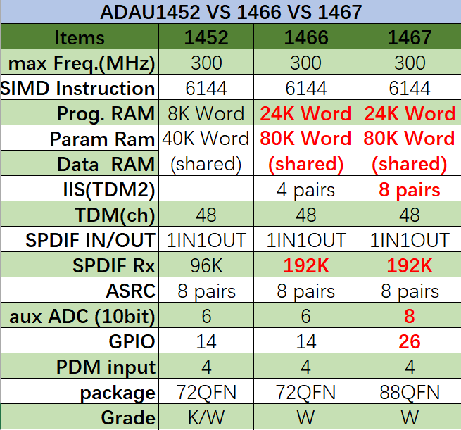

I'm thinking of getting an ADAU1452 board like this one Lusya ADAU1452_DSP Development Board Learning Moudle DSP Board With CODEC F9 006|Replacement Parts & Accessories| - AliExpress, with the codec board. I want to feed the board with a 192KHz SPDIF signal
What I'm confused about, is that in other Aliexpress listings like this one SIGMADSP ADAU1452 / ADAU1466 core board (new)|Personal Care Appliance Parts| - AliExpress they have a table that says that the ADAU1452 only has a 96KHz SPDIF input, see attachment
The ADAU1452 datasheet mentions a half-clock speed version of the ADAU1452, but the only difference mentioned by the datasheet between the 1466 and 1452 is the memory size
Can someone with the ADAU1452 board with codecs please confirm that their ADAU1452 runs at 294.912 MHz (put it another way, it has to be version ADAU1462WBCPZ300, not ADAU1462WBCPZ150

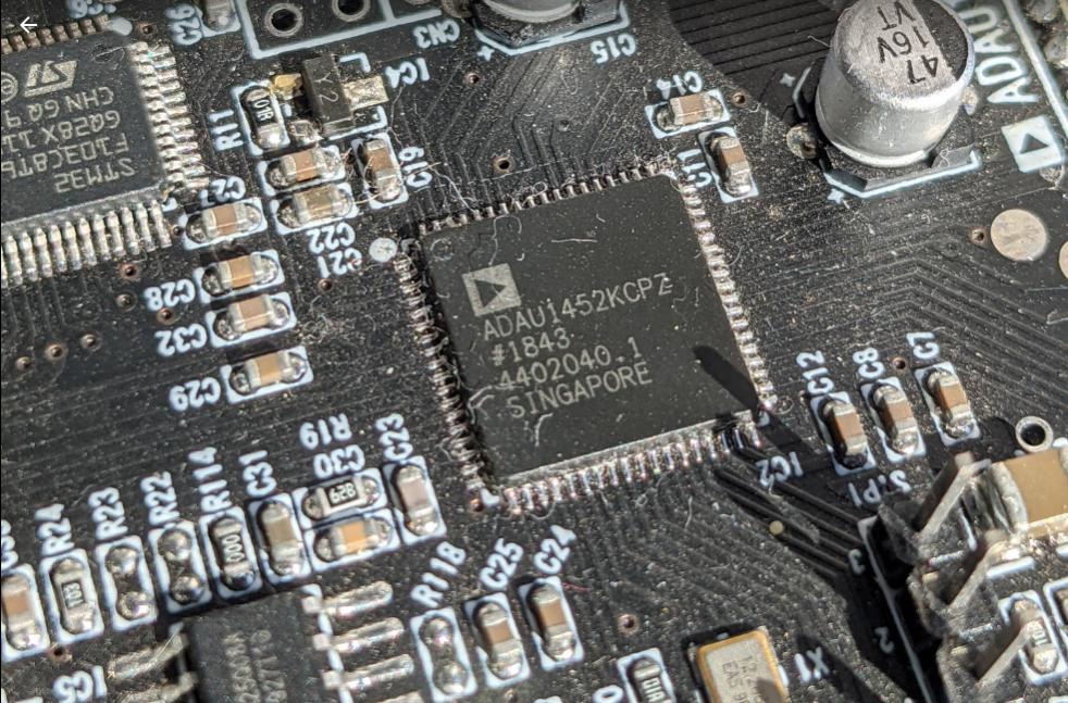

If you tell me where to look, I can check my Lusya ADAU1452 board with SPDIF input.

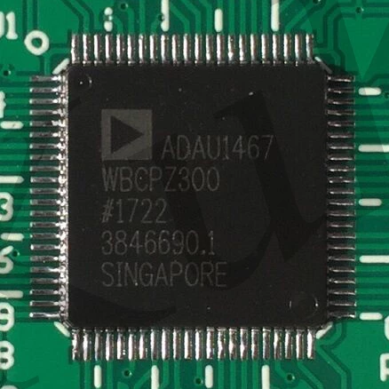

Thanks! It should be in the device markings. Here's a picture I found of an ADAU1467 with the full markings WBCPZ300.
If you could take a picture of the ADAU1452 in good light, I should be able to figure out if the markings provide the necessary info (or ask the Analog forum)
In reading this post ADAU1462-150 PLL and other settings - Q&A - SigmaDSP Processors and SigmaStudio Development Tool - EngineerZone and the datasheet, especially "Table 28. Optimal Predivider and Feedback Divider Settings for Varying Input MCLK Frequencies", it looks as if the 300 and 150 versions use the same settings, which are handled transparently by Sigmastudio and the chip, so it looks as if there is no way to tell from the Sigmastudio info what chip is being used
I asked the Analog forums (How do I recognize an ADAU1452-150? - Q&A - SigmaDSP Processors and SigmaStudio Development Tool - EngineerZone) and I learned two things:
  • The chip marked ADAU1452WBCPZ is the 300MHz part. the 150MHz version would be marked ADAU1452WBCPZ150
  • The 1452 is only certified to work with 96KHz S/PDIF, and does not support 192KHz S/PDIF. The supported way to have 192KHz S/PDIF is either to use a S/PDIF to I2S converter or use the ADAU1462, which is pin and software compatible and works up to 192KHz
Has anyone here ever successfully used 192KHz S/PDIF in on the ADAU1542 board discussed here?
