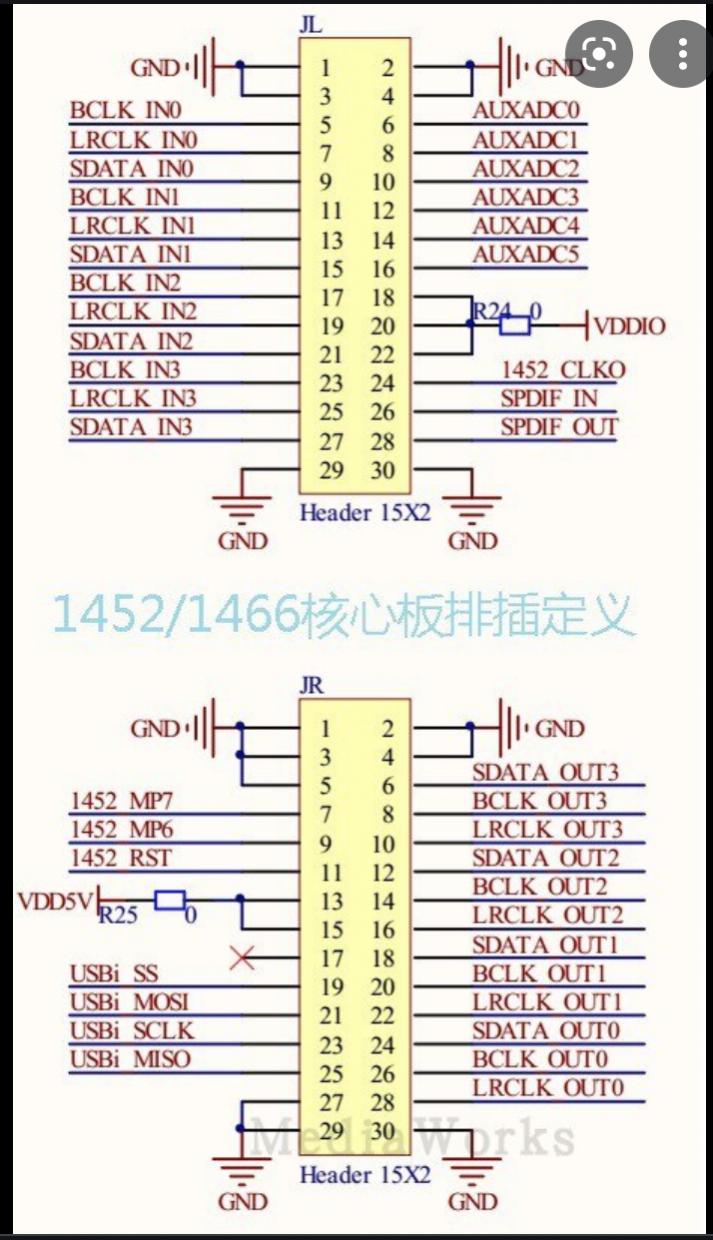

What do you think of these kind of boards? They have i2s connection, but I'm not sure if it's working, what do you say? The 1466 seem to handle i2s but I'm not sure how to connect things correctly.

ADAU1466 board
ADAU1466 Core Board Longer Delays for SIGMADSP Engineer Audio Maker DIYER | eBay
LRCLK
SDATA (which I assume is the same as regular signal-data)
BCLK
GND
What's missing here is the MCLK (masterclock), but is it necessary or should it be picked up somewhere else on the board? Or is it the same as SCLK (system clock)?
Or are these cards totally unsyncable?
Pin I/O for the 1466 board attached.
The PM1794A requires a master clock. For 192kHz sample rate a clock of 24.576 MHz is required which can be supplied by the master clock output of the ADAU1466 (CLKOUT, pin 23) with its MCLK_OUT register set for x8.
It looks like this pin is presented on pin 24 of the the top header in your posted diagram (1452 CLKO). Beware of course that this is a high frequency connection, so keep it as short as possible.

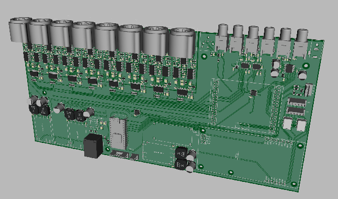

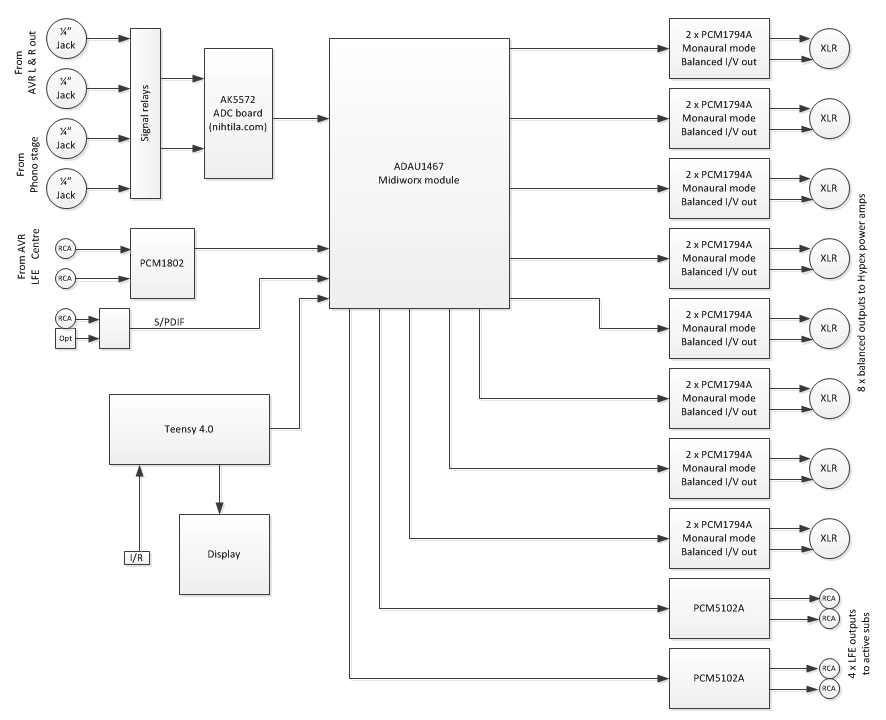

Taking my cues from the above posts re the Midiworx ADAU1467 core board and the PCM1794A DACs, I have desiged a PCB with eight channels of PCM1794A DACs to drive the LXminis plus a couple of PCM5102A DACs for the four LFE channels. Main L & R inputs go through an AK5572 ADC board which I bought from Tomi (nihtila.com) as he has made a very nice job of it and I can't see the point to reinvent the wheel! I made an option to switch these inputs to take the balanced oputput from my phono stage in case I wish to bypass the AVR altogether for vinyl. Also provided is a direct digital input option. For these direct input options, volume will be controlled in the DSP. The centre and LFE channels go through a single ended PCM1802 ADC. There is a Teensy 4 with a TFT display and I/R remote input. Input and ouput trigger functionality is provided.
Here is a basic block diagram:
3D CAD of the board:
This fits in a HiFi2000 Galaxy case (330mmx170xxx40mm). Most parts mount straight to the board but due to back panel space limitations I had to use chassis mount 1/4" jacks for the balanced inputs, also a couple of chassis mount 3.5mm jacks for trigger in and out. Power supply generation is onboard, just requiring a +12V DC input.
The PCB is scheduled to arrive today and I'm reasonably confident it should all work once I've solderd the 500+ SMTs, etc. as have had all the elements running on the bench in a prototype lashup.
Happy to share more info if anyone is interested!

your PCB looks great.

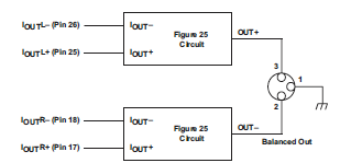

The Balanced out is done with the DSP?

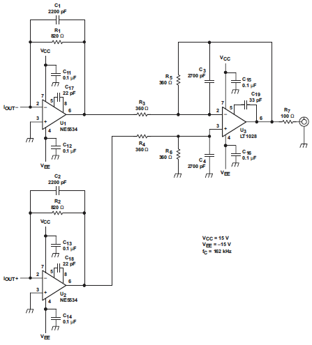

Balanced output is done via the PCM1794. One device is used for each of the 8 channels. There are three dual opamps per channel, so three opamps for the Hot and three for the Cold differential outputs. It is a similar configuration as shown in the datasheet:

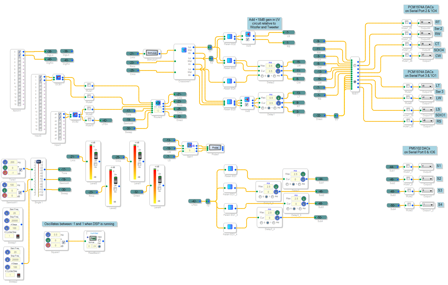

The I2S signals are fed to pairs of PCM1794A devices, both set to mono mode and one set for the left channel and one for the right channel. Linkwitz licensing does not allow me to publish crossover details in a public forum, but here is the prototype SigmaStudio top level design, including a few test tools such as signal generators and direct routing options:
Those who have a LXmini+2 licence will know that the sub has around 18dB peak lift compared to the woofer and tweeter so I have taken advantage of building my own post DAC stages to include an extra 18dB gain in the sub hardware channels in order not to require it in the DSP. This way I have kept an extra 18dB of dynamic range through the DSP.
I should add, apart from the PCM1802 ADC which is limited to 96kHz, everything else is running at 192kHz sample rate. There are few things not shown in the proptotype SigmaStudio design, such as a a four stage tilt control (ala QUAD preamps) routing of the digital signals through the mixer, etc. so it is a definite work in progress!
