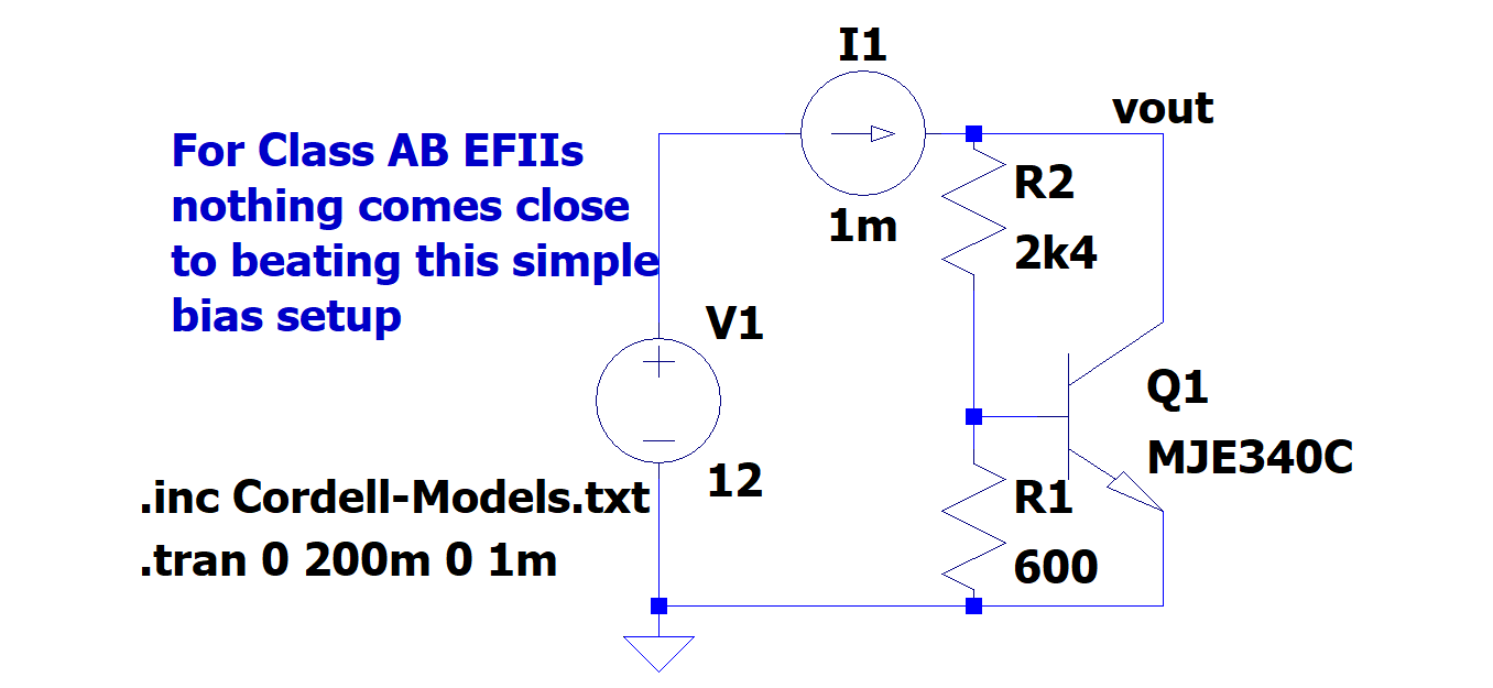

No, I'm not doing the work for you: go try it for yourself, it's free (at least OpenAI ChatGPT v3.5 is). Then learn prompt engineering and try again.
Oh, but I'm not asking you do the work, just notify us when you happen to encounter a circuit. I'll keep my eyes open as well.
