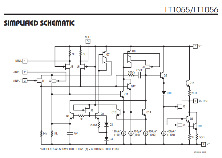

The Pearl 2 phono stage has no feedback at the first input stage, while many other phono stages do, but make the mistake of also using it as a RIAA filter at the same time. (Pearl 3 is a little different and Wayne also seems to know the formula, however the preamplifier on page 12 can easily take on Pearl 3). Voicing amplifiers cannot be used in phono stages due to the added complexity and noise they introduce.
For the second gain stage, you can either use the LT1055/56 or a discrete op-amp like the second stage of the Pearl 2. This op-amp could also be very good for all line-level processing.
The sound signature of your phono stage will change considerably depending on whether you choose to use the first stage of the Pearl 2 or the LT1115. I think using a signal relay to switch between the two types of input stages could be useful. However, if you don't want to be constrained by proprietary chips, you can go discrete with SMT.
The first input stage can make a big difference in the sound of a phono stage.
Feel free to critic and correct any claim

Much better is OPA192 (better Voffset, lower noise and TDH, lower price)For the second gain stage, you can either use the LT1055/56

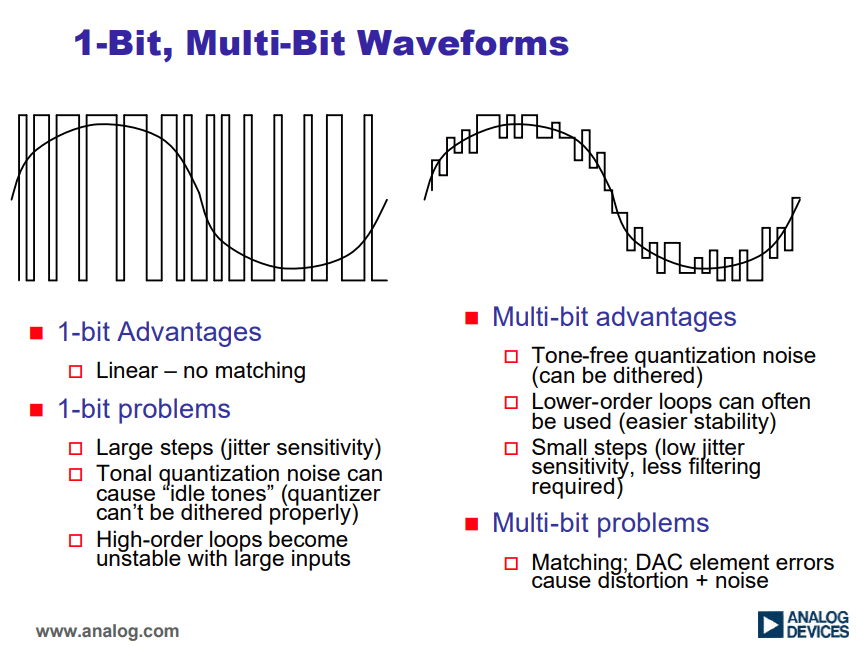

Title: Navigating the Impact of Jitter in Audio: Unraveling the Digital Symphony
IntroductionIn the realm of digital audio, the subtle yet significant issue of jitter has captured the attention of audiophiles, engineers, and enthusiasts alike. Jitter, defined as timing variations in the arrival of digital audio bits, has the potential to influence the perceived quality of reproduced sound. Its impact on audio playback quality is a subject of ongoing debate and scrutiny in the audiophile community.
Defining Jitter
Jitter refers to deviations from the precise timing of a periodic signal, specifically in the context of audio, where it manifests as timing variations between individual bits or blocks of bits in a digital audio stream. The consequences of jitter are most notable in high-resolution audio systems, where the precision of timing becomes paramount.
PCM and DSD Playback
In audio protocols like I2S and SPI, jitter can manifest differently for PCM (Pulse Code Modulation) and DSD (Direct Stream Digital) playback. In PCM systems, timing errors can cause distortion in the reconstructed analog signal, thus affecting audio quality. DSD, being a 1-bit audio format, is generally less susceptible to jitter, but significant levels can still impact playback accuracy.
Audibility of Jitter
The audibility of jitter is a nuanced aspect that depends on various factors, including the resolution of the audio system, the sensitivity of the playback equipment, the individual listener's sensitivity, the listening environment, and the type of audio signal being transmitted.
Mitigation Strategies
Audio engineers employ various strategies to mitigate the effects of jitter, such as dedicated clocking mechanisms, buffering, and re-clocking devices. These devices are implemented in high-end audio equipment to ensure precise timing and minimize the impact of jitter on audio quality.
Resistor Ladder DACs and Subjectivity
Certain DAC architectures, such as resistor ladder DACs (R-2R ladder DACs), have been associated with delivering a more natural and musical sound. However, the choice between DAC types is highly subjective, and factors such as implementation quality and system compatibility play crucial roles in shaping the overall audio experience.
Conclusion
While the impact of jitter on audio quality is a topic of ongoing exploration and discussion, it is clear that minimizing jitter is a priority in high-quality audio systems. The pursuit of pristine timing and precision continues to drive advancements in audio technology, ensuring that the digital symphony reaches the ears of listeners with fidelity and accuracy. As audiophiles navigate the intricate world of digital audio, the quest for an optimal balance between technical precision and subjective preference remains at the forefront of the audio experience.
